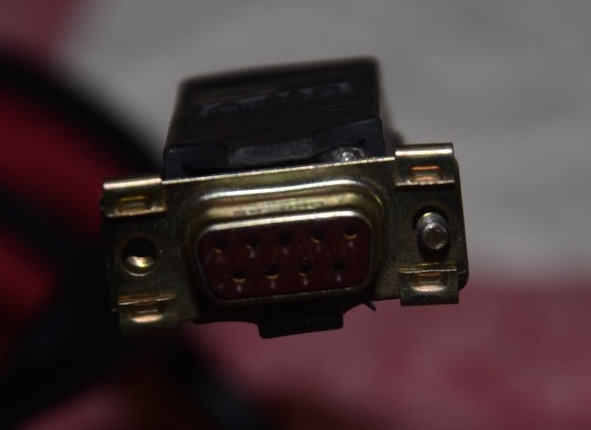

Does anyone know what language/protocol a Sperry Unisys keyboard might speak?
This is a terminal keyboard with a DIN-9 female connector at the end of its cable:
Inspecting the wires, I get this:
\ 5 4 3 2 1 /
 \ 9 8 7 6 /
1 - Black
2 - Blue
3 - No Connection
4 - Red
5 - Black
6 - Black
7 - Green
8 - White
9 - Black
I have not yet traced these to pins on the board or its 8048 microcontroller. That is the next step. But a quick look at kbdbabel.org reveals that this does not align to any of the DIN-9 connectors that they post.
Any ideas?

My instinct tells me Red is Vcc, Black is Gnd, and the rest Rx, Tx and ?idk?

My guess is that we have Rx, Tx, and clock. That depends on how the lock LED is implemented. If the terminal tells the keyboard to light the LED then it makes sense to have Rx (from the keyboard's perspective). Otherwise, I don't know.
Hopefully I'll get a chance to trace it out tonight to see what happens!
