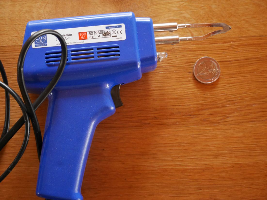

Hi! Is this soldering iron appropriate to desolder switches, or is it toochunky (this is my suspicion)?
If not, please give me a recommendation.
12 Apr 2015, 15:59
The shape is hard to hold. A "pencil" type iron is probably much easier. Something like this:
http://www.radioshack.com/nte-j-060vt-2 ... t=15&sz=12
To remove solder, there are cheap pumps like this:
http://www.smarthome.com/steren-400-170 ... oCuY7w_wcB
But much easier are these:
http://www.radioshack.com/radioshack-45 ... Sp5TpOK7Yg
And all are available on ebay from China even cheaper.
Of course, if you are willing to spend $100+ you can get a serious rig, which is always recommended.

The cheap desoldering pump for me is the best option and the cheapest, i have disoldered a lot with mine, i even broke the pastic threads on mine of use, that soldering iron is 100w if you re not careful you can melt the pastic on the switches i think, but if it is what you have just pick up some parts and practice a bit if it´s your first time and you would be ok with time and practice. If your planning on buying one, a decent one with temp control can be found cheap enougth. i would definitly recommend you one of those since you can change tip too, ( wich can be very helpfull in a desoldering job )
if your planning on salvagin some old switches, then i give you a tip, even your going to desolder them, add more solder (yeah counterintuitive i know) but that would help you to get better flow and would be easier to suck up with the pump.
i hope it helps :)

If buying retail, ZD-987 might be a decent option for Europe, or the ZD-985 with just the desoldering iron.

Thanks for recommendations. Why can’t I simply use desoldering wick?

mmm i would say that´s more for cleaning than for desoldering, it tends to stick on the boards and is slower that the pump , i would use the wick for smd cleaning on chip pins and take excess or even to tin a board with an oval tip, and the second reason is price, you would use a lot of wick.

The best desoldering pump I have ever used is a really cheap clone (like 3,50€ cheap) of the Soldapult. Just add a bit of solder to the pad and suck it up! High volume works wonders!

Still, regarding the iron, I've heard that you should go for 30W, max 40W otherwise you risk damaging the pcb and/or components.
Does this make sense to you?
There are lots of cheap 30-40W soldering starter kits available on ebay.
Thanks in advance!
13 Apr 2015, 11:52
you would be better with a cheap temperature controlled iorn. It does not have to be an expensive one . i got a hakko 936 clone and a real hakko tip for it and it works very well. The ones on the end of a cord usually have a terrible tip on them . not only that but they are quite dangerous imo , each to slide everywhere and burn you
13 Apr 2015, 12:05
andrewjoy wrote: you would be better with a cheap temperature controlled iorn. It does not have to be an expensive one . i got a hakko 936 clone and a real hakko tip for it and it works very well. The ones on the end of a cord usually have a terrible tip on them . not only that but they are quite dangerous imo , each to slide everywhere and burn you
Definitely this, I got the same (Yaihua 936 or something) and it's 10x better than my crappy old iron.

Zylkan wrote: I also checked YIHUA's website and apparently the 936 station is 45W, 936B is 50W and 936A is 60W. Would the 45W be ok ?
Also, regarding the possibility to control the temps, what kind of situation would make you want to go hotter or colder?
The wattage is not that important as its temperature controlled.
The idea is you don't want it any hotter than you need to. So if you are soldering a small component on a small pad you will need less heat than if you are soldering a heatsink to a huge ground plane.
I would also recommend getting yourself a replacement tip. The pointy tip is not so good as it only has a small contact area with the component and pcb you are soldering and thus requires more heat you want a flat tip.
Something like this
http://www.ebay.co.uk/itm/GENUINE-HAKKO ... 51cdcb7210
You also want to use 60/40 solder none of this lead free rubbish. Also make sure it has flux in it and its as thin as you can get 0.5 mm is ideal
this is a good brand but have a look around see what you can find
http://www.amazon.co.uk/Solder-60-Hi-Ac ... F40+solder
When soldering never ever add solder to the tip and then try to solder like that you will get a rubbish joint. Place the tip on the part you want to solder for a few seconds to let it get hot and then add the solder in between the iron and the component, don't add too much you will be surprised at how little you need.

It's also worth noting that more power can actually help prevent burning traces and melting components, on a temperature controlled setup. (I highly recommend temperature controlled soldering stations, too.)
See, if you're using an underpowered iron, you'll put the iron to the joint, it'll cool down, and then take a while to recover. All the while, the area is being heated, damaging things.
A powerful iron, it recovers quickly, and you reduce the time you're on the joint, because it never drops below the solder's melting point for long. Less total energy transferred.
13 Apr 2015, 13:12
That is important as well yes. If you have an iron with a high thermal capacity you need less heat than you would with a cheaper one like the one above. But ether way its better than any hot stick you can buy by orders of magnitude :).
I mean you could get a high thermal capacity iorn like a weller or a metcal but you would be looking at 100s and 100s of euros :P.
