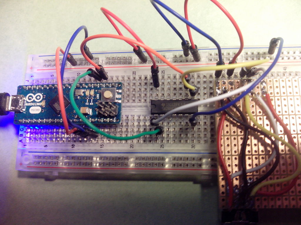

Hi all,
I've been lurking here for quite a while, and actually followed resources from this forum to bolt-mod one of my Ms ; but this is not about that. It is, however, a good time to say 'thanks' to the community.
I'm kind of a fan of Sun hardware ; incidentally I've grown to like the Sun keyboard layout. Coming from buckling springs, the actual typing experience is... different. The Type 6 is (widely known as) pure crap. The Type 5 is actually rather decent for a rubber dome. Finally, I got my hands on a Type 4, which I found suprisingly good (enough to quickly switch between the Type 4 and the Model M without any trouble or annoyance). The Type 4 is also rare as it is an ISO-Enter US/Unix layout.
So came the project to actually use the Type 4 as a daily driver and convert it to USB. I bought an Arduino Micro, delved into their libs and came up with a converter of my own. Very simple stuff : USB HID over the main 'Serial' port via the Keyboard lib, SoftwareSerial over 'Serial1' aka RX/TX aka pins 0 and 1, through a 7404 inverter on to the mini-din8 port. Read an input from the keyboard, transpose to the appropriate HID key code, pass on to a lightly-hacked arduino 'Keyboard' library, as to allow sending raw keycode (without ASCII translation).
It works like a charm (I'm using the sun keyboard to type part of this message), but it has the same limitation as the arduino's Keyboard library : no support for boot mode, and I don't know/understand enough of the lib to implement it.
That's when I discovered the LUFA library, which does support boot mode, and from there the TMK firmware, which already includes a Sun converter ; so let's try it. It compiles without errors (both on Debian, and on FreeBSD with gmake), loads with avrdude (original arduino bootloader) and... obviously, nothing ; the Arduino does not even come up as an USB device, at all.
The solution, of course, lies within config.h :
#define SERIAL_SOFT_RXD_BIT         1
#define SERIAL_SOFT_TXD_BIT         0
and since I'm using a hardware logical inverter,
(comment out)
/* #define SERIAL_SOFT_LOGIC_NEGATIVE */
Now I do get the arduino recognized as an USB device with TMK' VID/PID ; however, hid_listen only reports 'Reset: 0xFF' on each keypress (and sometimes on its own). In the other direction, none of the magic key sequences (eg, turn LEDs on) seem to work.
So, obviously, something isn't right with the serial communication between keyboard and arduino, but that's as far as I'm able to figure out. I'd welcome any pointers.

Arduino pin name/number is different from AVR name scheme and TMK uses AVR pin names. Check its schematic.
http://www.arduino.cc/en/uploads/Main/a ... ematic.pdf
I'm just curious, what is the problem?
sparky
01 Jun 2015, 09:05
hasu wrote: Arduino pin name/number is different from AVR name scheme and TMK uses AVR pin names. Check its schematic.
OK, re-checking this, the Micro's RX/TX pins are mapped to the AVR's PD2 and 3, as were initially defined in config.h.
I changed them back. I must have missed something before, since I get new (to me) symptoms.
Note, SERIAL_SOFT_LOGIC_NEGATIVE is still commented out since there's an inverter between the keyboard and the RX/TX pins.
So, with SERIAL_SOFT_RXD_BIT set to 2 and TXD set to 3 (original values),
  • the arduino shows up in lsusb with the TMK PID/VID, good
  • it's properly detected by hid_listen, still good
  • left alone, it reports "reset: 0xFF FF" at random interval. Or maybe that was a glitch.
  • most keys don't respond at all
  • Sun Open, F3, F7, 3, F, Numpad-1, left diamond consistently report (via hid_listen) a "reset: 0xFF"
  • E responds with ^[[6~ followed by "reset: 0xFF"
  • opening square bracket gives "layout: 0xFE EF" followed by "reset: 0xFF"
  • Numpad-+ and right diamond give "layout: 0xFE BF", no reset after
  • B gives "reset fail: 0x7E FF"
  • The keyboard shows no response to magic keys (tried with both right- and left-shift, and right- and left-diamond)
  • and strangely enough there's a 'reset: 0xFF FF / reset: 0xFF' pair reported when I toggle CapsLock on the Model M !

I didn't test the code with SERIAL_SOFT_LOGIC_NEGATIVE commented out. It smells like a bug.
Hmm, not sure but this interrupt should be triggered on 'falling edge'?
https://github.com/tmk/tmk_keyboard/blo ... .h#L63-L64
/* RXD Interupt */
#define SERIAL_SOFT_RXD_INIT()      do { \
    /* pin configuration: input with pull-up */ \
    SERIAL_SOFT_RXD_DDR &= ~(1<<SERIAL_SOFT_RXD_BIT); \
    SERIAL_SOFT_RXD_PORT |= (1<<SERIAL_SOFT_RXD_BIT); \
    /* enable interrupt: INT2(rising edge) */ \
    EICRA |= ((1<<ISC21)|(1<<ISC20)); \
    EIMSK |= (1<<INT2); \
    sei(); \
} while (0)
Try changing the line like this.
    EICRA |= ((1<<ISC21)|(0<<ISC20)); \
sparky
01 Jun 2015, 10:27
hasu wrote: Try changing the line like this.
(in config.h, line 65)
Wow, that was quick. It works.
Now hid_listen only prints the actual keystroke, and xev sees codes as expected (I've only got to re-adjust the keymap). It works on a booting machine as well (e.g. boot device selection).
The keyboard still doesn't seem to respond to magic keys (toggling key click, for instance) but I'll search a bit more before I ask about that :) In a similar vein, my original project called for a DIP-switch bank to toggle certain options in addition/as a default value to soft switches, I'll try and find where to integrate that by myself first.
Thank you hasu, that was amazing.

Could you post pics of your board? And if you setup your repository in github it would be great.

By pics of the board do you mean the prototype board ? (It's a bit messy but it otherwise works).

Yep, pics are usually very useful to understand how hardware goes.
Photo attached. As I said, messy, but it's been enough to get it working so far.
Quick overview : from the "south" end, the Arduino's GND and +5V feed their respective rail on the protoboard.
Arduino's TX goes to 7404's pin 9 (port 4A), through the inverter, out pin 8 (port 4Y), on to pin 5 of the mini-din.
Arduino's RX to 7404's pin 2 (1Y), through pin 1 (1A), to pin 6 of the mini-din.
7404's pins 7 and 14 to 5V and GND respectively.
Mini-din pins 1 and 3 to GND and 5V respectively.
Bypassing the 7404 was done by putting the jumper wires off 1A/1Y and 4A/4Y on the same rail respectively, off the chip.
