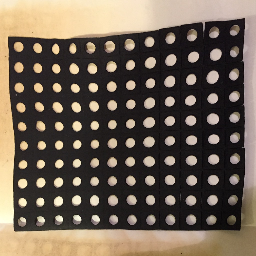

Ironing the pads
  • 1. Find a hard flat surface to use for ironing. If using an ironing board be prepared for the ironing board cover to smell a bit afterwards.
  • 2. Fold a blank piece of paper in half and place the landing pads inside. Place this on the ironing surface.
  • 3. Iron the pads. I ironed them all in one go. I did not find the need to iron them separately or in groups of four. If the temperature is too high there will be a lot of smoke and an unpleasant smell. Time to open some windows! The paper maybe stained brown and the pads will stick to it.
  • 4. Carefully peel the pads off the paper. They may curl up a bit so place them under some books and leave for a few hours.

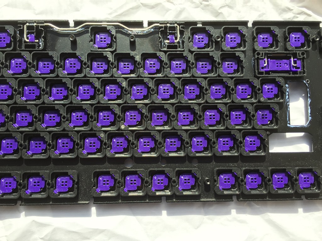

  • 10. Pop sliders out of the housing. Just press on them with a finger or prod with tweezers. Put the sliders to one side. I just placed them on top of corresponding rubber dome.
  • 11. The 2u stabilizers and their housing just pop out of the plate. I found it a little disconcerting as to how little force was needed for this. In comparison the 1u housings remained firmly attached to the plate.

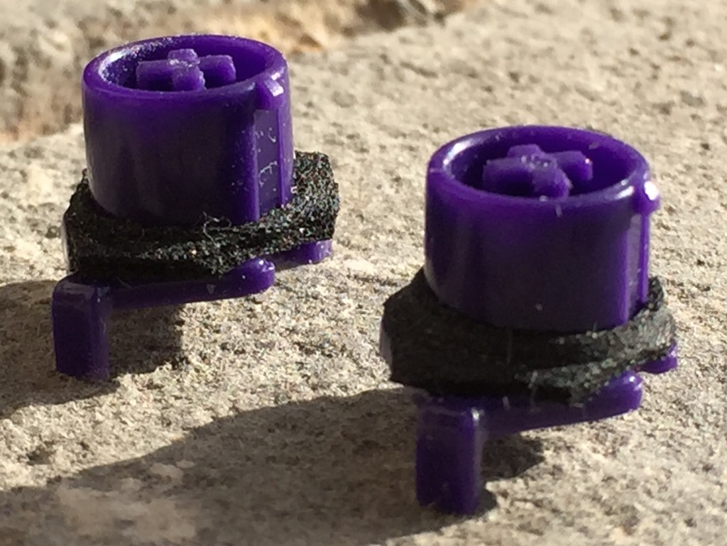

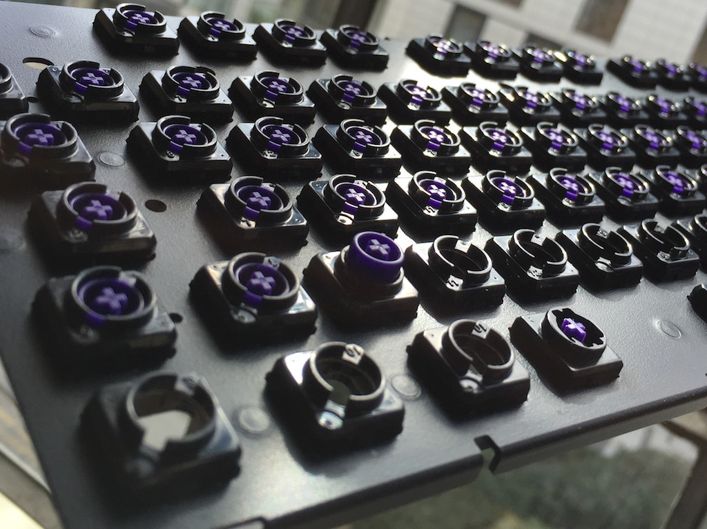

  • 1. Carefully tear off a pad and place it on one of the purple sliders. (Some pads maybe hard to remove and tear the adjacent one as well. You may find it easier to use scissors to cut the pads out.) The hole in the pad is slightly too small for the cylinder, so the pad climbs up it a little bit. It also sticks out over the base. Orient the pad so that its opposite corners are over the widest part of the base that clips into the housing.
  • 2. Pop the slider back into the housing. Test pressing it up. It should be much quieter on the way up compare to a slider that doesn't have a pad. If the slider sticks in the up position, use nail clippers to trim it down so the edges do not overhang the base. Sometimes the pad may need to be removed from the slider in order to trim it sufficiently. It is also helpful to push down the pad so it does not climb up the cylinder too much.
The pad climbs up the slider on the right too much and so the slider can get stuck in the up position. The wiki [wiki]File:Silent_Topre_-_Slider_Comparison.jpg[/wiki] shows this isn't as neat as the pads that come with a silenced Realforce or HHKB.

  • 1. For the spacebar I applied the lube on stabilizer wire, on the plate near the wire and in and around the mechanism at either end of the wire.
  • 2. For the stabilized keys I put a landing pad around the housing, as well as some lube on the parts not covered by the pad. Lube was also applied to the stabilizer wire, particularly where it touches the housing. As the housing easily popped out of the plate, I applied more lube to the contact area between the plate and the housing.

  • 1. Now all the sliders should be back in their housings and reaffixed to the plate. Place the plate on top of the domes and test that all the keys work as before. Pressing directly on the sliders should sound much quieter than before. In my case the 2u stabilized keys are almost silent. Previously they were the noisest keys of the lot.
