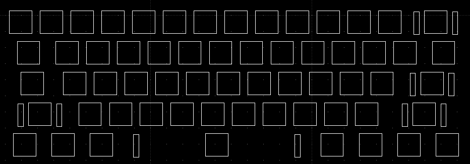

I'm currently building my first custom keyboard. It's plate mounted (hand wiring) TKL board. I've generated template from http://builder.swillkb.com/
Today I've got plate from laser cut. And found problems with stabilizers :(
I've bought stabilizers from WASD keyboards. First of all, looks like my stab holes are too long - stabs fixed not very well. I would need glue to fix them properly.
But another problem is space-bar. On backspace everything is fine. But on space-bar curved stablizer wire part hits middle of space-bar! I don't understand why. Cut-outs for backspace and space are the same. They must be different? Looks like they must be a bit above current position.
Could you help me, how to set up them correctly?
My drawing (dxf) is in attachment.
1_switch.zip
(5.99 KiB) Downloaded 163 times

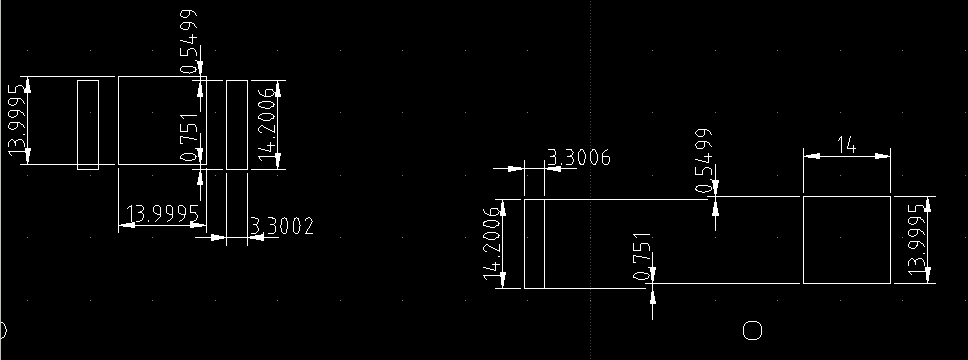

All sizes in mm.
This is image of part of keyboard, with stab holes:
Dimensions of holes: (another keys removed from image)
Looks like stab cutout must be 14.0(or less!) in height (instead of 14.2).
And aligned to the switch cutout. Without 0.5499 gap at top and 0.751 at bottom.
31 Aug 2015, 14:58
Hmm. Sure looks Costar. Perhaps they're use the same dimensions Matteo used on his early builds. Nah, forget that. Matteo's cutouts needed filing on one edge to make them bigger. Yours are plain too big instead.
Not a great problem to have to fix.
tinimi
31 Aug 2015, 15:13
Muirium wrote: Hmm. Sure looks Costar. Perhaps they're use the same dimensions Matteo used on his early builds. Nah, forget that. Matteo's cutouts needed filing on one edge to make them bigger. Yours are plain too big instead.
I can fix them. But what to do with space bar? It hits stab wire.

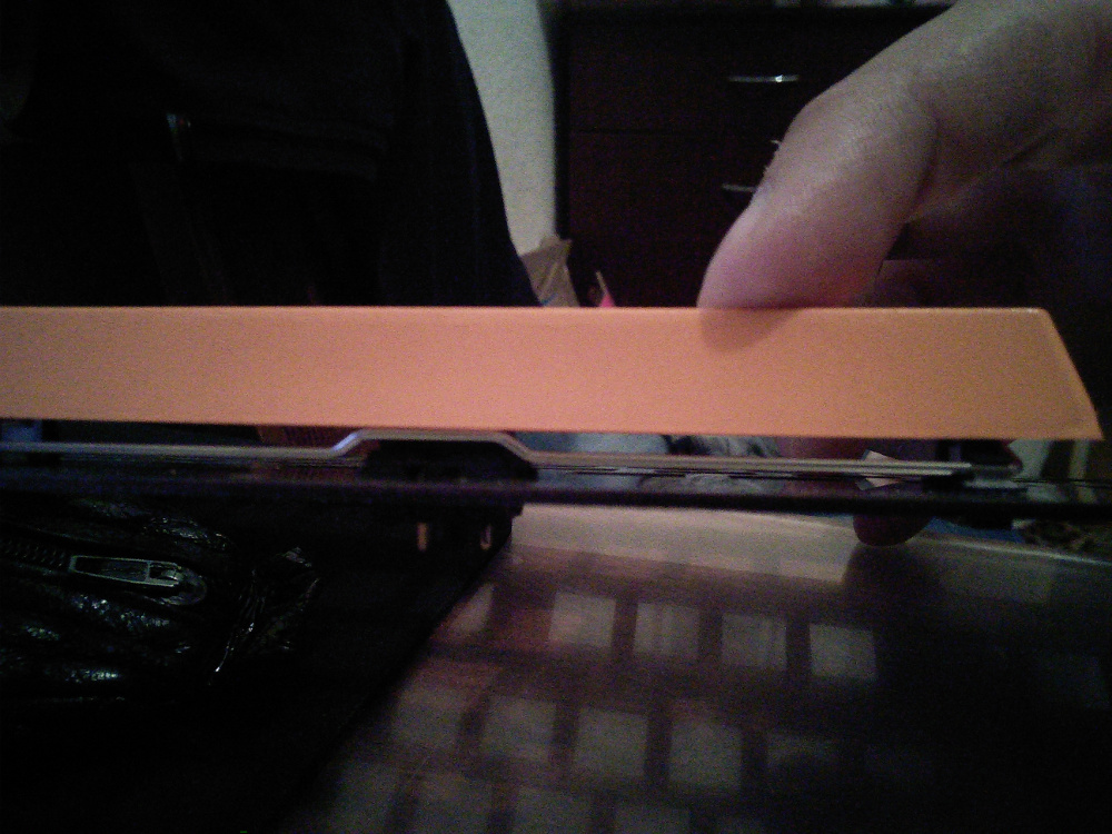

01 Sep 2015, 21:50
Here it is:
2015-08-31 22.12.16.jpg (300.51 KiB) Viewed 4445 times
I've done another straight wire (without curve in the center) and it works fine.
But i've found that plate insert must be moved upwards by ~0.2mm. Because currently stabilizer insert (in keycap) rubs stabilizer insert in plate. On both space bar, and 2u keys. And their movements are not very good.
And also cutout is 14.2 in height, while insert is only 13.6. So I would need to glue it to fix properly.
As written in swill's topic on GH - it is a bit bigger for thick plates - 1.6+. But my plate is 1.5.
Next time will try Cherry stabs. Costar had very low gap between keycap insert and plate insert, and must be positioned very precisely to achieve smoothly movements.

Stabs from WASD. 13.6mm. But swills tool generate cut out 14.2mm.
