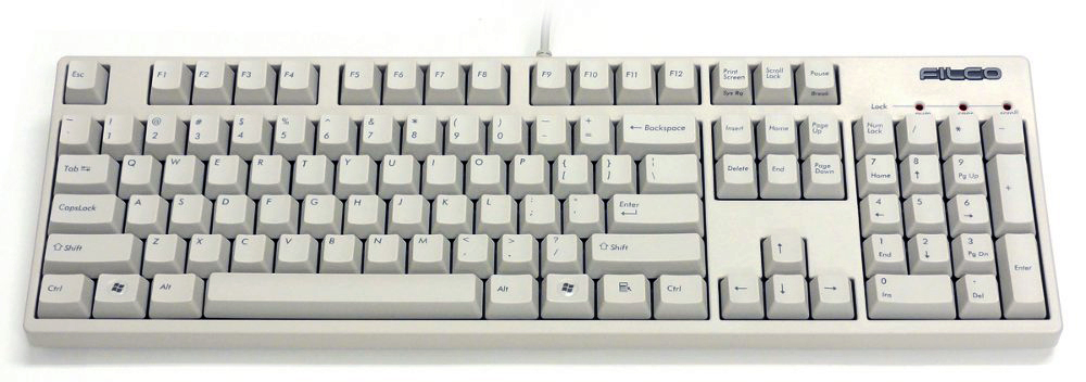

Does anyone know if Filco ever produced a version of this keyboard with MX Black switches?
Filco Majestouch-2 full ANSI keyboard in (biege) white.
All I ever see listed (in dead ads from back when it was in production) are models with MX Red switches.

Damn that's one fine piece of keyboard there. What would be brilliant, if someone provided Clears instead of Blacks.

I would gladly replace the MX reds with MX blacks if (a) I didn't have to do all the labor of replacement, and (b) I could get my hands one with reds in the first place. They are long out of production.
I was considering putting in a [WTB] in the Marketplace but thought I'd first see if asking for one with MX blacks was anything but pointless (which it would be if they were never made).
06 Sep 2015, 18:13
Cue someone trying to sell you lighter springs…
That mod's a lot of fiddly work. And plate mounted boards make it much worse.

I would buy a bunch of Gateron Blacks, solder out the reds, and put in the blacks. If the PCB is at least half-decent quality (cough cough Cooler Master) you will probably not suffer any losses through the mod. In the end you will have a keyboard that is not only unique, but (in my eyes) better than the Cherry variant, while being cheaper than vintage blacks, and it saves you the hassle of opening each switch to change the spring.
chzel
07 Sep 2015, 16:06
Filco PCBs are well made. They are somewhat difficult to desolder for the novice due to plated through holes. Get a good pump, add a good dollop of leaded solder and suck away. They can withstand a bit of abuse and heat, so not too difficult.
