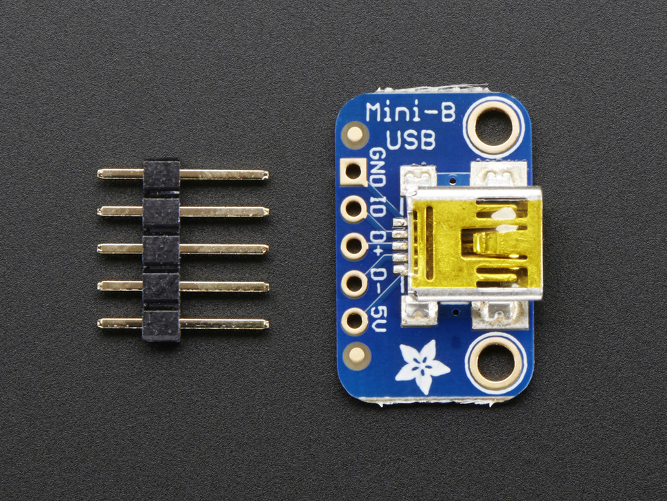

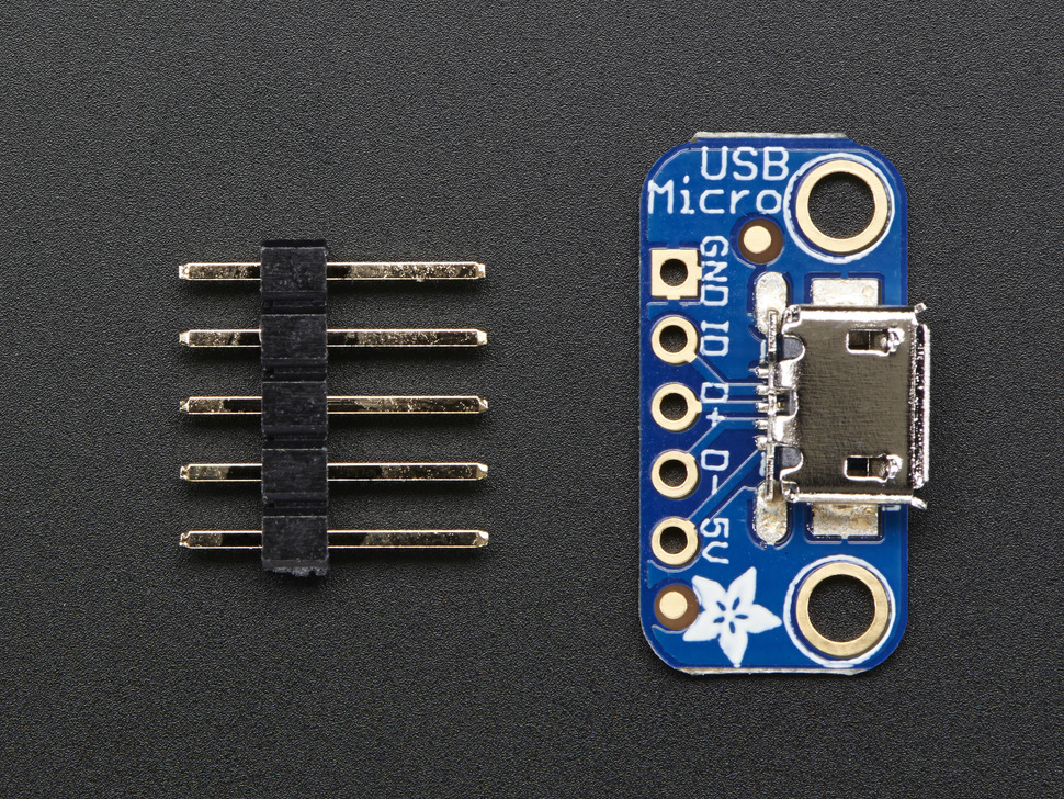

Adafruit also make micro and miniUSB breakout boards:
https://www.adafruit.com/products/1833
https://www.adafruit.com/products/1764
They are smaller than the ones from Sparkfun and cost $1.50 each.
06 Sep 2015, 23:22
Almost every USB port combo you can find is available on eBay from China for very little, even including shipping.
But those Adafruit boards look more useful than most, because of the mounting holes.
