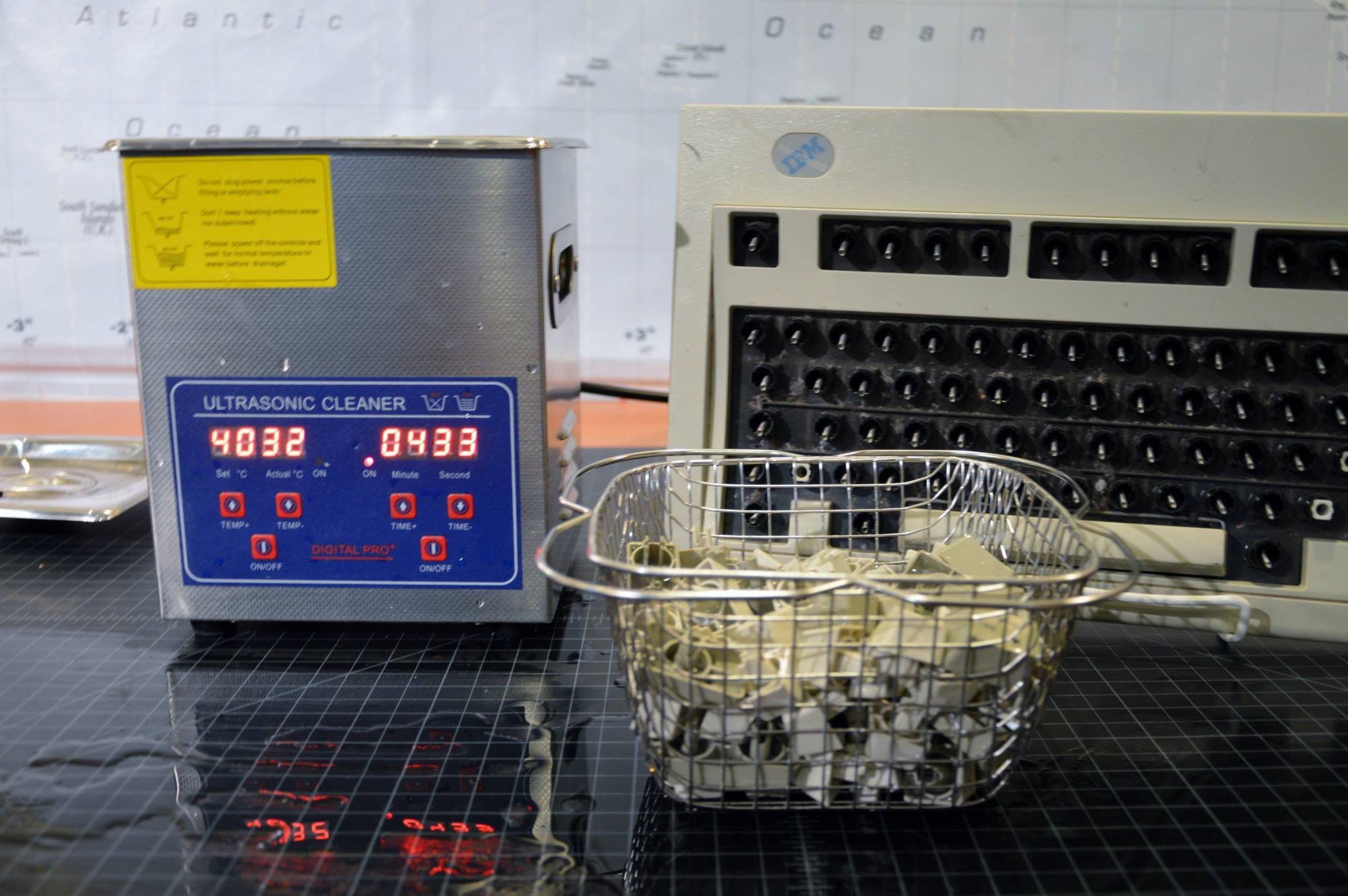

Earlier this year, I started to feel my hands getting old and I switched from cleaning tiny keys in the sink by hand (all 101 keys) to using an industrial-grade ultrasonic cleaner with warm water and a drop of detergent. Simply load the removable wire basket, warm water to 35'C, turn on ultrasonic motor/vibrator. Then I clean the keyboard front case in the sink by hand and 5 minutes later, all the keys are mechanically deep cleaned. It works great in removing 20+ years of dirt, grime and grease and is very consistent and helps to increase my workflow throughput. Since switching, I've seen my water bill drop significantly and am using much less detergent and the ultrasonic cleaner has now paid for itself. (Of course, we typically clean 20-30 keyboards every 30 days).
If you just have one keyboard to clean, then cleaning the keys individually in the sink with a bit of detergent and a kitchen rag is the cheapest.
model m ultrasonic cleaner

@clickykeyboards: Looks like a tasty batch of fries you've go there! ;) Seriously, though, the ultrasonic method looks good. Thanks for sharing this technique.

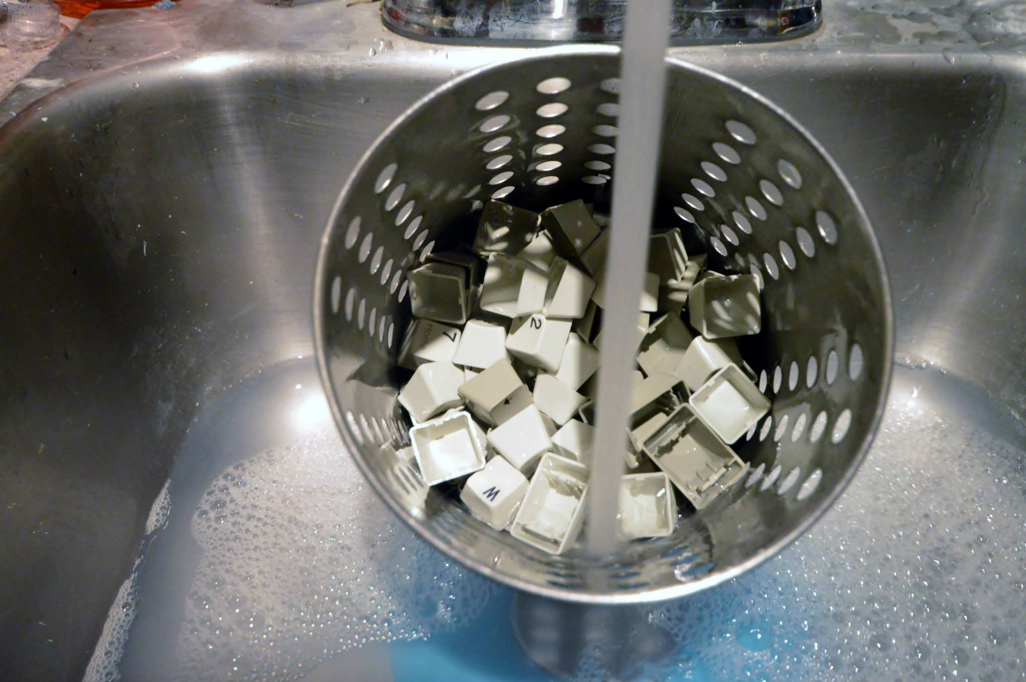

Wish I had switched sooner. Whenever I look at the old metal cutlery basket that I used to manually clean the individual key caps in, I just imagine all water, detergent, and time that I could have saved and all the waste that literally went down the drain.
old metal cutlery basket for cleaning model M keys manually.

I've thought about using the ultrasonic cleaner from the lab but it's kinda of powerful so I'm afraid of shattering my caps, especially the PBT ones xD .
clickykeyboards
03 Oct 2015, 22:53
Well.. :D I can only personally attest to my personal experience and confirm that the sonic cleaner works great with the model M dinosaur bones.
