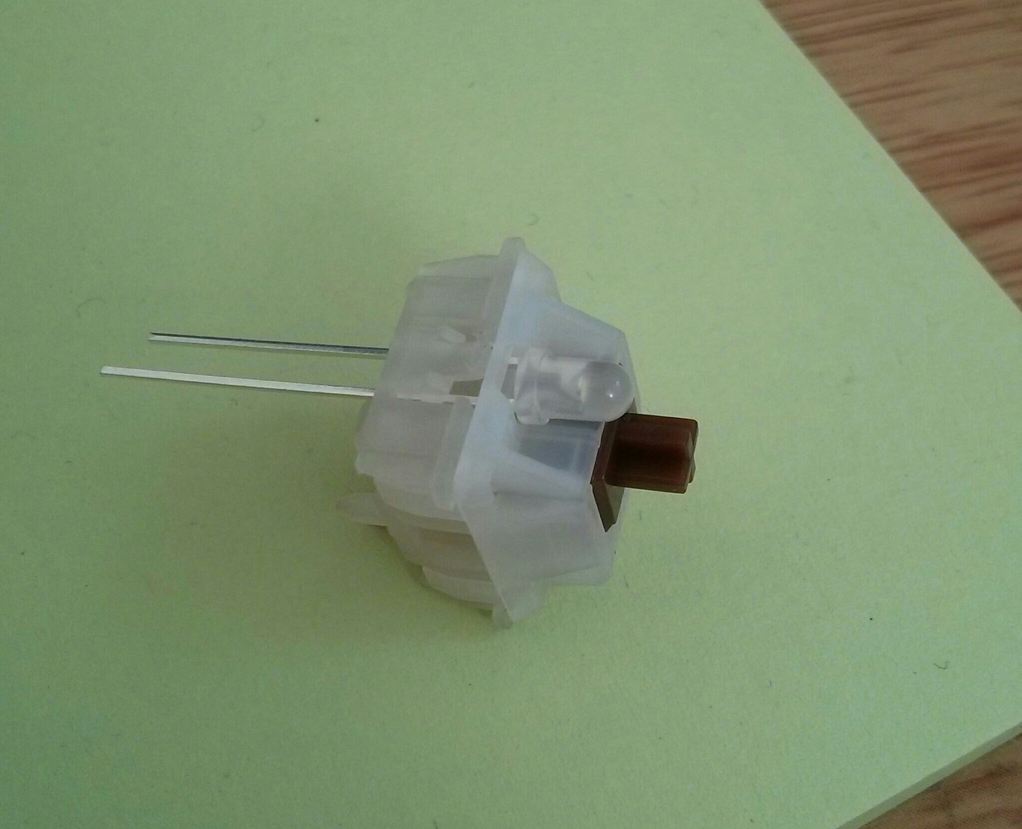

Here is a mobile phone pic of one of my gaterons with LED inserted.
There are indeed, as stabilised said, 4 holes in the bottom. I guess you could use those for RGB LEDs, too.
- IMG_20151024_160655~2.jpg (413.19 KiB) Viewed 1921 times
