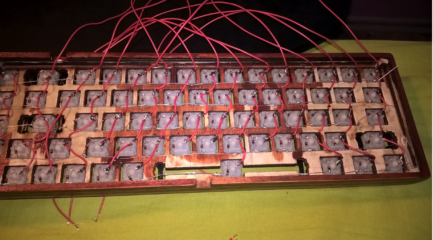

I've attached a picture (it's missing the wiring for the rows)
It doesn't have any metal in the encasement (it's made out of wood)

Well, your solderjob looks good enough. If it did work once, that shouldn't be the problem. Except I cannot see wires connected to your rows.
