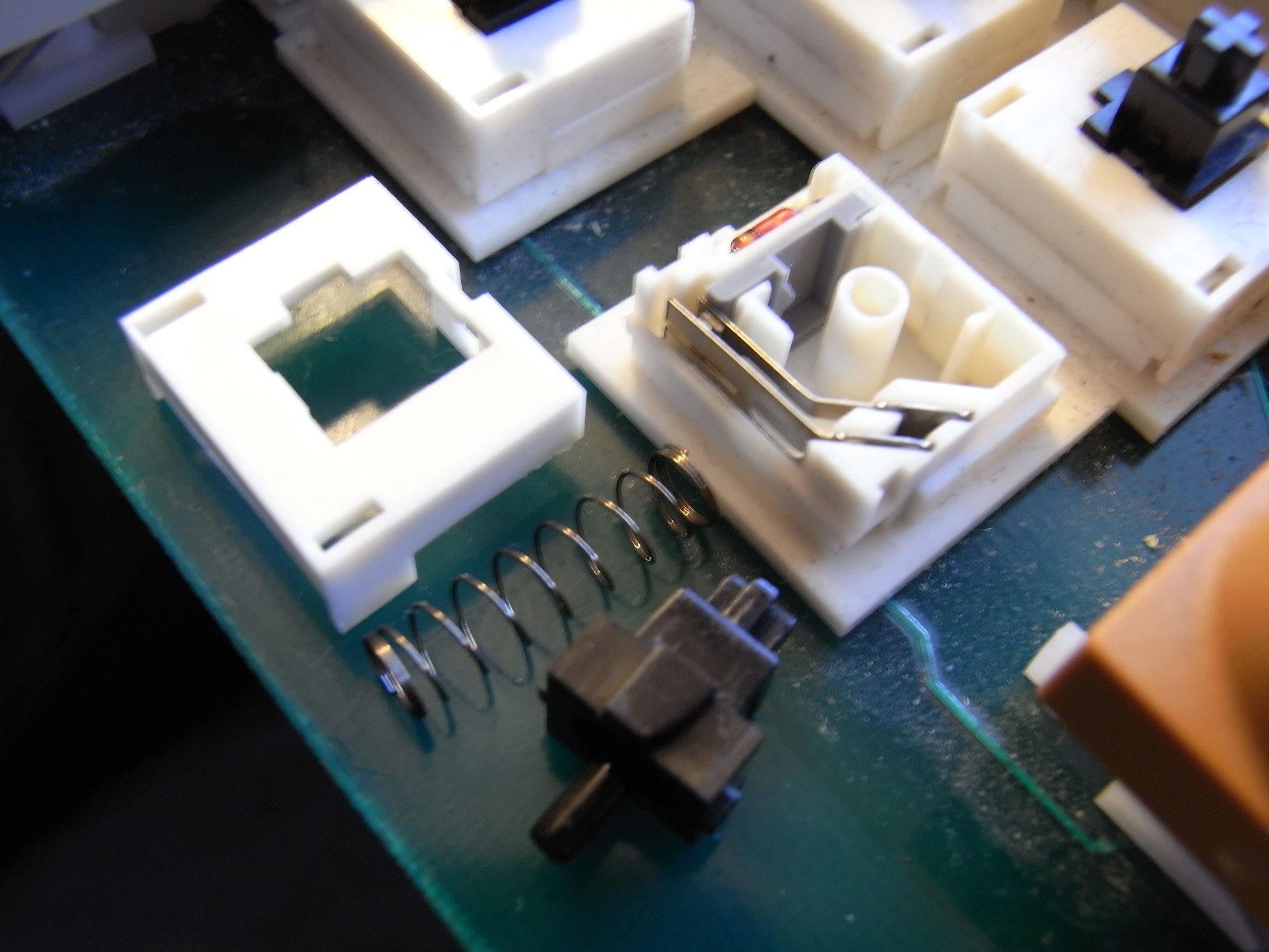

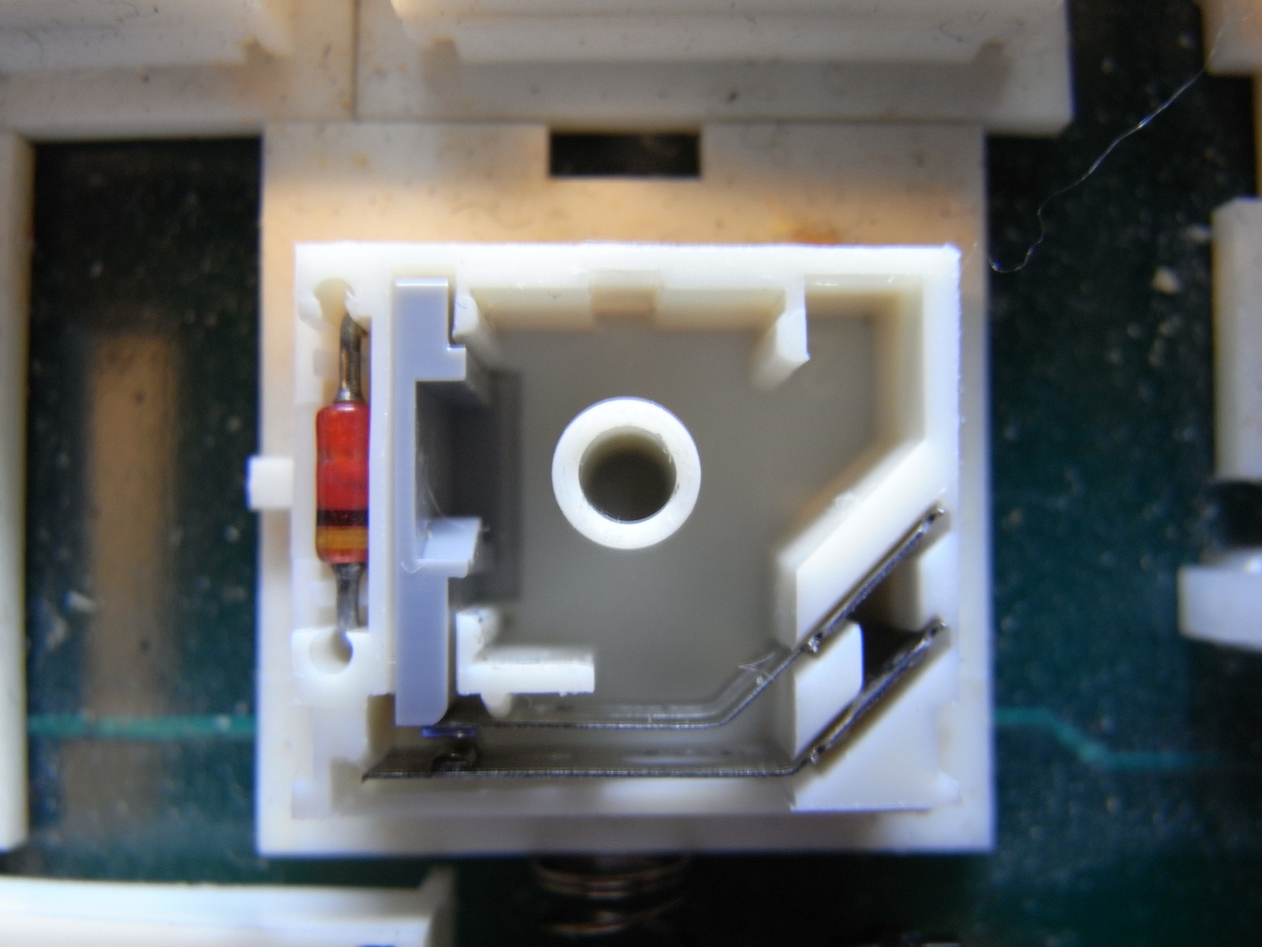

As you can see in from the pictures, there is a plastic bar that is pushed sideways by the slider to actuate the switch. This mechanism gives the switch very interesting characteristics. It's linear, as the spring is the main counterforce at all times. However, at the actuation point the force requiered to push the plastic bar sideways and additional friction is added. The result is a split linear curve, starting out as a regular linear switch but bumps up to almost 100cN if you want to push it to and past the actuation point. From there it continues linearly, but with the added friction. Needless to say, it has a very "springy" feel to it, and it's pretty heavy and not really suited for touch-typing. On the other hand, if you have an application where you need to hold keys down for some time or if you like to slam the keys as you type, then it's actually pretty good.

- Switch base and trigger mechanism
- RIMG0735 - Copy.JPG (506.45 KiB) Viewed 3497 times
- Slider and Spring
- RIMG 0739 - Copy.JPG (620.84 KiB) Viewed 3497 times

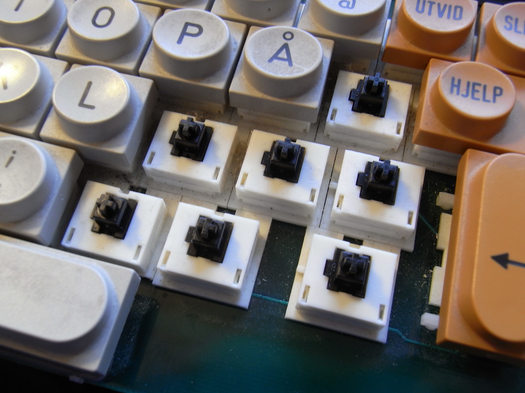

- An overview of the keyswitch
- RIMG0741 - Copy.JPG (616.92 KiB) Viewed 3501 times

Very nice macro shots. Does the force curve kick up just before actuation, or after it? I'm trying to picture typing on either!

The force kicks up just BEFORE actuation. The secondary horizontal slider has to move first for the switch to make physical contact, and that requires the mentioned force. Not good for touch-type!
