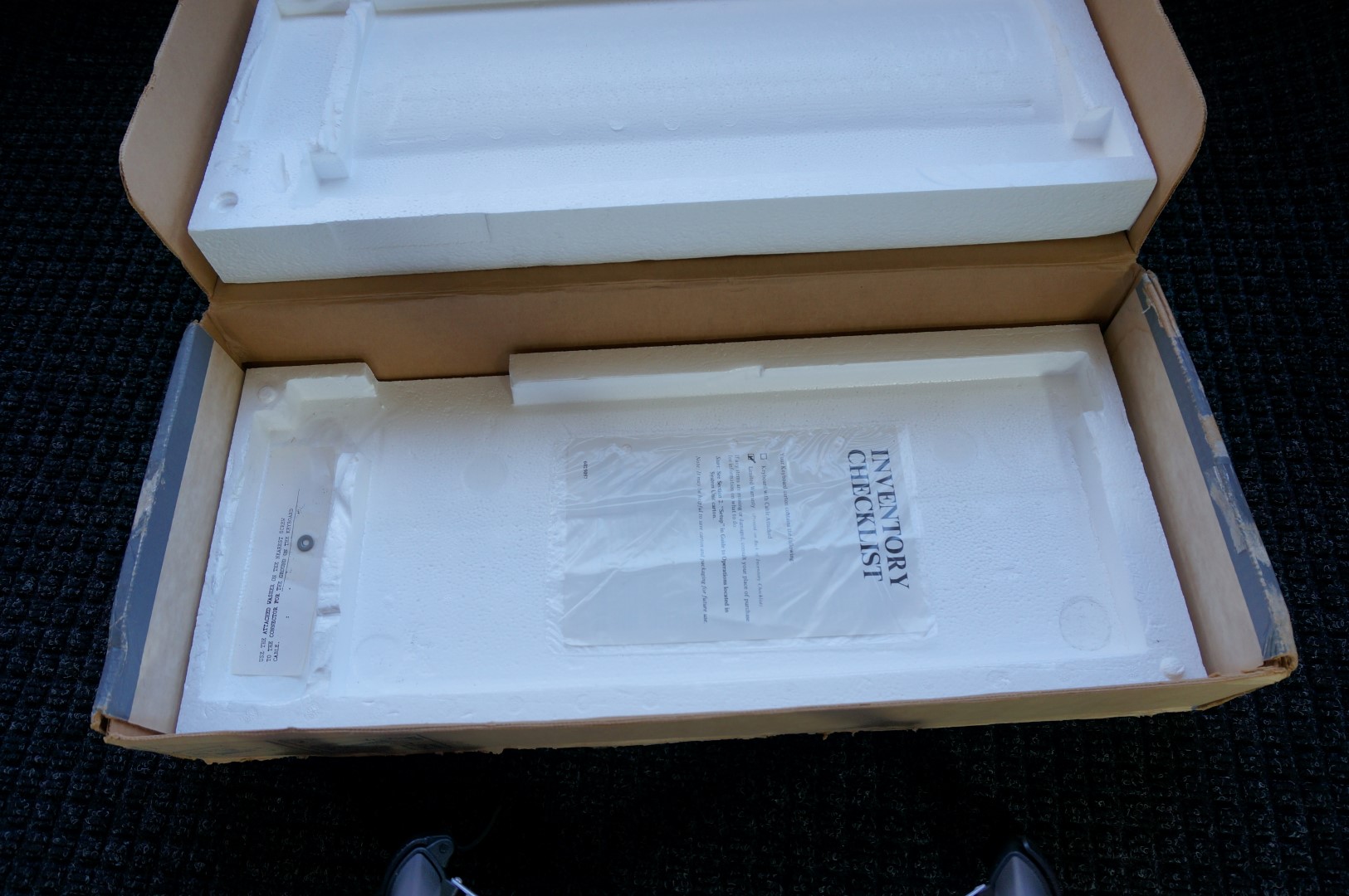

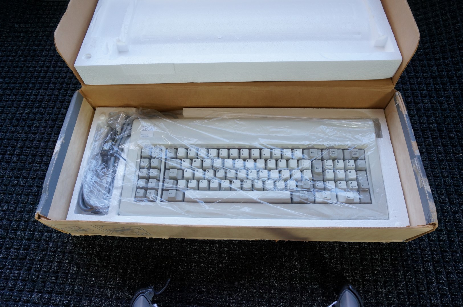

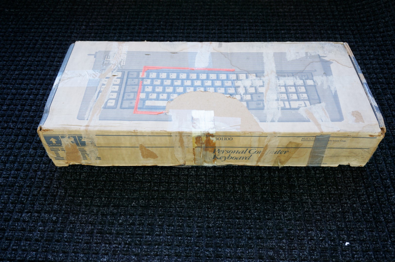

I found a NIB IBM PC/XT keyboard that at first I thought might be a type 1 keyboard, but when I received it I realized it was an EMR. Interestingly, it had the "Personal Computer" badge instead of the "EMR Keyboard" badge. It has a very strong smell which reminded me of the "Pingmaster" 6113442 / 6112884 keyboards.
To the pictures...
DSC00468 (Large).JPG (535.79 KiB) Viewed 4429 times
DSC00471 (Large).JPG (461.48 KiB) Viewed 4429 times
DSC00472 (Large).JPG (332.27 KiB) Viewed 4429 times
