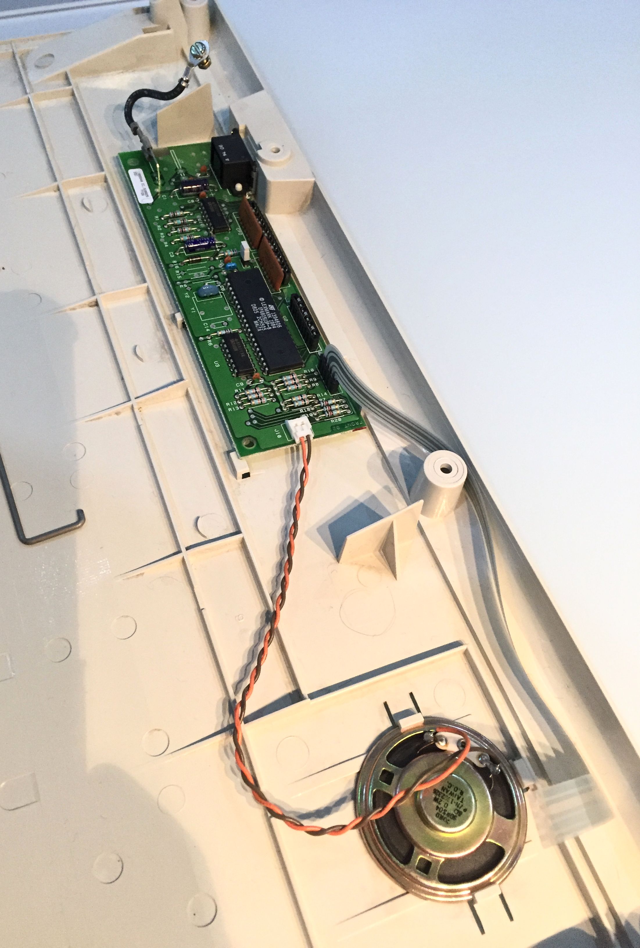

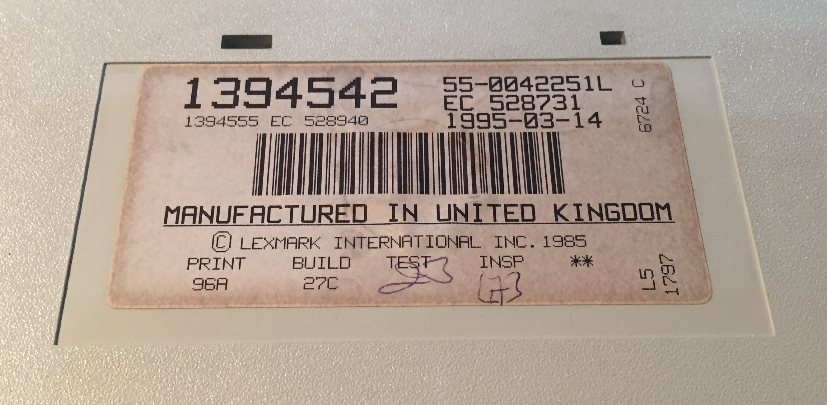

Hi,
I got my hands on a German Model M with Speaker.
Does anyone knows how to make it work ?
The interface is a normal PS2.
Photo 27-11-15 22 35 49.jpg (644.7 KiB) Viewed 4021 times
Photo 27-11-15 22 39 04.jpg (431.05 KiB) Viewed 4021 times
Thanks

This keyboard was originally made for use with an RS/6000 workstation.
I think the speaker only had the function of the solenoid in older boards. If you search for #6599 on this page
http://www-01.ibm.com/common/ssi/ShowDo ... _locale=en
you'll find a replacement part "Optional Keyboard Cable with Speaker" that you could use if you keyboard didn't have its own speaker. It says: "Purchase is recommended with the Quiet Touch Keyboards for those systems needing an external audible queue", which I interpret as meaning that, like in the old terminal keyboards, the speaker clicked when a keypress had been registered by the operating system.
I don't know what the command to make the speaker click would be, but it must have come from the computer.
Halvar
28 Nov 2015, 01:15
Ha!
http://ps-2.kev009.com/ohlandl/keyboard ... board_PCBs
"One side of J10 [speaker connector] goes directly to pin 6 on the SDL connector, which is why the RS/6000 keyboard cable can not have the "missing pin" found on some PS/2 keyboard cables. The speaker is a little 8 ohm, 0.2W job, IBM part number 1392326. "
So you can really play some music on it... :D
If you can confirm that, could you please add that information to the wiki?

The speaker is directly connected to the Model M connector and from there to two ps2-unused pins.
I have the pinout. I will make a picture and post it.
