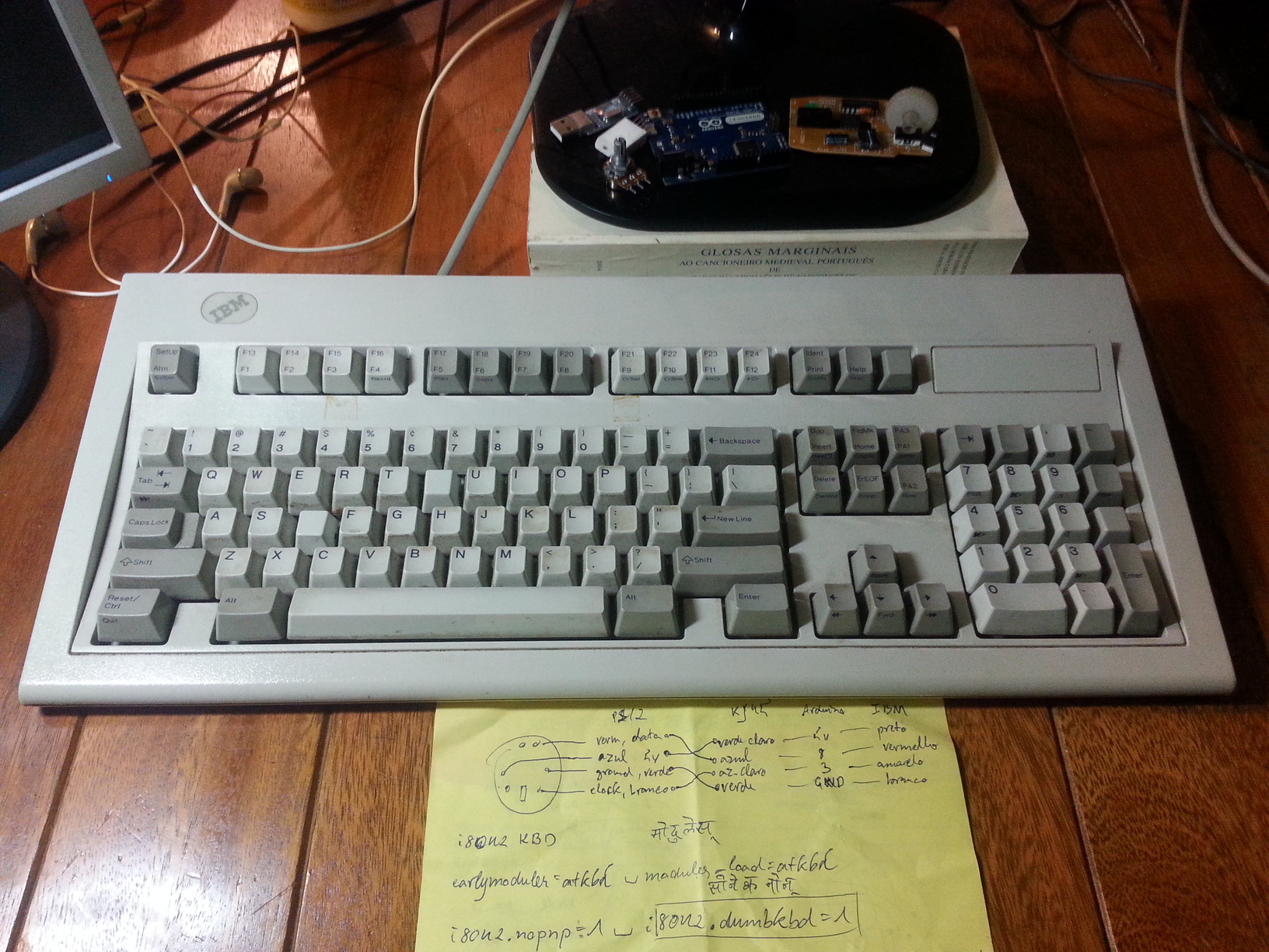

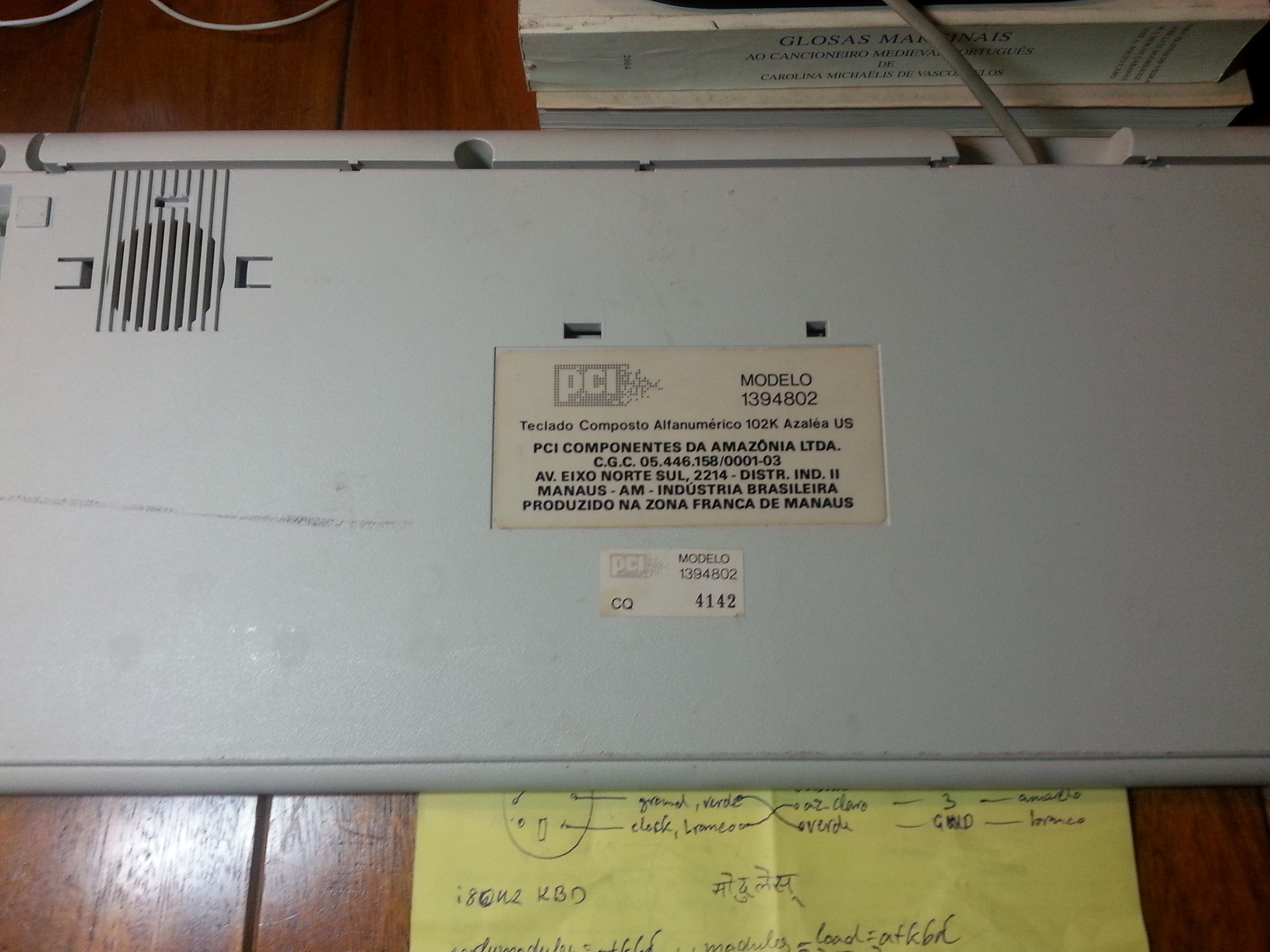

I've received last friday a 102-key Terminal Model M, most likely assembled in Brazil, and so with an unusual stick on the back stating to be a model 1394802, of which I didn't find much information:
back
back
here is the front:
front
front

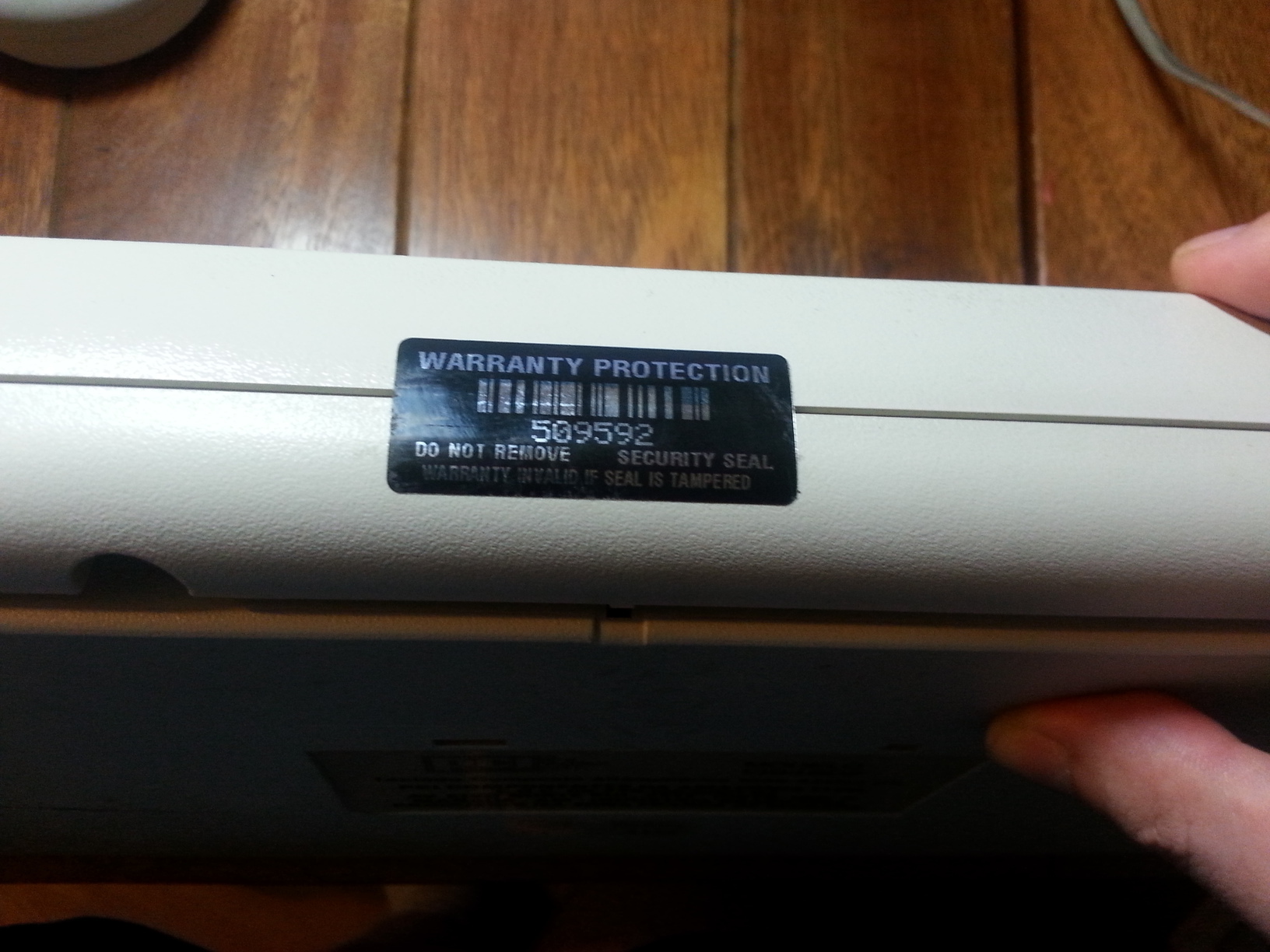

And here is a warranty seal... is it original?
seal
seal

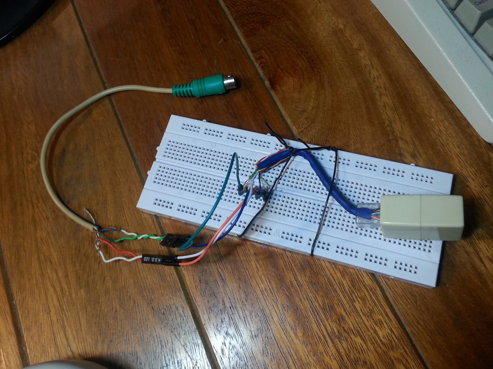

Now, I wanted to test if it was working before doing anything else with it. As it has this seal, and I don't have the screw, I didn't open it. I could test using Soarer's converter for instance, but I don't have any appropriate microcontroller around. Also it was friday already and there was no convenient place to buy the stuff.
After some quality time I've managed to build this ungodly thing, using a female-female RJ-45 connector:
rj-45 to ps/2
rj-45 to ps/2
I've used a breadboard because I wasn't sure which wire went with whom. Also I'm a linguist, so I'm surprised nothing ended up blowing me to pieces : o ).
First I checked which RJ-45 wire corresponded to which one on the keyboard connector, and then I checked the PS/2 wiring using an Arduino Uno to read it, and plot the reading using the plotter of the arduino framework. One thing to bear in mind is that the idle state on every pin, except the ground of course, is on high.
There is an Arduino library, to read ps/2 events, called PS2Keyboard (http://playground.arduino.cc/Main/PS2Keyboard). It was trivial to use it to read the keyboard once I got the wiring right; since it takes the scancodes set 2 for granted, it doesn't translate everything right, but fiddling with the library can make it output the raw scancodes, specifically on this function:

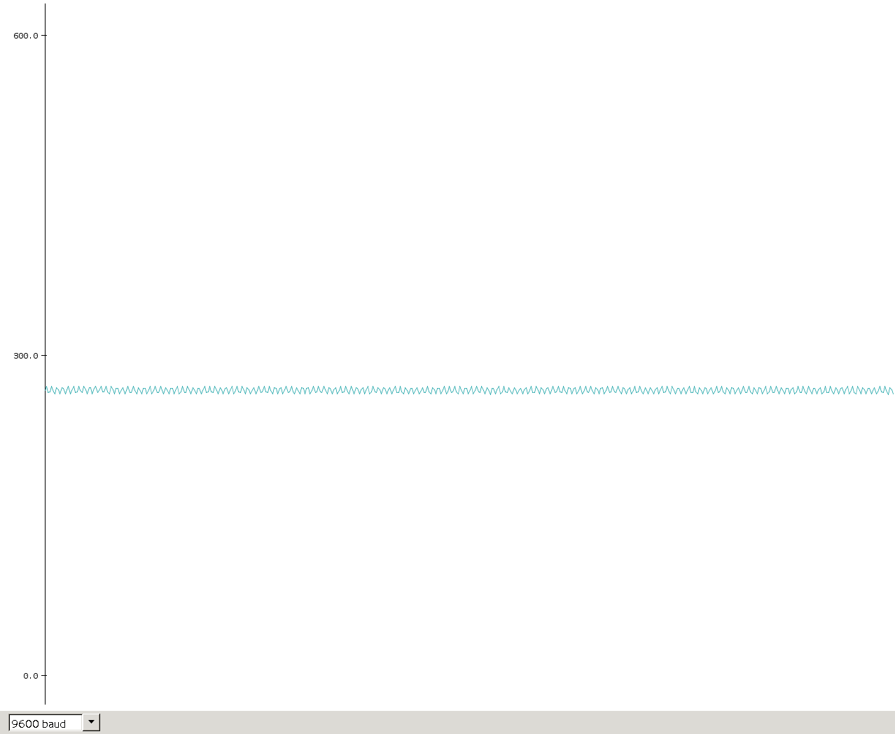

Just hooking up the analog 3rd pin to it, you can get graphs like this, using the serial plotter:
graph
graph
In this case the x-axis was around 1000 (1000 what...?) with spikes when I pressed anything, that were the clock and the data signals senting information to the computer. This site was very helpful: http://www.computer-engineering.org/ps2protocol/.
