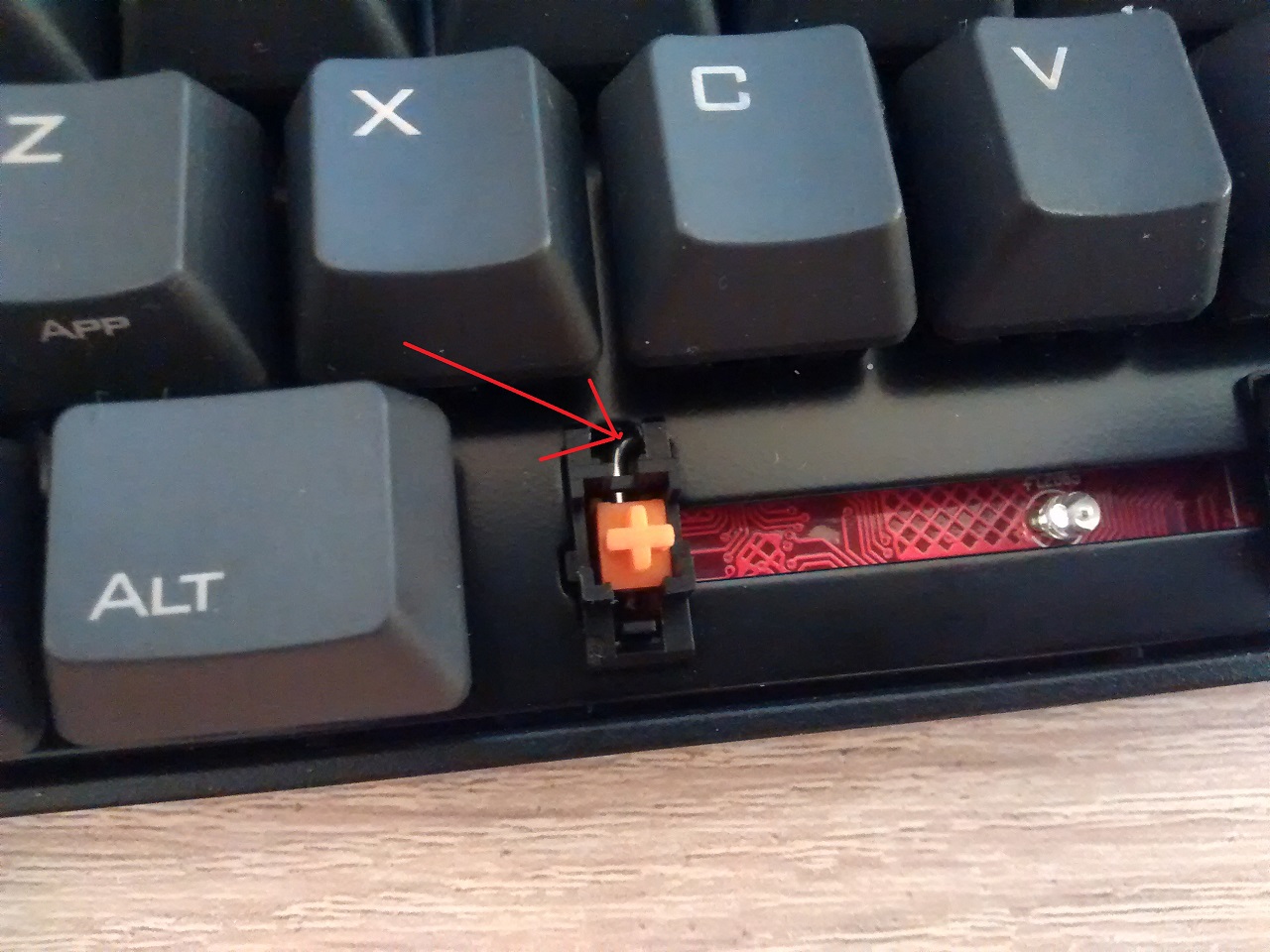

My wire is mounted towards the top... that means I'm screwed right? Would it be possible to only desolder one switch and remove the stabilizer, instead of all switches?
Here is a picture from my kb:
chzel
07 Dec 2015, 00:10
When I made that comment, I was referring to PCB mounted stabilizers, you have plate mount.
So either lube a bit where the arrow points, or you can remove the stabilizer by desoldering just that one switch.

Thanks for the info... It's pretty late here where I am, so I must have misread the mount type. Thank for the tip, I will try to lube as soon as I get my hands on some good grease (WD 40 might do the thing). Hopefully it'll work without desoldering... never did it before :)

Good news,
I just successfully lubed the stabilizers and the "rattling" is reduced by a large amount. It still can be heard, but I can live with it. I really don't wanna risk over-lubrication and have a sticky spacebar. I can always add silicone grease later. thanks chzel for the tip...
