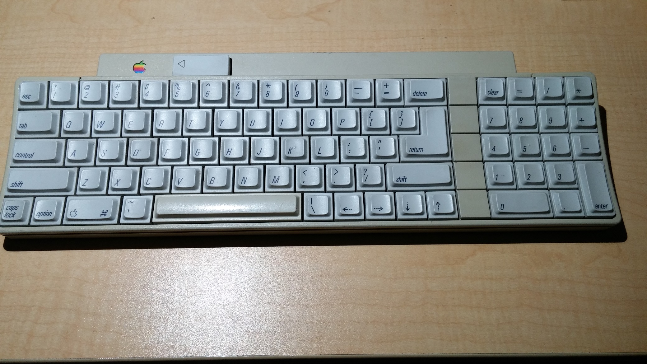

Here's a picture of it:
[see below]

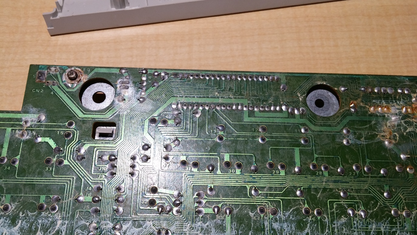

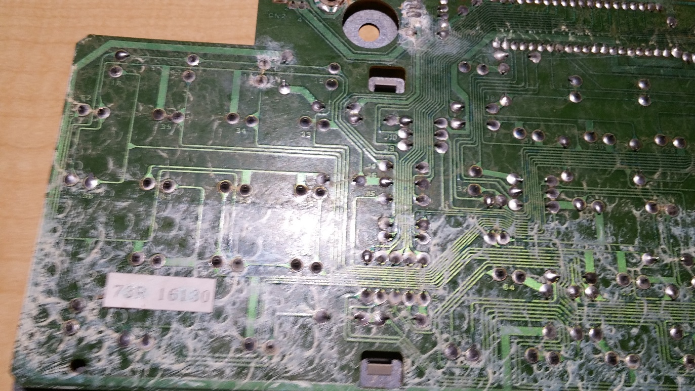

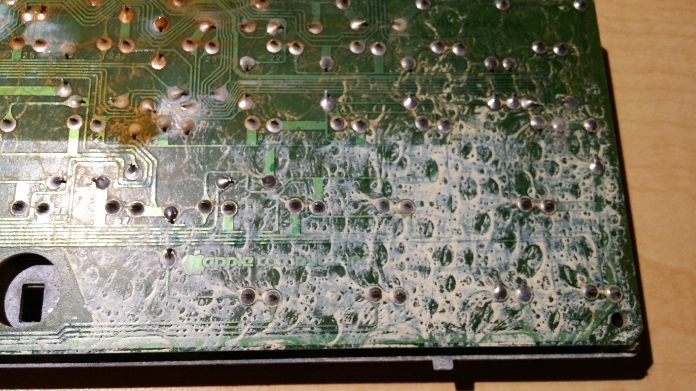

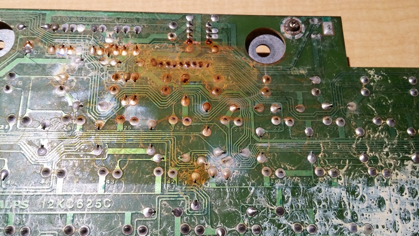

Okay, I thought, maybe I should take this thing apart and see if theres anything wrong with it. This is what I saw:
So thats an appealing sight

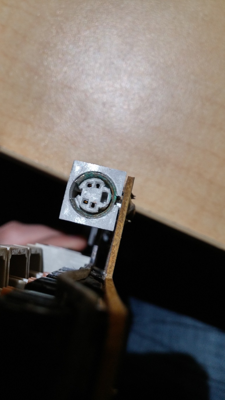

[keyboard didn't work when I plugged it back in, but it does now. See below]
Oh boy, these look a little mangled up. Like I said before, only the one from the right side works, so I only took a picture of the one. Just touching the left side's connector makes it wobble, so my guess is it's disconnected from the board.

Lots of work will need to go into repairing the PCB. I don't currently have fast data speeds so I can't see all of your pictures, but I will say not to be discouraged from buying a different one. I've never seen a board this bad other than a Model M that had flood damage.

I see your update. It's obviously not a lost cause, but lots of work will be necessary. First will be getting rid of the gunk on the back and the rust. If you don't mind the work, this would be best accomplished by desoldering all of the switches and taking ISA to it. Most of the rust will probably wipe off once you get some ISA on it.
Next will be sourcing switches. Orange or Salmon switches are not very easy to find by themselves, but you could replace them with Matias Quiet Clicks which are similar, though not exact matches. Otherwise you'll need to scour for them.
