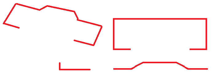

I have a different keyboard with the same stabilizer system and Enter key :mrgreen:
Just removed the Enter key to have a look, and obviously the way to properly re-install it is the following:
- put the wires in place (with the bent piece showing upwards):
Stabs A.png (64.71 KiB) Viewed 4529 times
- install the white plastic inserts on the wire so that their longer part shows to the switch when they are in their final position (i.e. resting in the stab base with their switch mount showing upwards)
- push the Enter key in place, done.
I hope it will also work for you :D

05 Feb 2016, 13:52
I'm not very good at drawing, but I'm an even worse photographer :lol:
Stabs B.png (2.63 KiB) Viewed 4458 times
The wires on my keyboard seem to be thinner than yours, but to have the same shape.
Perhaps I did not make clear enough what I meant when writing "put the wires in place (with the bent piece showing upwards)".
The "bent piece" was supposed to mean the raised middle part, which has to show to the cap and not to the board.
The direction in which the small white plastic inserts show also plays a role.
Their longer part must be directed at the switch.
05 Feb 2016, 14:09
Pic corrected:
Stabs C.png (46.65 KiB) Viewed 4449 times

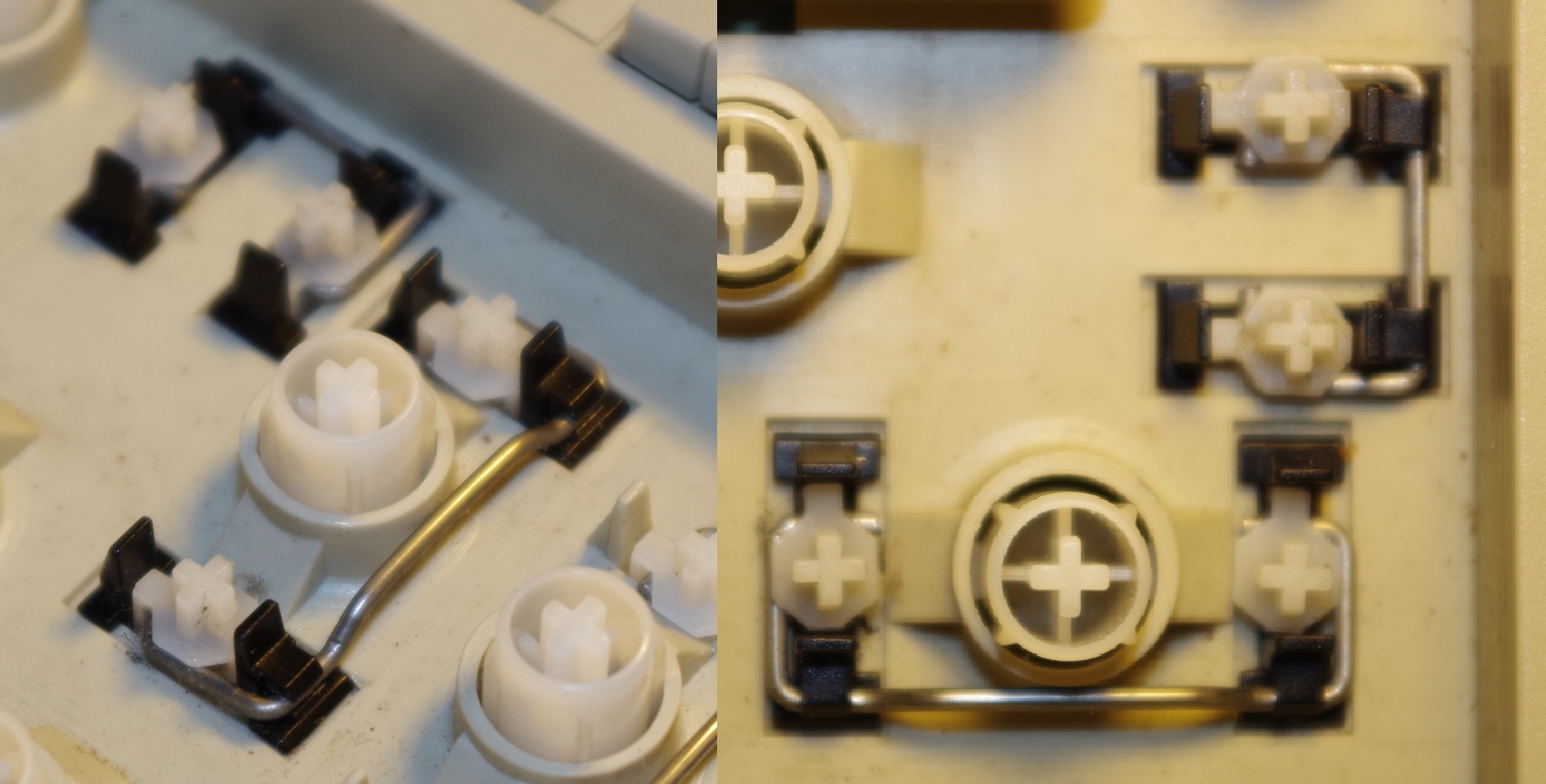

05 Feb 2016, 17:35
volhodav wrote: […] I only wish that you'd attach actual photos of your keyboard instead of drawings. However, beggars can't be choosers - I guess. […]
Actually, on DT sometimes they can:
Stabs D.jpg (209.7 KiB) Viewed 4405 times
(remember: lousy photographer :mrgreen: )
