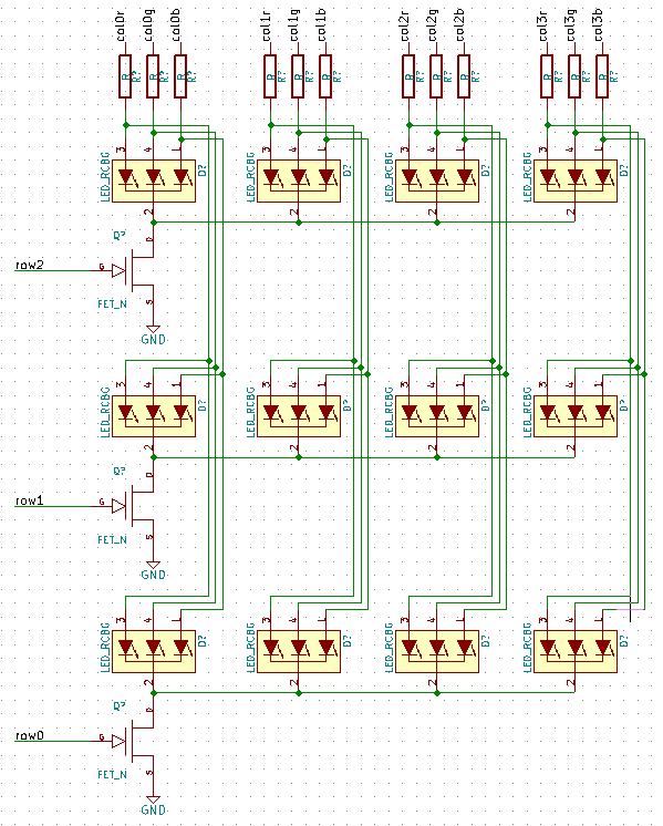

You need to decide first what backlight you really need. The minimum solution is all keys backlit with always the same brightness. That will require only one Pin on the microcontroller. The maximum monochromatic solution is that each key can have different brightness. If your switch scanning matrix is e.g. 10 x 10 then you will need at least 10 additional pins for controlling brightness (maximum duty cycle a bit less than 1/10). If you would want an individually controlled RGB leds then it would be better to modify the swithc scanning matrix to 5x19 and you would need 15 additional pins to control the RGB leds (maximum duty cycle a bit less than 1/19 ... or possibly 1/15). You will need a FET for each pin of the grounding side of the led brightness control matrix.
When you know the number of needed pins then you can select the cheapest controller which gives you all the pins needed.
I do not know about the level of firmware support for matrix based LED brightness control.
An example of a small LED matrix schematic is attached.

vvp
31 Mar 2016, 22:12
Let's say you will have a keyboard scanning matrix of 5x15 and you want a single color LED at each switch with individual brightness control for each LED. Then you can share either 5 or 15 (but not all 20) wires for scanning switches also for one side of the LED matrix (but again not for both sides). Now you have two options:
  • share the 5 wires, then you need additional 15 wires for backlight control and your maximum duty cycle for PWM is slightly below 1/5 (here you need together (5+15 + 15 pins);
  • share the 15 wires, then you need additional 5 wires for backlight control and your maximum duty cycle for PWM is slightly below 1/15 (here you need together (5+15 + 5 pins).
Since the switch scanning matrix (as well as the LED matrix) is sparse (has holes - not all crosses are filled) then you can put additional special LEDs (like CapsLock, ScrolLock, NumLock, ...) into to the empty spaces of the LED matrix. In such a case, you do not need any additional pins for these special LEDs.
Or you may decide to dedicate one wire for each special LED. In such a case, you need one more pin for each special LED. This is a simpler solution from the point of view of writing firmware support for special LEDs. I do not know whether any current open firmware support PWM LEDs in a LED matrix.
Even if you want just one brightness control for all the backlight LED together. Even in such a case you almost for sure need one pint for it. The reason is that before the keyboard is enumerated (i.e. its firmware fully boots) it should not draw more than 100 mA from the USB buss. This limit will be hard to obey if you have there about 75 LED. Anyway if you decide to break the limit and draw 500 mA immediately it will work with most PCs. It may be more of a problem if you connect the keyboard to an usb hub. I do not really know about the hub option.
PWM duty cycle: The idea is to use resistors so that they limit the LED forward current just below the LED limit. That is typically 20 mA. So you would design the resistors so that the LEDs are taking e.g. 15 mA. Most LEDs will be quite bright at this current (you should select as efficient LEDs as possible). If the maximum PWM duty cycle is 1/15 then in practice your LEDs will be 15 times less bright as the maximum (because from the 15 units of time only one unit of time will actually drive 15 mA of current through a LED, the rest of the time the LED will be switched off). So the maximum duty cycle limits the maximum brightness you can achieve.
One pin of a microcontroller typically can source/sink at most about 20 mA (some can do more). So if you use the pin for more than one LED and the LEDs are driven near their maximum current limit (e.g. like it is in a LED matrix) then you need to use a transistor (FET) to amplify the amount of the current the wire can source/sink.
I guess that should answer all the LED related questions in a general way. I.e. the better way :D
