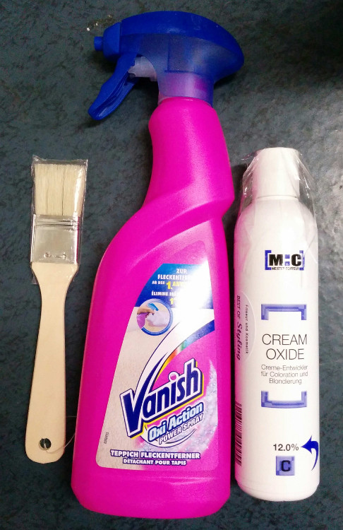

Hmm interesting I think I might give Denture tablets a try. First I'll try kbdfr's method:
workshop-f7/g80-5000-mod-questions-t109 ... etrobright
ohaimark
Kingpin
20 Apr 2016, 19:04
kbdfr's method is a pretty standard one that's known to give good results, so long as you prevent drying.
I think the methods I'm testing won't suffer from drying issues -- I'm hoping to use full liquid immersion instead of paint on creams.
20 Apr 2016, 19:08
Yeah the paint on method is more work vs. immersion. I'm definitely using the good old sunlight.
20 Apr 2016, 19:28
A problem I had encountered with immersion is that you have to prevent things from floating.
The method I use has another big advantage: it is cheap, real cheap :mrgreen:
By the way, IIRC, matt3o has a slightly different method where he mixes the oxi stuff and the peroxide cream.
20 Apr 2016, 19:35
I got the tools ready kbdfr! Waiting for Mr. Sunshine now.
