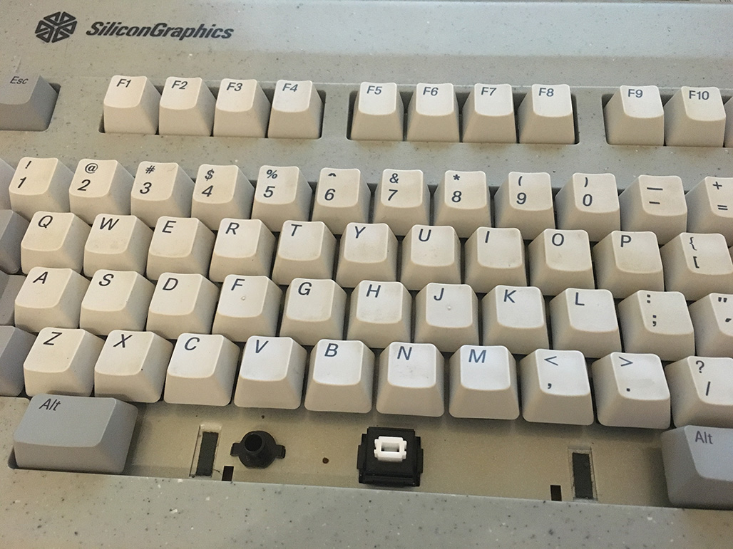

In todays score I got an not-working SGI Granite 9500900 for cheap. It also misses a space bar...

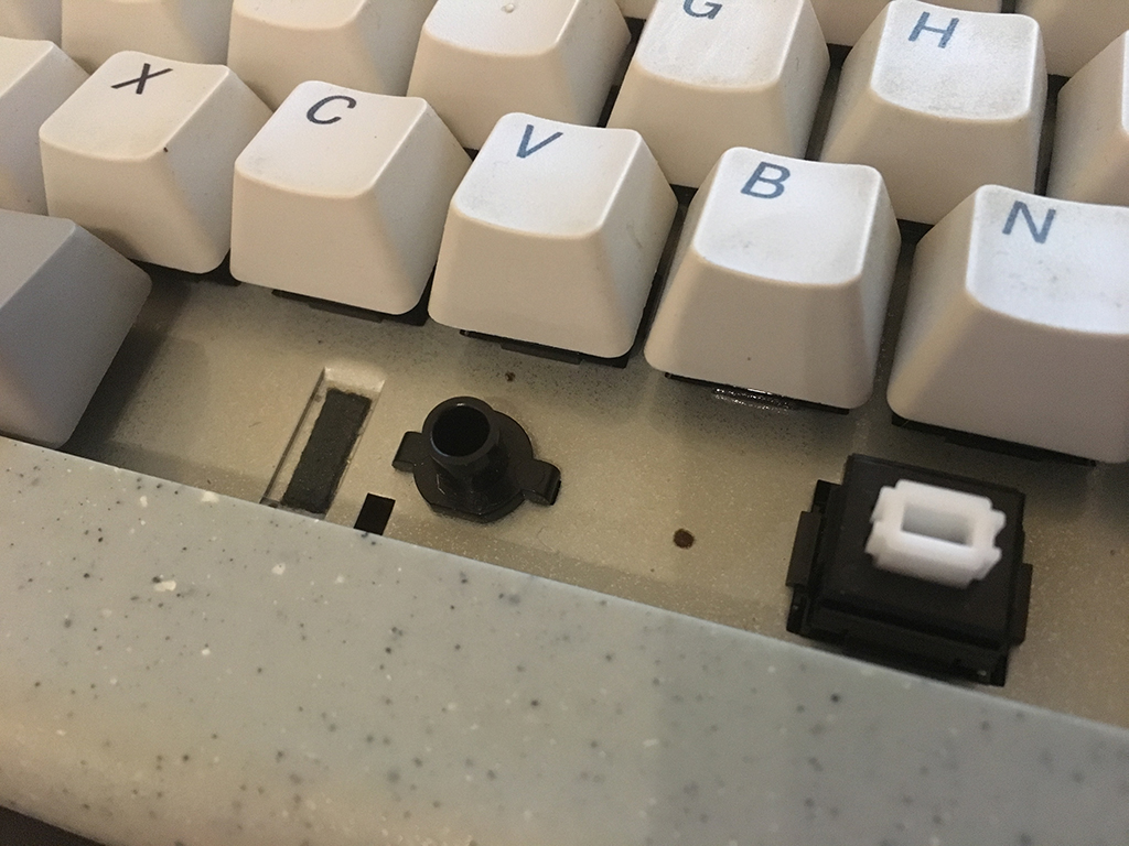

I did try space bar from other ALPS board I have, but it even length is the same stabilizer mount is quite different on SGI.
And I wasn't able to find any information on it... Also looks like Im missing a spring or some other part?
Any help or advice will be greatly appreciated.

I think a focus spacebar would work?

nice catch......wouldn't a spacebar from any dell at101/102 (not -w models though) be a fit?

Looking at this pic
I would say it fits, since modifiers end at same position compared to alphas. They are basically the same keyboard (but the keycaps indeed are different, at least in material and legends). The stabiliser in my Dell AT101w is the same as in the SGI above, so if there is no OG SGI spacebar to be found, Dell non-w ones are worth a shot.

Really any Focus FK-2001/Northgate OmniKey/AT-101 spacebar should work. Luckily it's a common spacebar style (for Alps SKCL/SKCM at least)

Anyway, a space bar from ALMOST any 7u Alps board SHOULD work. I've used a Focus FK-2001 space bar with no issue, but you will have to snip one of the two stabilizer pegs used on those bars. Snip the right one as the AT101 and SGI Granite use only a peg on the left. The original Alps-made bars had detachable pegs, but it doesn't matter much.
Some keyboards come with Cherry-like cruciform stabilization. That will not work, obviously. Most 7u Alps boards should be fine.
I can guarantee that an Acer 6011, and Focus FK-2001 space bar will work. I'd go for the FK2001 as it's pretty cheap and easy to find.
The only other Alps made 7u space bars with the detachable pegs are far and few between, and they all tend to go with relatively expensive boards.
Also, if you do not have the wire for stabilization, you can bend it yourself. I forget the diameter needed though. :? It's very similar to the size of a #1 sized paper clip.
