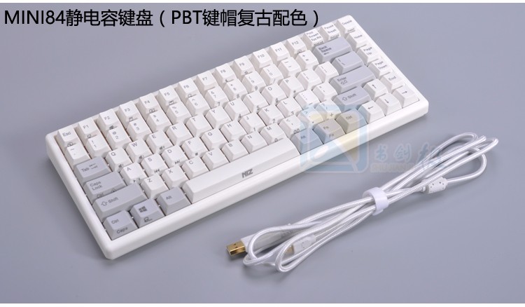

Hello guys. It's an overly lengthy review with lots of pictures in poor lighting!
A couple months ago I purchased a Plum 84 35g electrostatic capacitive keyboard frommech greenhand's Aliexpress store. I have been quite pleased by it.
A bit on the reason for purchasing a Plum 84 keyboard. I liked the layout, I am a big fan of ultra lightweight tactile switches, and I wanted to try a Topre clone keyboard. With the combination of the layout and lightweight switches, I decided to purchase a Plum 84.
But after using the Plum 84 for a couple months, my curiosity grew to compare the keyboard to a genuine Topre keyboard. So I purchased a used Realforce 86U for that purpose. I also wanted to try out 30g Topre switches, as I am considering a uniform 30g Realforce keyboard.
Plum 84 35g (photo courtesy of mech greenhand)

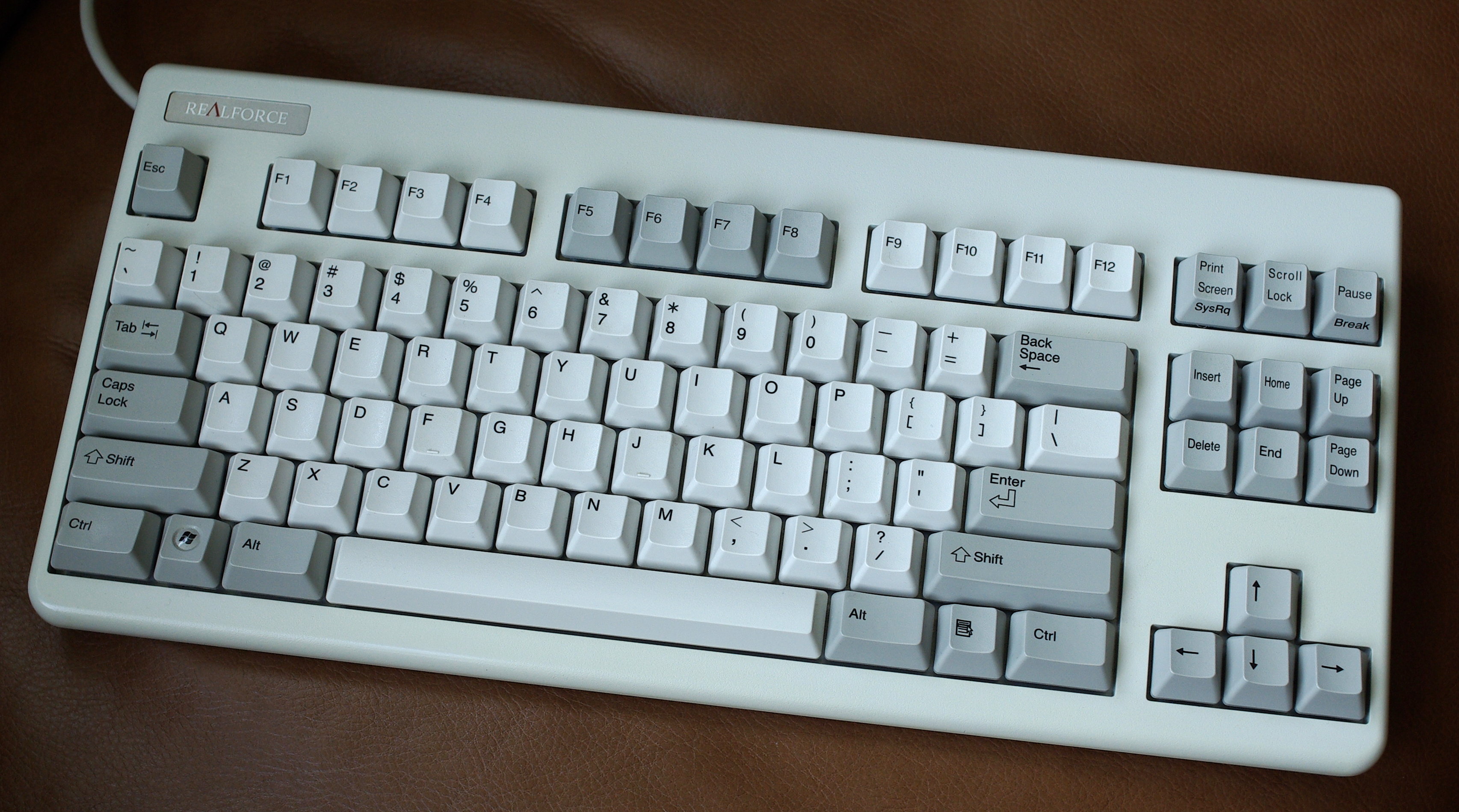

Realforce 86U variable force (photo courtesy of seebart)
First Impressions
Plum 84:
Not bad for $100. This is not a premium product, but certainly has some worthwhile features. More than I expected.
Realforce 86U:
Okay, now I fully understand the hype. The quality and refinement are immediately noticeable when I started typing, no break-in period or adjustment required. Probably one of the highest quality off-the-shelf keyboard I have tried. Well done.

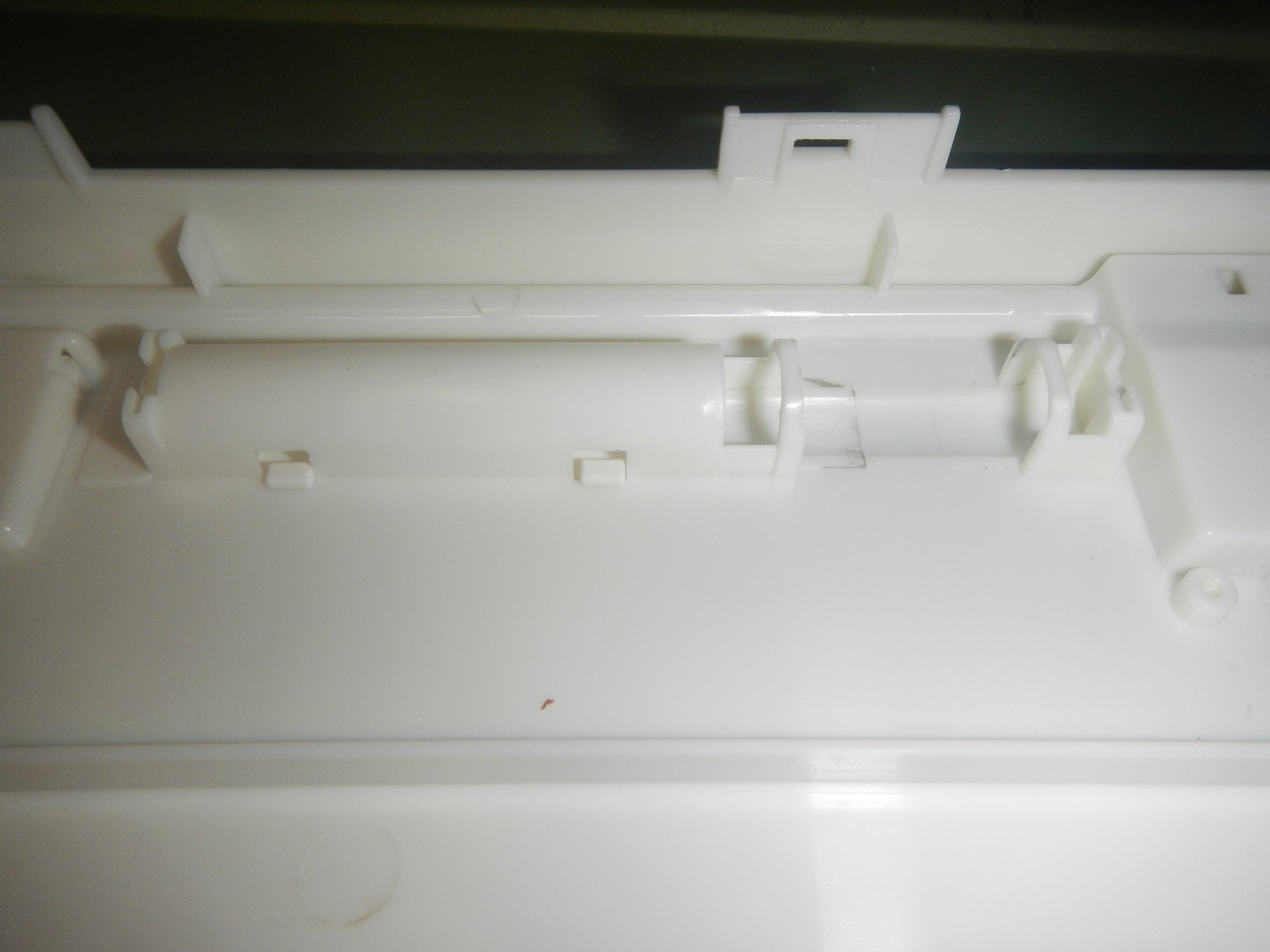

Plum 84: The case is a slightly glossy white with kinda thick rounded edges. Nothing special, maybe a little outdated. The case snaps together without any screws, which makes you think it would be easier to take apart and look inside. Not really. When one end is loosened, it is very difficult to loosen the clips on the other end. I had to insert some old shopping cards to hold open clips while I loosened the other clips.
Also, the case seems like it was designed for a different keyboard, perhaps the Noppoo Choc Mini wireless, because there is a compartment for batteries on the back, but no wireless hardware attached to that compartment. I assume this decision reduced manufacturing costs.
The cable is braided and detachable with cable routing options. For a $100 keyboard, the cable is decent. No complaint there.
Realforce 86U: I think most of us reading this know that Realforce keyboards have sturdy, reliable, and tasteful cases that are easy to take apart. Yes, some the edges are a little excessive, but you barely notice the large edges when the keyboard is sitting on your desk. The cable, while not detachable, is thick and sturdy, and the case has routing options as well.

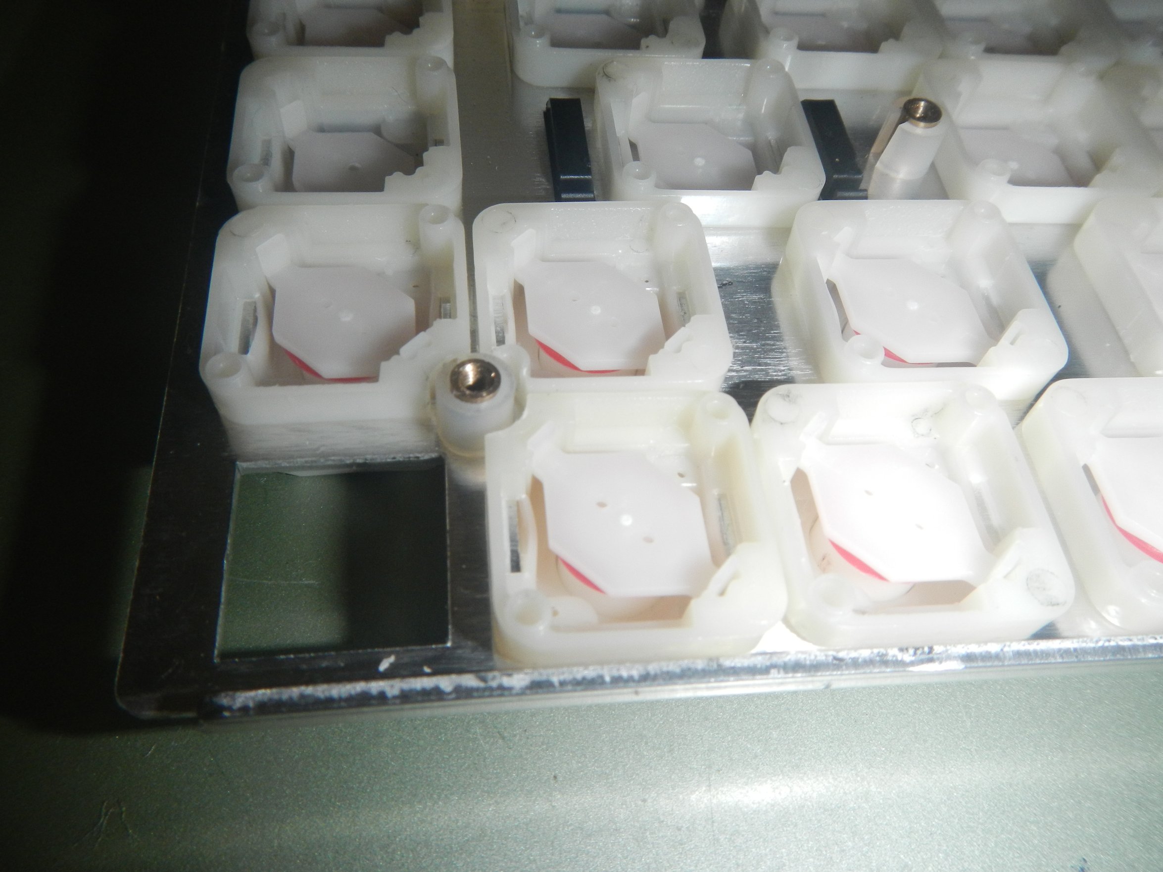

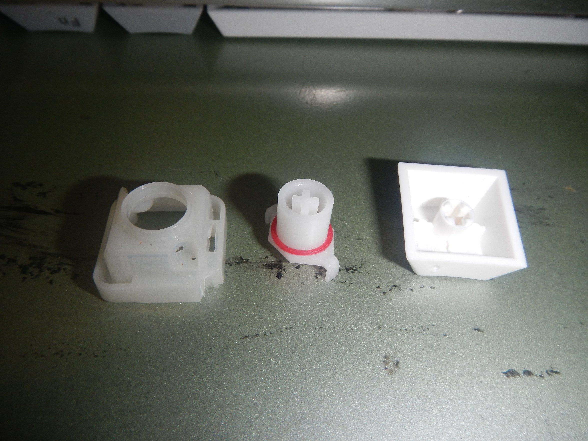

Switch Housing and Sliders
Plum 84: The housing and slider for the switches are a translucent white that seem a little less robust than genuine Topre. The slider is MX compatible, so you can use all the fancy keycaps that you have lying around. Next, to make room LEDs and screws, it appears the manufacturer cut out a corner of the switch housing rather than made a cutout in the plate. Finally, silencing bands are included in the switch housing. When typing next to unsilenced Realforce, the Plum 84 is noticeably quieter.
Realforce 86U: While not MX compatible the slider and housing seem more robust than on the Plum 84. I wonder if the two keyboards use different types of plastic on these parts. Also, to accomodate LEDs, Topre uses a slightly modified housing and makes a cut in the plate rather than slicing off a corner of the switch housing. Nice touch.
Verdict: Realforce 86U, just seems like higher quality for these particular parts.

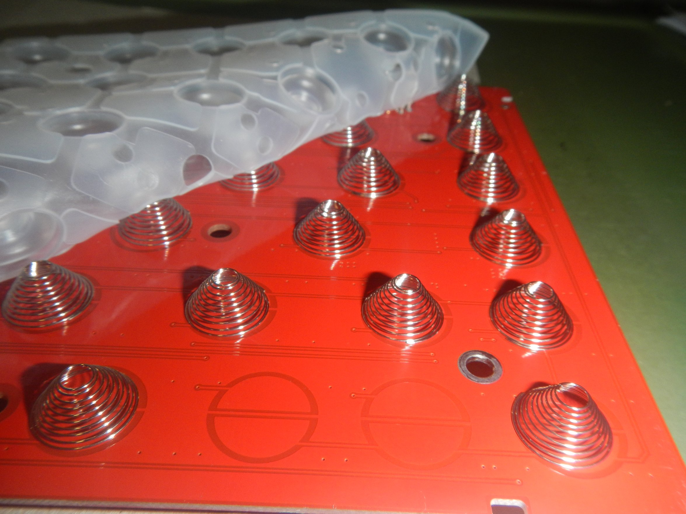

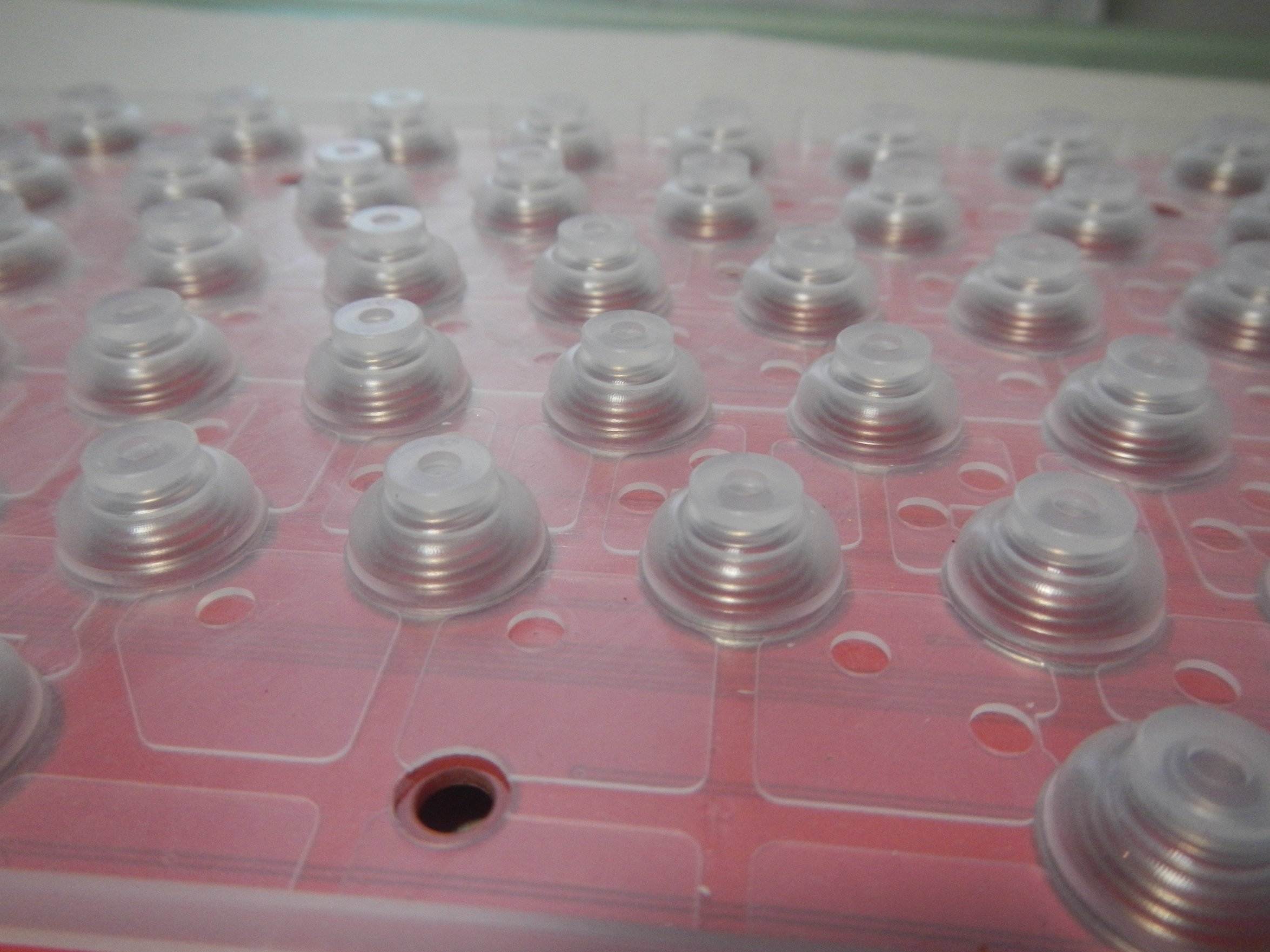

Internal Bits

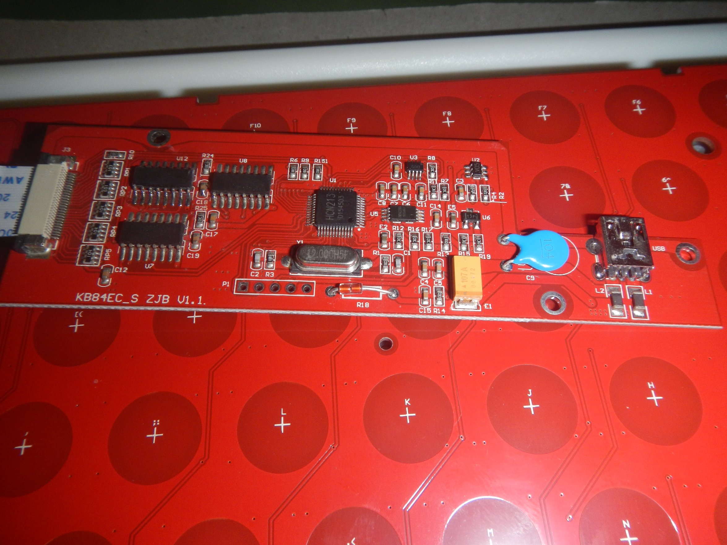

Plum 84: The plate on the Plum 84 is of a medium thickness and decent enough. I think it is stainless steel, which can be obnoxious if you prefer a plate with a more subtle finish. The soldering on the PCB and controller are clean, no complaints there. The PCB is connected to the controller with a ribbon cable, so I wonder if the controller can be replaced.
The rubber dome mat reveals some of the shortcuts taken in this keyboard. The LEDs are poked straight through the mat, without a hole for the whole LED as we see on genuine Topre keyboards, so I would have to tear the mat or cut out a larger hole to remove the mat completely.
Realforce 86U: The stock plate and PCB are perhaps the thickest I have ever seen in an off-the-shelf keyboard, seemingly hefty enough to stop a home intruder. While I did not pry apart the plate and PCB to view the dome mat, I have seen plenty of pictures and am aware of the quality. The plate and mat both have cuts for the LEDs. Topre does not take any short cuts with the internals of this keyboard.
Verdict: Realforce 86U, obviously.
