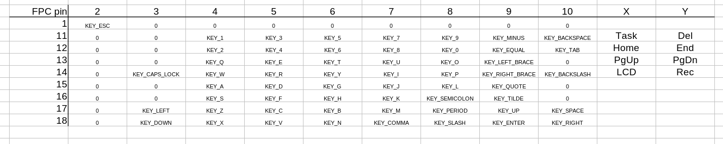

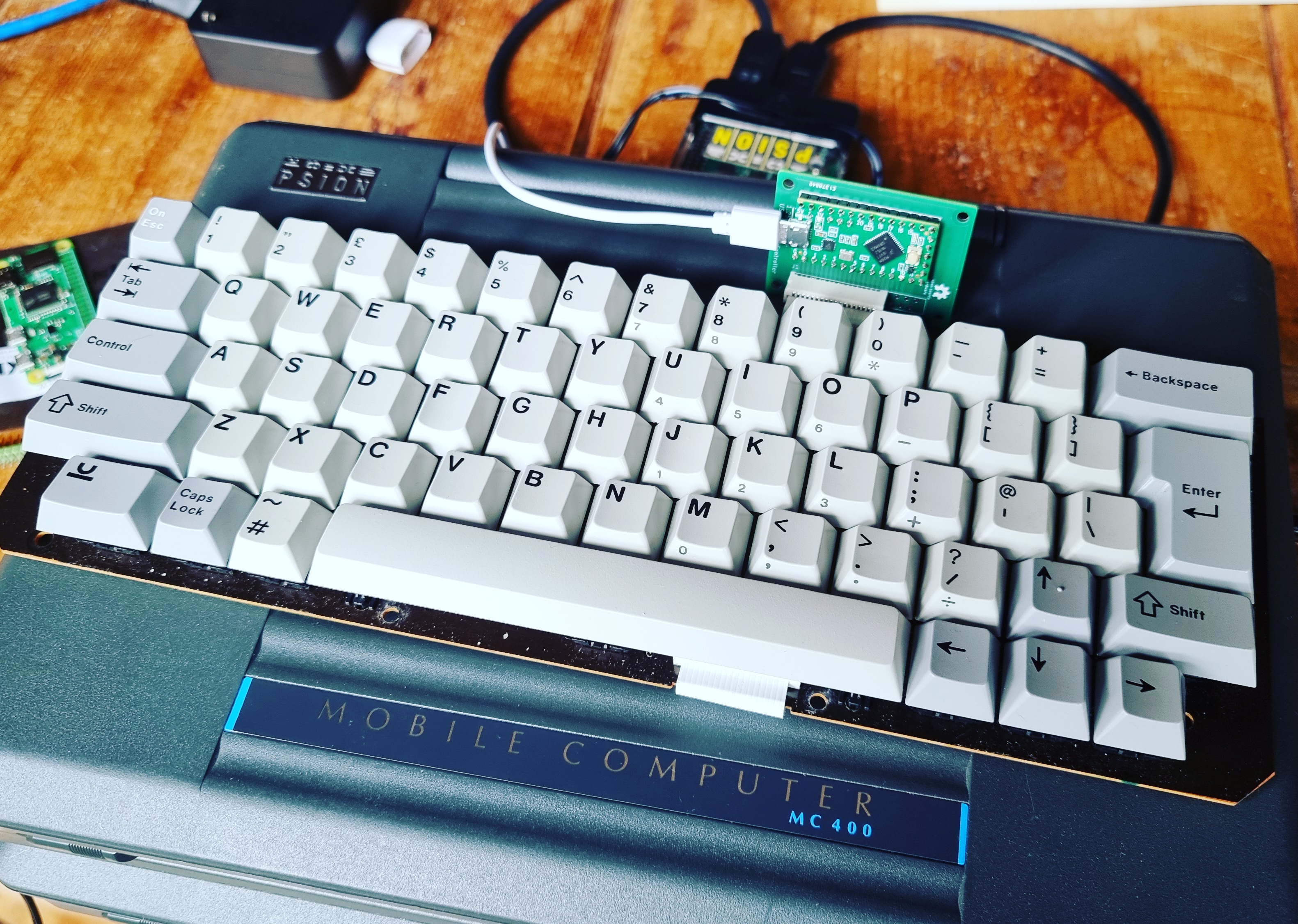

just managed to get a USB-MC400 keyboard working thanks to Frank Adams' Teensyduino sketch - the MC400 keyboard matrix is unique in that the On/Esc key has 2 dedicated lines (i.e. not shared with any other keys) to ASIC2 which is the custom chip that handles power on/off for the MC. Of the 18 pins in the connector it's a 9x9 matrix but with 2 pins dedicated to On/Esc it's 8x8 for the other 60 keys. This confused Marcel's python so I had to hack it around considerably to get it working!
video of USB-MC400 keyboard in action!
(Apologies, slow one-handed typing whilst holding the phone in the other hand :-) )
My Teensy LC sketch is here.
Full keyboard matrix, including the case-mounted supplementary buttons (Task/Del/Home/End/PgUp/PgDn/LCD/Rec):
Screenshot from 2022-06-19 21-50-17.png (38.96 KiB) Viewed 2920 times
