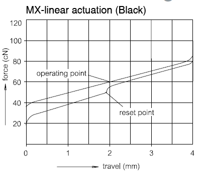

to not drive this any further
i'm not even sure if cherry clear springs are linear or progressive so i wrote "afaik" to anyone with further knowledge to come in.
BUT not all cylindrical springs are linear (ask your car) and hence argumenting with Hook's law wich only applies to linear springs.. and posting random stuff you dont understand to...
btw. the only thing your seem to be able to proof is Goodwin's Law ;)

You sir, are an ignorant slut.
This is a keyboard forum, not a car forum.
Hooke's Law FTW!
In case you're ESL here's a graph.
cherry black force diagram.jpg (56.13 KiB) Viewed 3359 times

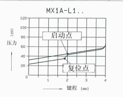

In case you're Asian ESL here's a graph.
Cherry Red Force Diagram.jpg (63.71 KiB) Viewed 3359 times

And to be ABSOLUTELY sure the force diagram for these is determined by the springs I did this simple test.
1. Removed Cherry Spring from a Cherry MX Red
2. Put a key on it. It ALMOST depresses - the key weighs .8g (see Geekhack Key Ref Wiki for details)
3. Add a 1 Yen coin that weighs 1.00g on top (see Geekhack for details, coin pics are BANNED)
4. The switch collapses. Indicating at MOST 2g of force is added by the switch leaves.
