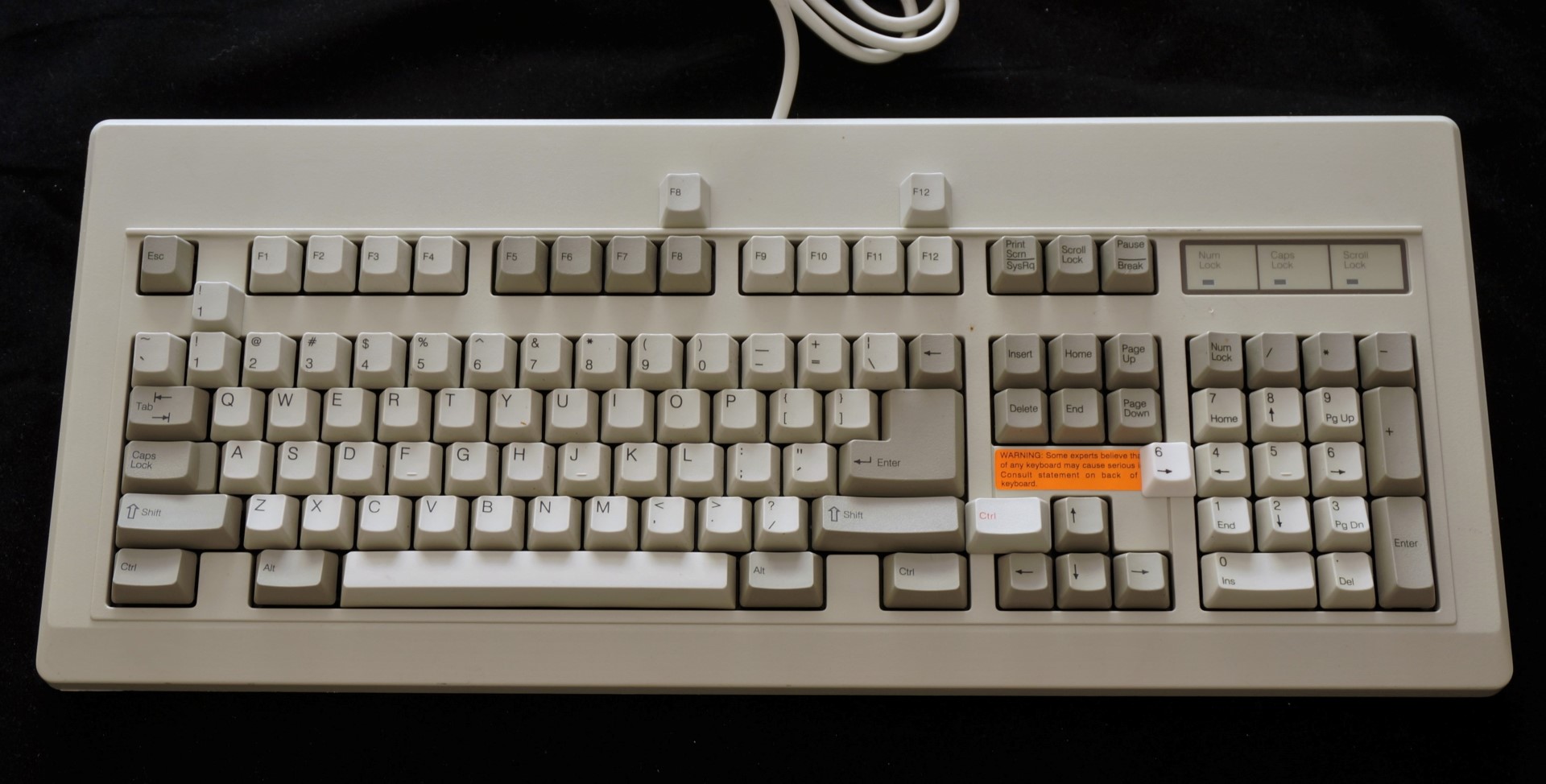

The all grey/gray cap 4th gen NMB's are interesting. They are most often found with Everex branding. While they key caps appear to be a grey similar to the mods on a standard NMB/Hi-Tek keyboard, they are in fact the same color as the alphas from the standard board. The reason they look darker is that the case is a lighter beige than the standard case and that the white keys in the number pad are extremely white.
Here is a photo comparing the cap colors. The keyboard is the standard 4th gen. The loose caps are from one of the "grey" boards. Notice how the "1" and "F12" are the same,maybe even lighter, color as the standard board. The "Ctrl" is much lighter than the standard mods. The numpad "6" is starkly white when compared to numpad keys from the standard board.

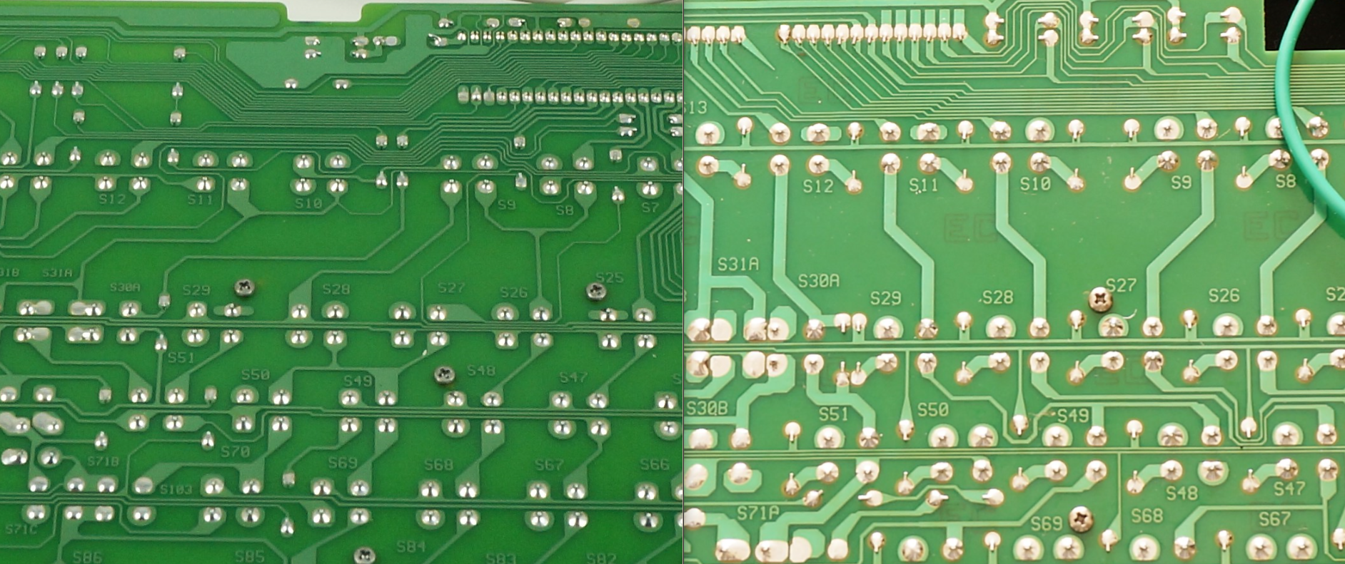

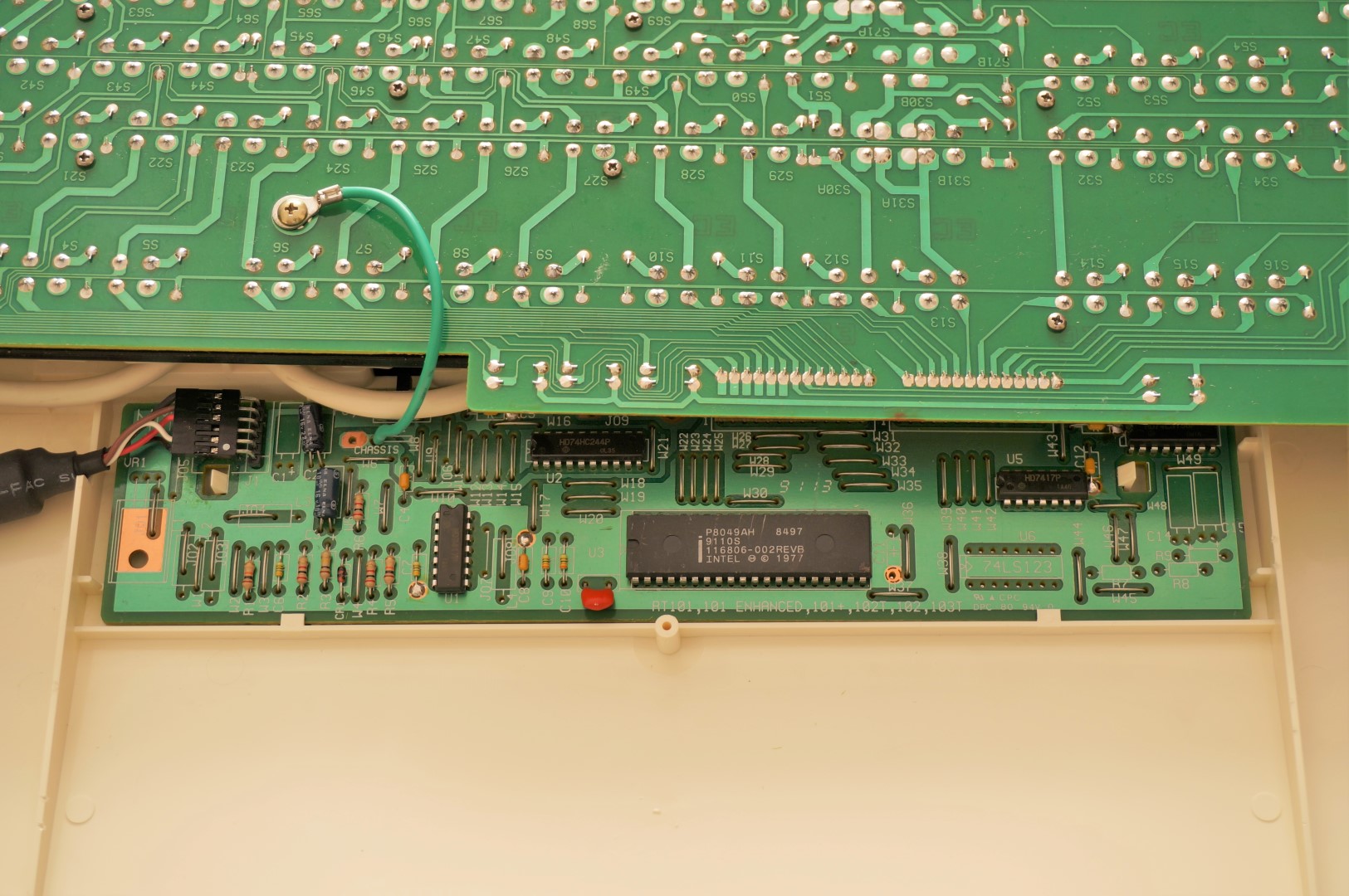

As far as NKRO (i.e. diode equipped); while the later (4th gen) boards do not commonly have diodes, almost all of the 3rd gen boards did. 4th gen boards with diodes have the controller on a daughterboard as shown below;
Everex-116920-001-PCB-3 (Large).JPG (416.82 KiB) Viewed 6907 times
Here is comparison of the a pcb with the diodes and one without.

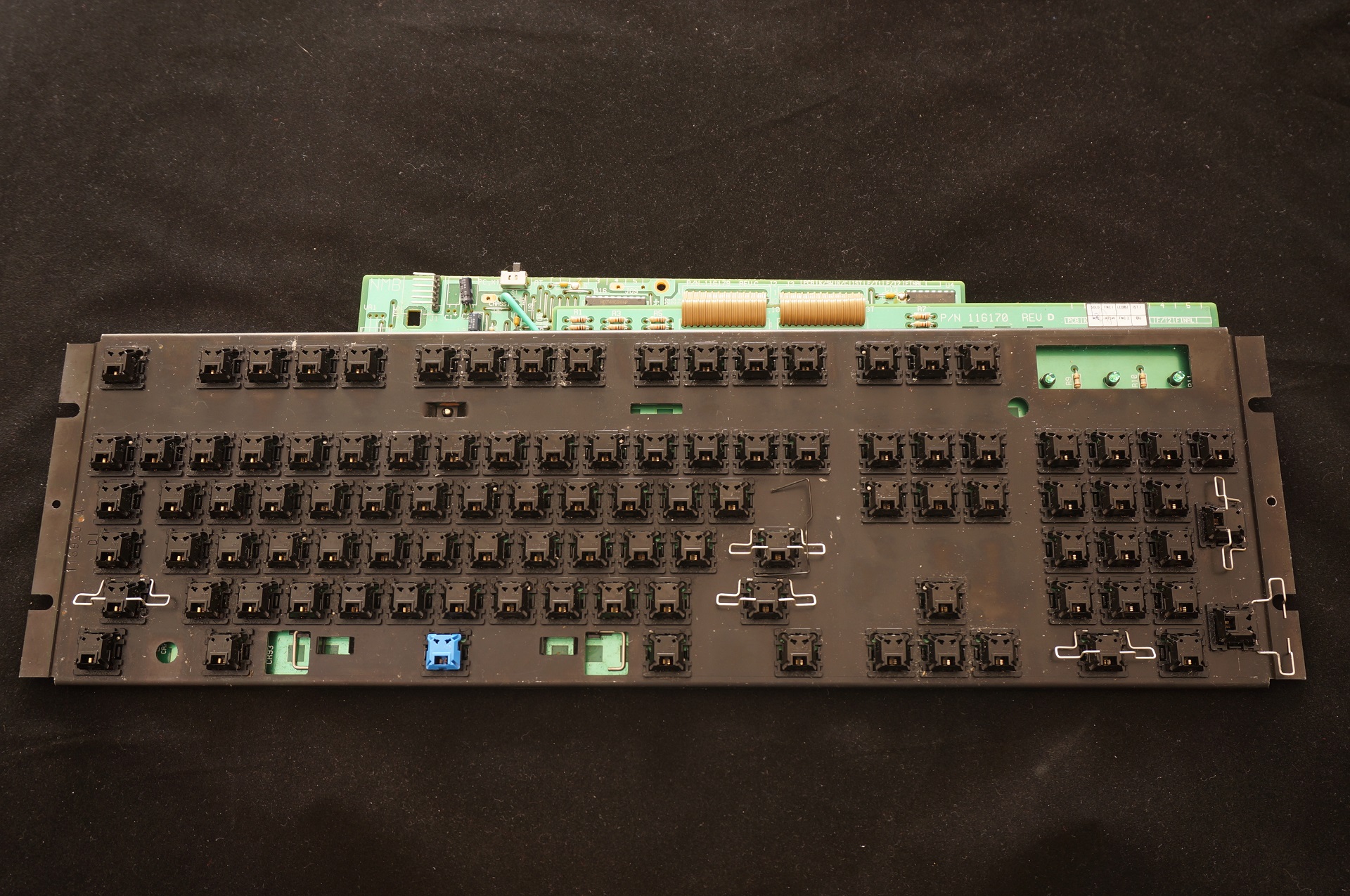

I popped all the caps off and had a look at the springs (thanks Chyros and terrycherry for tips on how to do it without ruining the switches - it's actually not that bad). I blasted the insides with canned air, and then.. ran out of canned air. So be warned: it looks a bit filthy :P
Switches galore, funnily enough none of the grime is visible under the office lamps o_O
