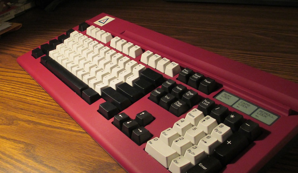

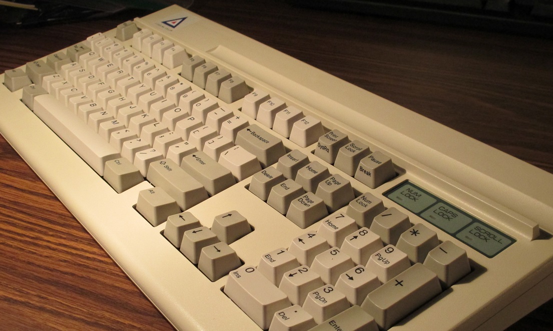

Recently, I was fortunate in being able to find two Leading Edge DC-3014 blue Alps keyboards in rapid succession.
For the time being at least, I have decided to keep one of them (I'll call it DC-3014A) in a nearly stock state -- the only modifications I've made is to install an internal converter and micro-USB panel-mount connector. I also quieted the spacebar by swapping out the slider and click leaf on the spacebar switch with the corresponding components from a Matias Quiet switch.
The other one (dubbed DC-3014B) also has the internal converter and micro-USB connector along with a painted case and new keycaps (SGI Granite alphas; others from Matias and Tai-Hao). Its spacebar also has a transplanted slider and tactile leaf from a Matias Quiet switch, and the Matias spacebar has 0.5 mm urethane foam pads on the plate where contact is made with the stabilizer inserts.
Even before making these relatively minor modifications, I noticed that I had a preference for the sound and feel of DC-3014B. The differences were subtle, but noticeable. Now with the replaced keycaps, the differences are more apparent, and I definitely prefer typing on DC-3014B.
I've noticed differences in typing characteristics on other Alps boards of the same make and model as well. For example, I have two Northgate Omnikey 101 white Alps boards. Even with the same stock keycaps on each, the two boards have a noticeable difference in sound and a just-perceptible difference in feel.
One difference between the two Northgates that is readily apparent is in the sound from brushing fingertips horizontally along a row of keys -- one of the boards makes much more of a racket than the other. I thought that this difference might be due to the relative degree of wobble, but as far as I can tell, the wobble in the switches is the same between the two boards.

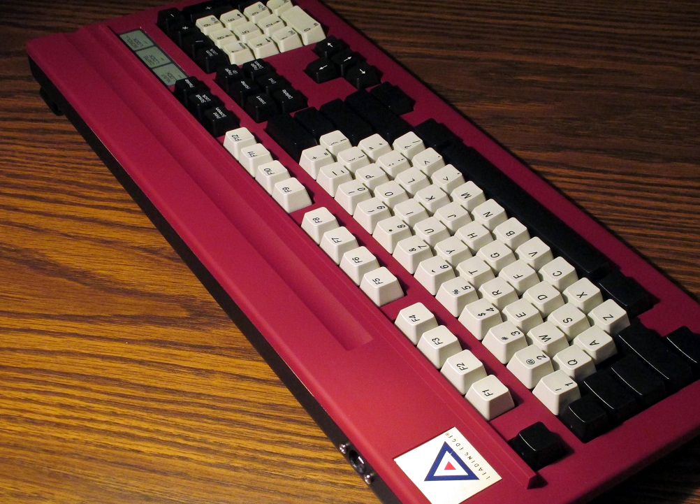

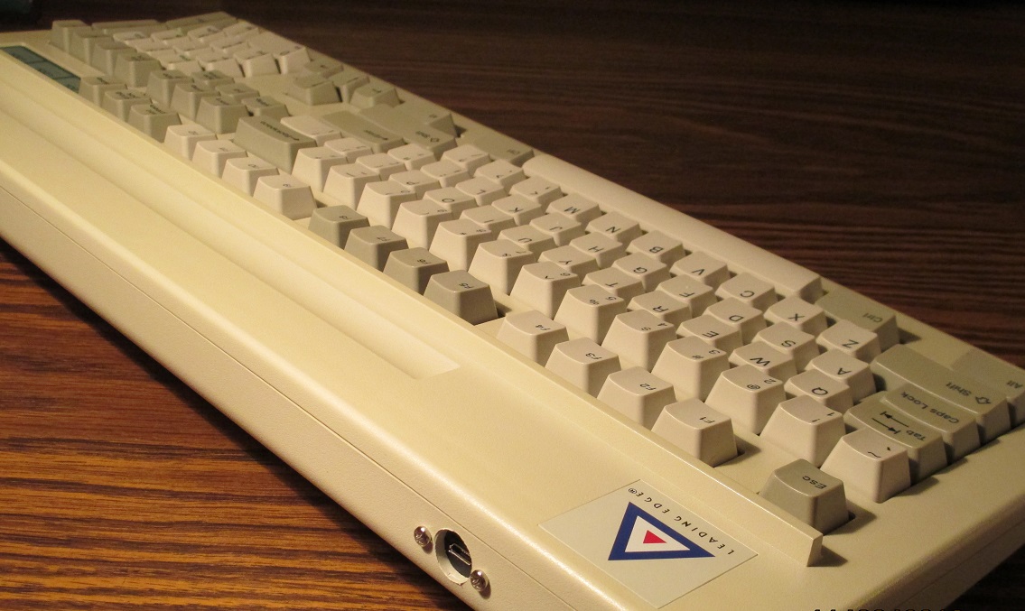

Please tell me the case is plasti-dipped. The 3014 is one of my favourite boards of all time (and one of the best looking), and I'd kill for a blue alps one. It makes me feel weird to see one modified like this. That being said, it did end up turning out nice. Could you post some pics of the conversion to micro USB? I'm curious :?:
Hypersphere
11 Oct 2016, 14:41
@chiptea: Yes, I anticipated drawing criticism for altering the case of a classic like the LE DC-3014, but I wanted to make the keyboard more visually appealing to me so that I would be inclined to use it more. However, I am lucky enough to have found two of these keyboards (one for the home office and one for work), and I am keeping one of them in a nearly original state (except for the panel-mount USB connector).
The USB conversion was extremely easy, thanks to Orihalcon's version of an internal Soarer's Converter for the LE DC-2014 and DC-3014. The header on the converter plugs into the header pins on the keyboard's PCB. On the other side of the converter there is a micro-USB connector. To provide strain relief and a micro-USB panel-mount connector, I connected the converter to a 1-ft. micro-USB panel mount extension cable from DataPro:
http://www.datapro.net/products/usb-mic ... e-m-f.html
The DataPro site has a downloadable PDF with cutout dimensions. In addition to drilling three holes in the back of the case for the panel-mount connector, I made cuts through some of the interior supports inside the bottom of the case to provide routing for the cable. You could use a Dremel for the interior cuts, but I preferred to first drill a hole and then use a hand file to remove the arch above the hole, thus creating U-shaped openings for interior routing of the cable.
