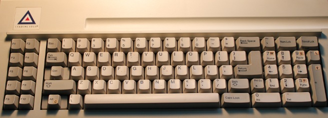

@u-ra: Thanks for confirming that you were motivated to do the top-mod because of the layout. Like you, I find BAE boards virtually unusable. However, ISO would not work for me, either. However, I am able to make a slim backwards-L work for me. Right now, I am typing on a Leading Edge DC-2014, and its modified-XT layout works fairly well, as it lends itself to HHKB-style remapping.
wiki/Leading_Edge_DC-2014
My remapping:
Backspace --> Backslash
Right Bracket --> Backspace
PrtSc --> Fn
Backslash --> Left Gui
CapsLock --> Right Gui
Fn+1 --> F1, etc.
Fn_Tab --> CapsLock
The slim vertical part of the Return plus the oversized Right Bracket makes this remapping possible. Also, Left Ctrl is already where I like it -- to the left of the "A" key.
Even so, the Return key is not as smooth as I would like. I tend to hit the Return on the left edge, and it wants to be struck farther to the right. If I were to use an ISO board, I would probably remap the key just to the left of Return as the Return key and remap Return as Backspace.
