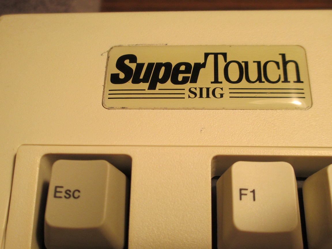

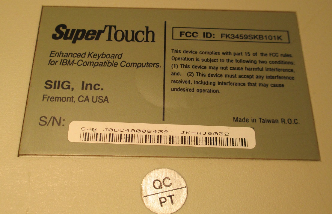

Does anyone here know what kind of printing was used on keycaps from a SIIG Supertouch KB101K with white Alps switches? The keycaps have a nice pumice-like texture. At first, I thought they might have been dye-sub PBT, but I did the acetone test on the inside of a cap, and this indicated ABS rather than PBT. However, the lettering looks like dye-sub to me. I don't have a camera with a macro lens, so I don't think my potato pics would be of much help.
The DT wiki refers to the SIIG Supertouch as a rebranded Chicony KB-5181, but it says that K101 is a SIIG Suntouch rather than a SIIG Supertouch and the SIIG Supertouch is model JK-WJ0032. However, mine is a SIIG Supertouch, but the model number is K101.
The switches look brand new, and they have "ALPS" on the top housing.

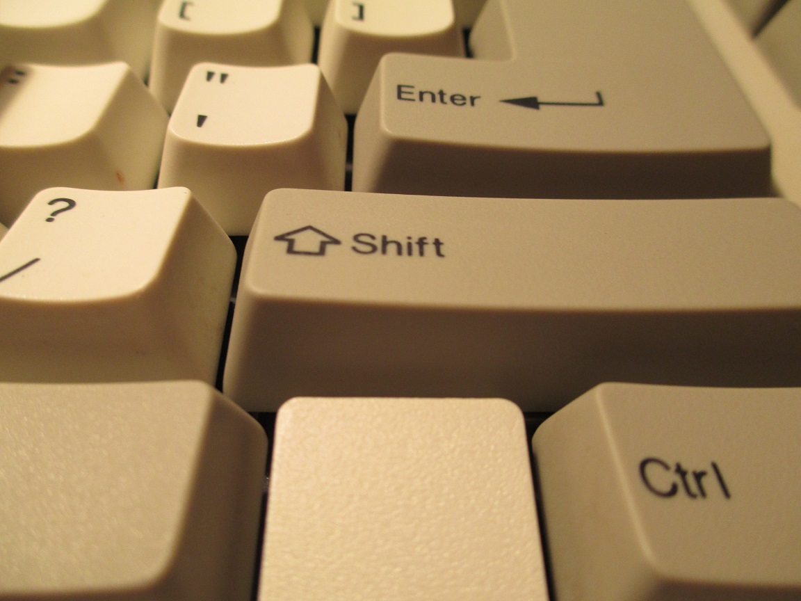

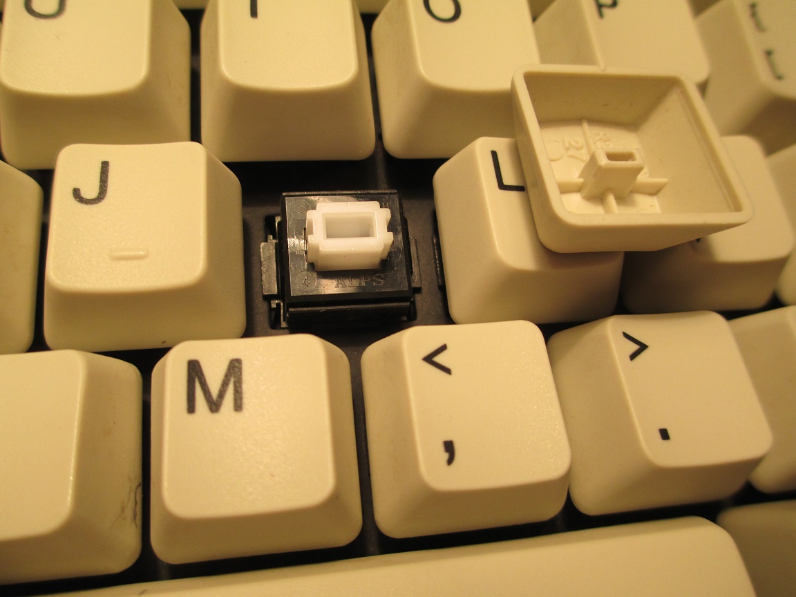

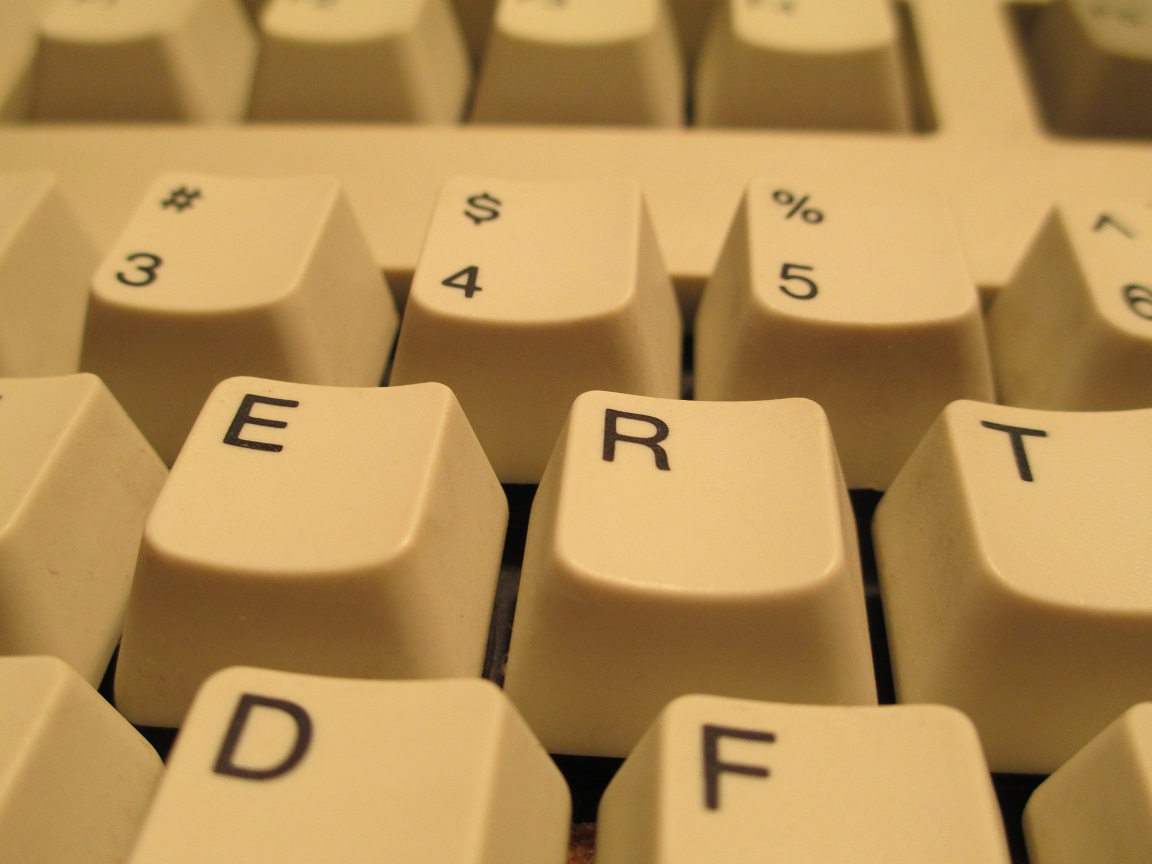

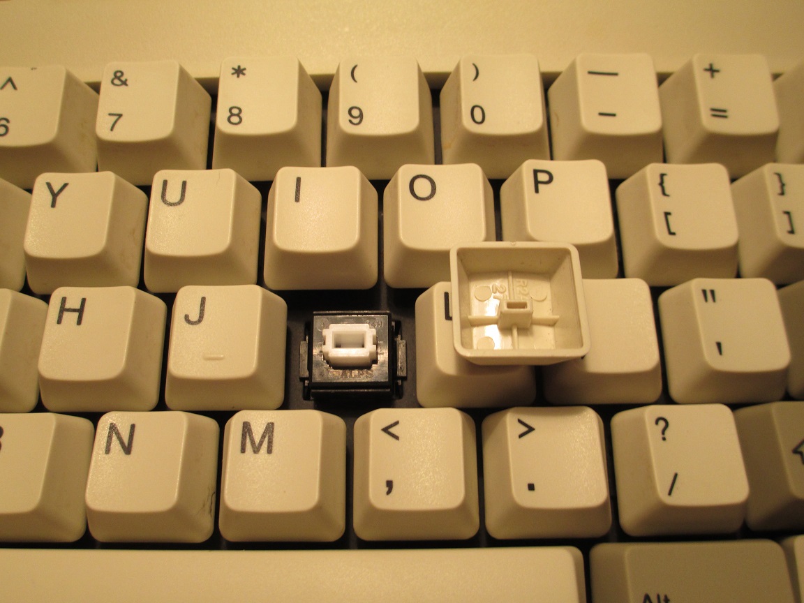

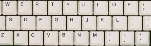

Here are some crude pics:
ohaimark
Kingpin
02 Nov 2016, 19:10
It looks like rimless pad printing to me. The edges are a wee bit sharp for dye sublimation.
The good news is that rimless pad printing is passably durable.

Rimless pad printing is extremely thin pad printing with durable ink. I'm guessing they bond it to the substrate using some particularly volatile chemical method. The whole "rimless" thing was termed because you can't feel the edges of the printing. Keycap texture helps hide any hints of edges that might exist.
There are only two ways to tell for sure: macro photography or cutting. The old logo Dell surprises me a bit, but from what I understand the caps and keyboards went through a bunch of phases. Perhaps they produced rimless pad printed keycaps for a limited amount of time during a transition between manufacturers (or something).
Other options include: an ABS dye sublimation process or the use of an acetone-positive plastic compound that could withstand the heat of standard dye sublimation.
I don't think it's Acer style -- the contrast on the legends is too good.

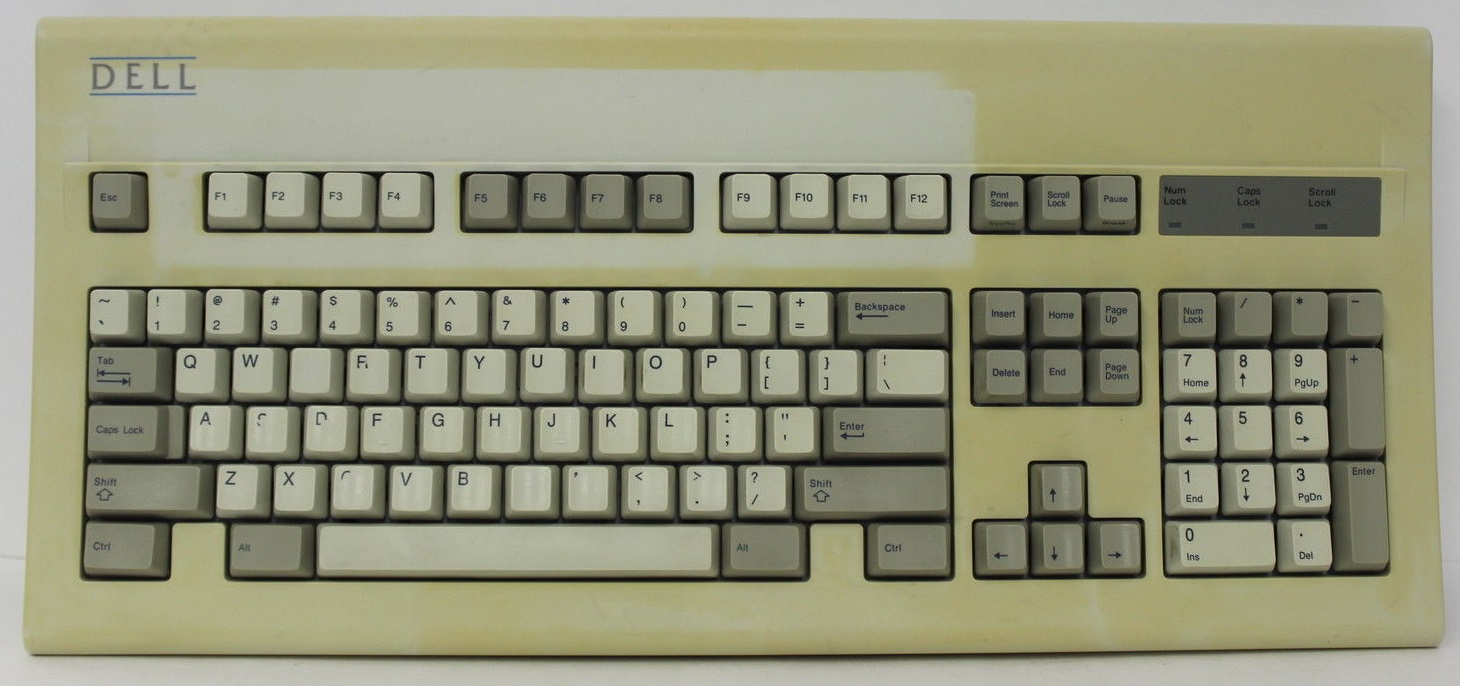

My Old Logo Dell AT101 set is from a model with S/N GYUM97SK. The caps are so nice that I put them on my refurbished Northgate Omnikey 101. I like the appearance of the Northgate doubleshots, but the Dell caps have a texture like fine pumice, similar to some of the Chinese PBT caps. However, the Dell caps dissolve in acetone. The test I use is to moisten a cotton swab with acetone and rub the swab on the inside of a cap. If the swab leaves permanent marks in the plastic, I assume it is ABS (or at least that it is not PBT).

Looks like the printing on at least some Old Logo Dell AT101 GYUM97SK boards is not all that durable:
http://www.ebay.com/itm/DELL-25109-PS-2 ... 2174694245
Maybe I should put the doubleshots back on the Northgate, although they are rather shiny. I've been tempted to use an SGI Granite set, but I can't get past the Italic font.

Yep, the verdict on your old Dell is rimless pad printing.

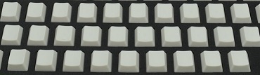

You can also sandblast them, it works very well. Someone here can do it for you.
Hypersphere
02 Nov 2016, 23:28
Sandblasting!
Before:
In process:
After:
Seriously, at first I thought you were in jest, but then I found that people really do sandblast their keycaps! Nevertheless, I think I will seek other solutions first. Interesting idea, though!
