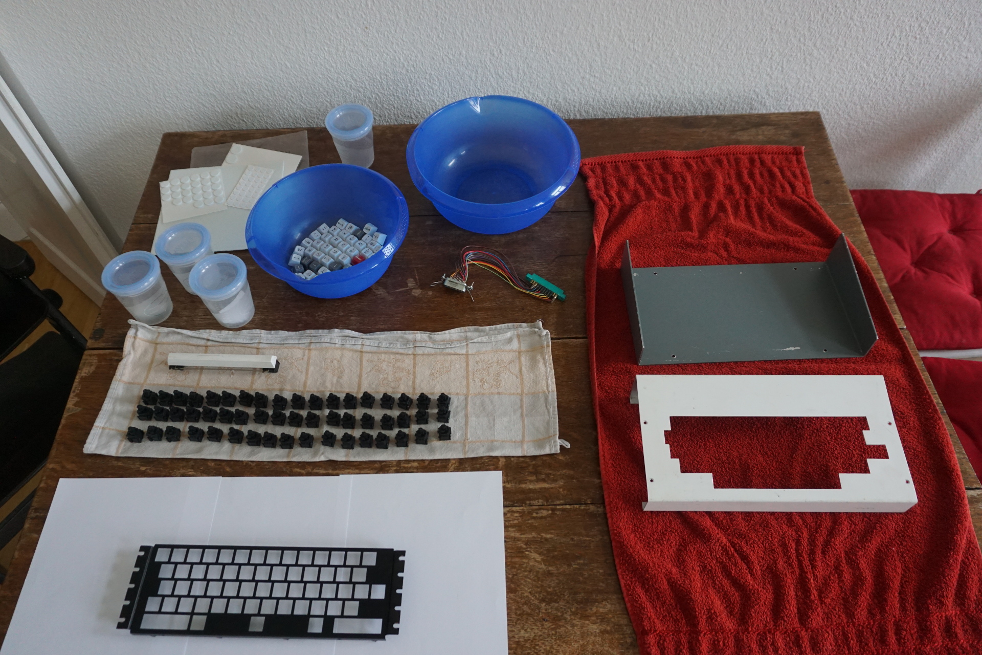

This "little" Board has been lying around in pieces for many month. Not any more ... :)
First lets have a look at all the material we can use. Lets hope we don't have anything left in the end.

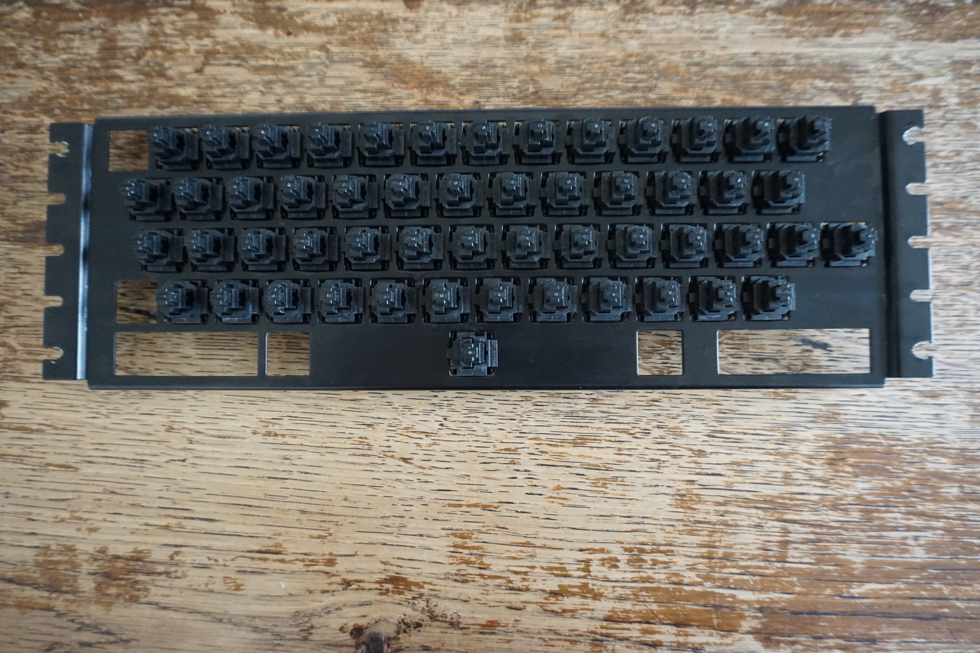

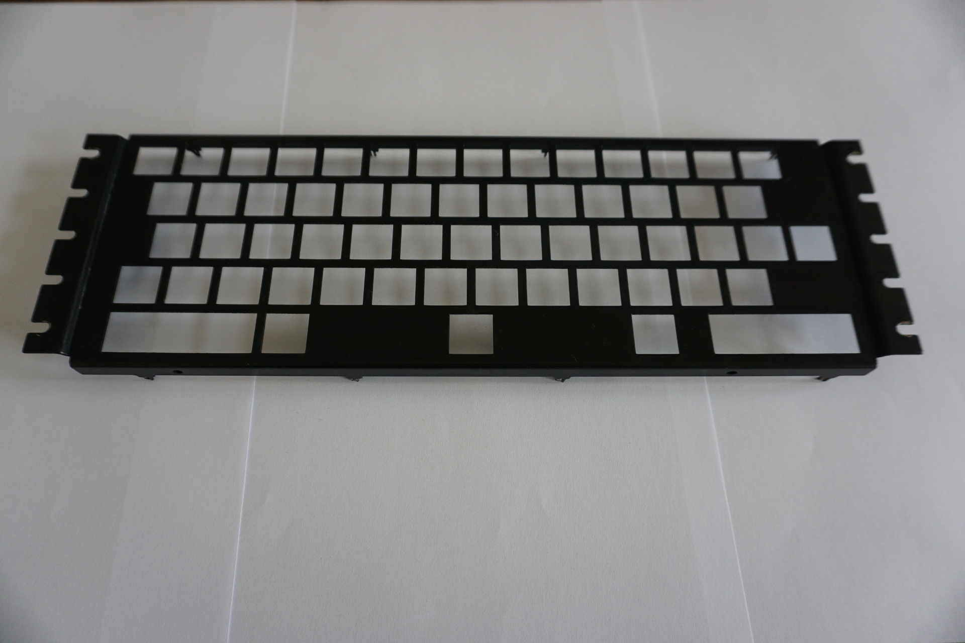

The first step is putting the switches back into the plate.
plate top.JPG (563.67 KiB) Viewed 4302 times
plate bottom.JPG (554.13 KiB) Viewed 4302 times

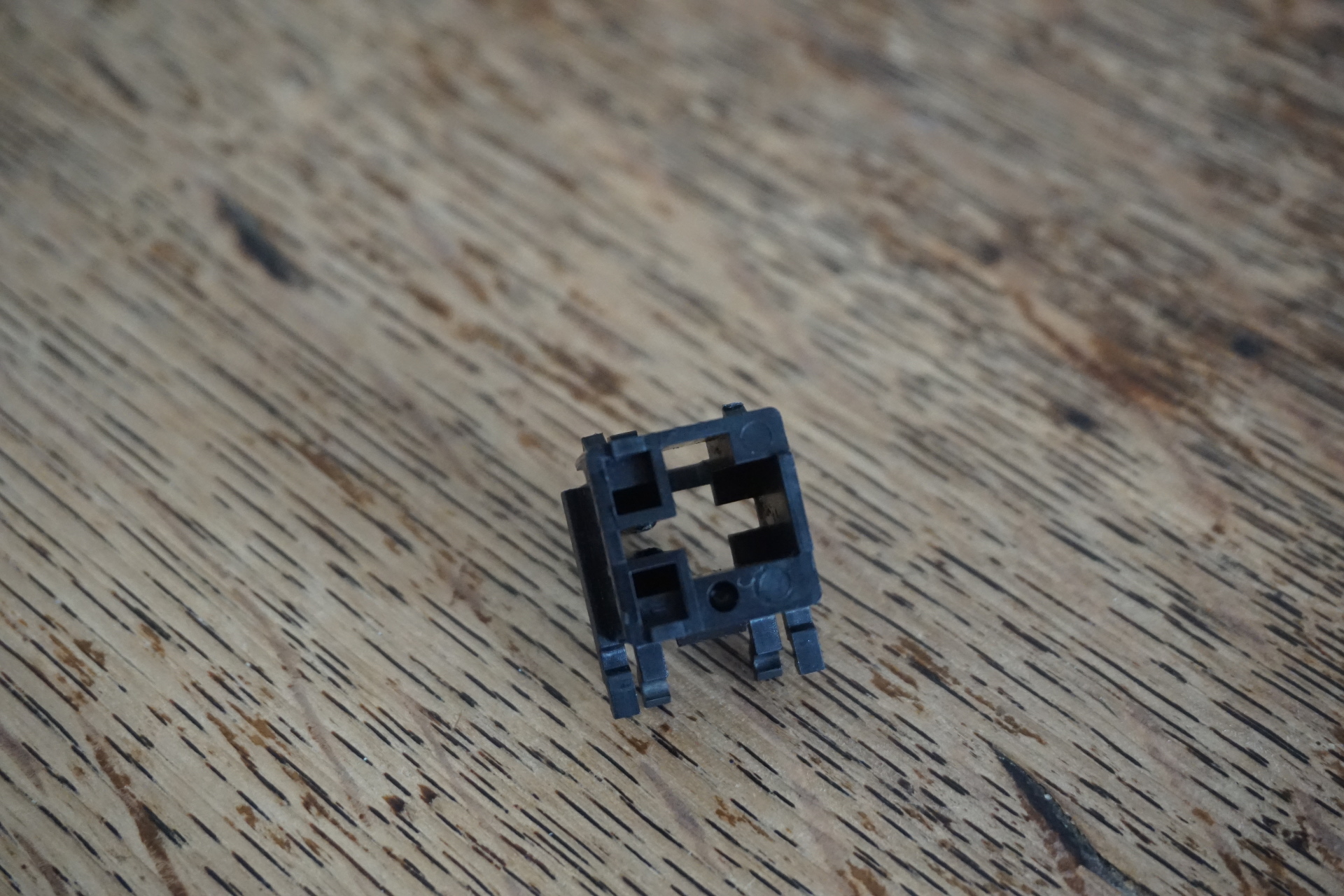

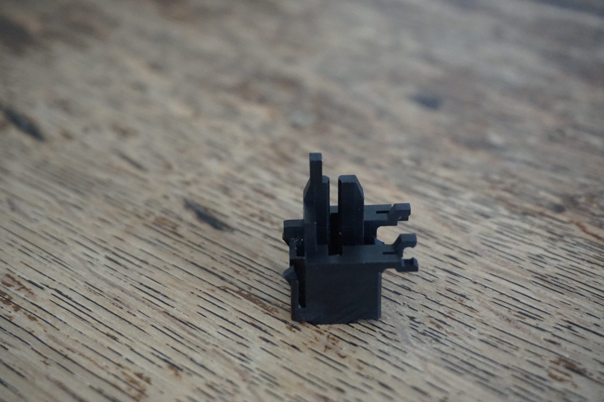

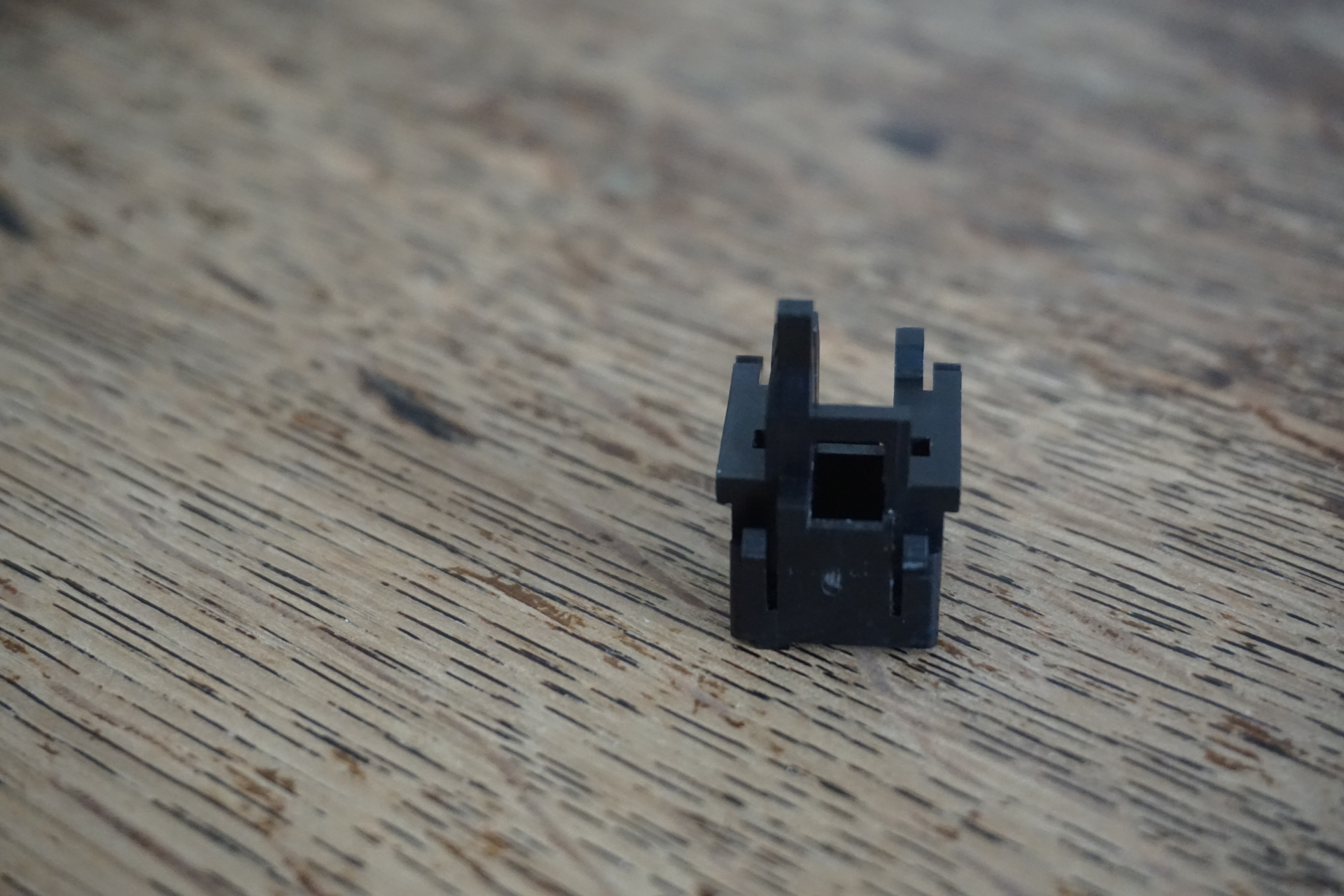

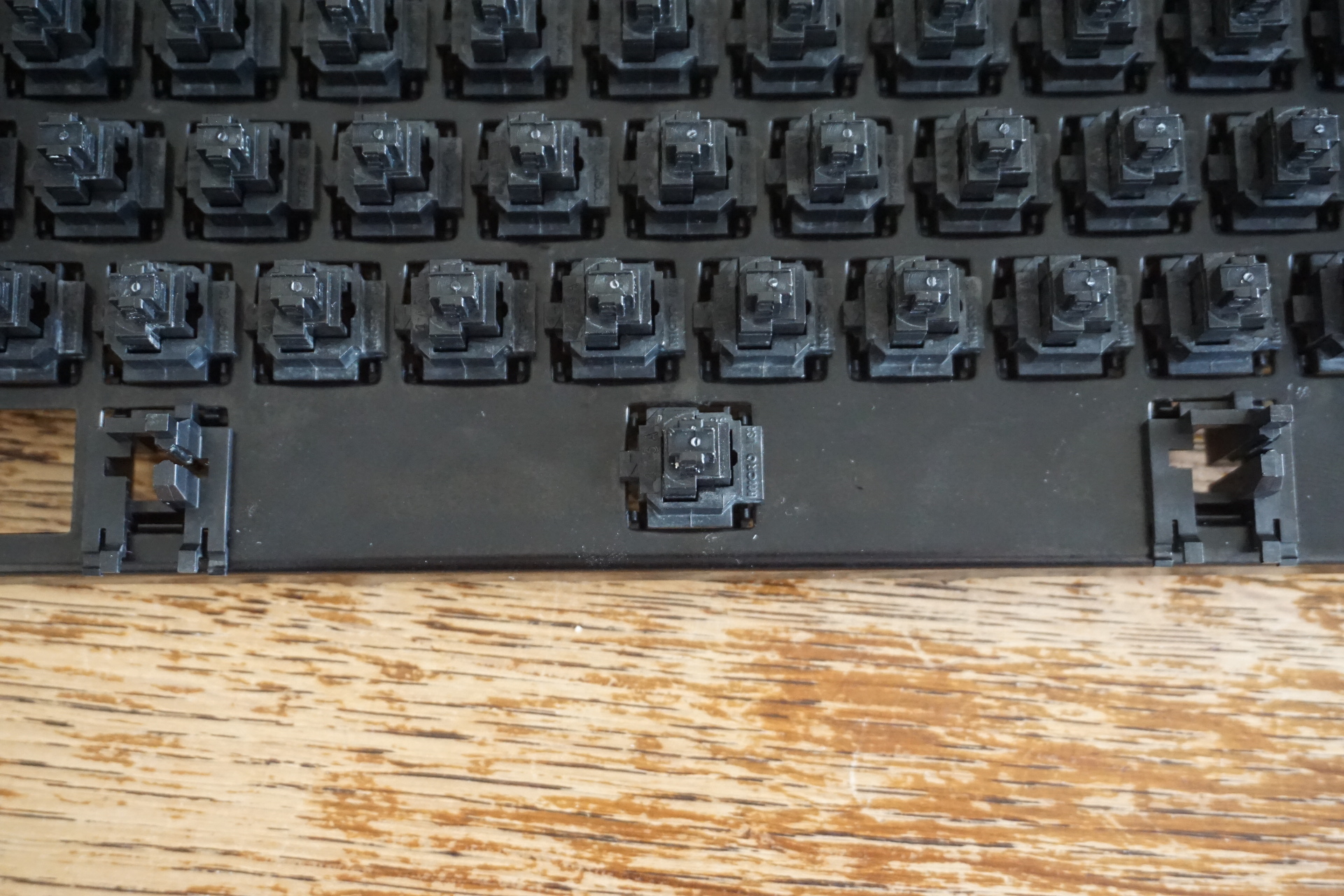

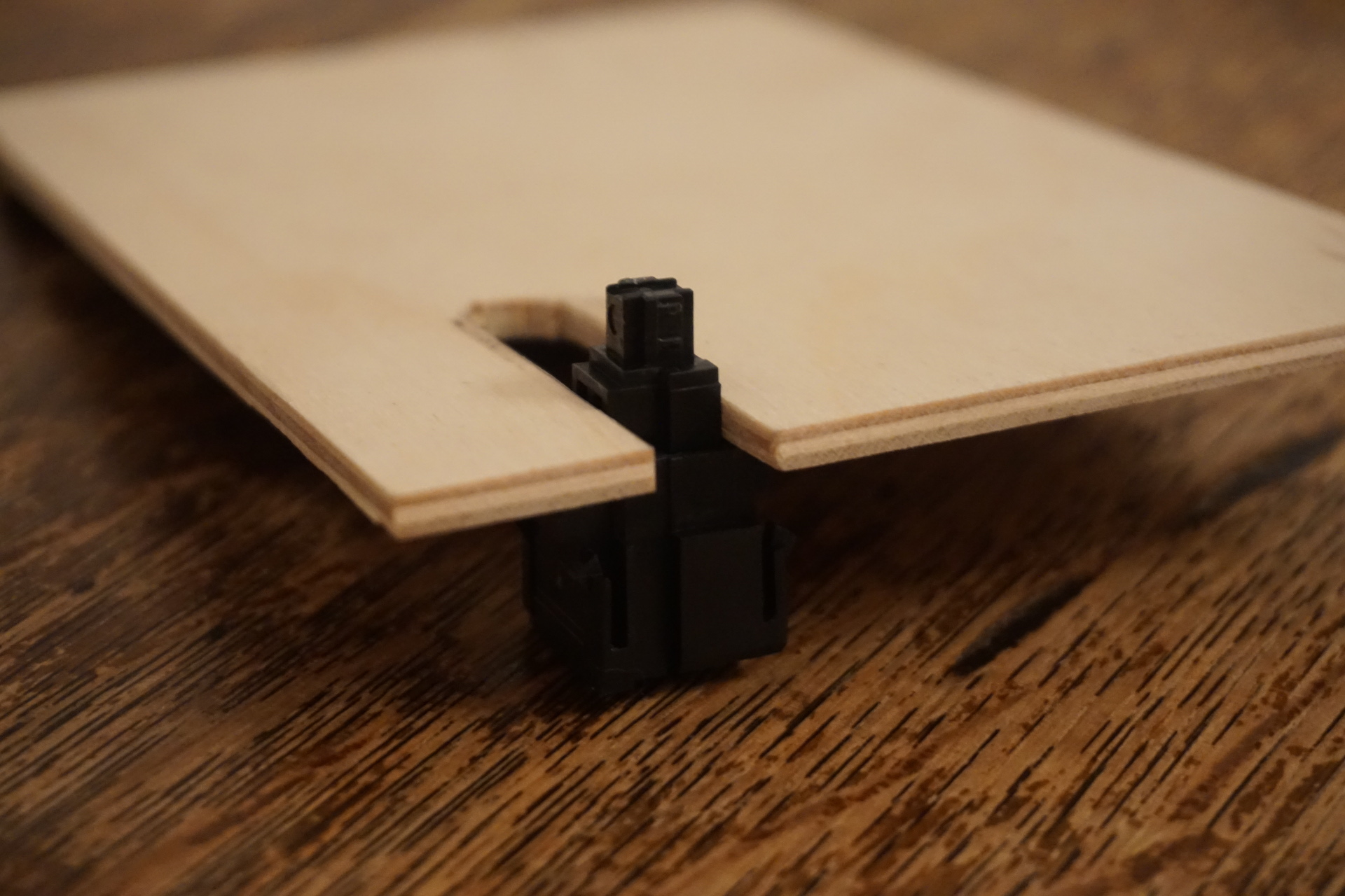

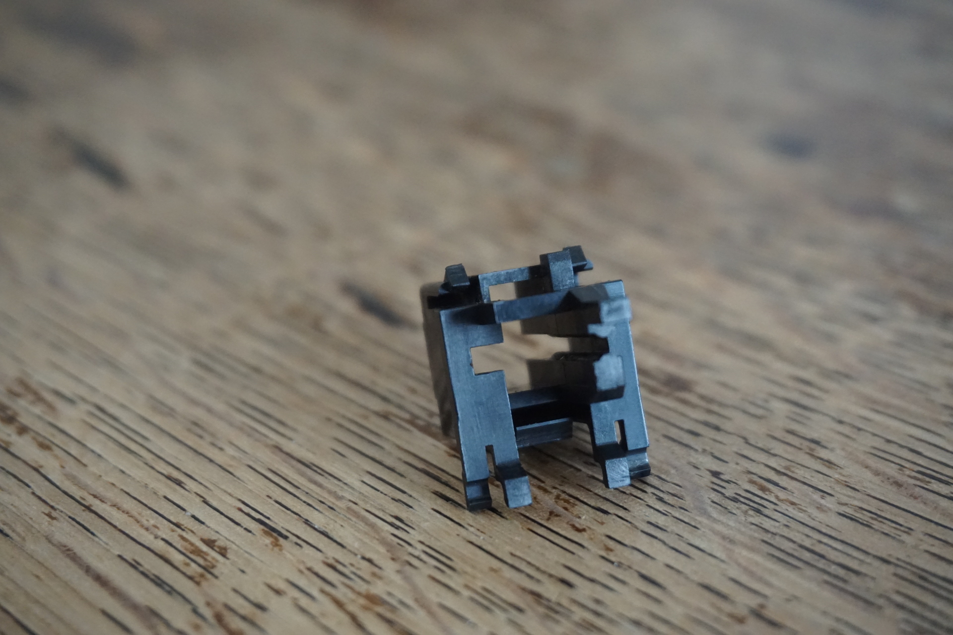

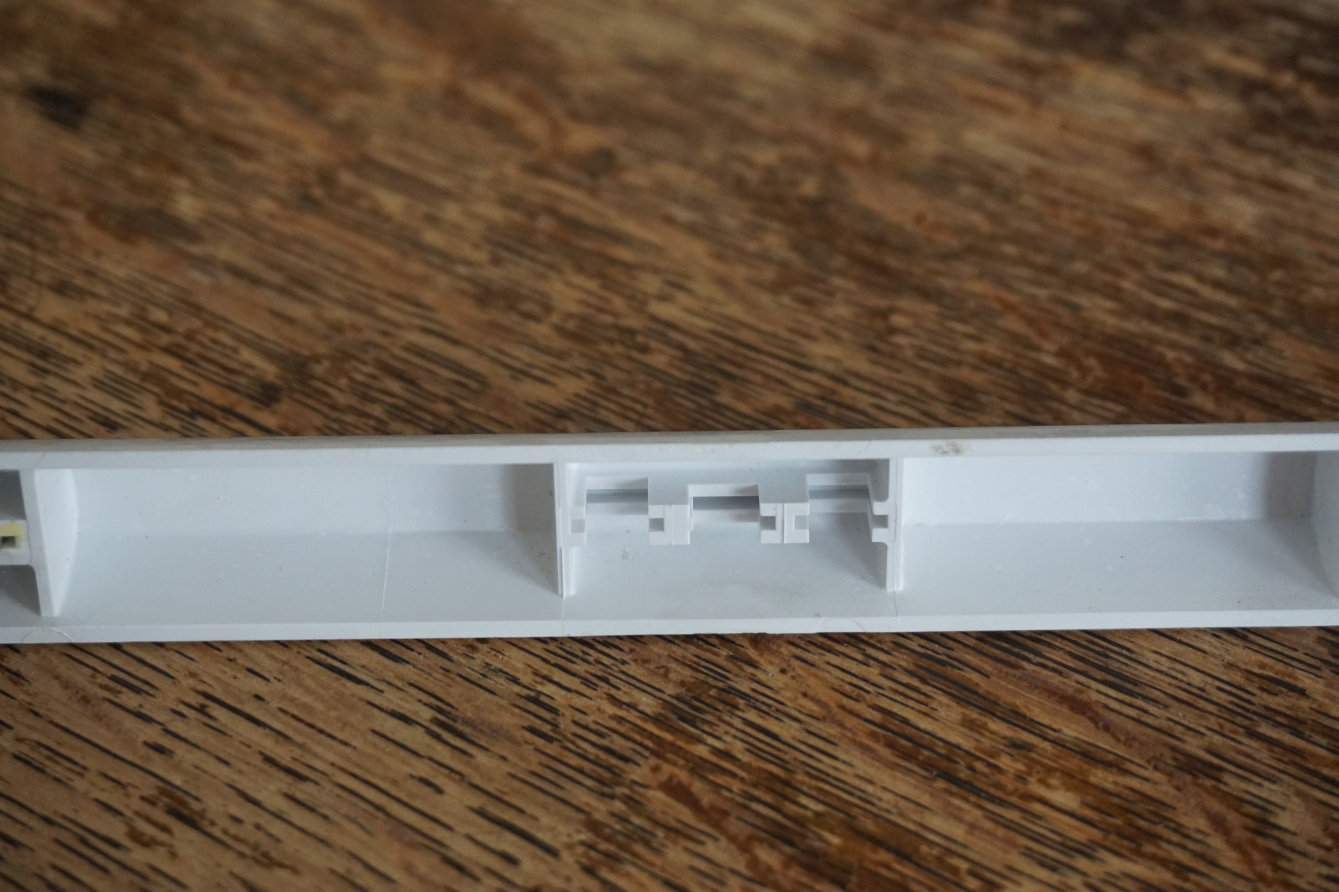

The most interesting part here is probably the stabilisers.
stab right.JPG (618.31 KiB) Viewed 4302 times
stab left.JPG (607.25 KiB) Viewed 4302 times
stab top.JPG (571.87 KiB) Viewed 4302 times
stab bottom.JPG (717.3 KiB) Viewed 4302 times
stab back.JPG (621.15 KiB) Viewed 4302 times

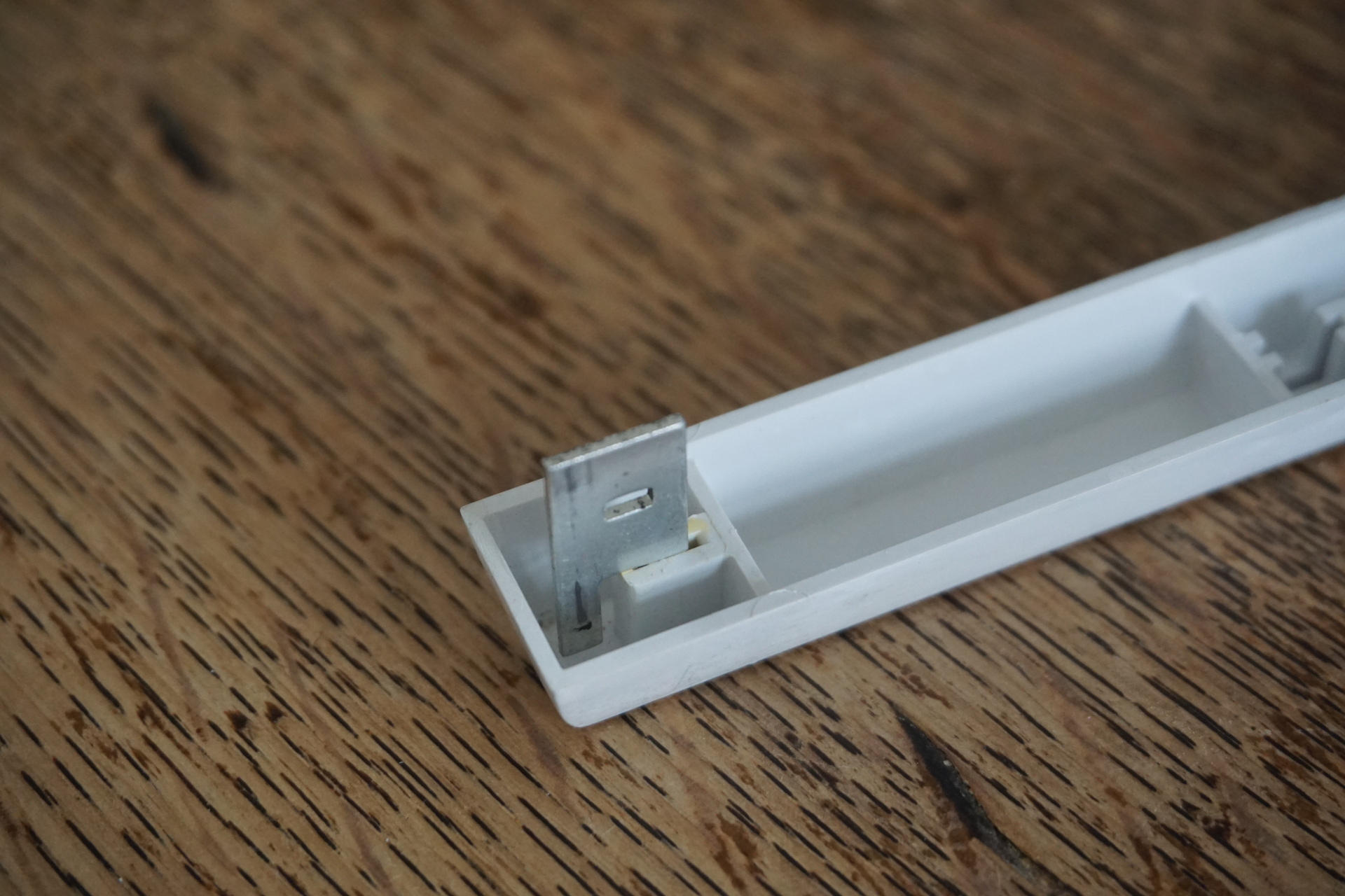

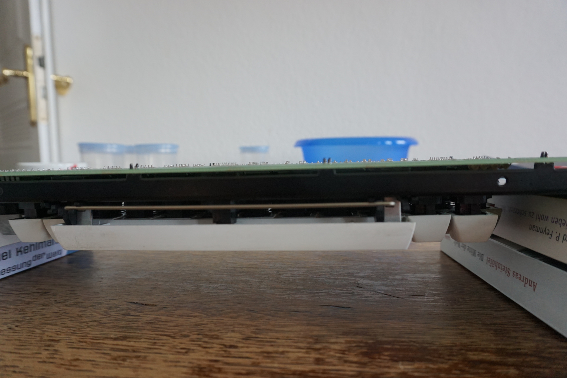

At first I was worried that I could not remember which way the spacebar should go on. Turns out it only fits one way, and if you do it wrong it will simply not move.
spacebar stab insert.JPG (638.9 KiB) Viewed 4302 times
spacebar stab mount.JPG (741.91 KiB) Viewed 4302 times
Pressed and released state of the stabiliser:
spacebar stab pressed.JPG (726.47 KiB) Viewed 4302 times
spacebar stab released.JPG (725.11 KiB) Viewed 4302 times

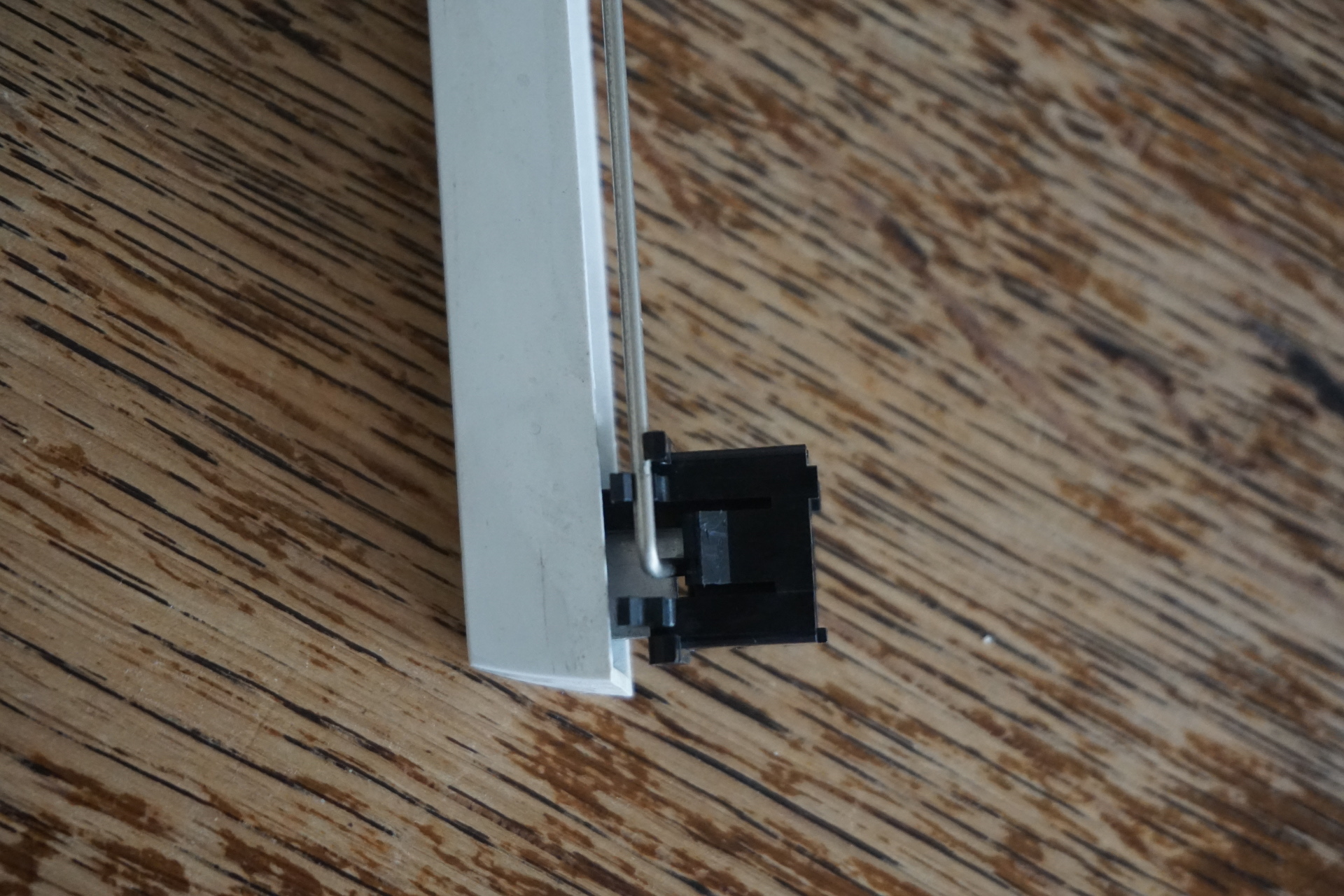

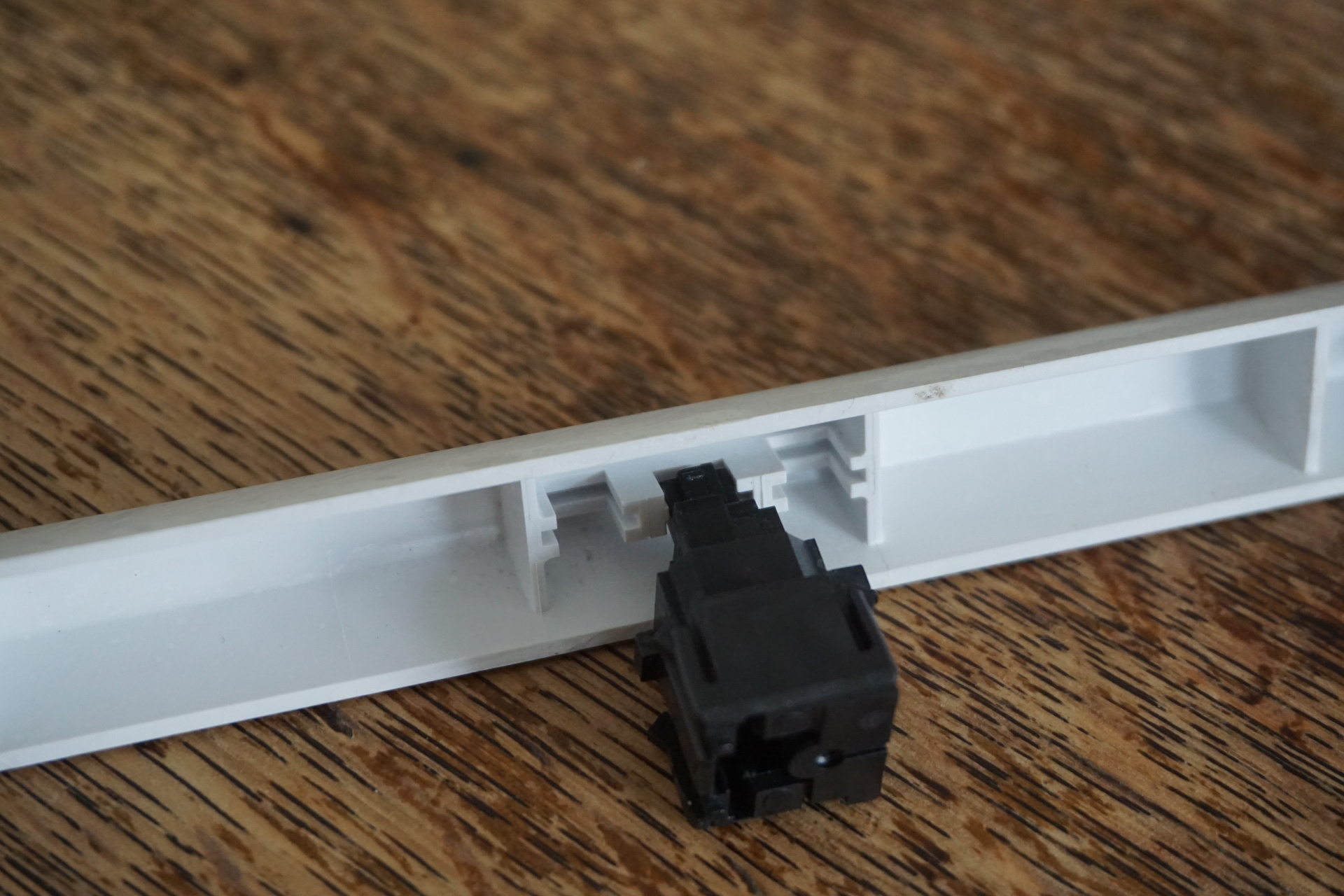

And here's some detail on the way the switch fits the spacebar. There was a tiny piece of felt there, which I forgot to put on again :(
spacebar switch mount 1.JPG (653.89 KiB) Viewed 4302 times
spacebar switch mount 2.JPG (642.3 KiB) Viewed 4302 times
Here's all the switches and the stabs done:
switches and stab holders.JPG (782.7 KiB) Viewed 4302 times

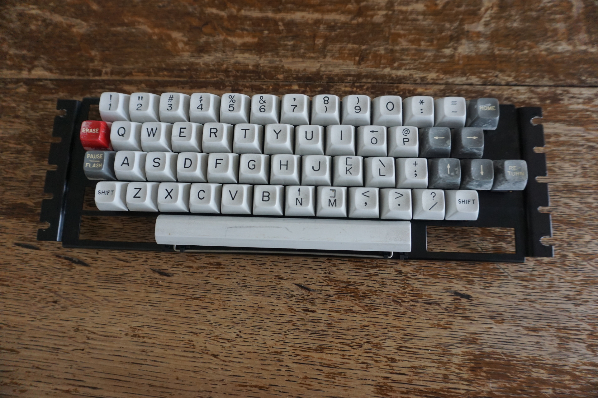

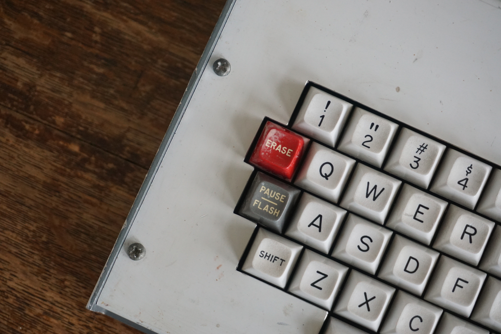

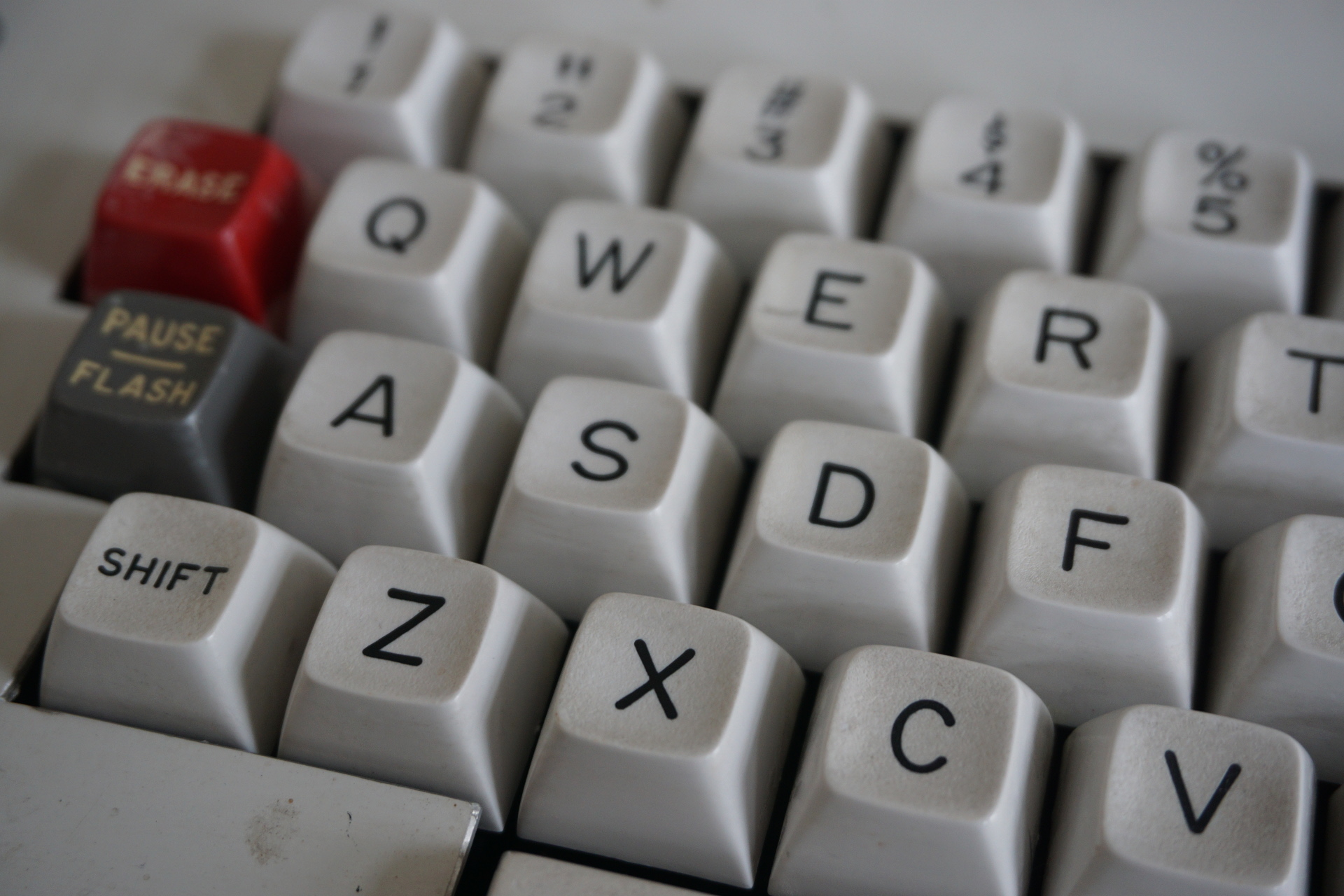

Next we have to place the caps back onto the keyboard.
keys mounted.JPG (905.18 KiB) Viewed 4302 times

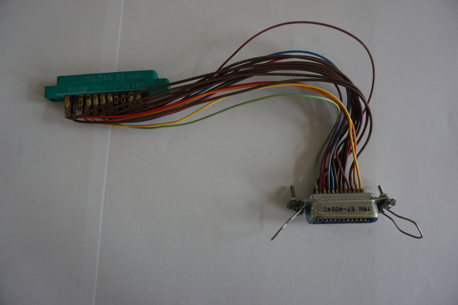

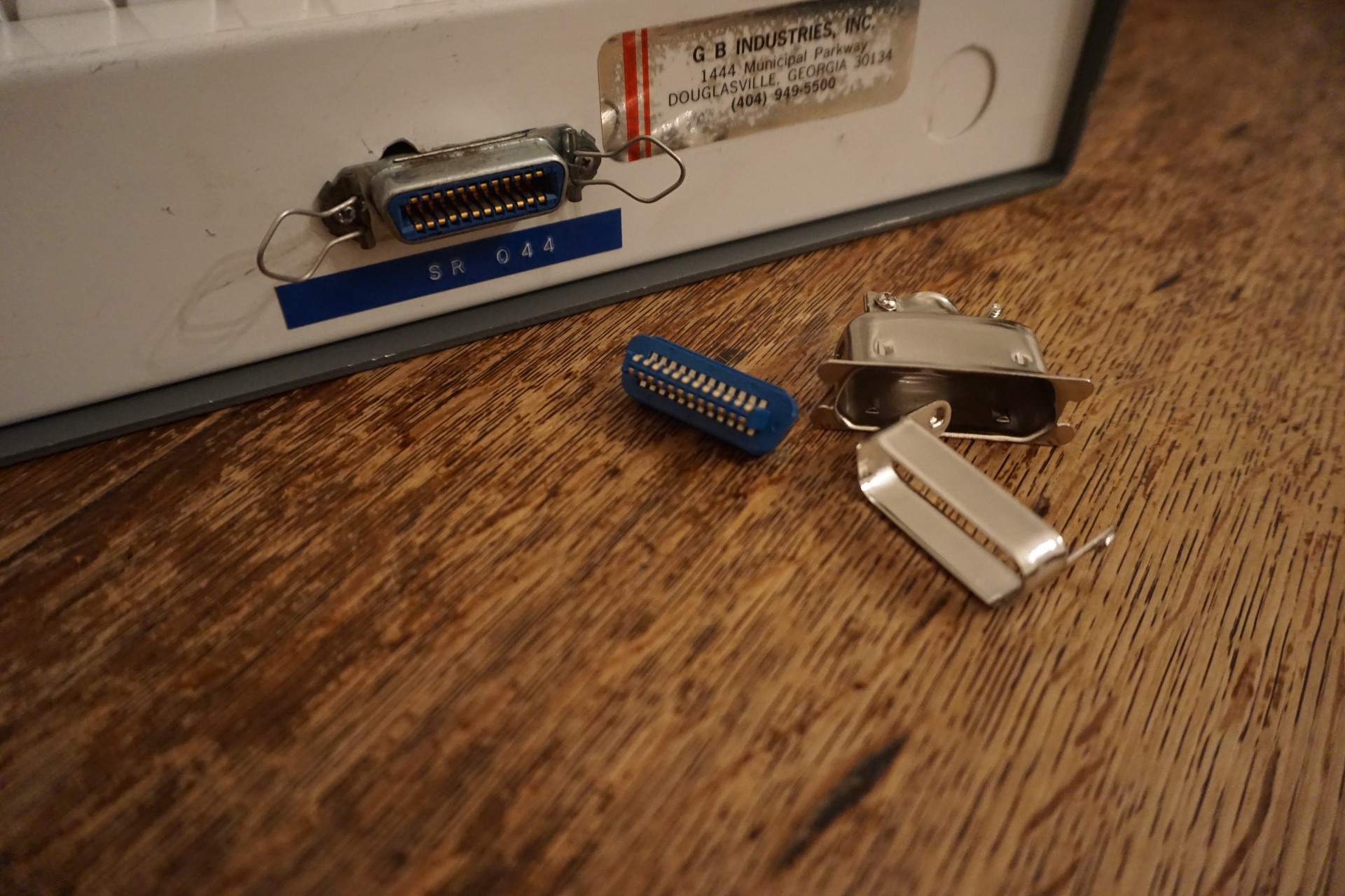

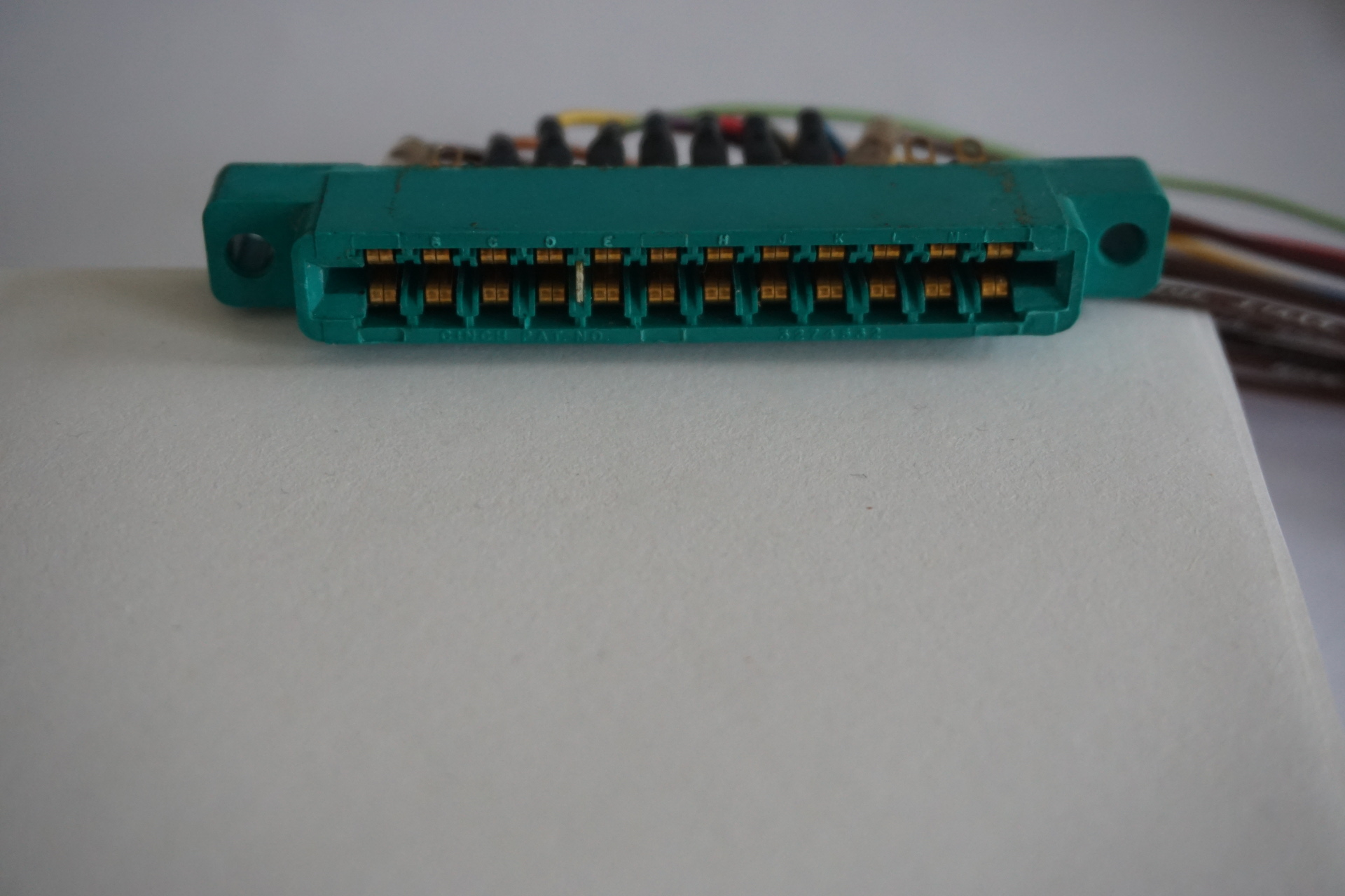

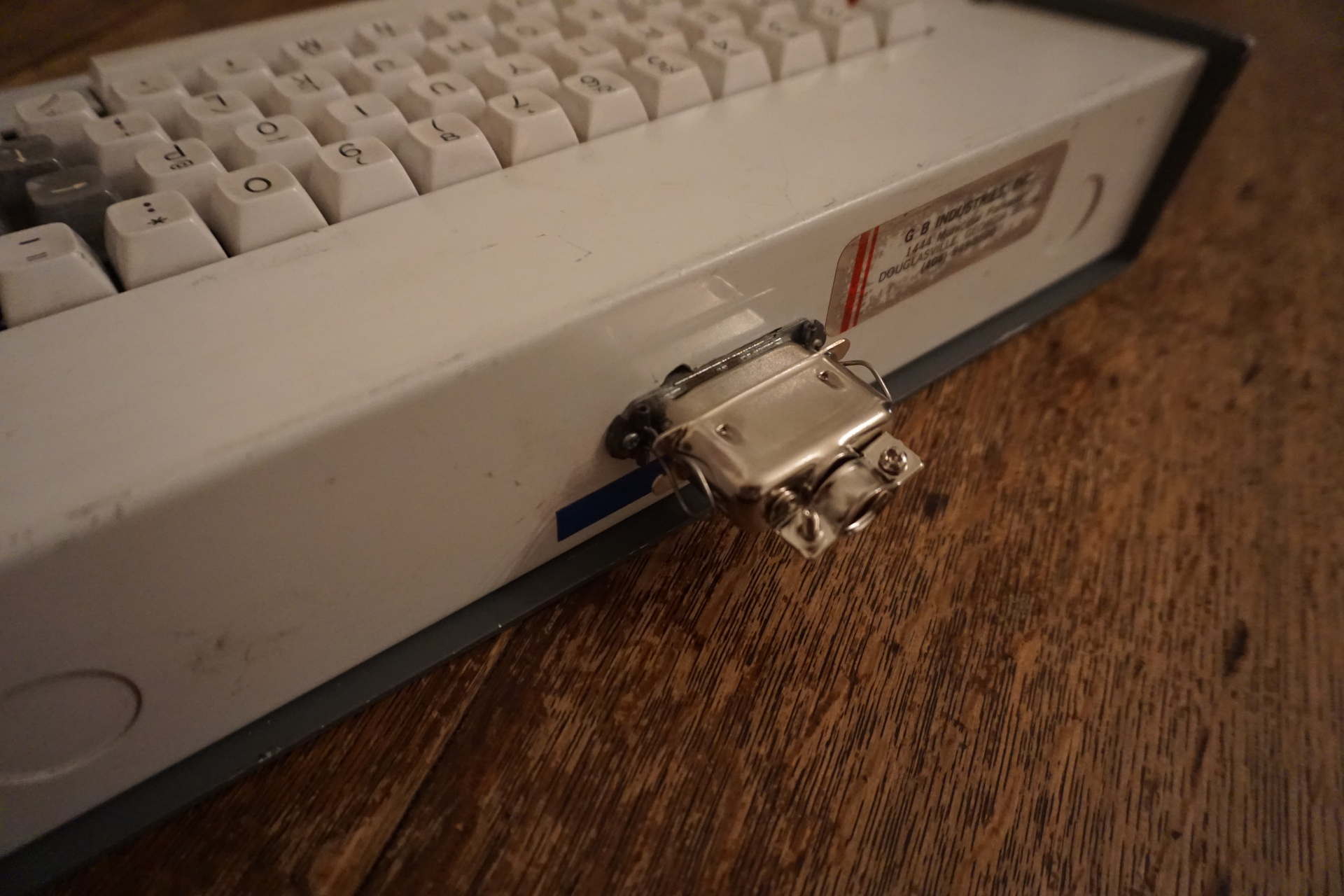

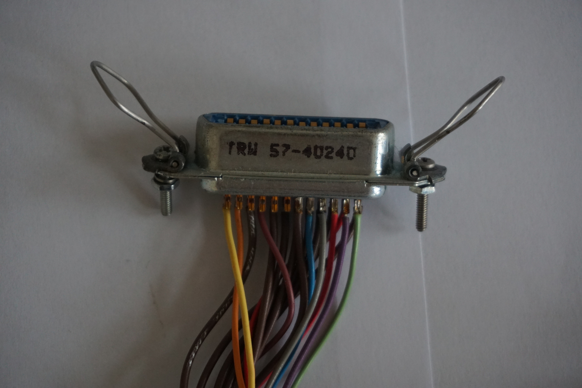

Now, before we come to the case, let's have a look at the connector. The external part seems to be some kind of centronics connector.
external connector head on.JPG (519.67 KiB) Viewed 4302 times
external connector label.JPG (509.89 KiB) Viewed 4302 times

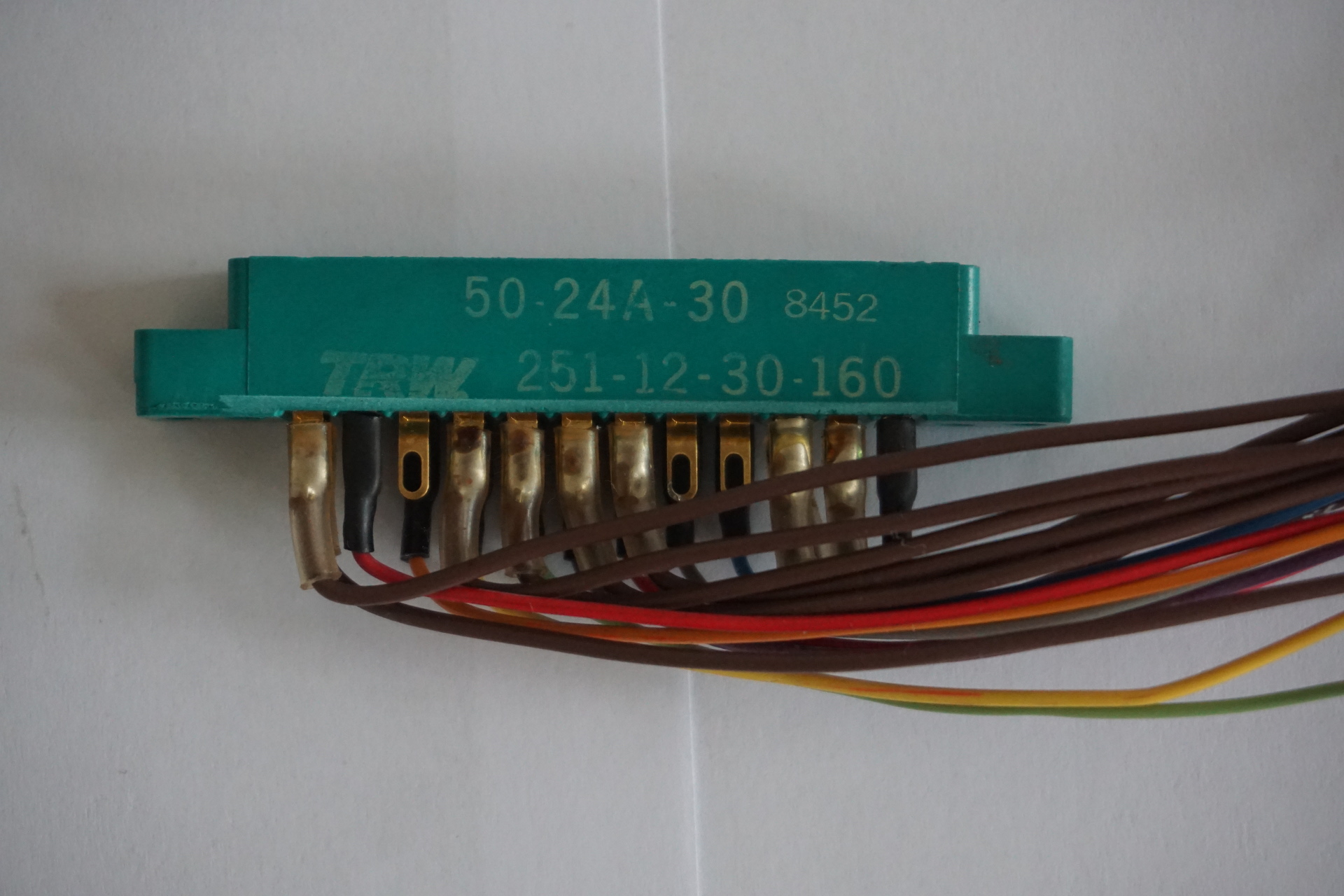

The internal connector fits onto the PCB only in one way.
internal connector head on.JPG (452.79 KiB) Viewed 4302 times
internal connector label.JPG (515.59 KiB) Viewed 4302 times

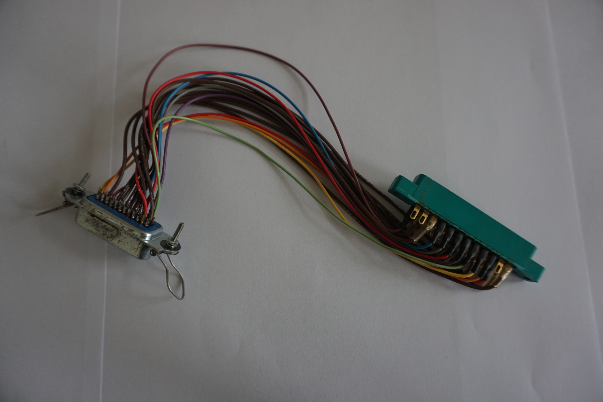

internal cable top.JPG (546.05 KiB) Viewed 4302 times
internal cable bottom.JPG (571.35 KiB) Viewed 4302 times

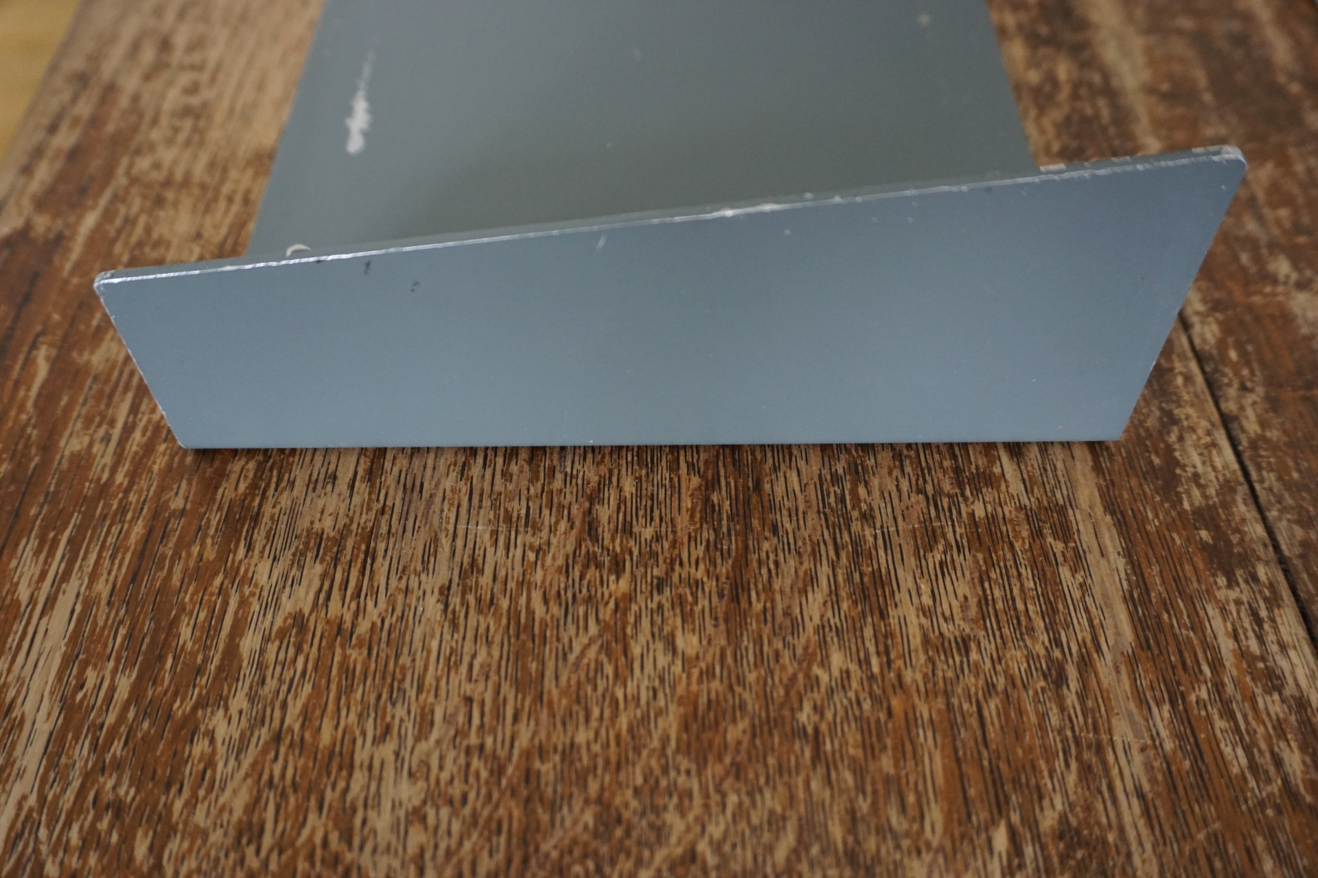

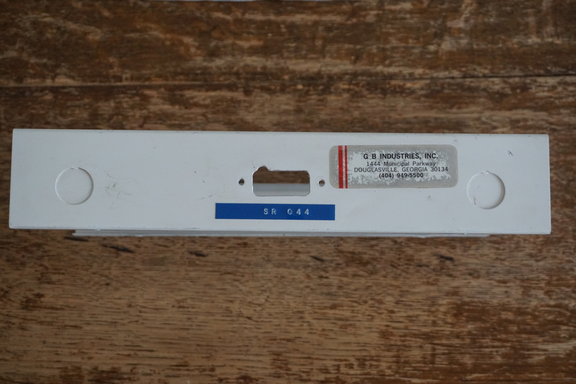

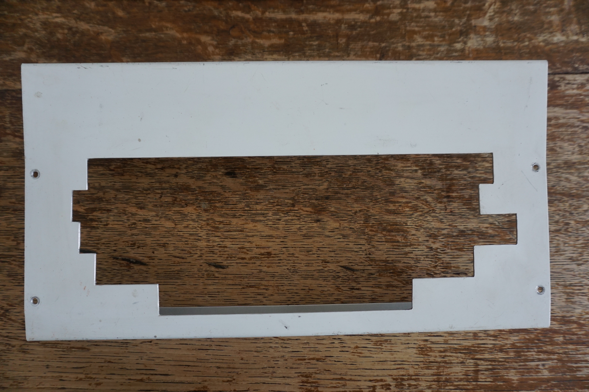

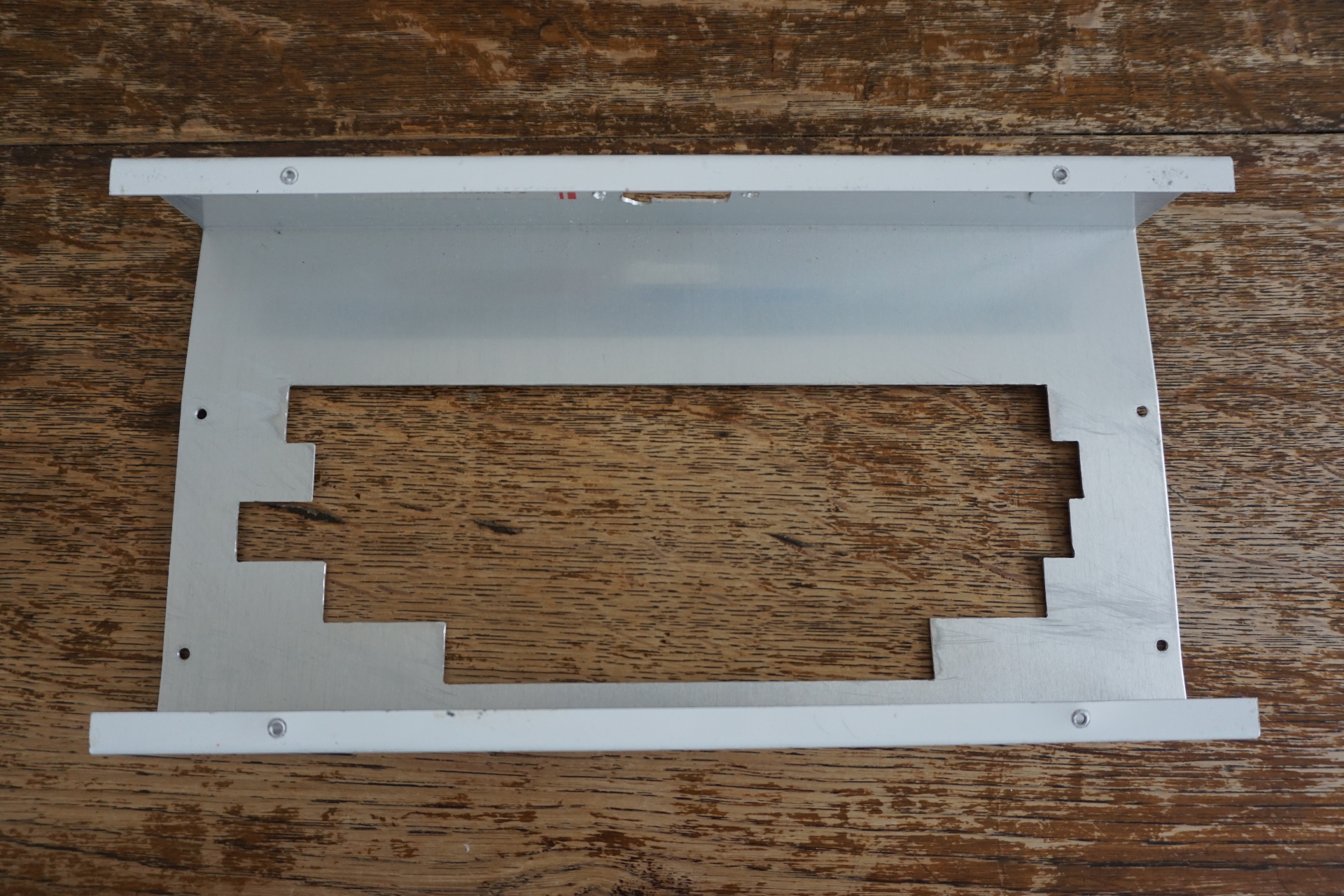

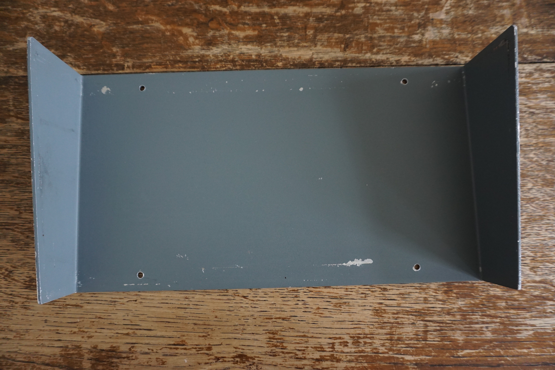

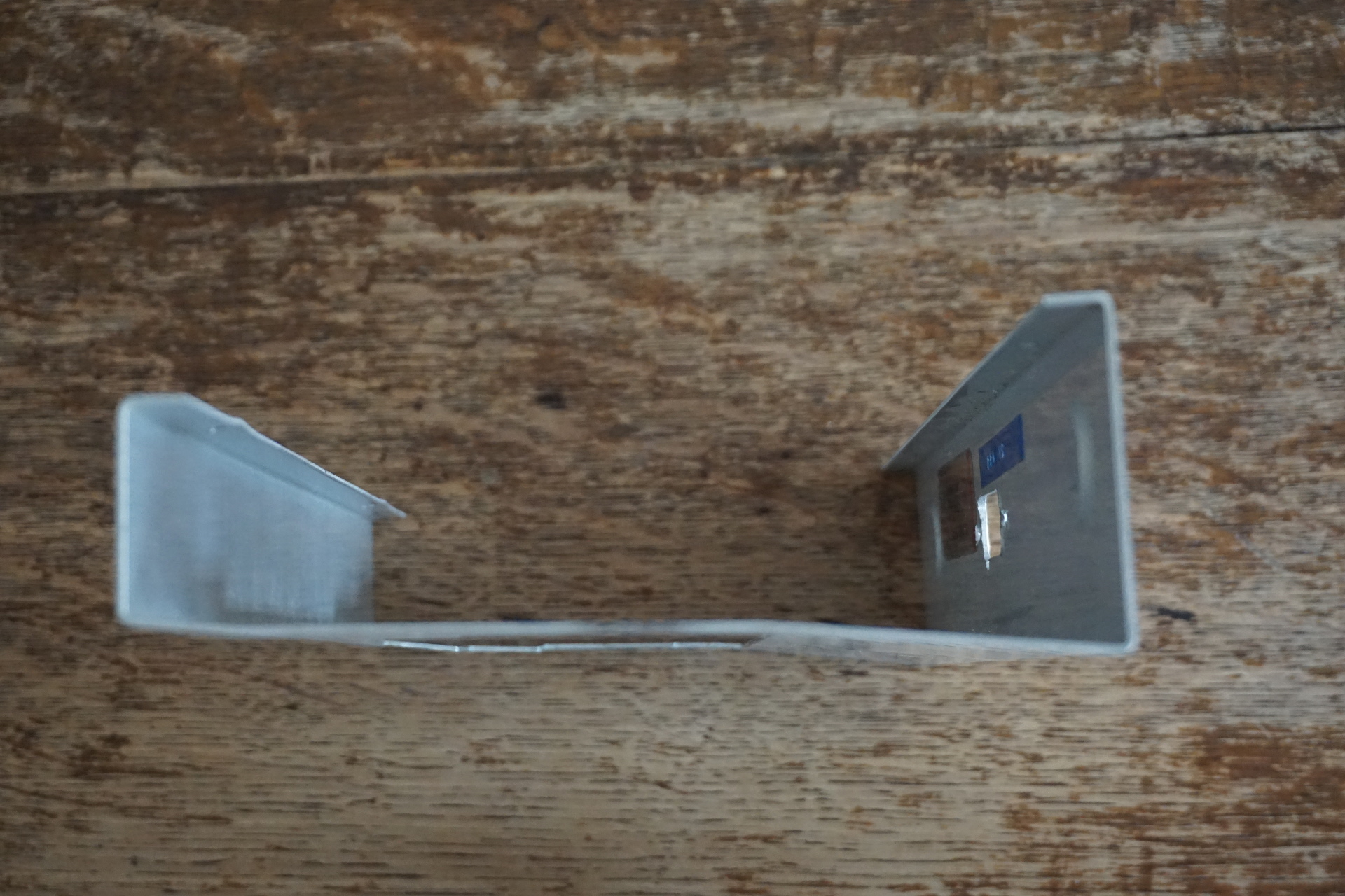

The case is a simple 2 piece bend metal case. The top part is screwed onto the bottom part, and the plate with the keyswitches is hung from the top part.
First some views of the top housing:
upper case top.JPG (753.25 KiB) Viewed 4302 times
upper case side.JPG (705.12 KiB) Viewed 4302 times
upper case bottom.JPG (895.78 KiB) Viewed 4302 times
upper case back.JPG (624.35 KiB) Viewed 4302 times
upper case detail.JPG (490.05 KiB) Viewed 4302 times

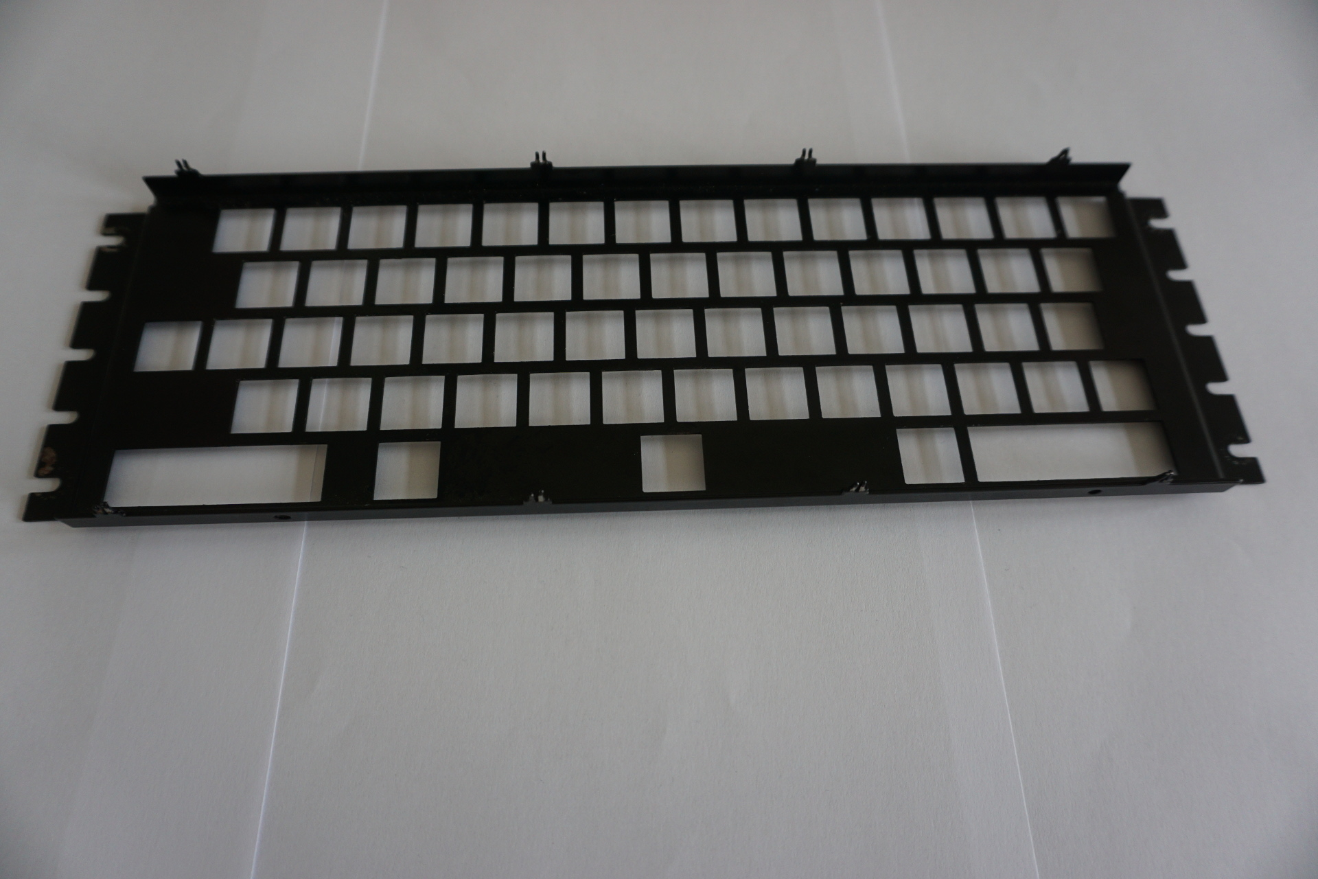

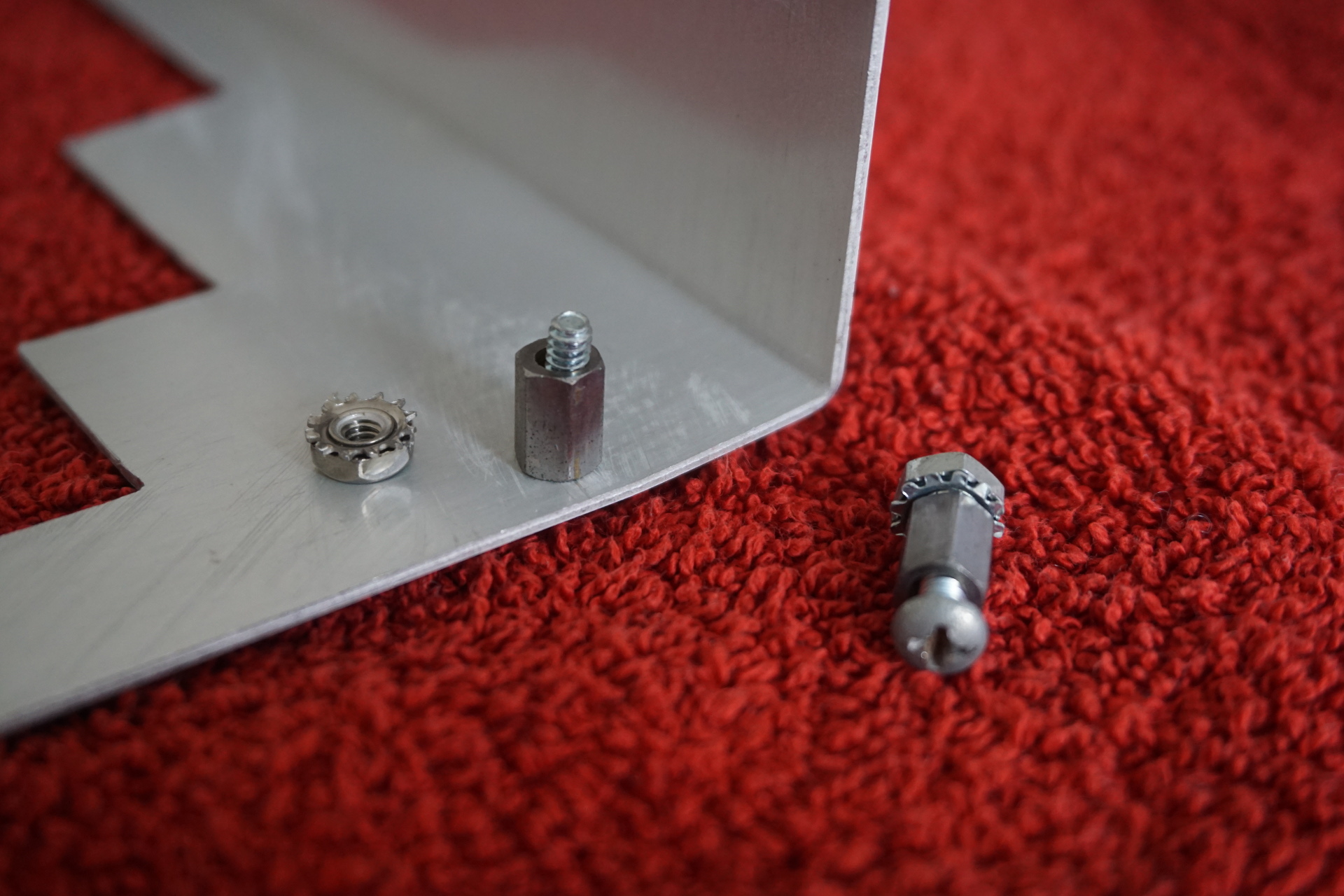

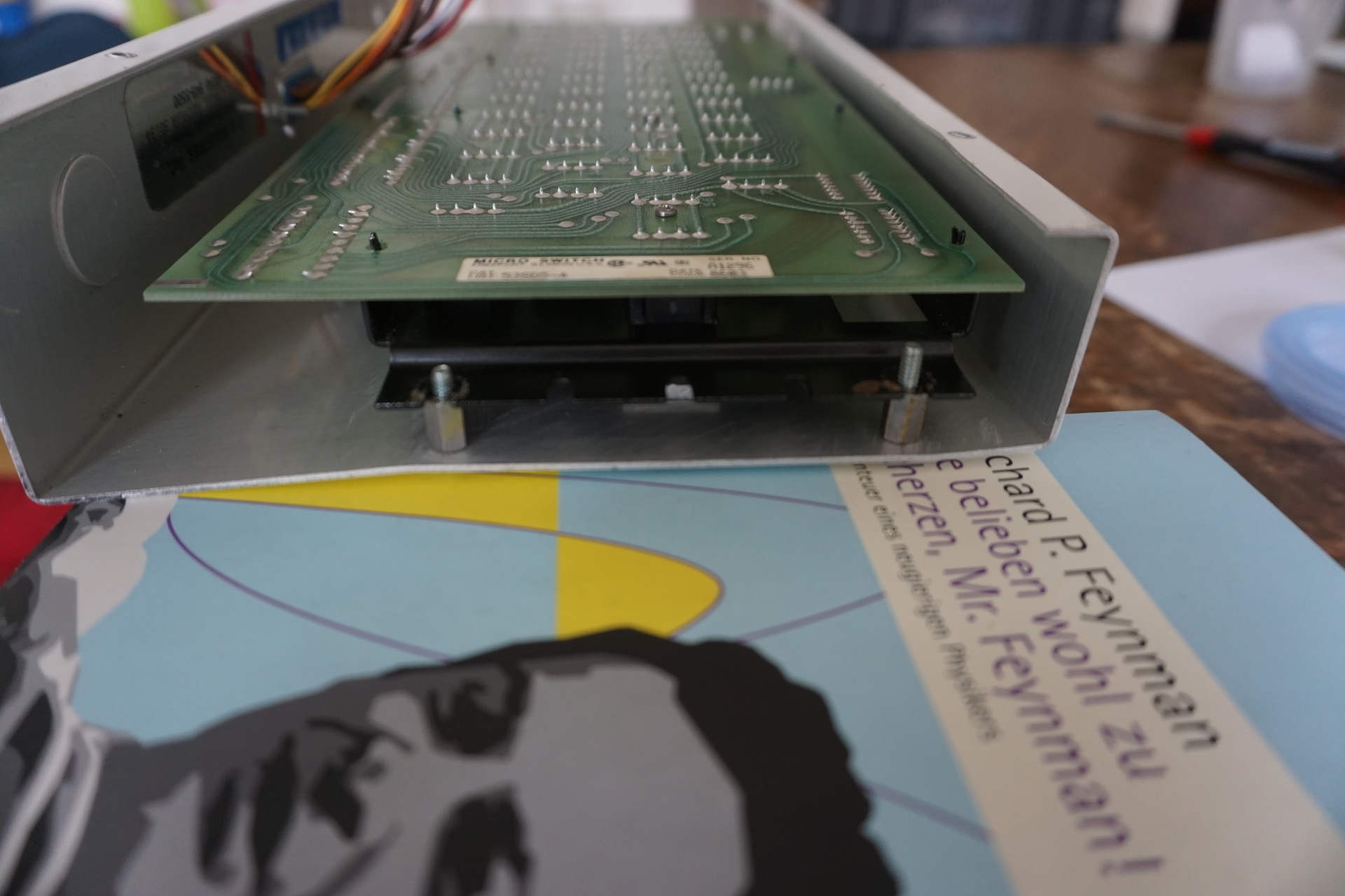

And here are some pictures of the spacers between the upper case and the plate:
plate spacer 1.JPG (599.48 KiB) Viewed 4302 times
plate spacer 2.JPG (506.57 KiB) Viewed 4302 times

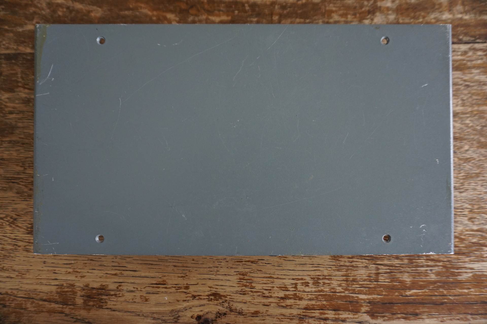

All that's left now is adding the lower case with 4 Screws.
lower case top.JPG (759.79 KiB) Viewed 4302 times
lower case side.JPG (773.63 KiB) Viewed 4302 times
lower case bottom.JPG (697.98 KiB) Viewed 4302 times

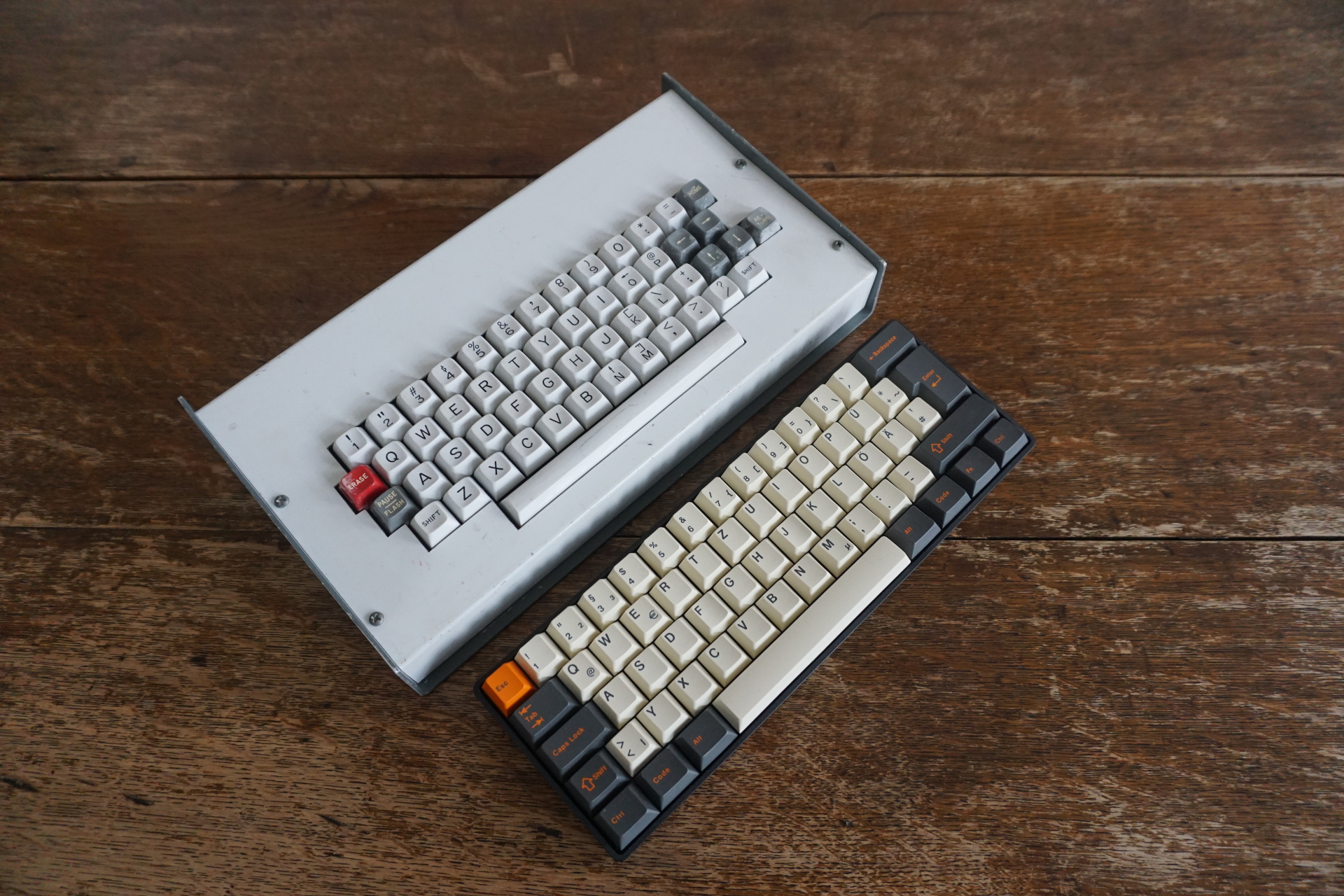

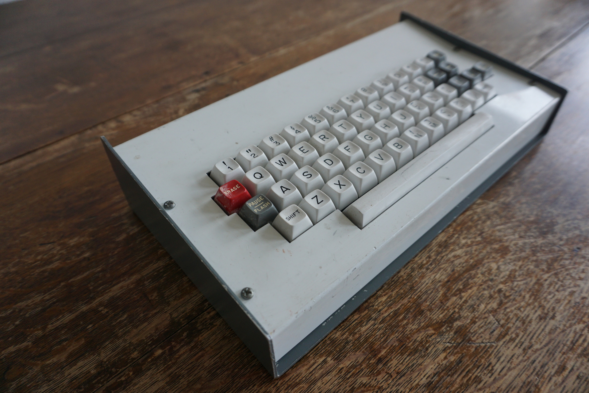

And finally some pictures of the complete keyboard:
done 1.JPG (825.44 KiB) Viewed 4302 times
done 2.JPG (637.14 KiB) Viewed 4302 times
done 3.JPG (950.44 KiB) Viewed 4302 times
done 4.JPG (575.78 KiB) Viewed 4302 times

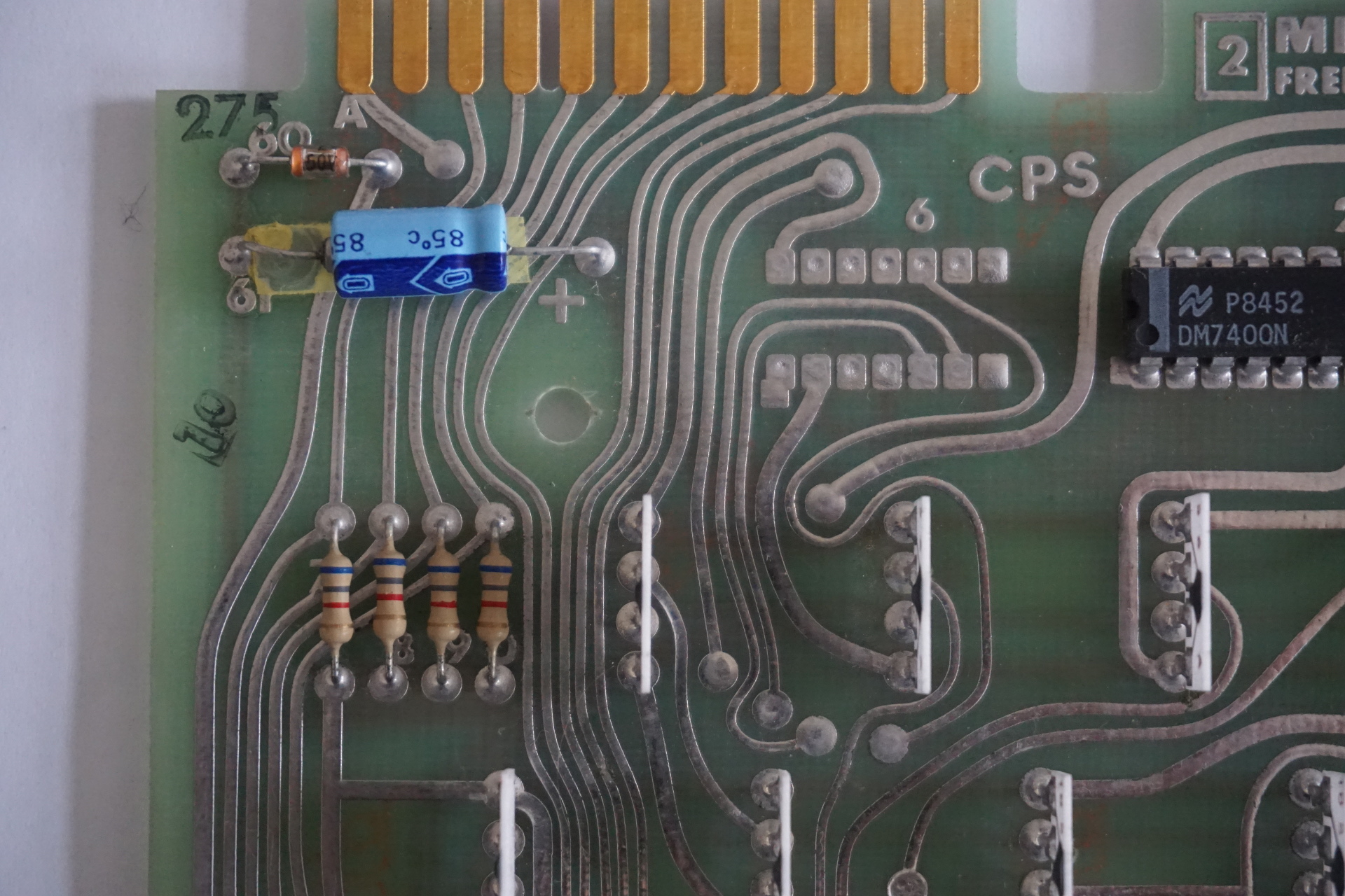

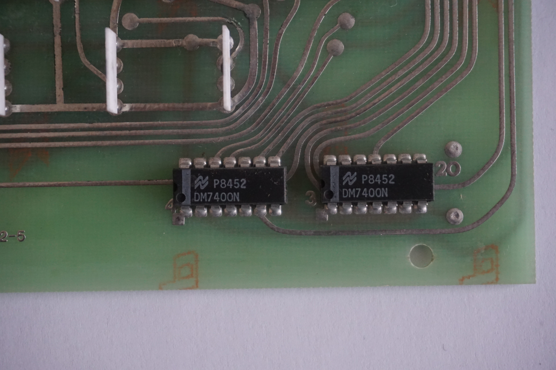

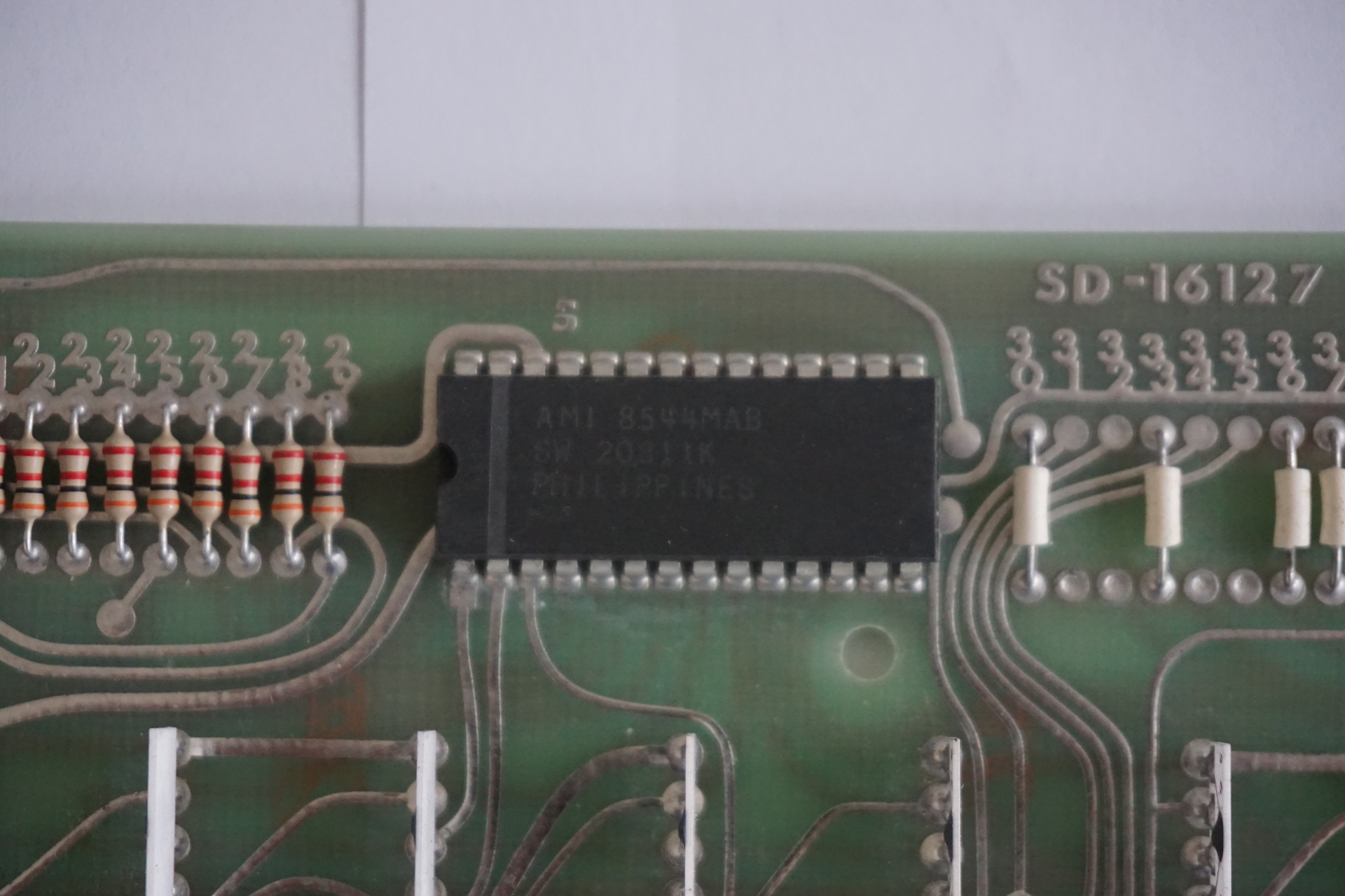

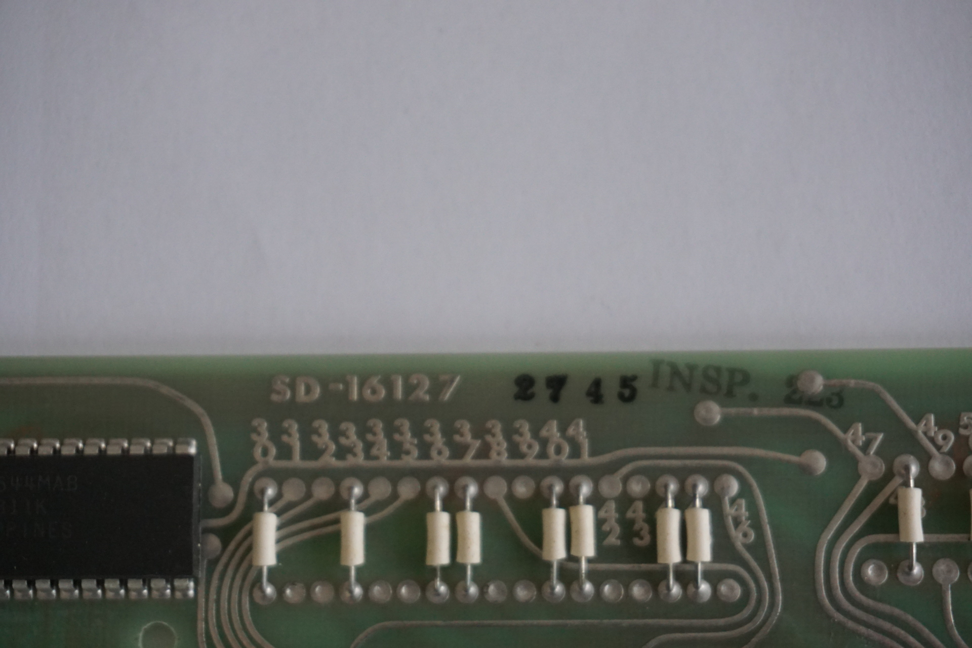

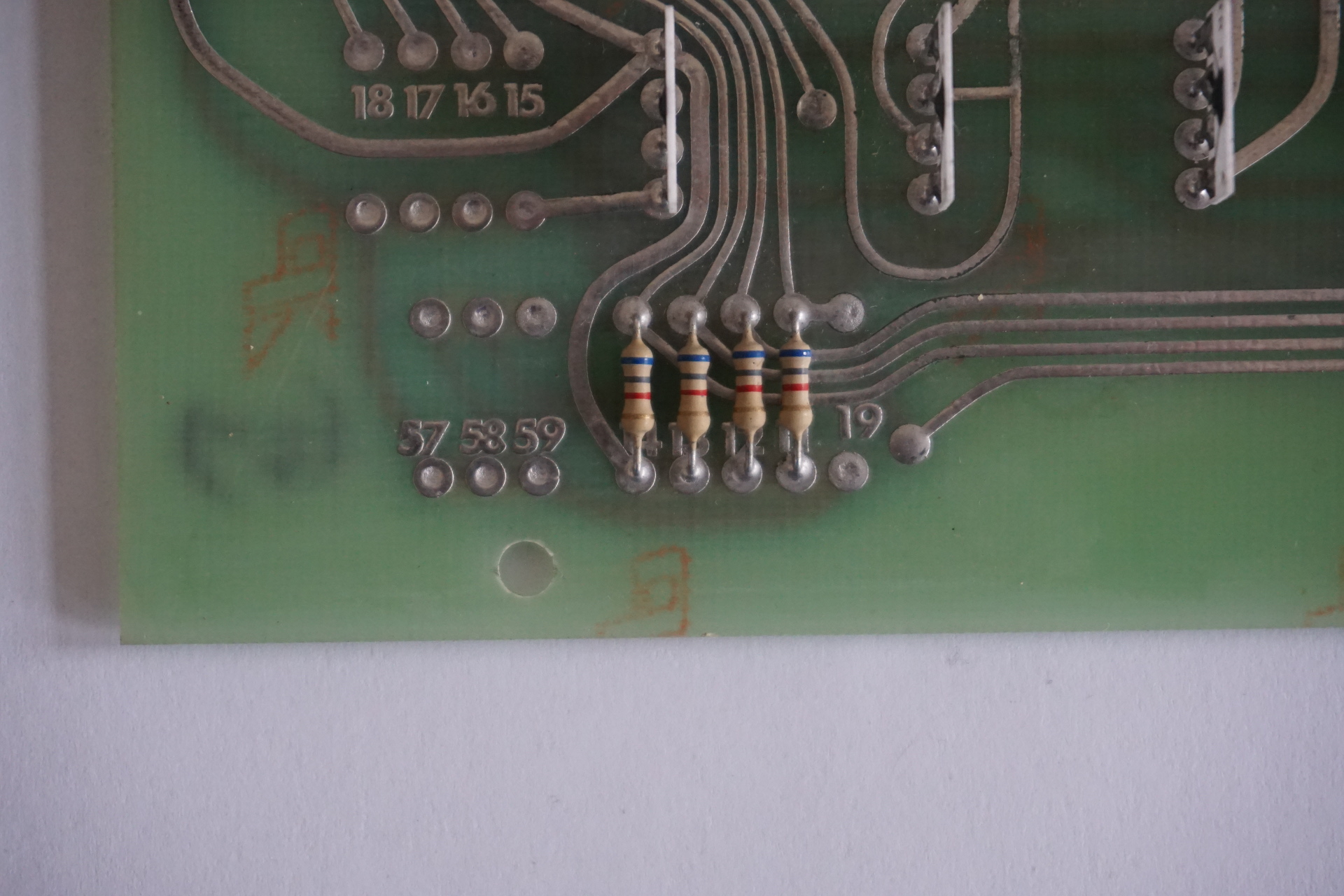

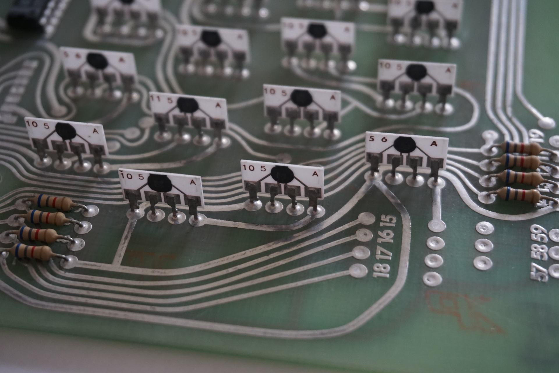

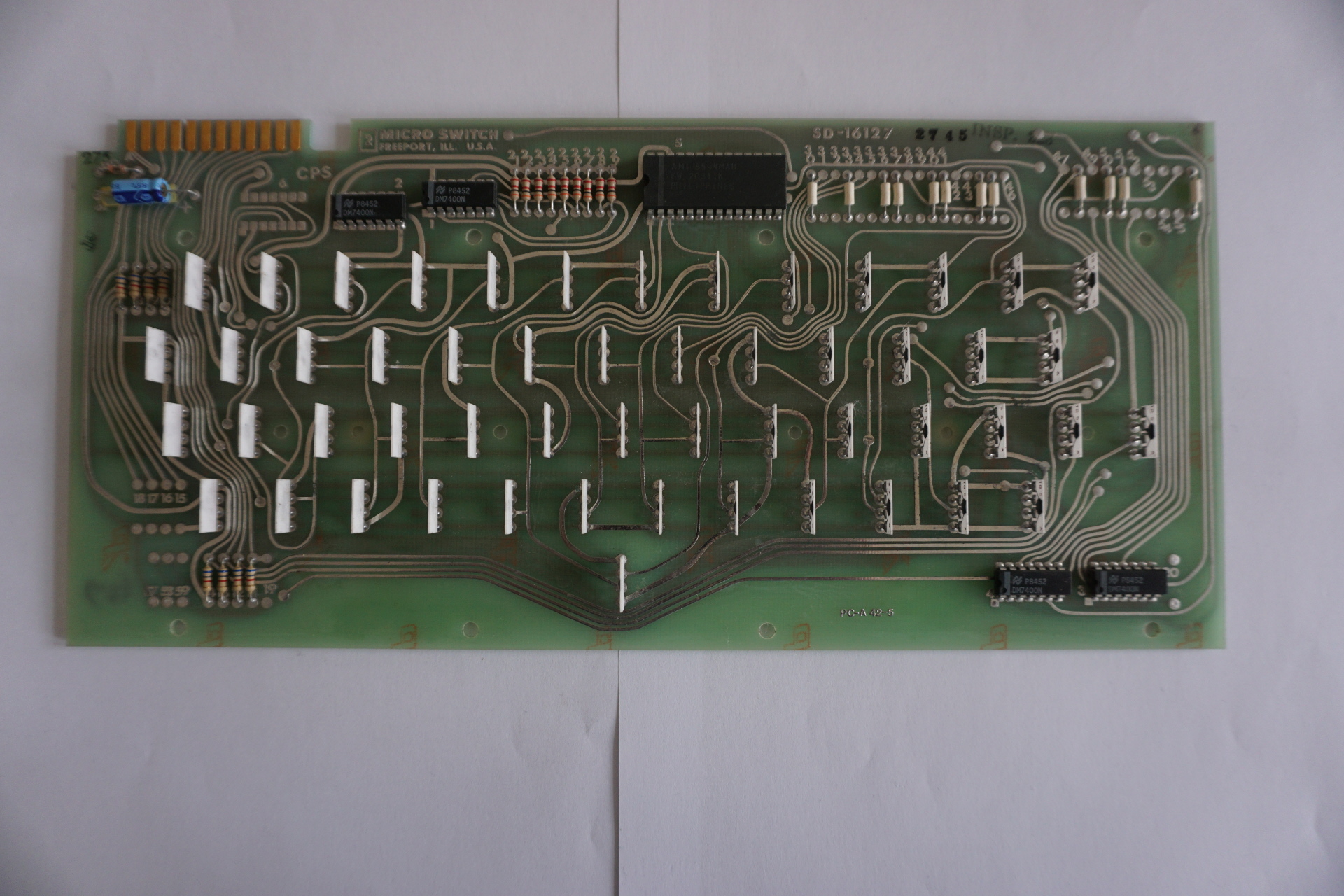

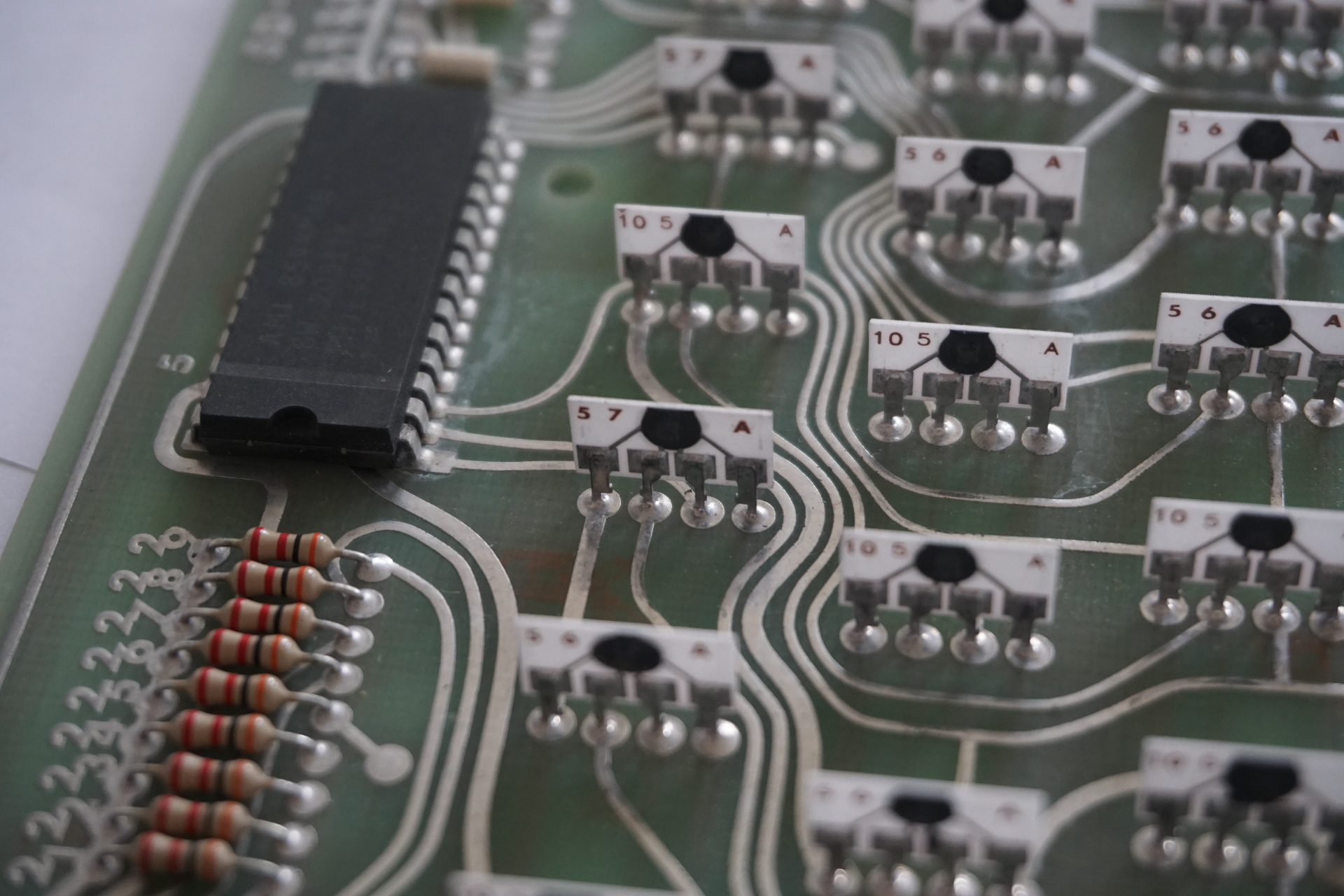

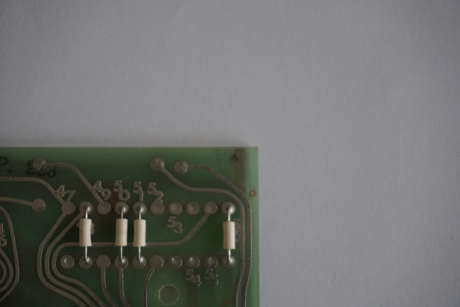

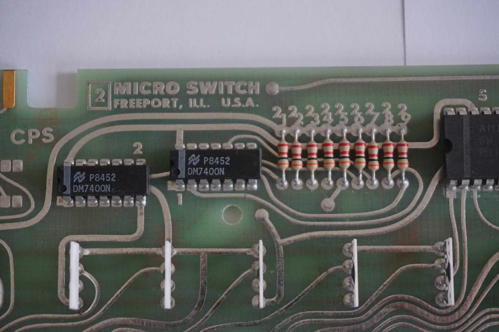

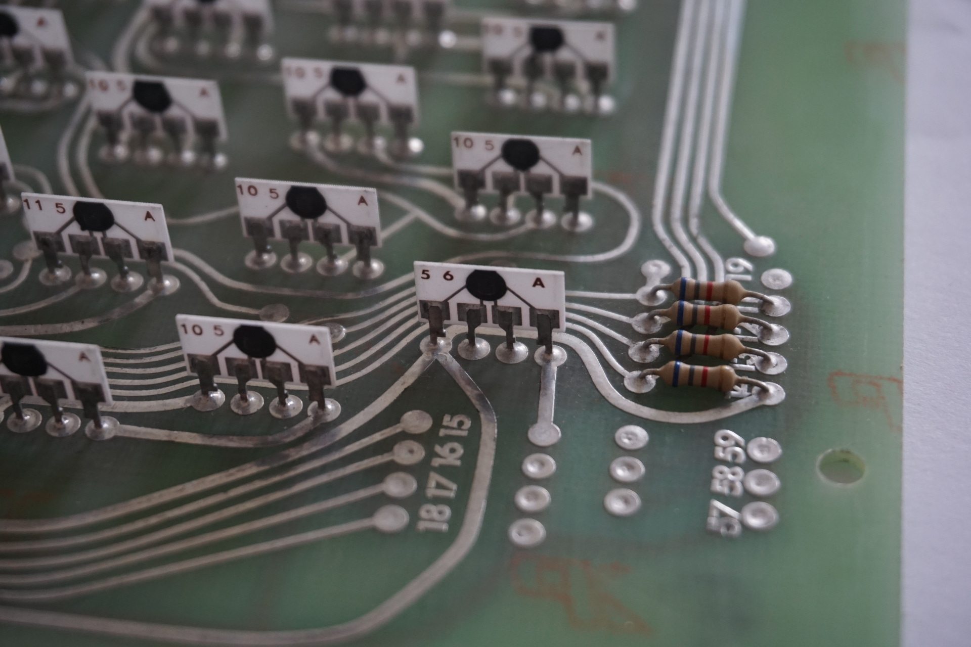

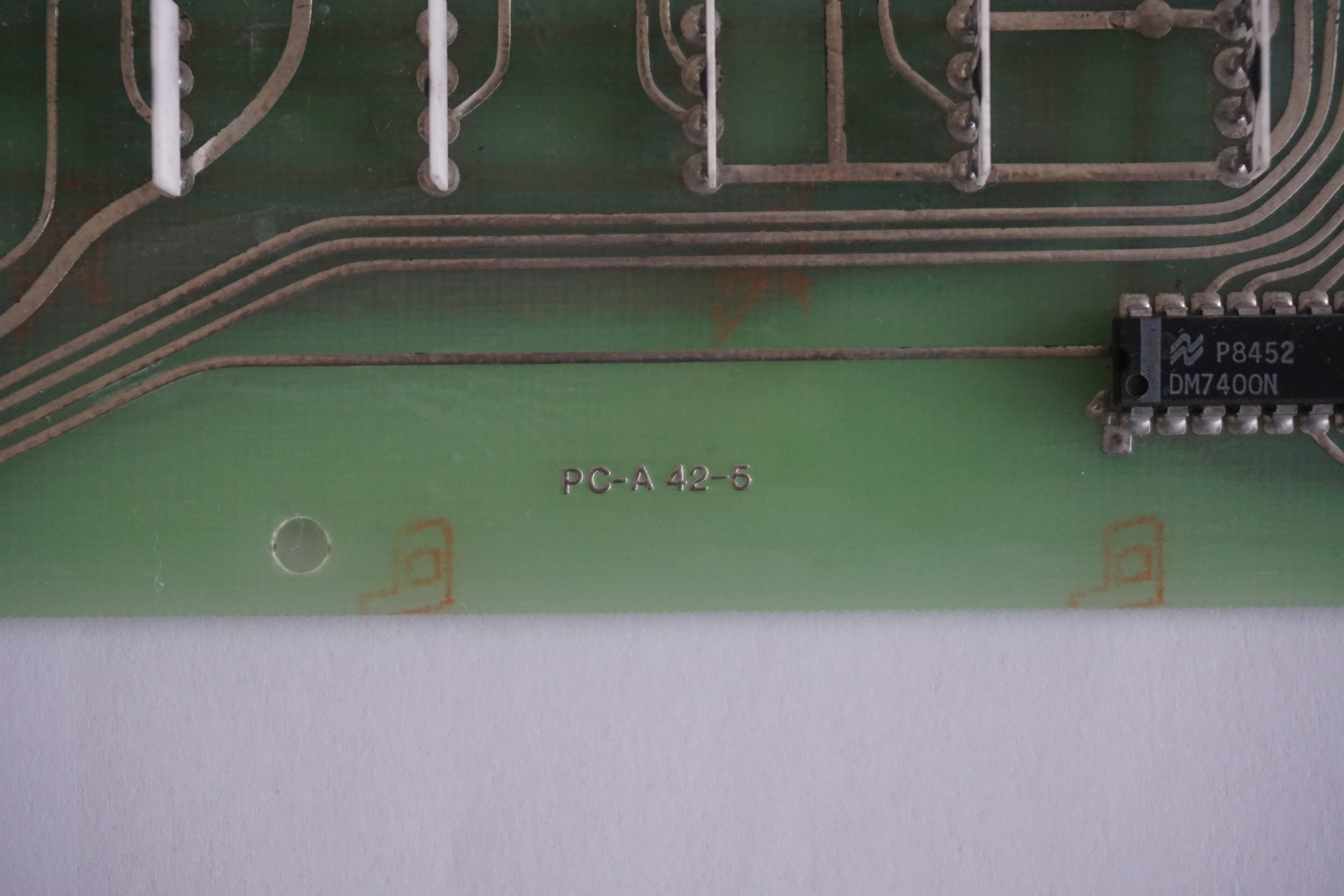

pcb front:
pcb front overview.JPG (721.7 KiB) Viewed 4290 times
pcb front 1.JPG (429.22 KiB) Viewed 4290 times
pcb front 2.JPG (499.2 KiB) Viewed 4290 times
pcb front 3.JPG (551.87 KiB) Viewed 4290 times
pcb front 4.JPG (623 KiB) Viewed 4290 times
pcb front 5.JPG (580.49 KiB) Viewed 4290 times
pcb front 6.JPG (770.54 KiB) Viewed 4290 times
pcb front 7.JPG (683.08 KiB) Viewed 4290 times
pcb front 8.JPG (571.71 KiB) Viewed 4290 times

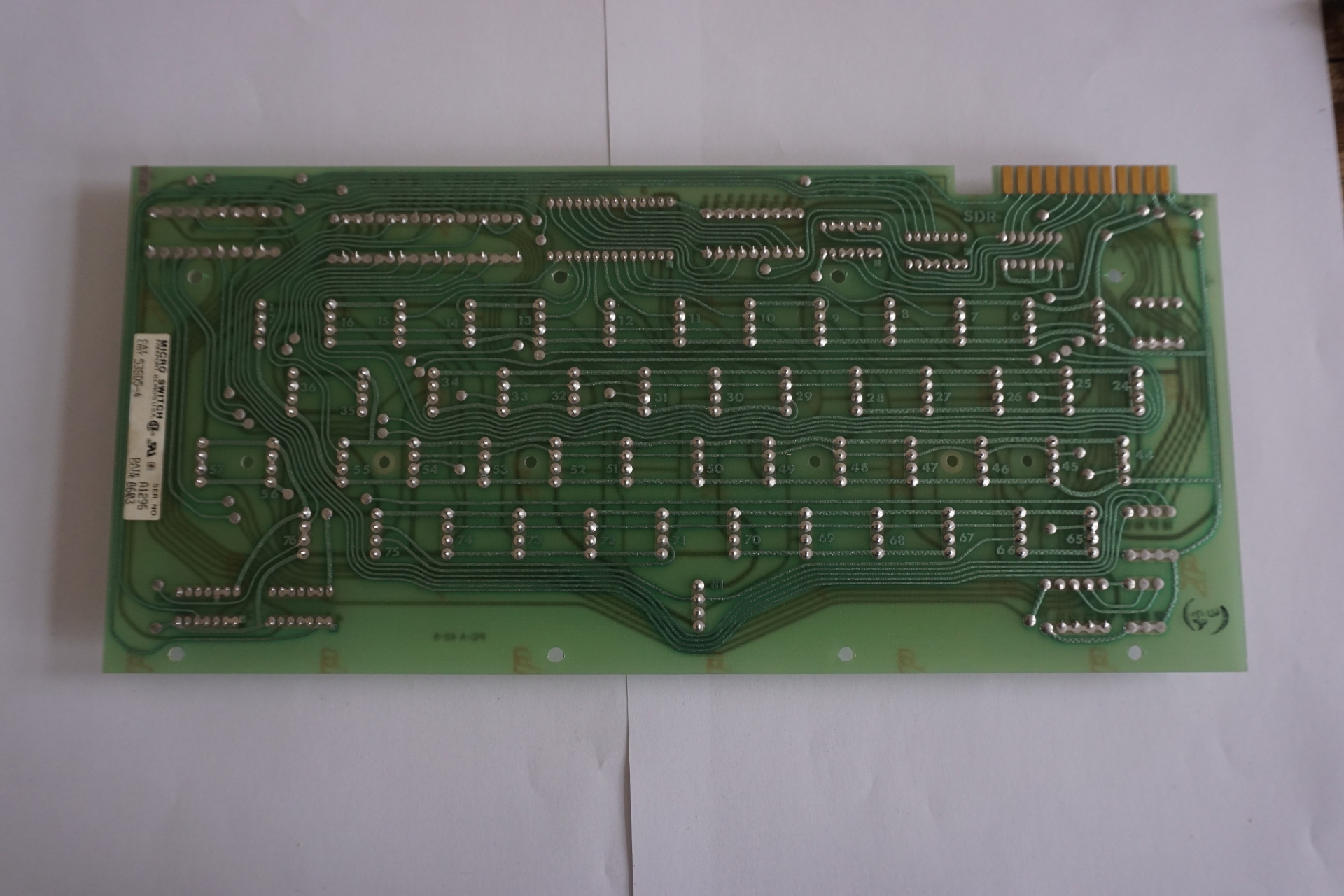

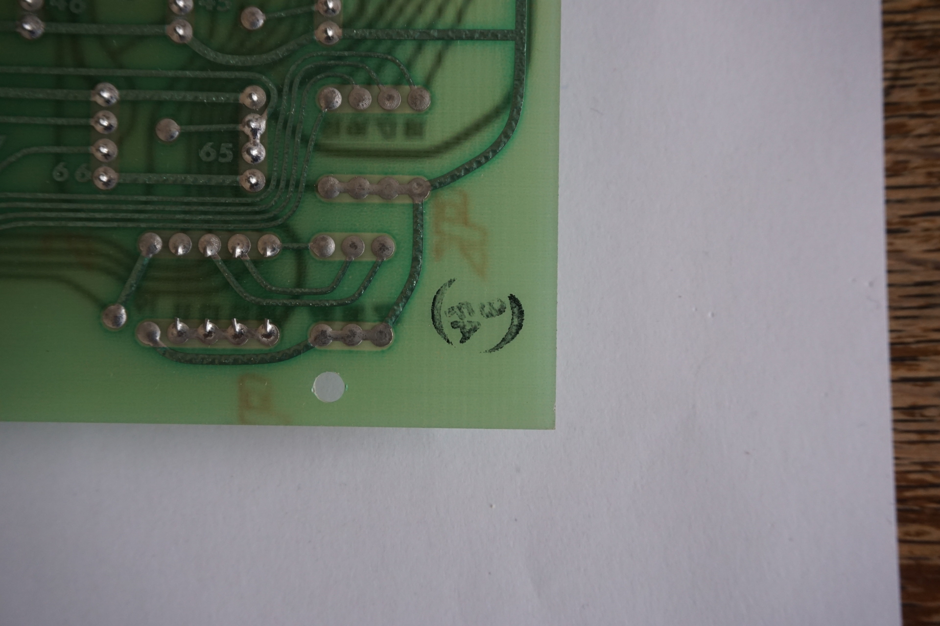

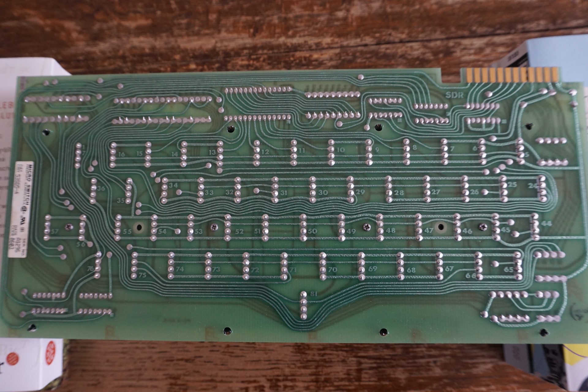

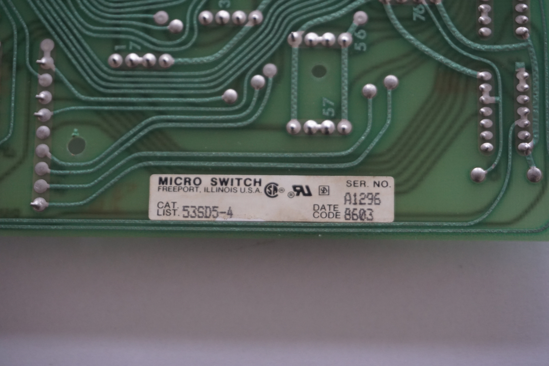

pcb back:
pcb back overview.JPG (602.84 KiB) Viewed 4290 times
pcb back 1.JPG (478.83 KiB) Viewed 4290 times
pcb back 2.JPG (542.02 KiB) Viewed 4290 times
hall senor labels:
sensor 10 5 A.JPG (614.14 KiB) Viewed 4290 times
sensor 56 A.JPG (560.11 KiB) Viewed 4290 times
sensor 57 A.JPG (619.45 KiB) Viewed 4290 times

Really nice Slom! :o :shock: I was looking at that erase key earlier in the header thread and thinking...where is that from? ;) How do you like those switches?
Great pictures, thanks for this post. :P

I didn't realise that the sensor PCB was removable — is that normal with SD series?
05 Mar 2017, 16:59
I don't believe it's easily removable on mine, I'll have to check.
Slom
05 Mar 2017, 17:08
Yes, I think it is normal that the hall sensors can be pulled out from the bottom of the switch.
To remove the whole PCB, I had to unscrew the 4 screws and also bend the 8 small clamps on the underside of the PCB together. Forgot to mention these, as I didn't put them back into their original position for now.

seebart wrote: Really nice Slom! :o :shock: I was looking at that erase key earlier in the header thread and thinking...where is that from? ;) How do you like those switches?
Thank you :)
The switches are ... underwhelming. Really stiff and still quite scratchy, even after using an ultrasonic cleaner on them and applying lube. Maybe I need to get a more powerful ultrasonic cleaner ...
I have another SD series keyboard where the switches are stiff as well. Not even in the same league as SW series.
05 Mar 2017, 18:08
What part numbers are on the switches? I can't make them out from any of the photos.
Slom
05 Mar 2017, 18:11
They are all 4A3A.
05 Mar 2017, 18:13
Slom wrote: The switches are ... underwhelming. Really stiff and still quite scratchy, even after using an ultrasonic cleaner on them and applying lube. Maybe I need to get a more powerful ultrasonic cleaner ...
I believe you and I have heard that here before. I can say that the Micro Switch SD Series switches in my Pertec feel fantastic but that keyboard is like new. The SD's in that large Micro Switch I linked in my PM don't feel so smooth and there is variation in feel and sound across the keyboard. Micro Switch SW Series is another feel alltogehter.
05 Mar 2017, 18:15
OK, so a bog standard 0.695 N switch. Just wanted to be sure they weren't intentionally heavy!

Beautiful work! I recall proxying this board for you, nice to see it again!
dorkvader is working on this. 4A3A is the "good" kind of switch which holds output low when pressed as opposed to pulsing it.
wiki/Micro_Switch_SD_Series
So you could either do protocol conversion, or, replace the controller. I wish my Wang board had 4A3A switches!
workshop-f7/converting-my-wang-t12379-30.html#p279867

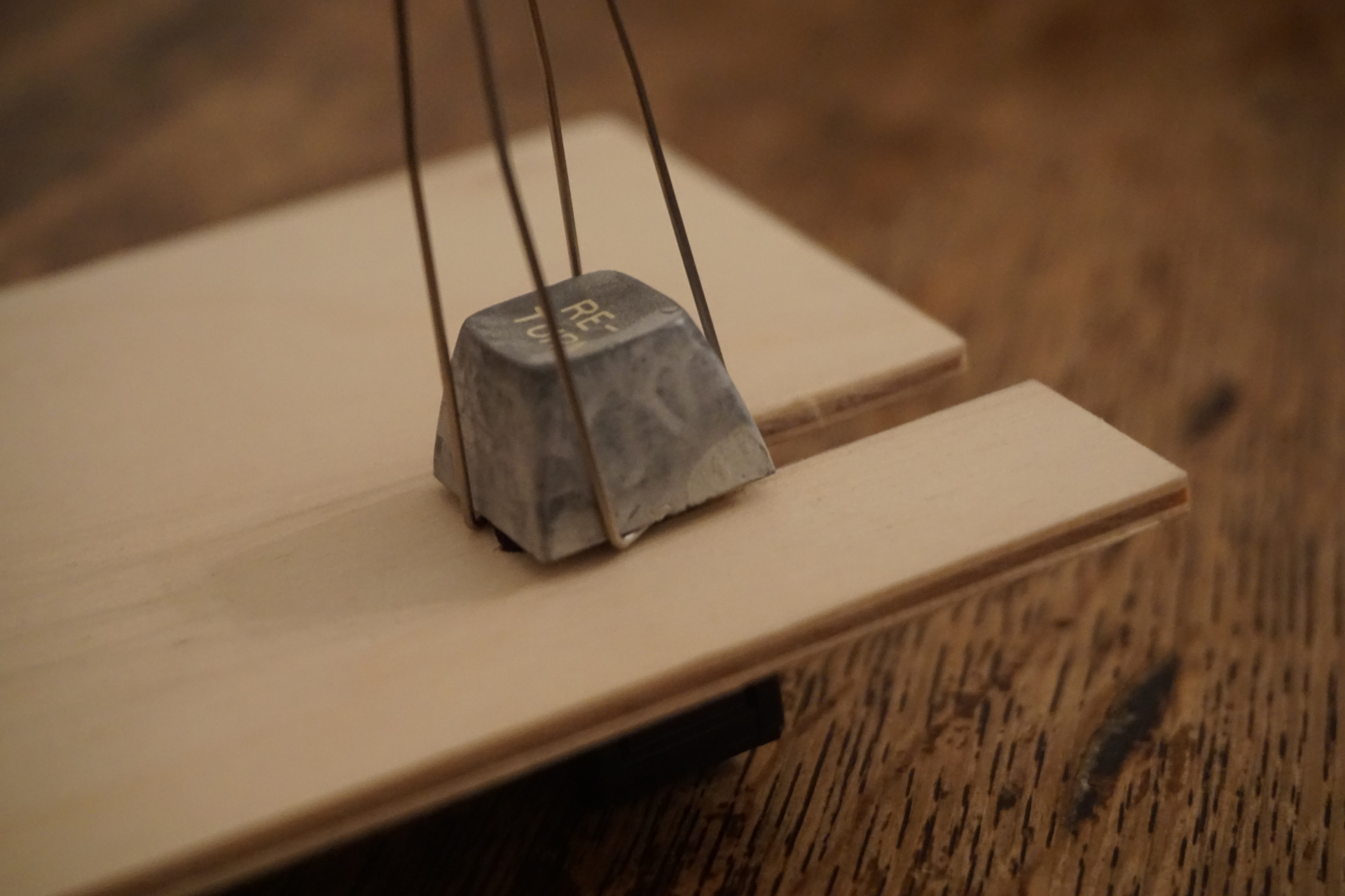

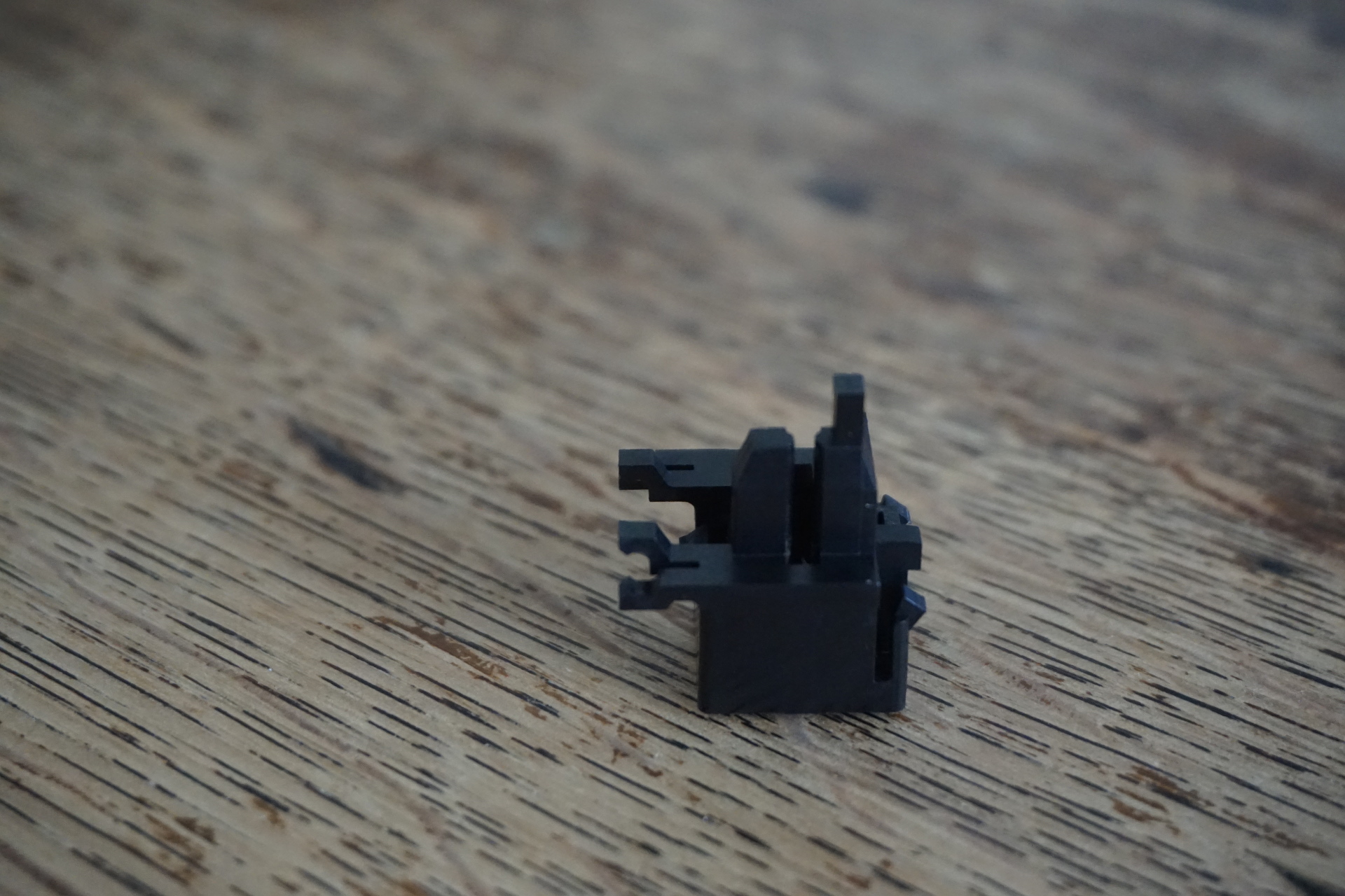

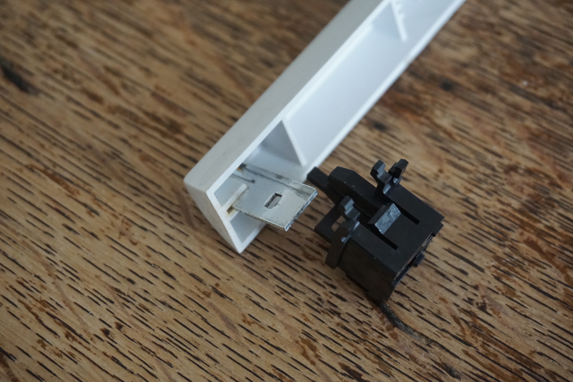

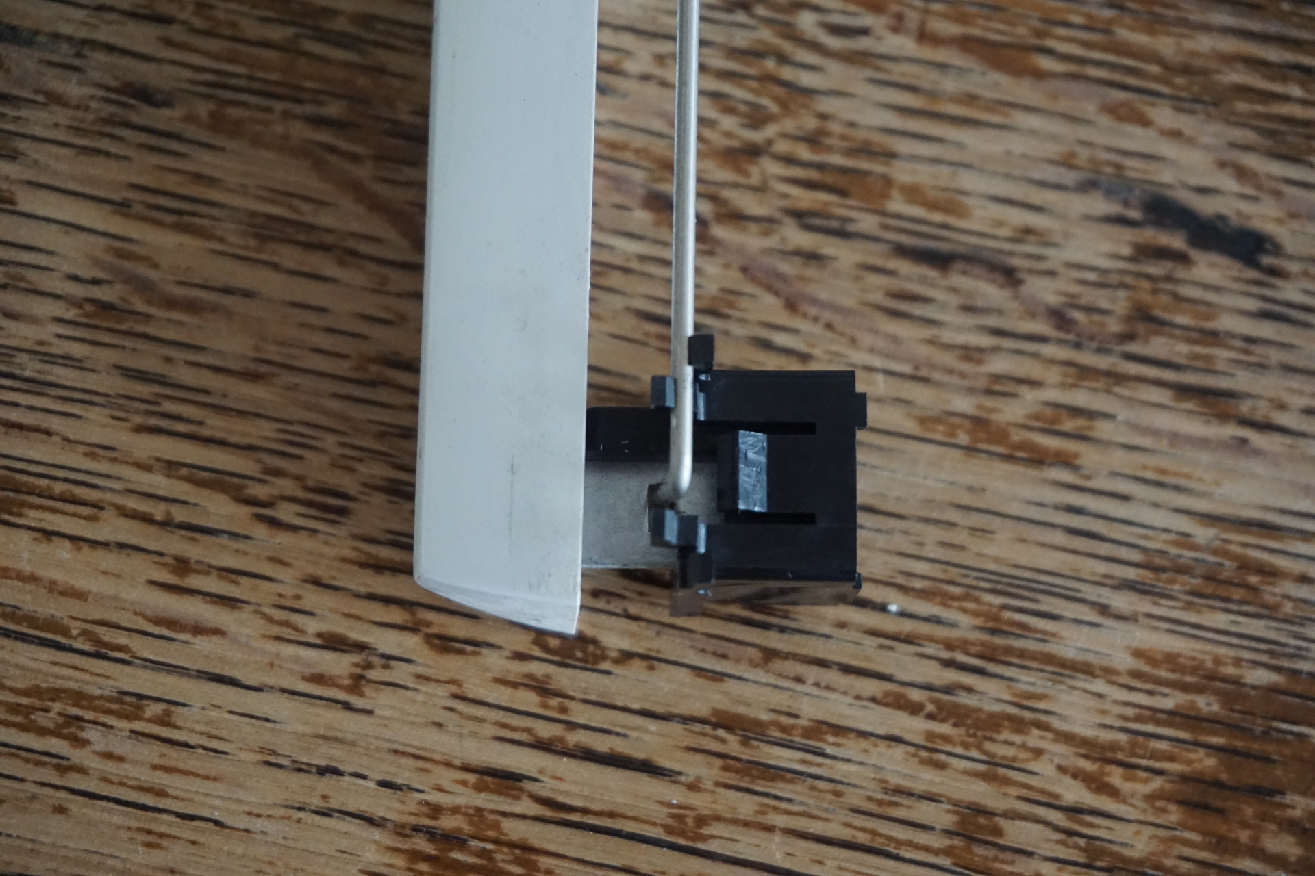

2) When pulling the key caps, I found that they really stuck to the switches. Almost like they where glued in, and probably related to the chemical damage mentioned above. After breaking a switch, I build myself a small helper to avoid further damage:
cap remover 1.JPG (486.04 KiB) Viewed 3993 times
cap remover 2.JPG (537.2 KiB) Viewed 3993 times
This way there is some pressure on top of the switch housing to counter the pressure coming from the stem being pulled up.

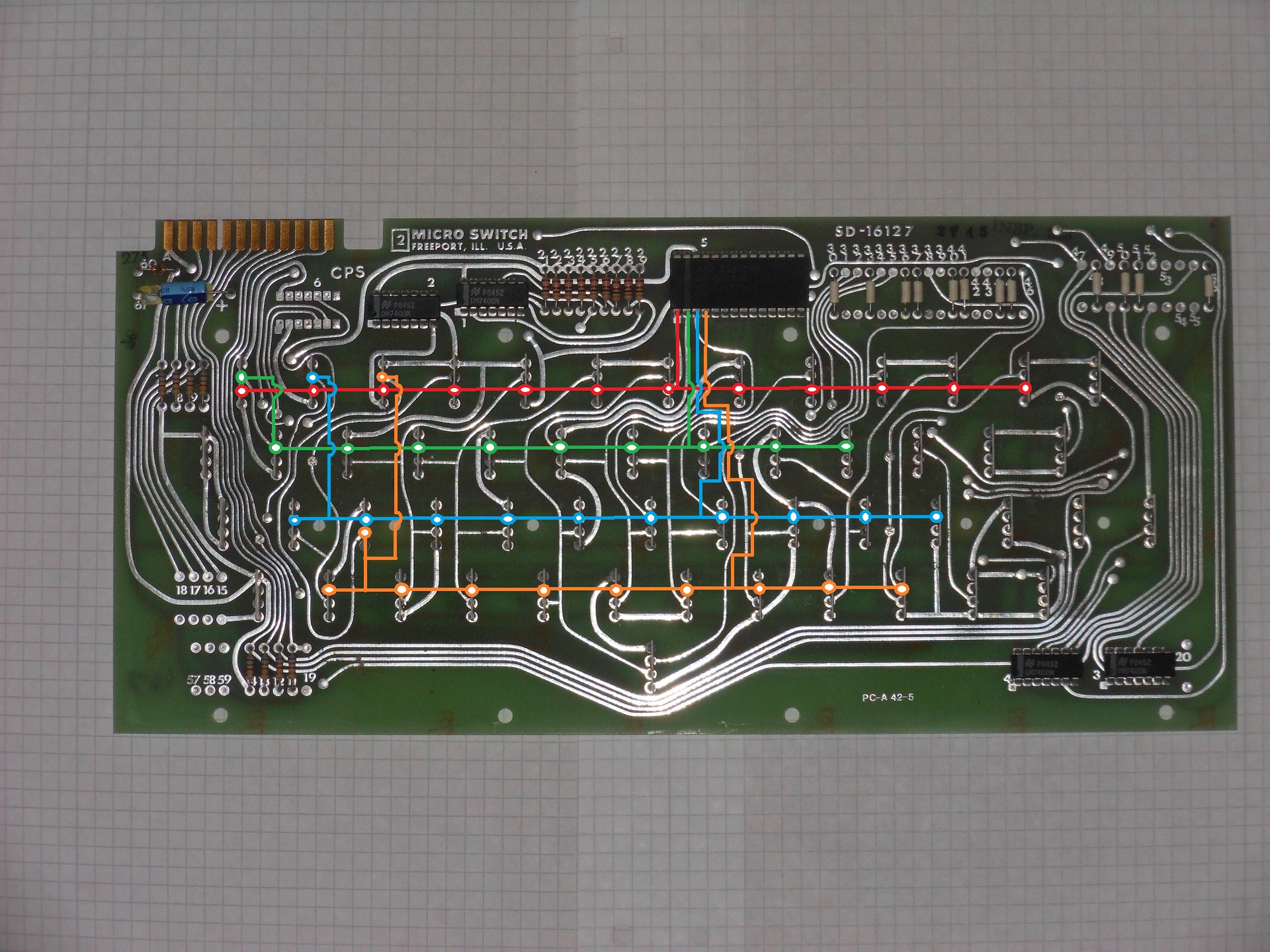

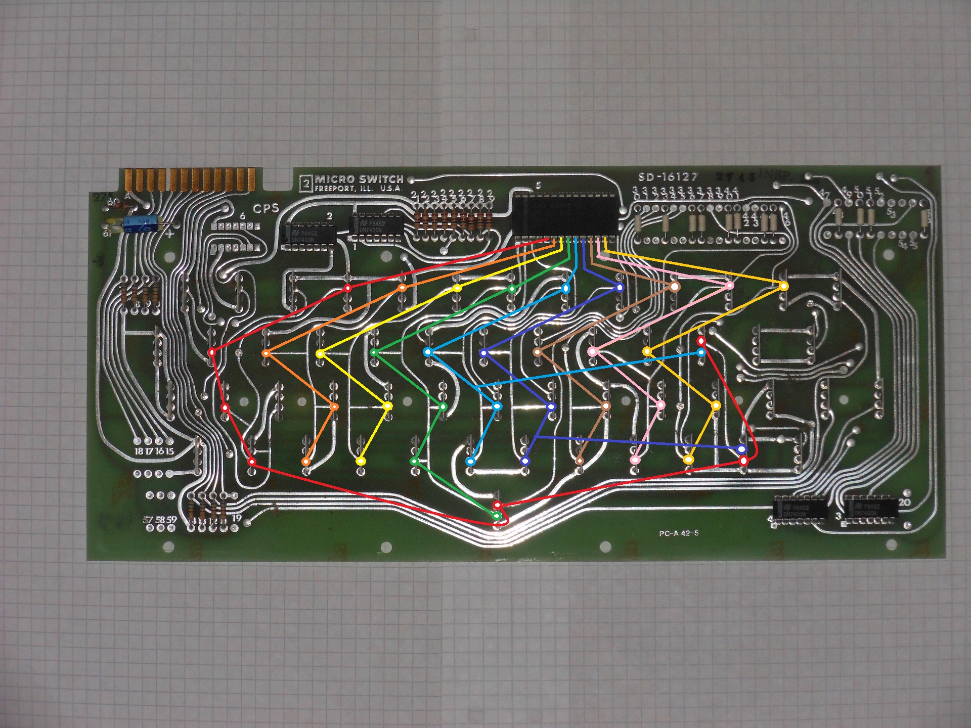

3) Todays edition of "Multimeters are fun", brought to you by mister Paint. This is basically the same information as in Halvars table here. The only difference is that my arrow keys are all directly routed to the edge connector.
sense lines 1.jpg (1.01 MiB) Viewed 3993 times
sense lines 2.jpg (1002.46 KiB) Viewed 3993 times

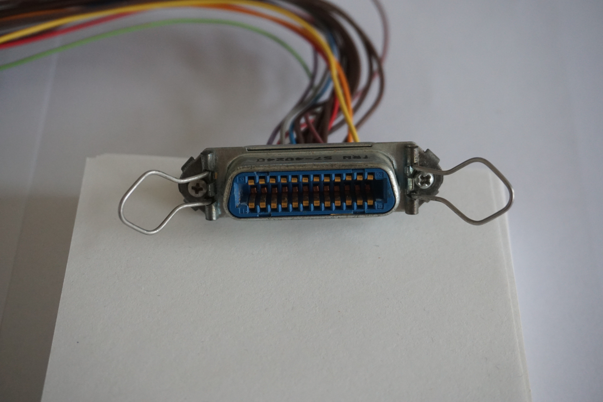

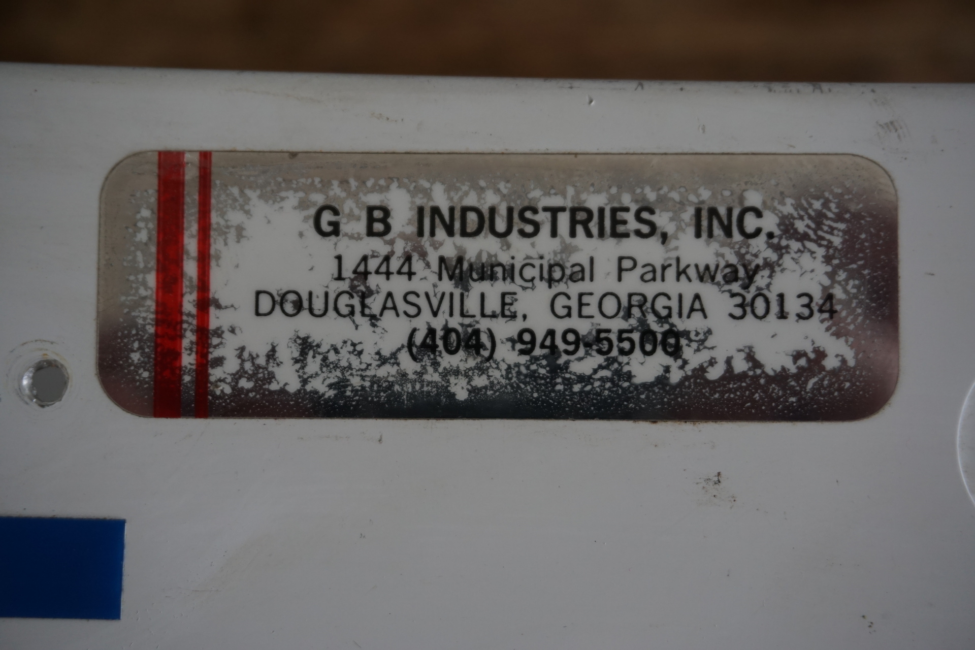

4) The connector at the back of the keyboard is indeed centronics, and I now have the matching piece to connect a cable:
centronics 1.JPG (778.63 KiB) Viewed 3993 times
centronics 2.JPG (647.3 KiB) Viewed 3993 times
