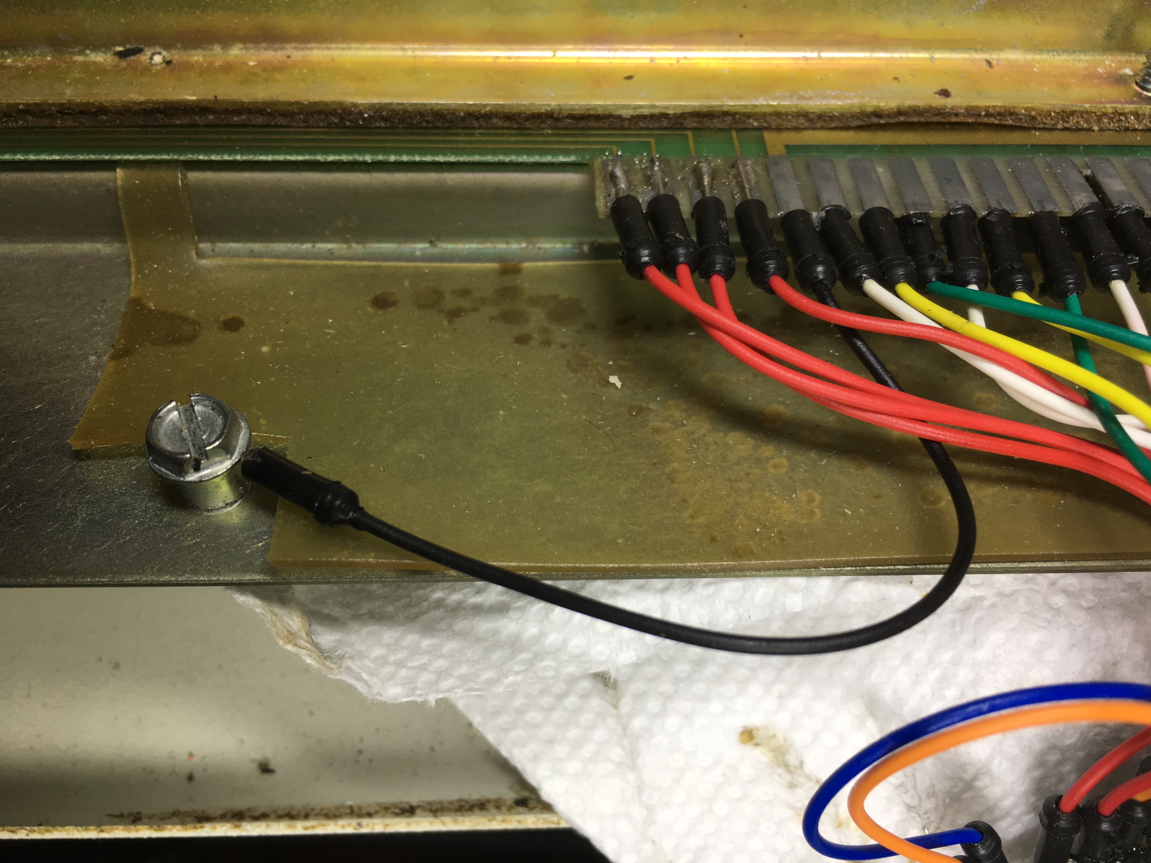

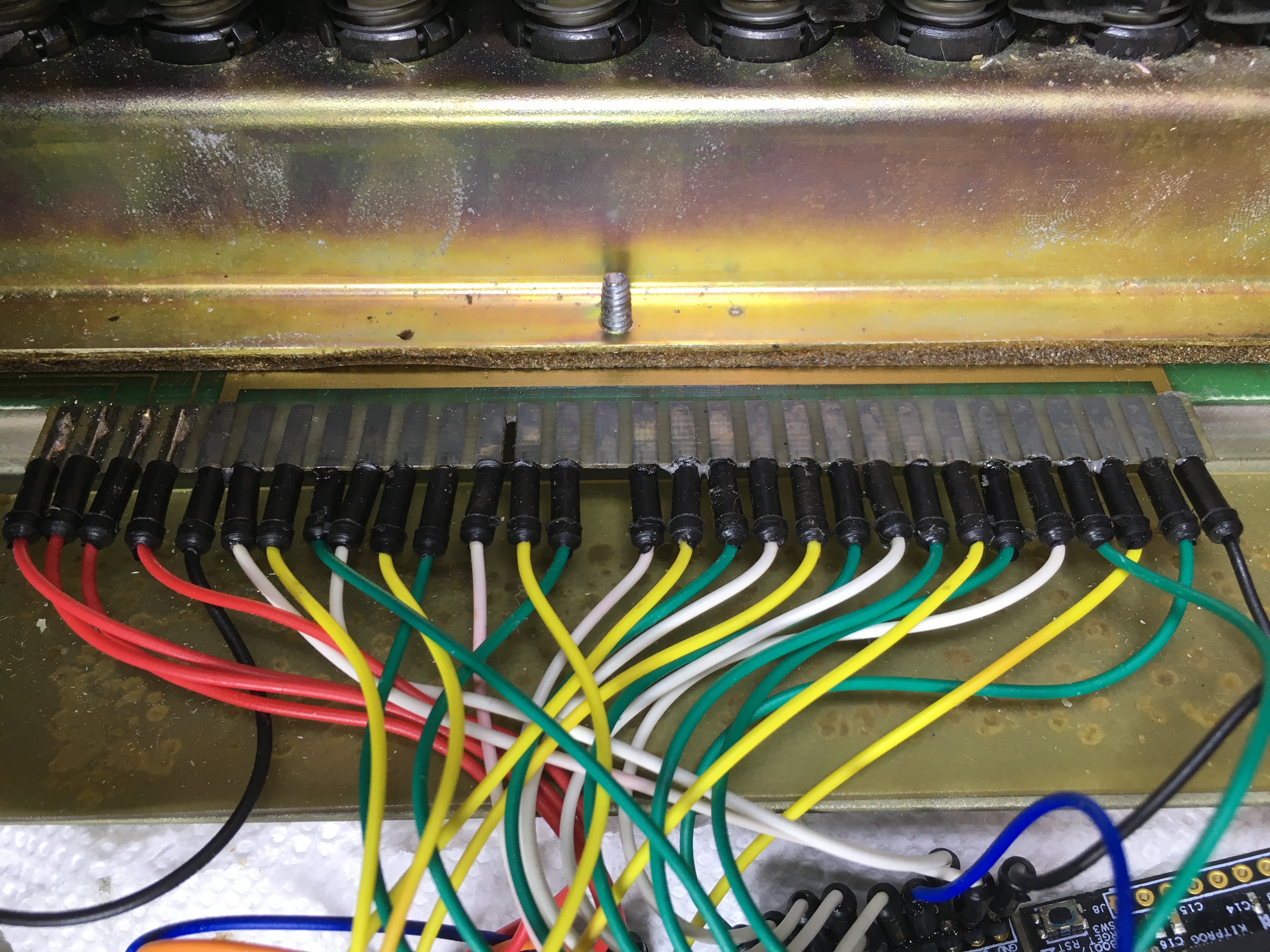

As I'm prototyping I decided to solder the pins directly on like so using male colour-coded Jumper cables like so:
What are the colours I hear you ask?
[*] Red - Rows.
[*] White / Green / Yellow - Different locations on the protoboard for columns.
[*] Black - Da Errfs.

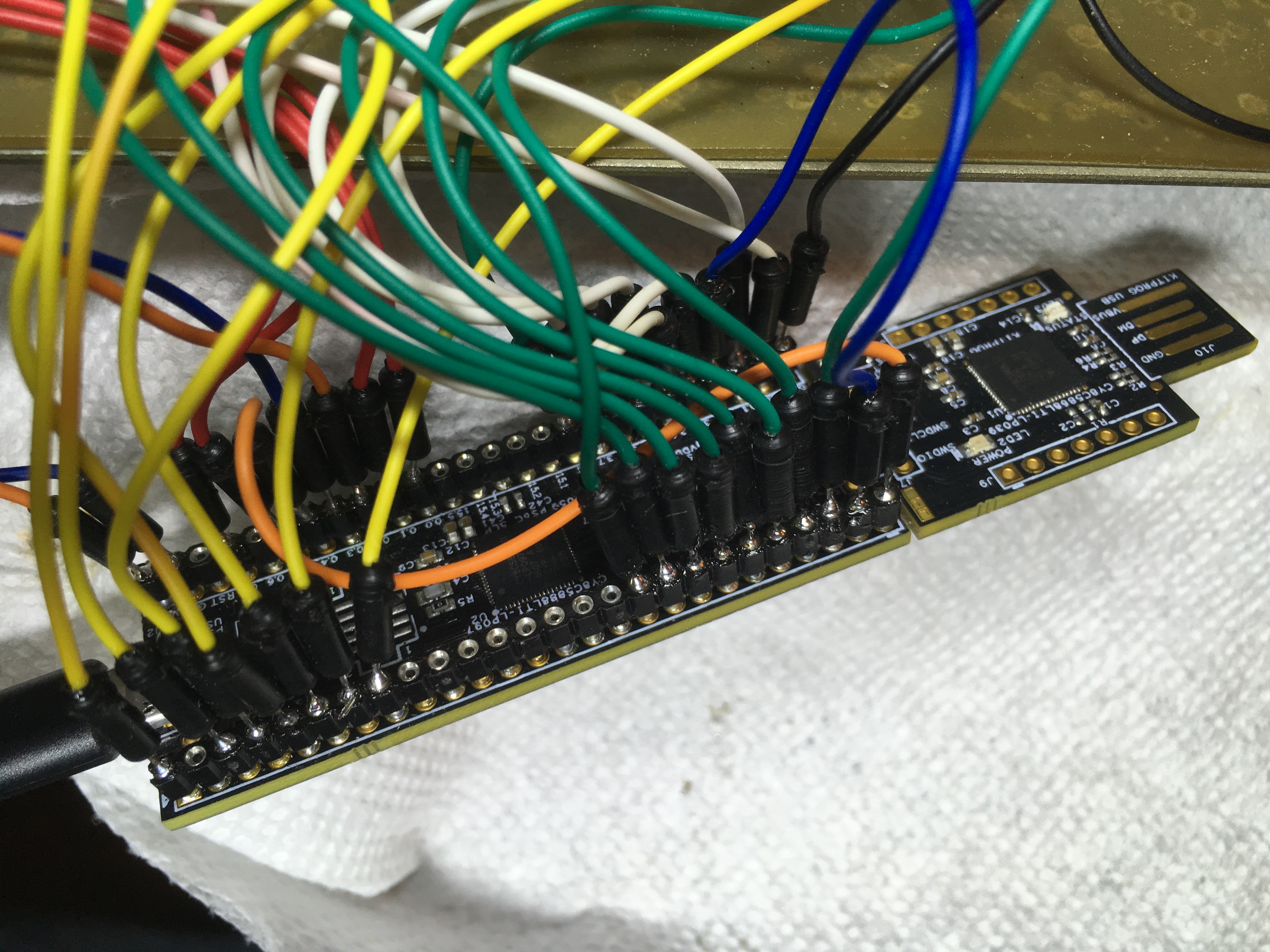

So, to the protoboard - it looks like so:
Now the colouring probably makes more sense as you can see that the columns are grouped. Why oh WHY did I align the columns in that strange round-in order? I'm paranoid about cross-talk so I figured I just wouldn't take the risk.
The observant may also notice that I soldered in female sockets along the edge. As I'm prototyping I know for sure I was going to be re-locating cables around so I made my easy. Now they're in a permanent spot I simply dropped a dab of solder on each one to keep the male jumper engaged with the female socket.
Finally - da errfs:
Yeah - I can do better and I will... but that will be done properly when I'm done with the cleaning.

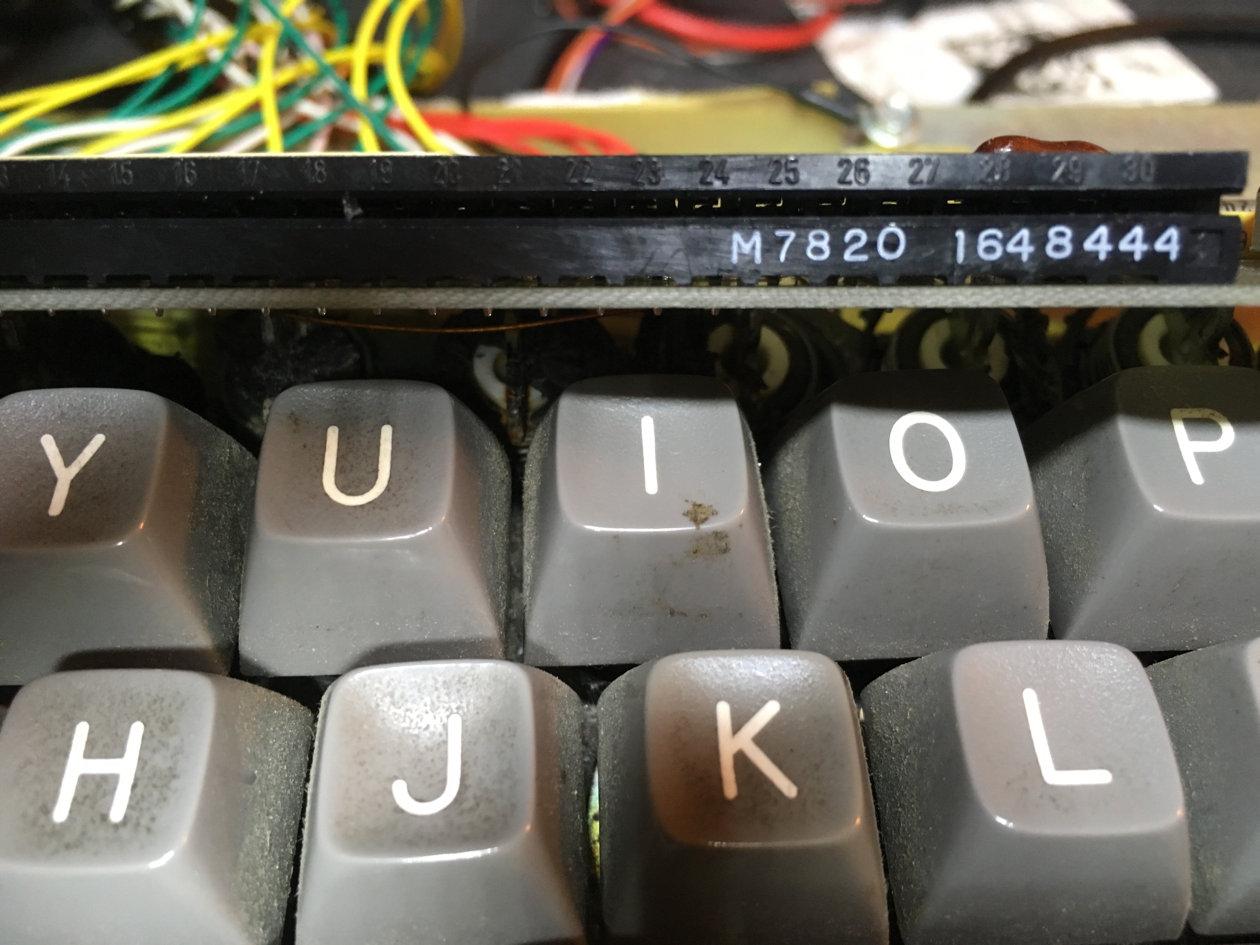

__red__ wrote: ..that I've not managed to locate an edge-connector which is accurate enough in its specs for board thickness that I was willing to trust.
Which raises a question - what IBM was actually using.
Haven't seen a beamspring controller - but it looks like they just use standard edge card connector (rated for min. 1.57mm IIRC). If it didn't bother IBM - why should it bother you?
What's the part number on the connector? There must be something there.
__red__
11 May 2017, 02:57
It's visibly thinner than one is used to seeing...

Great job on converting your IBM 5251 Beamspring but I would just like to ask how could you connect the solenoid driver up to the CY8CKIT-059 development board?
if you could help me out with that it would be much appreciated.
DMA
20 Jun 2019, 16:38
there are "exp header" pins - those should go to solenoid board
