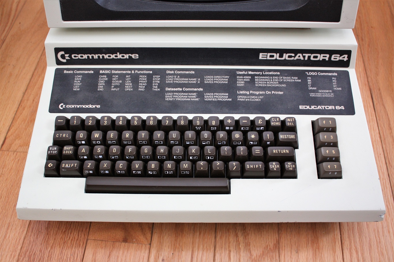

The Commodore Educator 64 is a rare bird that was a cross between a Commodore 64 and Commodore PET. It's purpose was for educational use so that it provided Commodore 64-like computing in a Commodore PET case (it was harder to walk away with a PET than a C64). It was also a computer with keyboard and monitor all built into one unit.
This computer has a slightly modified Commodore 64 motherboard and a slightly modified keyboard in that the cable is much longer (so the case could open fully). I don't know if there are any other differences. It's pretty much like a C64 but I took some pics while I had one open. This is one of my favourite computers in my collection.
Educator 64 - with keyboard displayed
Educator 64 - with keyboard displayed.JPG (425.85 KiB) Viewed 3885 times

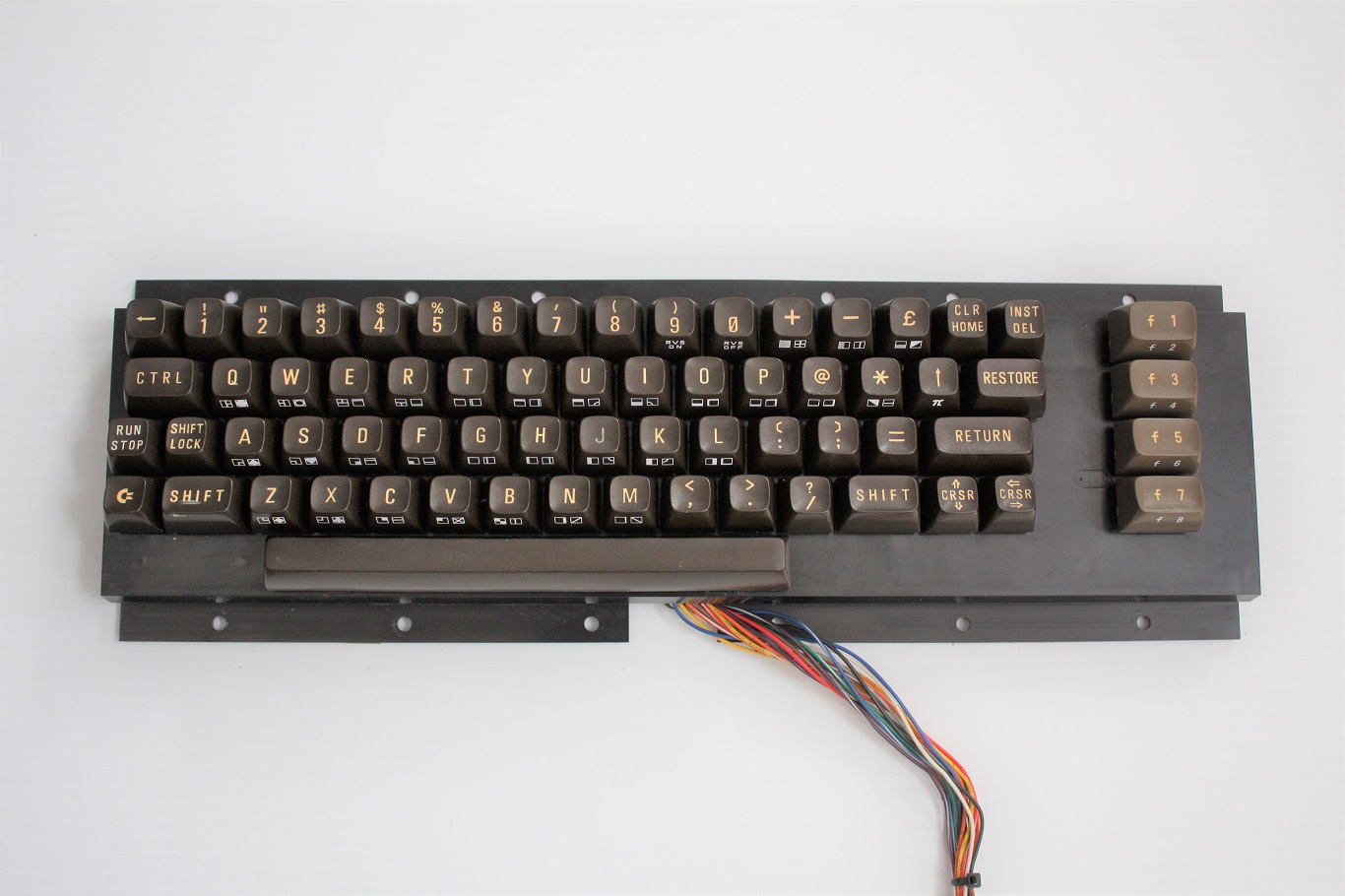

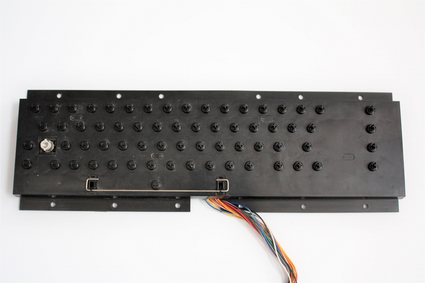

Educator 64 - keyboard mechanism top
Educator 64 - keyboard mechanism top.JPG (255.51 KiB) Viewed 3885 times

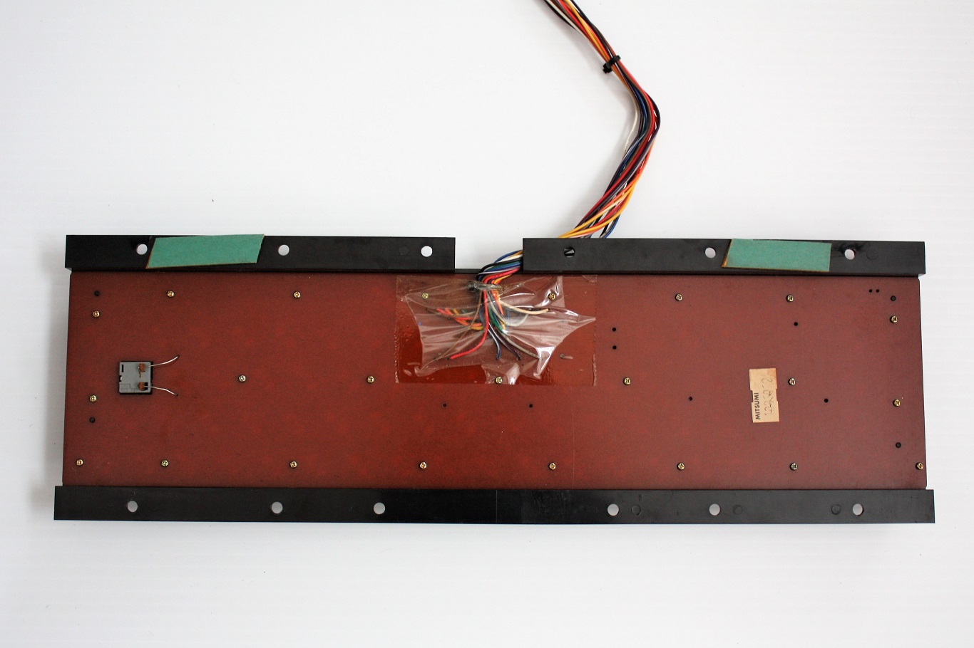

Educator 64 - keyboard mechanism bottom
Educator 64 - keyboard mechanism bottom.JPG (231.98 KiB) Viewed 3885 times

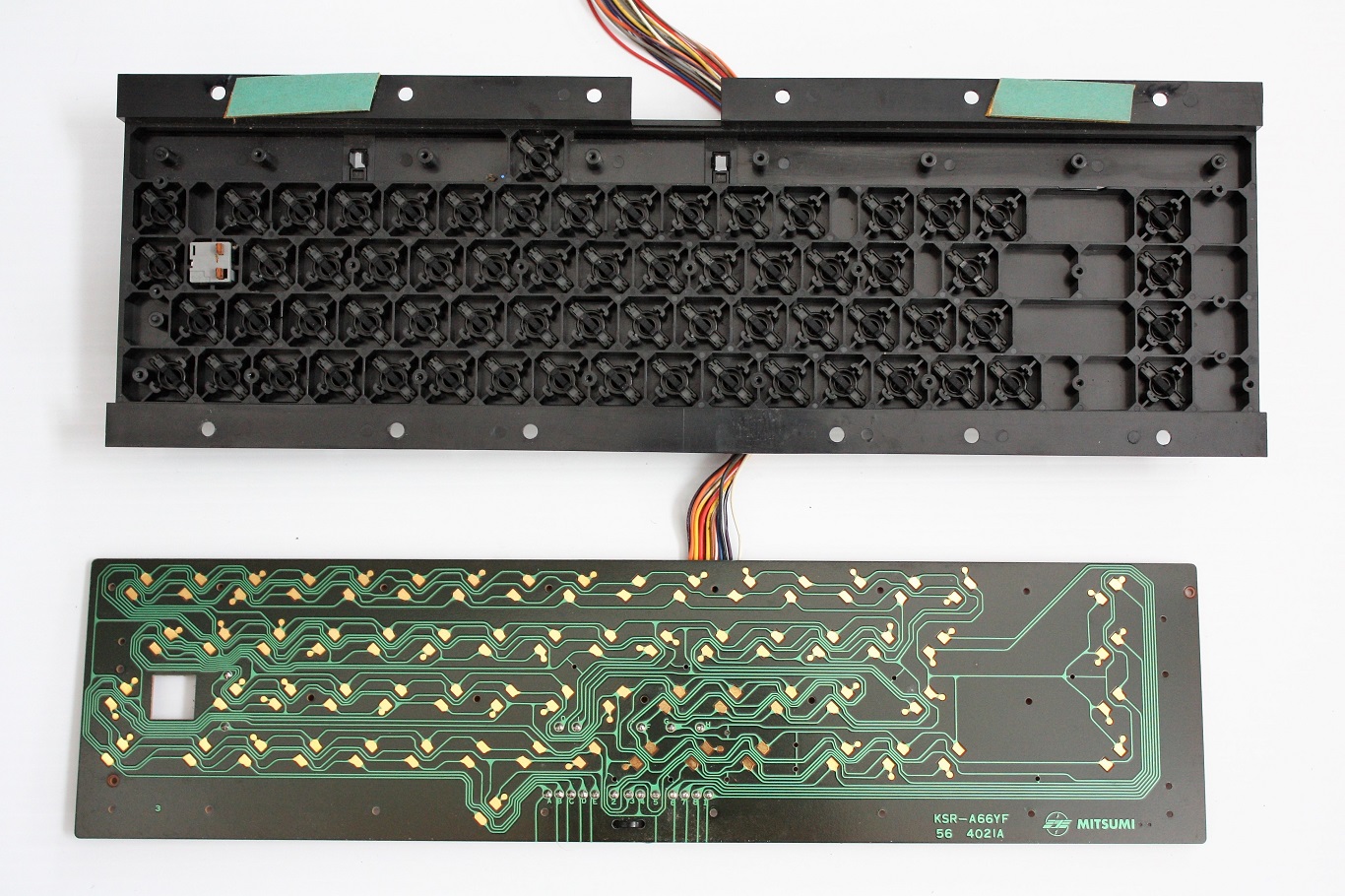

Educator 64 - keyboard mechanism internals
Educator 64 - keyboard mechanism internals.JPG (448.39 KiB) Viewed 3885 times

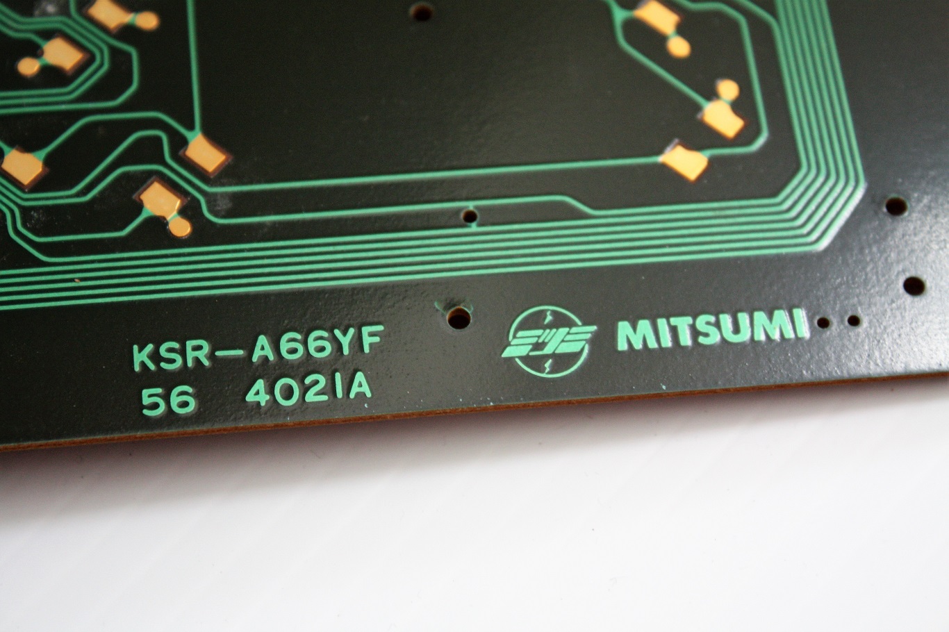

Educator 64 - Mitsumi KSR-A66YF keyboard PCB markings
Educator 64 - Mitsumi KSR-A66YF keyboard PCB markings.JPG (339.13 KiB) Viewed 3885 times

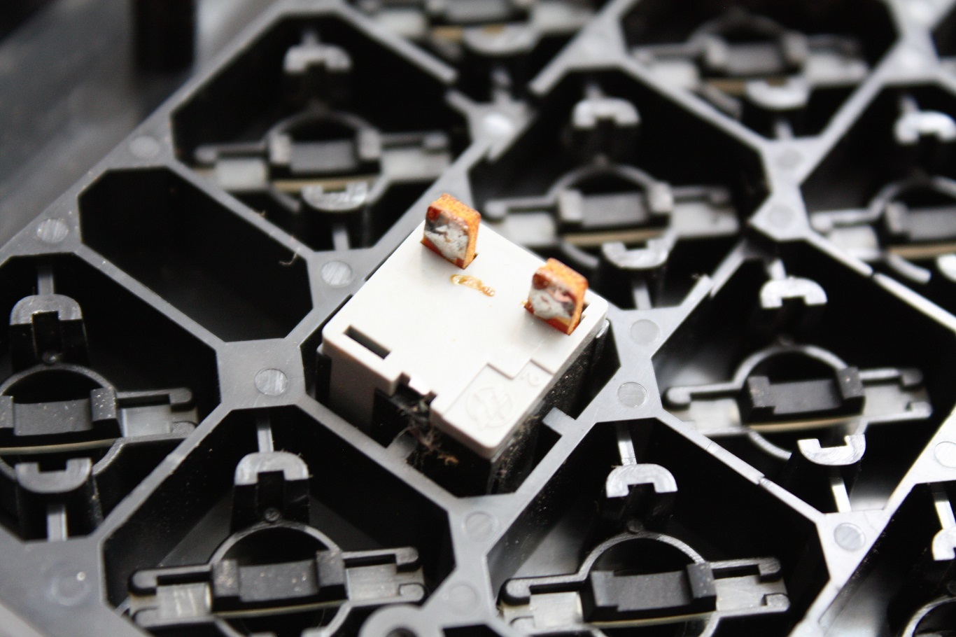

Educator 64 - caps lock bottom
Educator 64 - caps lock bottom.JPG (313.73 KiB) Viewed 3885 times

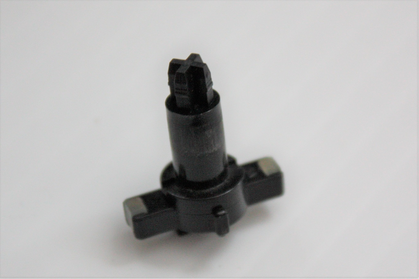

Educator 64 - key stem
Educator 64 - key stem.JPG (221.63 KiB) Viewed 3885 times

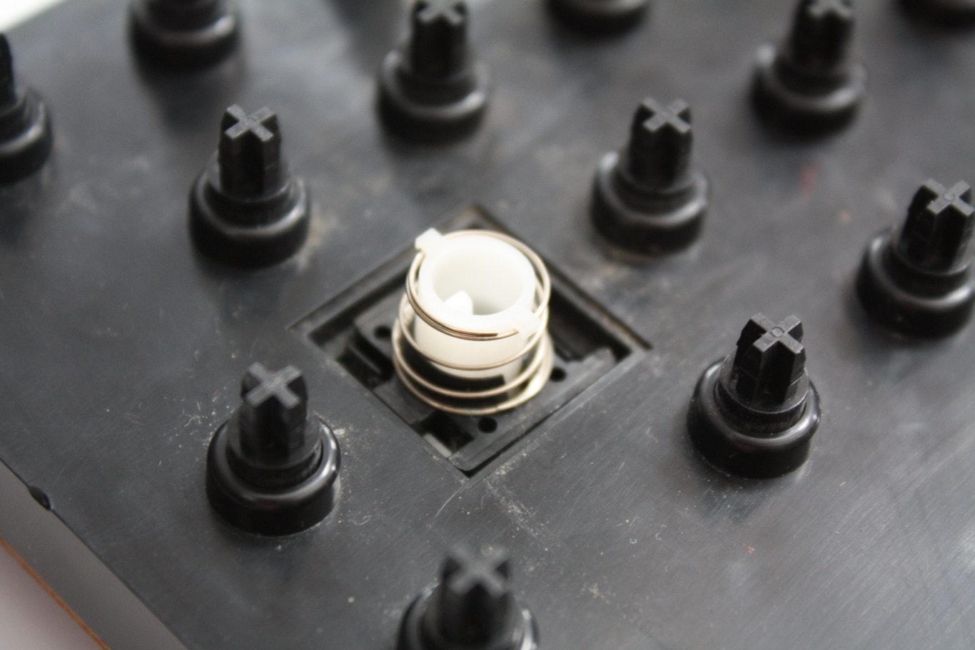

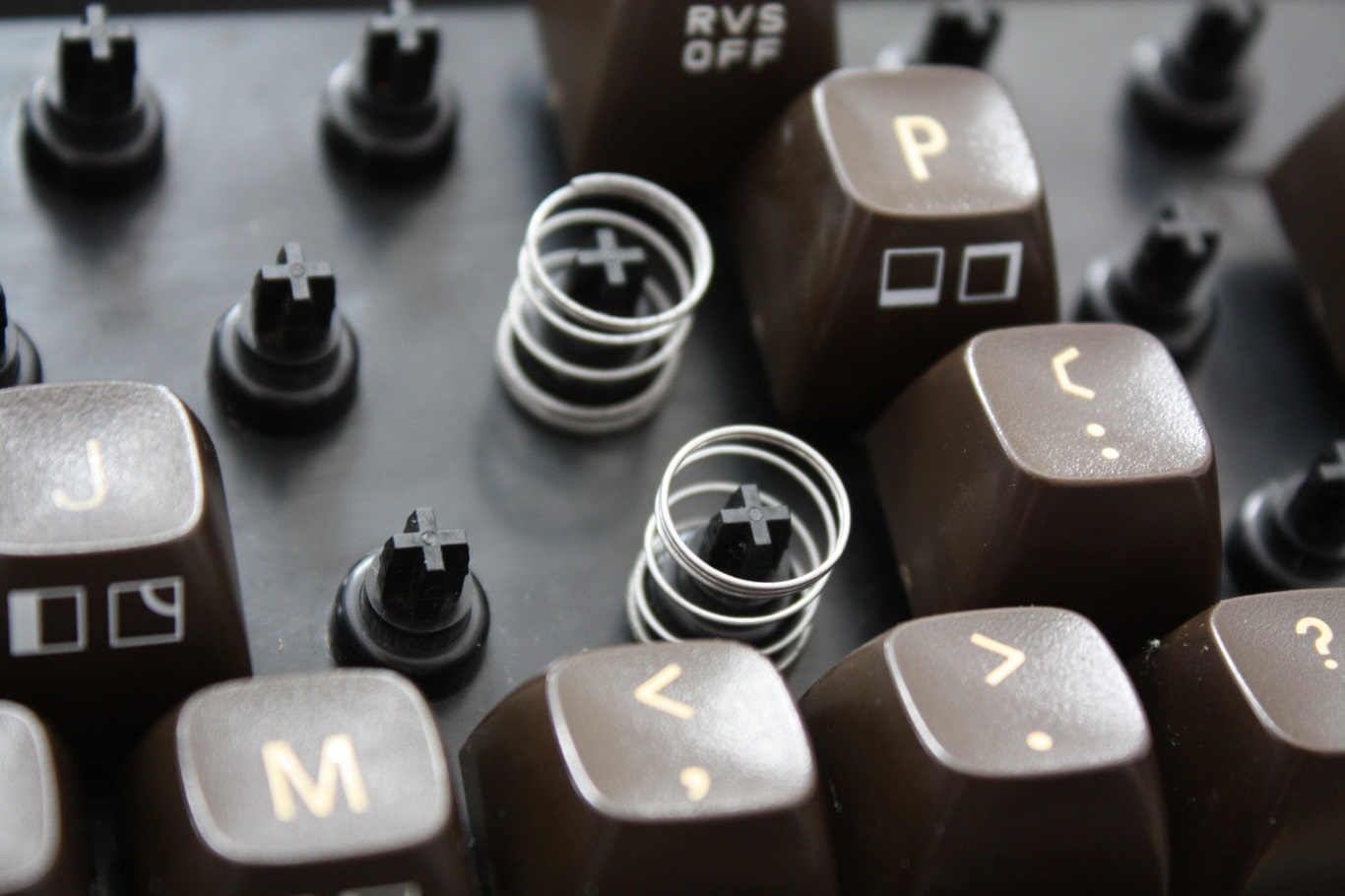

Educator 64 - key switches with springs
Educator 64 - key switches with springs.JPG (268.01 KiB) Viewed 3885 times

What does the label on the back of the keyboard say?
Mine's from August 84.

Daniel Beardsmore wrote: What does the label on the back of the keyboard say?
It's a number that is not stamped very well but I think it says. Mitsumi 10950621 It didn't look like a date code to me and there are no electronics on the keyboard.
06 Jun 2017, 09:37
It's definitely a date code, but I also thought it looked like "95". Having seen the bottom-heavy "8" on mine, I'm guessing the decade is "8", and the day of month looks to be "21".
The photo is too low resolution to make out the rest of it. Maybe it is 85.
Basically, these keyboards are getting weirder by the day. The VIC-20 started out with a gaffer taped PET derivative, then onto something with rubber domes glued to the PCB, and then onto the hybrid switch type identical to the C64. I'm trying to determine the date sequence for the various types and in particular how this relates to the introduction first of the fat switch for shift lock (seen above, replacing Futaba lock seen as late as 1983) and then the Mitsumi standard mechanical that came along by the time of the M0110A and C64C.
Compounding this is the likelihood that, despite their hopeless indecision, they likely retained the older shift lock switch type for later production runs of the same keyboard, even if newer keyboards had been changed. I don't however know for certain what the earliest C64 had: Futaba the same as the PET/1983 VIC-20, or fat Mitsumi the same as later C64 variants.

Daniel Beardsmore wrote: It's definitely a date code, but I also thought it looked like "95". Having seen the bottom-heavy "8" on mine, I'm guessing the decade is "8", and the day of month looks to be "21".
All of the pics are high-res. I just resize them for posting here in the forums. The high-res ones go on the wiki. To be honest, I just looked at the high-res pic to see what the date code was. When I get a chance, I'll open up all three but they would all be manufactured in the same time frame. These Educator 64s apparently used refurbished Commodore 64 (C64) motherboards so the date codes on the ICs will be all over the place.

The sticker isn't readable on the photo above even if you have a higher resolution version elsewhere — I don't have NSA access to your hard drive.
