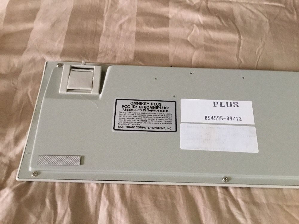

Could the sticker in the backplate that reads "89/12" be taken as an indication of the year of manufacturing?
Sticker on Back plate
Engicoder
10 Jul 2017, 00:04
That is definitely one of the earlier rear label stickers, so I would be very confident they are complicated (SKCM) alps. Most likely white.
