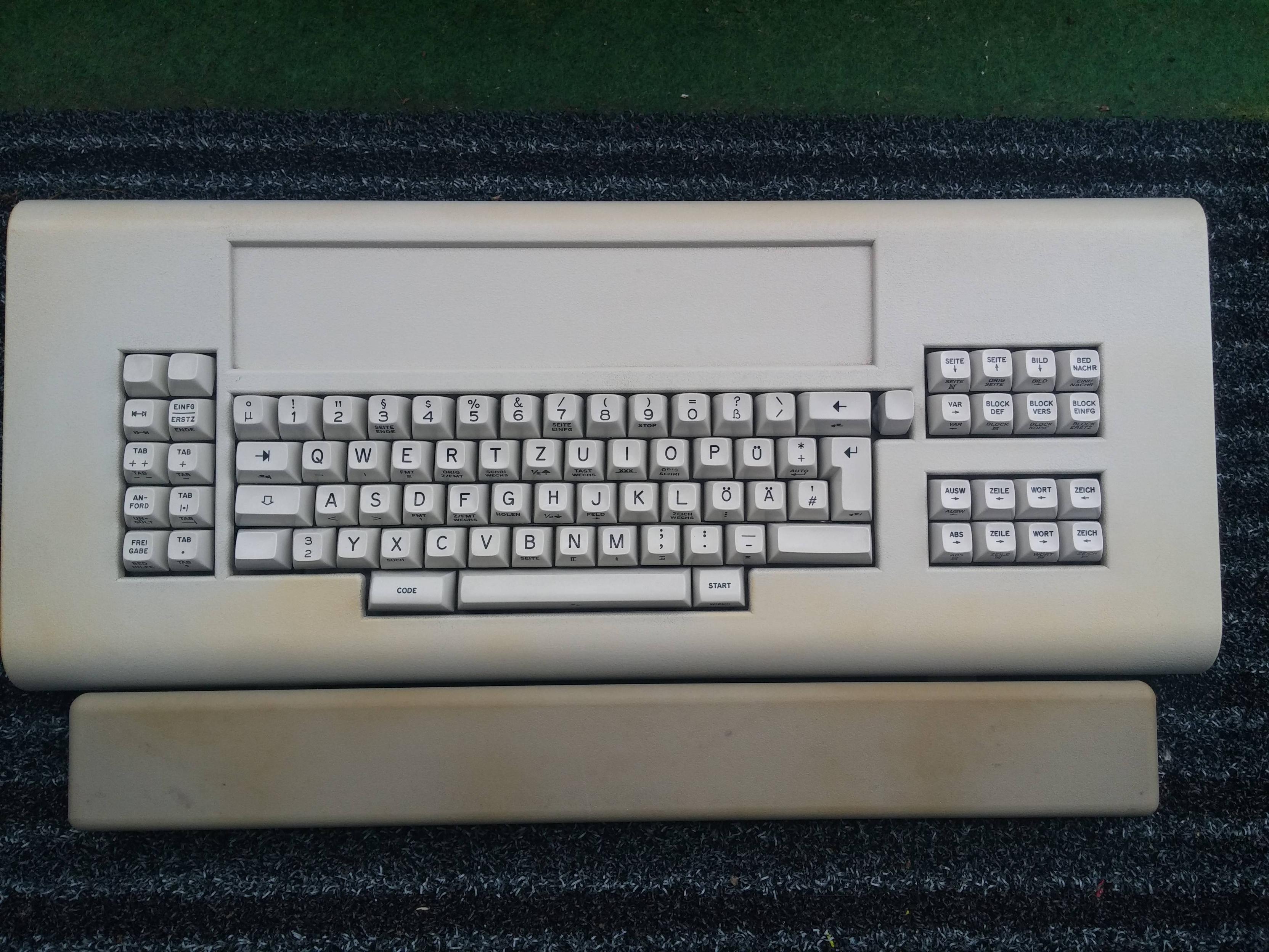

To me the 3276 and 3278 have the most usable layout and they are not so very insanely bukly as the 5251 for example. None of the Beamsprings have modern "practical" layouts. The Displaywriter layout is actually pretty good but it's just such a huge bulky beast to use.
Here is hammelgammler's with that cool wrist rest:
photos-f62/ibm-displaywriter-wrist-wrest-t13935.html

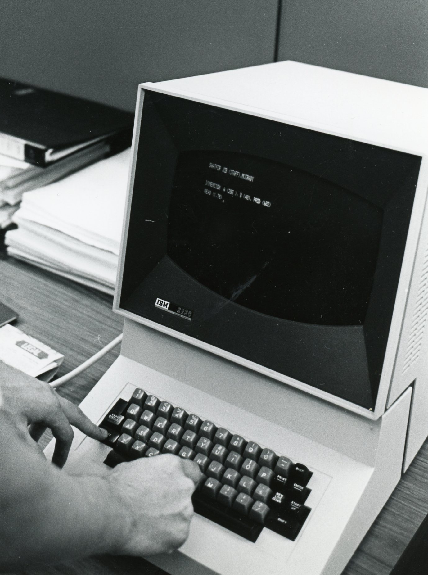

The mechanisms behind the IBM 2250 and 2260 (the predecessor of the 3270 family) keyboards are, as far as I know, not yet known on this forum. Judging by their layout and containers, I am inclined to think that they may be derivatives of the Selectric mechanism, but this theory I have nothing except superficial similarity to support.

Possibly the electric mechanism of that IBM card punch keyboard I don't have the link now. Here is a IBM 2260 terminal in Ryerson Computer Centre:y11971alex wrote: The mechanisms behind the IBM 2250 and 2260 (the predecessor of the 3270 family) keyboards are, as far as I know, not yet known on this forum. Judging by their layout and containers, I am inclined to think that they may be derivatives of the Selectric mechanism, but this theory I have nothing except superficial similarity to support.

That too is a possibility. I will note that I'm 10 minutes away from Ryerson by foot, so I might call on them and ask for the keyboards
