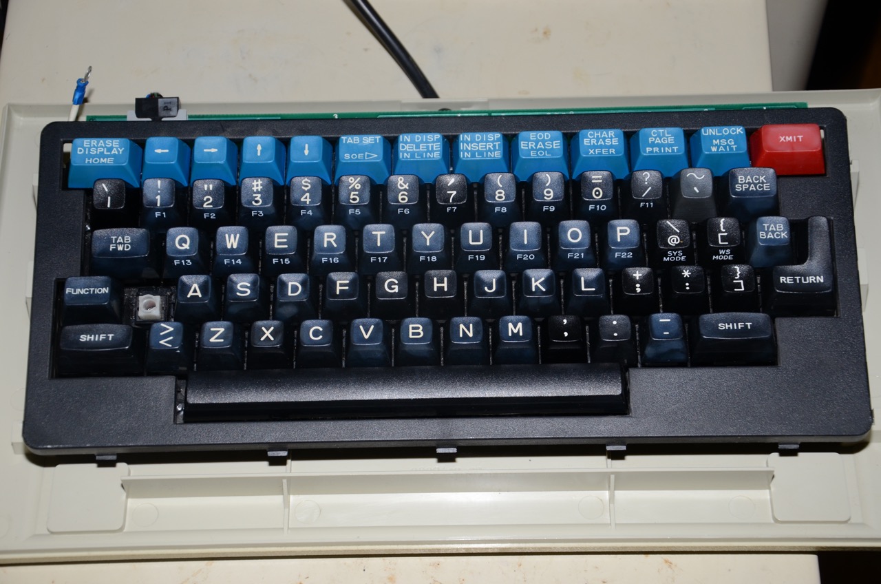

A while ago I bleached a keyboard that I really like and left it worse for the wear. In particular, some key caps were quite bleached. You can see more details here:
photos-f62/retr0bright-a-cautionary-tale-t10065.html
Blanched keys, oh no!

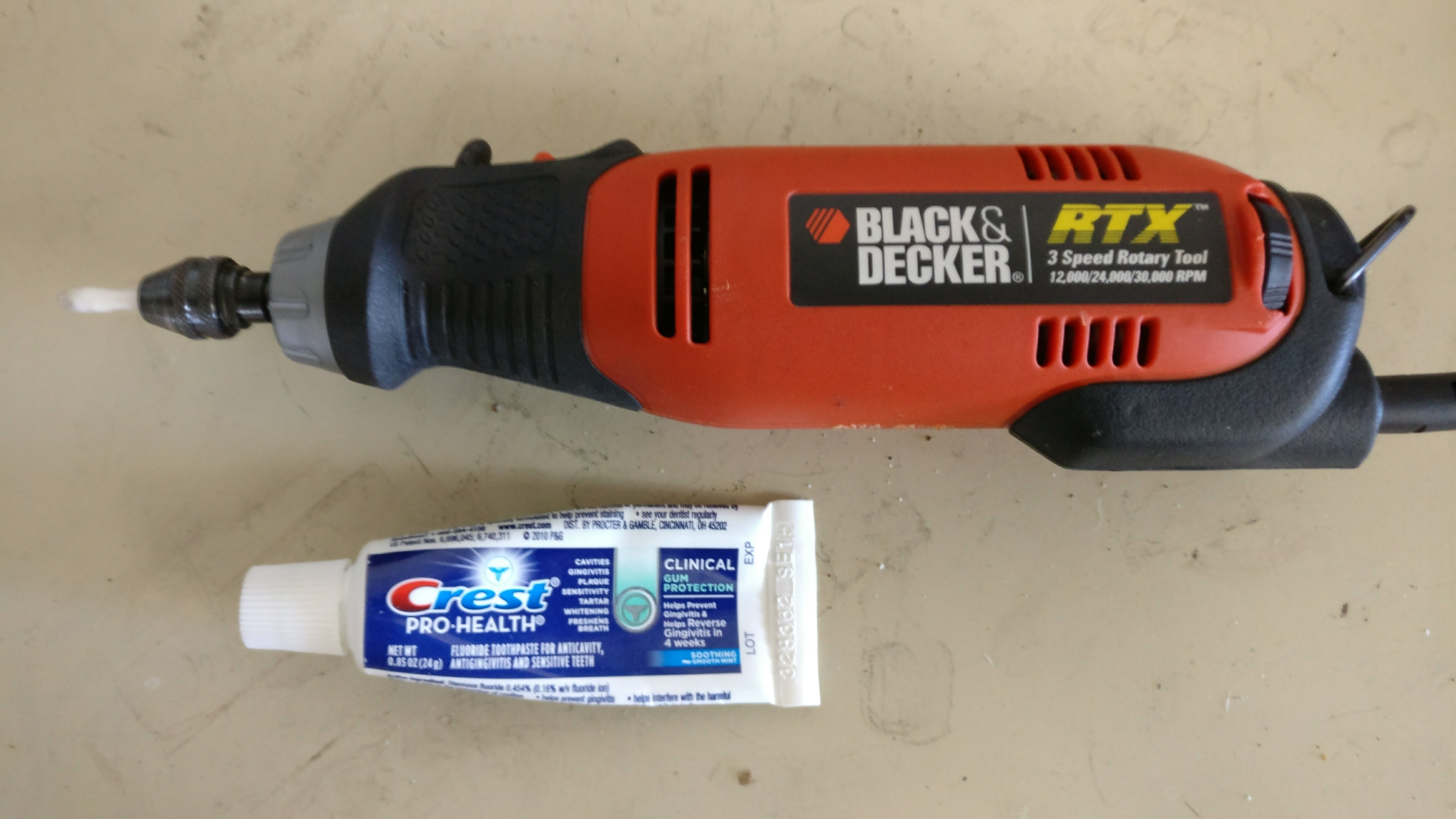

I knew that I had polishing wheels for my rotary tool ("Dremel") somewhere but after five minutes of searching I was fed up. So I worked backwards and thought, what could I use for polishing with readily available household materials? I decided to cut a Q-tip cotton swab in half, stick it into my rotary tool's collet, and use a polishing compound. I was unable to find my compound, so, I decided to give toothpaste a try since some people use this for restoring car headlights. The speed was just off of low - maybe about 15,000 RPM.
Polishing tools.
Polishing tools.

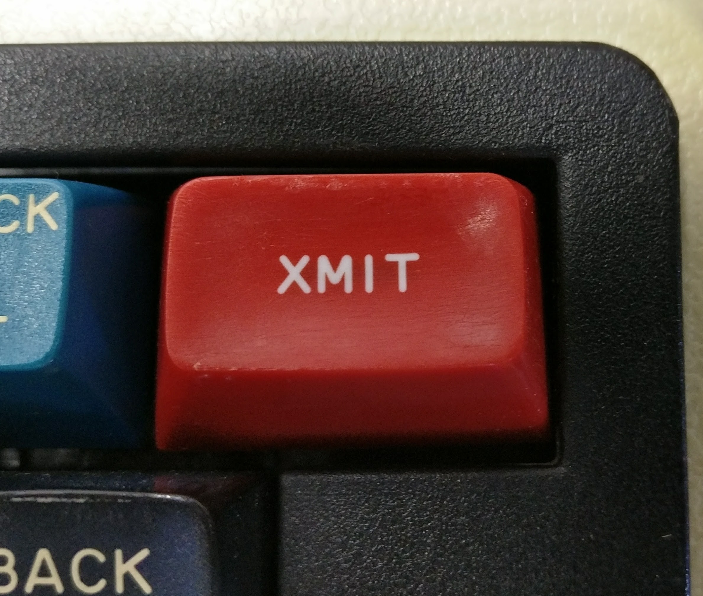

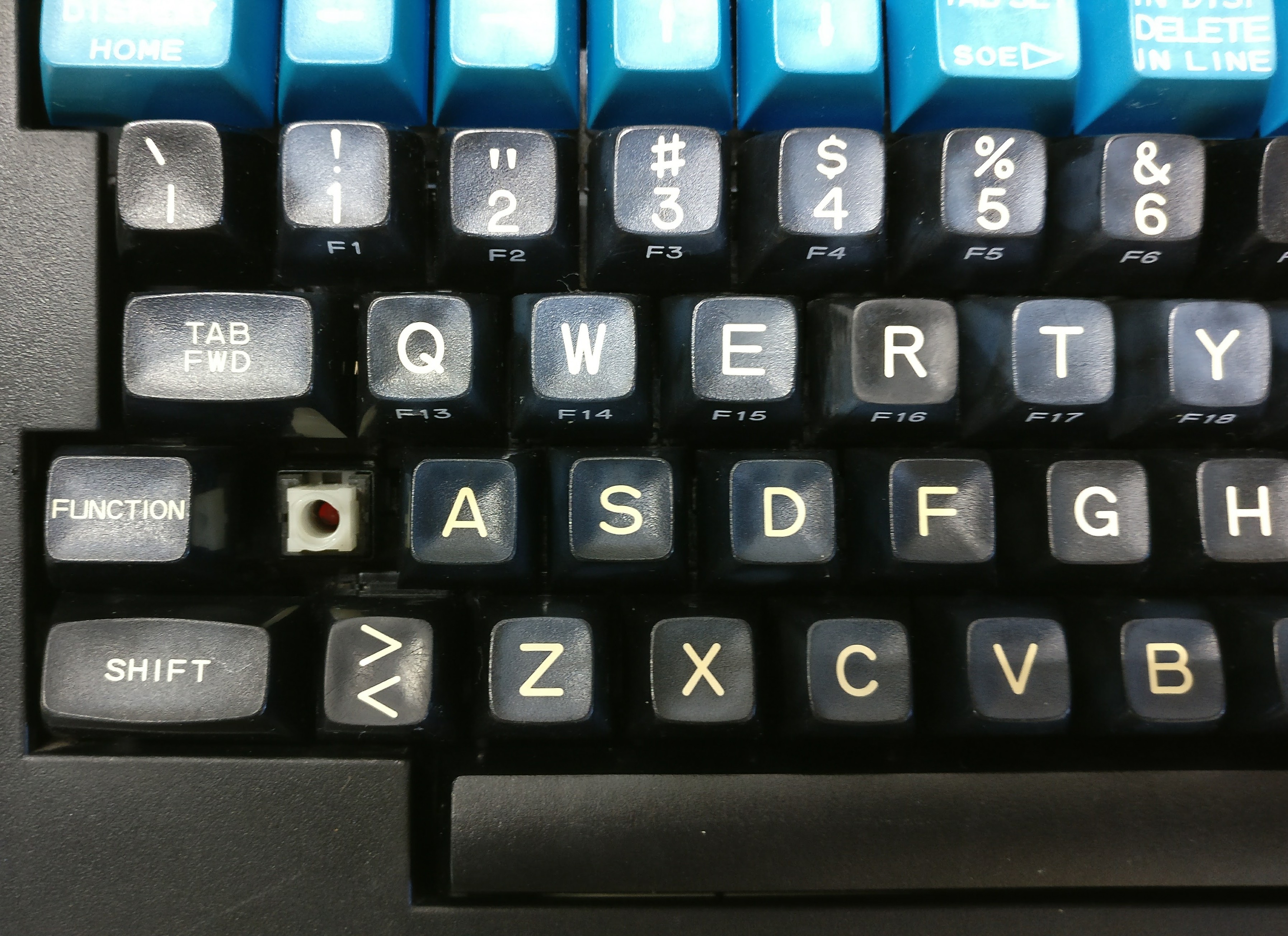

The results were better than expected! The technique can certainly use some refinement but things got better! I treated the Q, ><, R, and XMIT keys with this and they are at least looking better than they were before.
Key contrast: Q, R, and &gt;&lt; are a little lighter.
Key contrast: Q, R, and >< are a little lighter.
The original XMIT key, closer to its original condition.
It's dead simple. 320-grit sandpaper, rotary tool with collet, cotton swab, scissors (to cut the swab), toothpaste. It works really well! It leaves the key cap with a satin finish, which is nice for giving some new texture to a well worn key cap. The resulting finish is smoother and more even that using a green Scotch-Brite abrasive pad, without gouging, but not nearly a full gloss. (I would test this on the far facing side of a key cap or on a spare key cap to see for yourself just what the effect is.)
