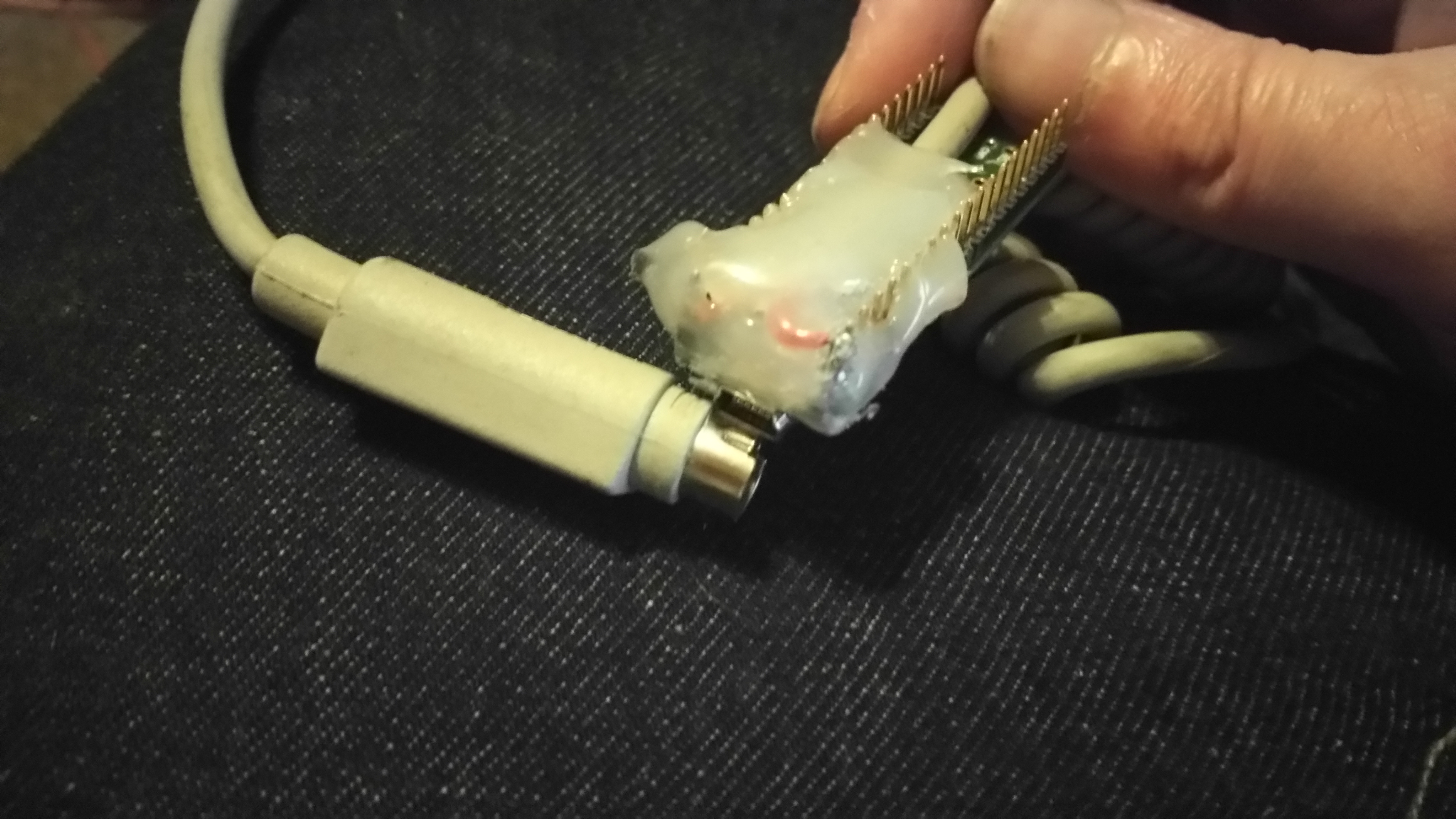

Is there something wrong with the open source firmwares to do this with the teensy? That is what I use and have no problems. It does sync lock keys(except caps lock, which acts strange because it is latching, I don't know how it couldn't act strange :P). However, I only use windows, and not mac os. The power key on mine changes modes. I can't tell exactly what changed, but I assume it is for compatibility.
Oh, I use mine on an original AEK. Uses the TMK library.
It's not pretty, but hasn't failed me.
