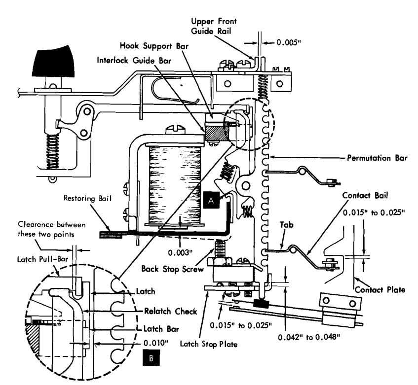

Here's a video of the IBM 129, which according to this maintenance manual (page 26) has the same keyboard mechanism. It has a internal 80 characters storage, so that mistakes can be fixed before the card is punched. This has the side effect that one can hear the switches :)
But thinking of the card punching mechanism as one big clicker is just way cooler :D
Slom
19 Oct 2017, 20:14
Chyros wrote: That mechanism definitely looks like it has a lot in common with the Selectric, though in a different way.
Well what I understood from your review of the Selectric was that the whole ball positioning was mechanical?! I need to watch it again, and compare the manuals.
The Theory of Operation manual for the 029 has a very detailed description starting from page 27.
This one has electrical contacts, but the whole key to "scancode" conversion seems to be mechanical. The interlock (mechanical anti ghosting) seems very similar to the Selectric indeed. One interesting thing (from the way I understood it) is that the spring under the key is only responsible for the return of the key itself, not the contact mechanism. That part is done by a magnet it seems, a solenoid with a purpose one could say ...
