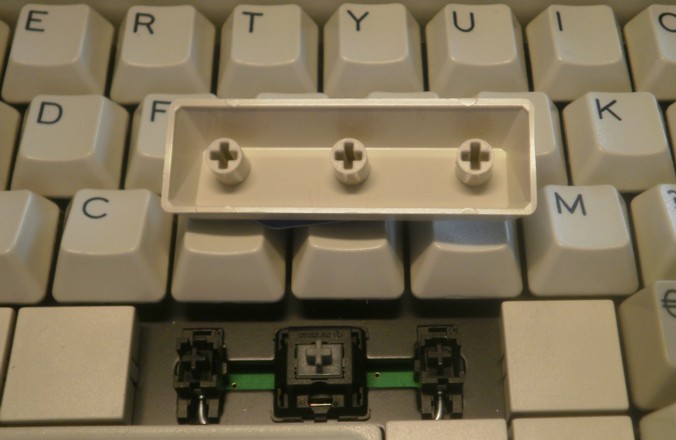

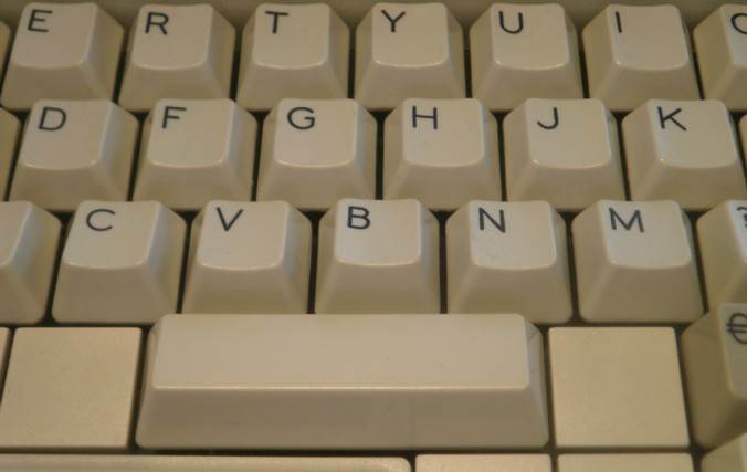

22 Oct 2017, 08:48
The option with dummy switches (i.e. switches without a spring) is a good idea (and, by the way, the standard solution used by Tipro in their keyboards). My Enter key works flawlessly with that.
3u space bars, exactly fitting 3 switches, but nevertheless using a stabilizer, can be found in Acces-IS point of sale keyboards
(own pics, sadly the the stabs were tossed long ago):
(ninja'd by t8c :mrgreen: )
