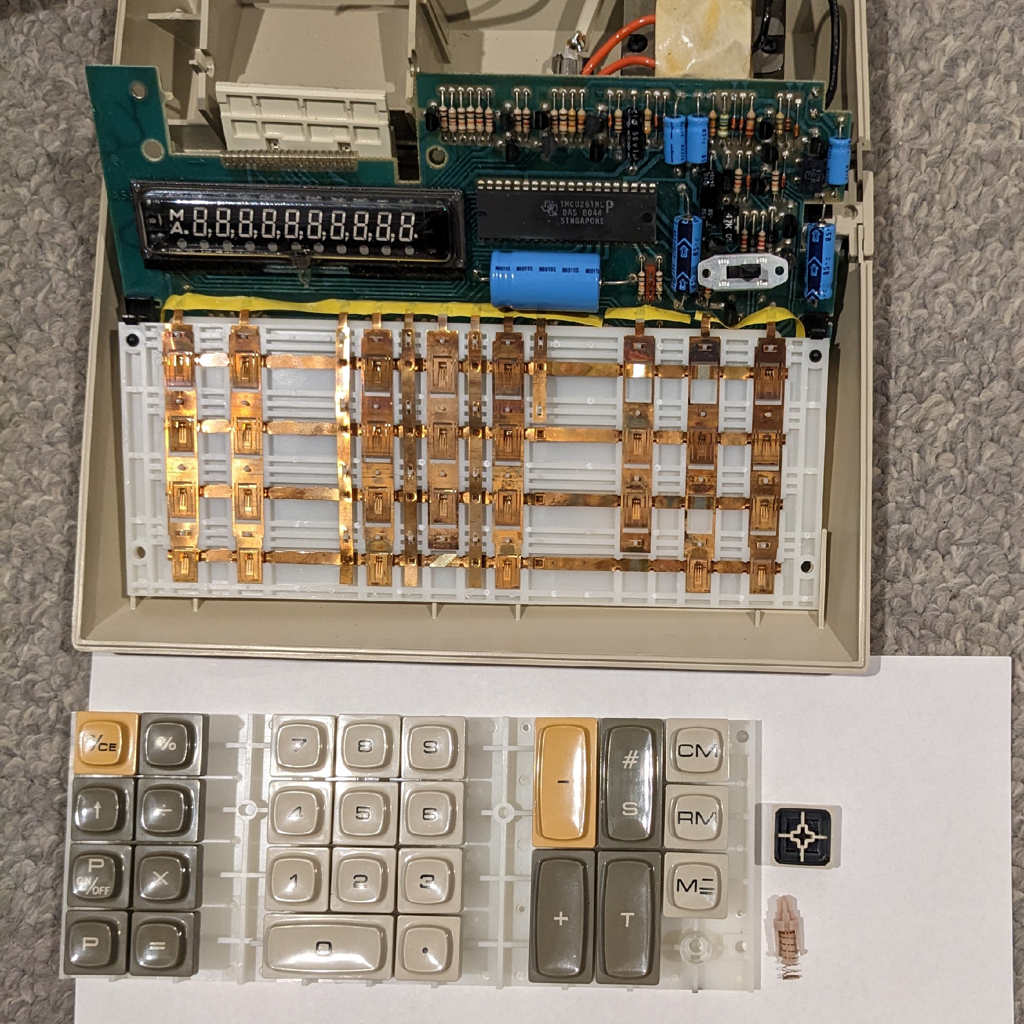

Reviving a old topic here. I also recently picked up one of these old adding machines from Goodwill. I didn't know what it was but the keycaps looked nice at the very least and they felt like maybe some vintage linear switches in them. Here's an additional picture of the switch plate disassembled...
It seems to use a combined leaf springs per column which is pushed down by a slider with spring for each switch. Interesting design and it makes for a decent feel. Similar to Fujitsu leaf spring, there is only really a downward push and no cam for a sideways leaf to register. So it feels pretty smooth. I'm not sure though where the actuation point is. I took it apart first so things probably aren't as tight as they should be. It does appear to register before bottoming out but it does feel near the bottom with little travel after actuation.
Like many old switches/keycaps, the stem is completely external so the keycap is filled with no room for the keycap to surround the switch like modern switches do. It does appear that the keycaps use the same thickness on the cross mount so an MX stem could fit well with the switch. MX keycaps do not fit on the switches though as the cross is larger in diameter. If I decide to use these keycaps in something, it would likely be with Choc switches using an adapter to MX mount which would sit completely above the switch. The choc switches help keep the overall height to be more normal with the extra height needed for the adapter.
