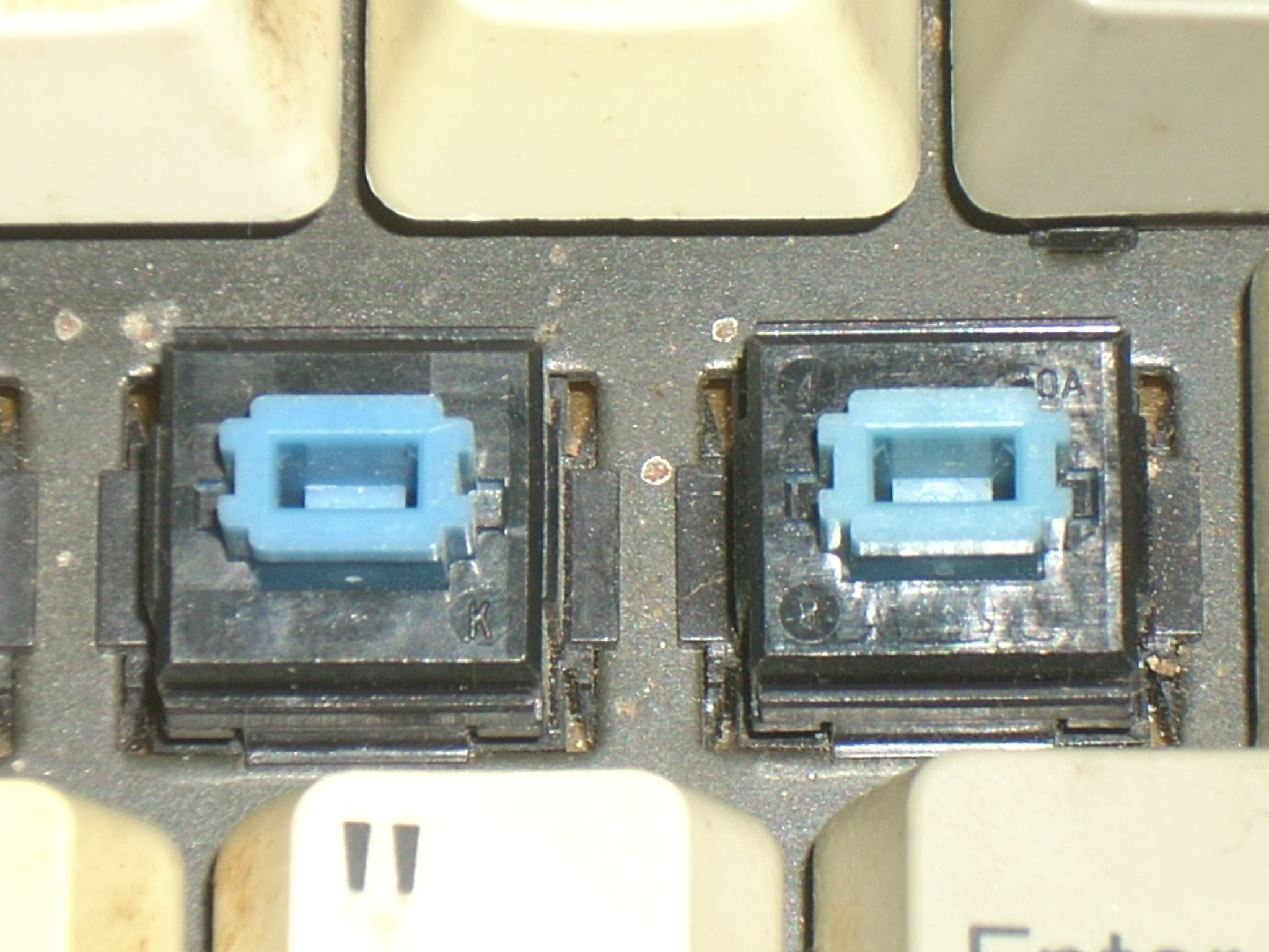

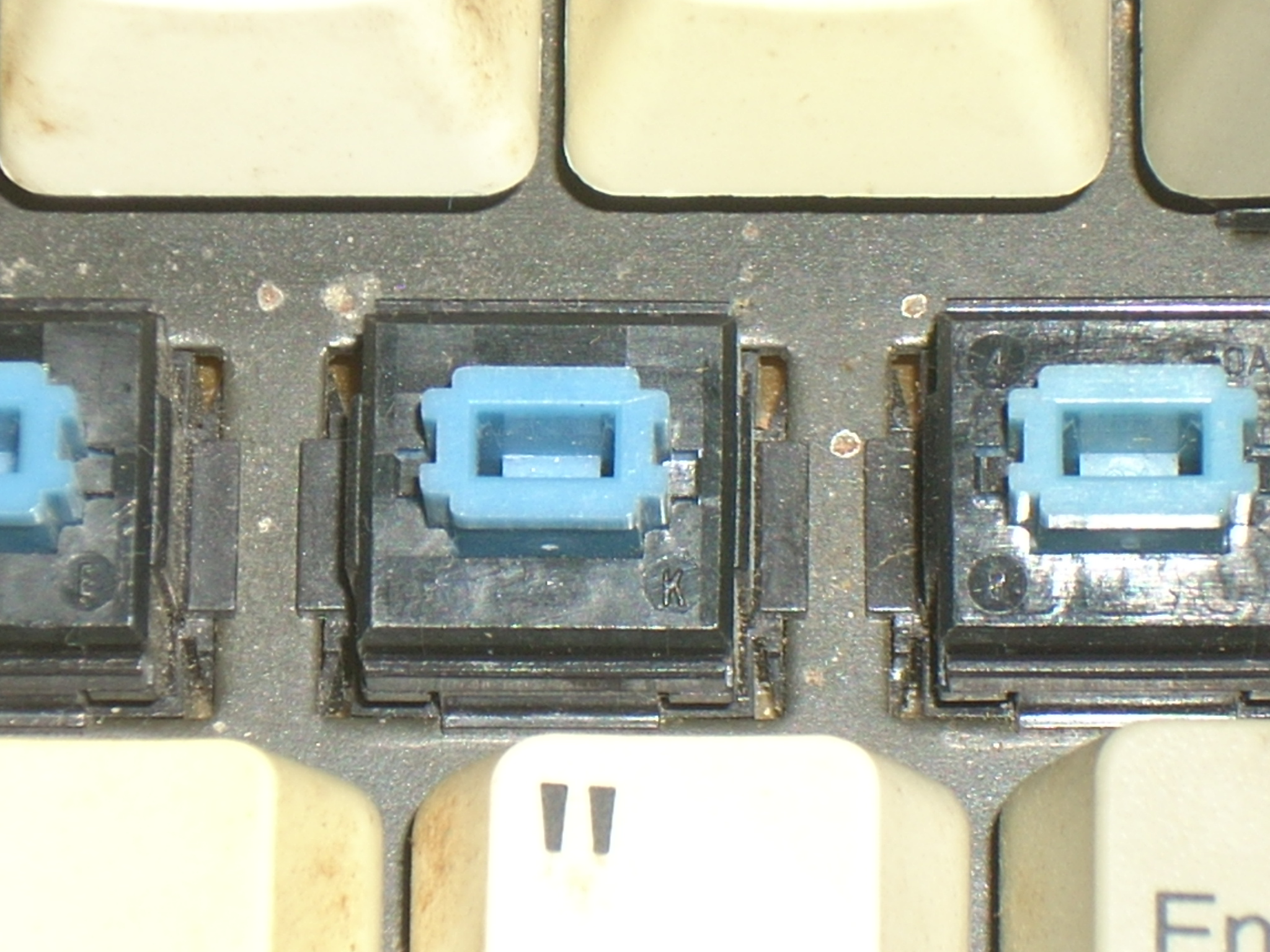

In digging through my blue Alps boards looking for branded upper housings I found something even stranger, to me anyhow. These are in a very early Northgate 102, sticker date July 1988, and about a third of the switches I've checked so far (two rows) have only a single alpha character on the SE corner, no other markings. The rest have the usual xxy on the NE corner and single digit on NW and SW, mostly 10X but a few 8x. Help me, Daniel B.! (or anyone else...) Is this a known thing? I opened up one of the alpha-only ones and it had a tall gray switchplate inside, as expected.

It is generally expected that blues 'have no alps logo on top'. There are some that did, but when they do have a logo on top, you have to struggle to see it. There is nothing out of the ordinary here.
I believe they will have a logo on bottom though, but that requires desoldering the switch. It is obvious, however, that these are not clones.

I've seen the faint logo on white SKCM, so I'm on board with that. What's strange here is the switches with no mold numbers on the upper right (NE). I suspect these are very early blues, but perhaps they're from a different factory or something? None of the others I've seen have this type of marking, or lack of.rich1051414 wrote: It is generally expected that blues 'have no alps logo on top'. There are some that did, but when they do have a logo on top, you have to struggle to see it. There is nothing out of the ordinary here.
I'll desolder one of each to check the bottoms. I've been soldering since I was nine or ten so I'm a lot more comfortable desoldering switches from a board than I am taking the switches apart.

It's curious though that looks like someone took an LED top shell and filled in the LED hole, and that one circle is where it would be on an LED shell. However, the LED hole is at the front, not the back, and those are the wrong slits for an LED top shell of that age.

More info on these switches. I decided to pull all the caps to see what I could learn. I'd divide the upper case markings into four types.
1) What I'd consider "normal" SKCM markings--letter NW, number-letter NE, number SW, blank SE. 30 of these in total. NE number is "10" on all 30, NE letter ranges from A to O.
2) As above, but with both lower corners blank. 11 of these in total. NE number is "8" on all 11, NE letter ranges from C to P. NW letter is P on all 11.
3) Only a single letter SE corner, no other markings. 58 of these in total. SE letter ranges from A to K. A couple had the letter upside down (A and F).
4) Single letter NW, single letter NE, lower corners blank. Only 2 of these. NW letter B on both, NE letter K or N.
I desoldered and pulled one of each type. All had the normal Alps logo on the bottom.
Again, the label date on this keyboard is 07-18-1988. Mold date on the upper case is June 9, 1988. PC board date is 19880204 (top) and 19880427 (bottom).
Sorry, photos later, I'm not going shopping for camera batteries on Christmas day.
- Polecat
By the way, these aren't the ones with faint logos or worn off. No trace of Alps markings on the upper housings on even a single one. And no sign whatsoever of resoldering or disassembly, other than the four switches I removed and reinstalled today. Been in my storage room for twenty-plus years. 99.99 percent sure this one is exactly as it came originally.
