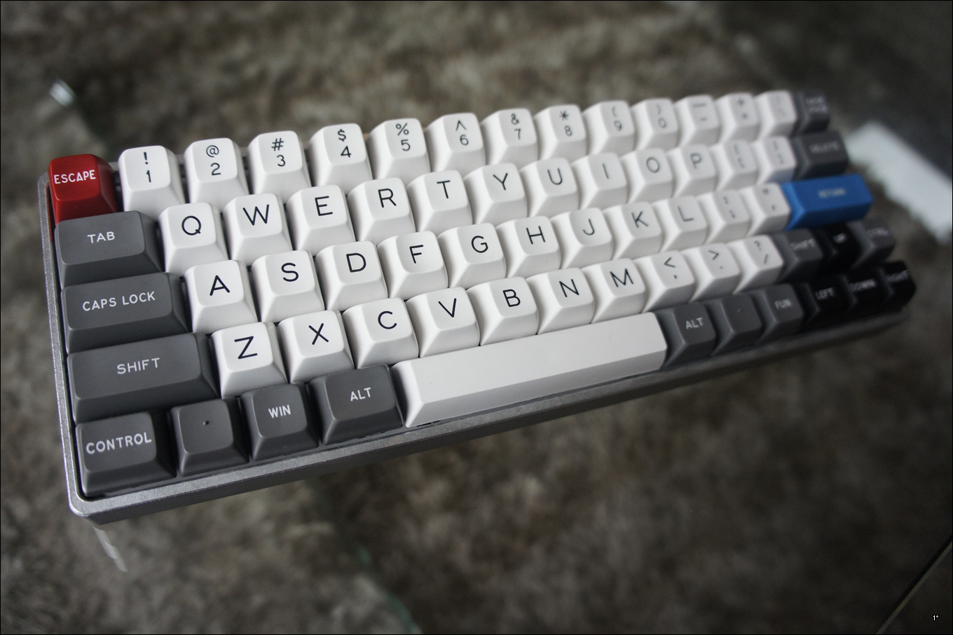

24 Feb 2018, 00:30
Thanks for the advice but for a Leopold Topre there aren't many options I guess.
I very much like the general look of the keyboard from a member in the picture below.
I guess these are SA as well? I believe they're 7bits.
What do you think, won't I get a similar look?
