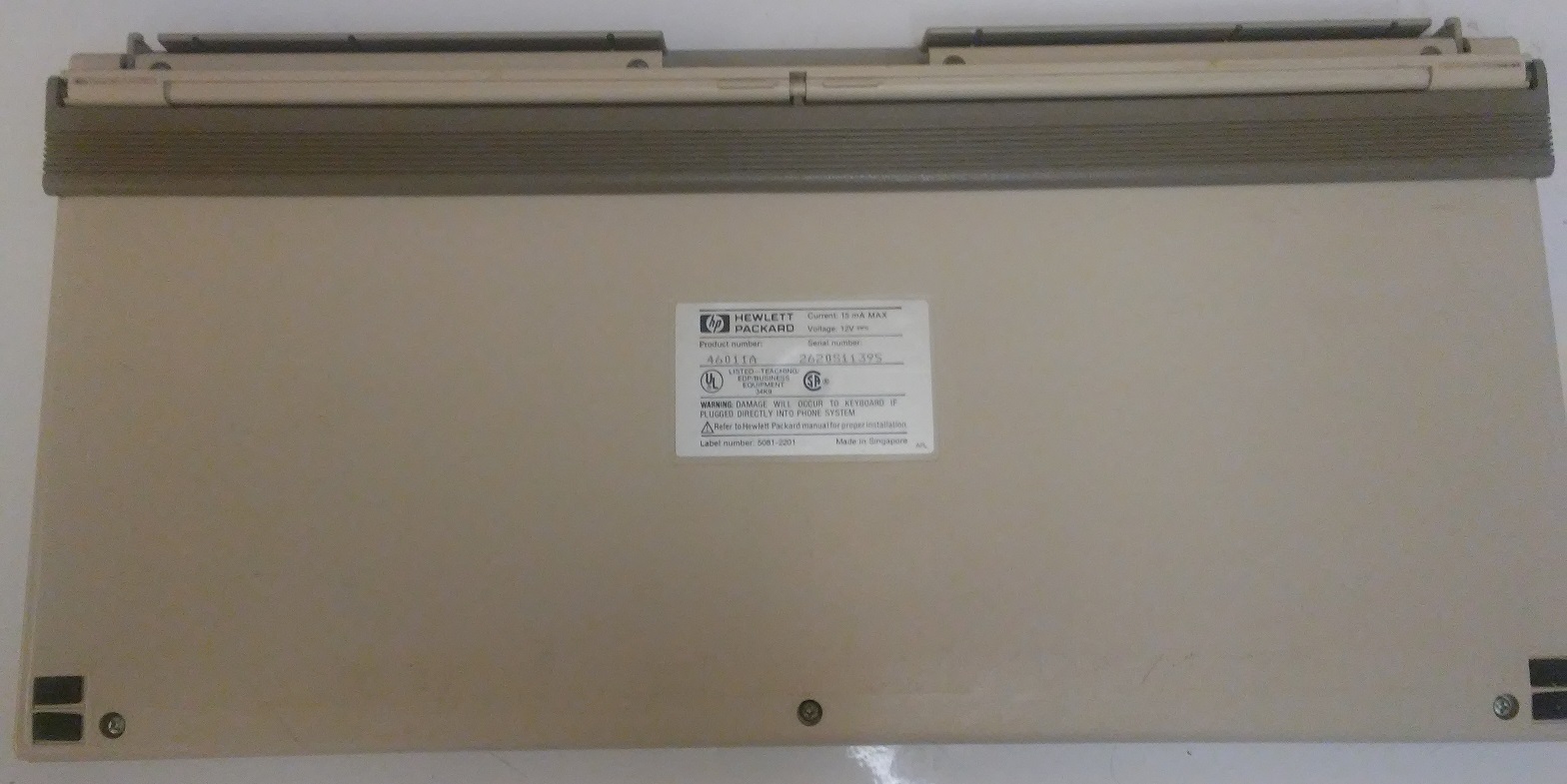

I've seen these boards a number of times and have wondered about them. I've seen a post or two saying they are rubber dome but they didn't seem definitive. So ... when I came across one, for not a lot, I bought it. I thought the red keys and such looked kinda cool.
So here's the deal: It is rubber dome, but hey - sometimes that can be ok.

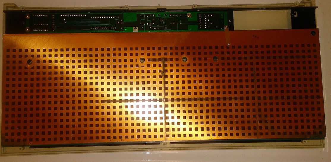

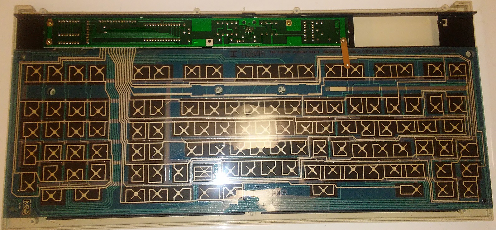

Here's the back board - notice the copper tracings. They are facing toward the back and the non-conductive side towards the keys. Guess had some left over PCBs:

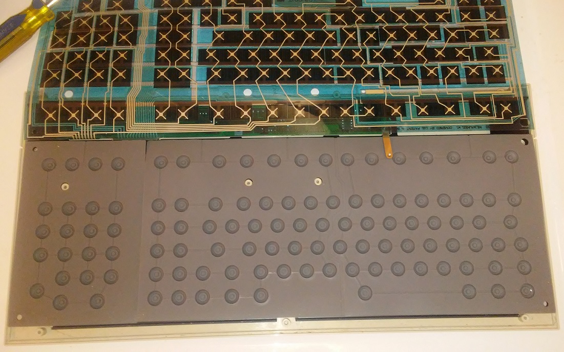

Here's the back of the membrane:

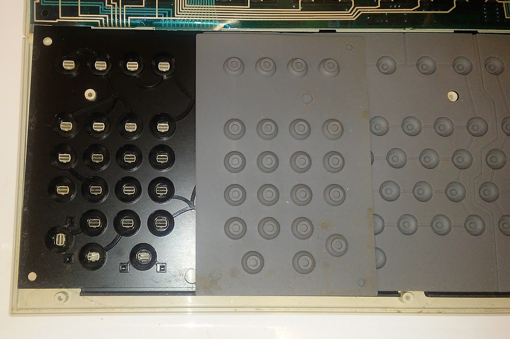

front of membrane and rubber domes:
Another view:

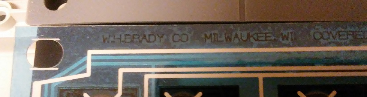

Here are the claims of responsibility on the membrane:
25 Feb 2018, 15:16
Strange, I would have expected the membrane to have come from some company in Taiwan.

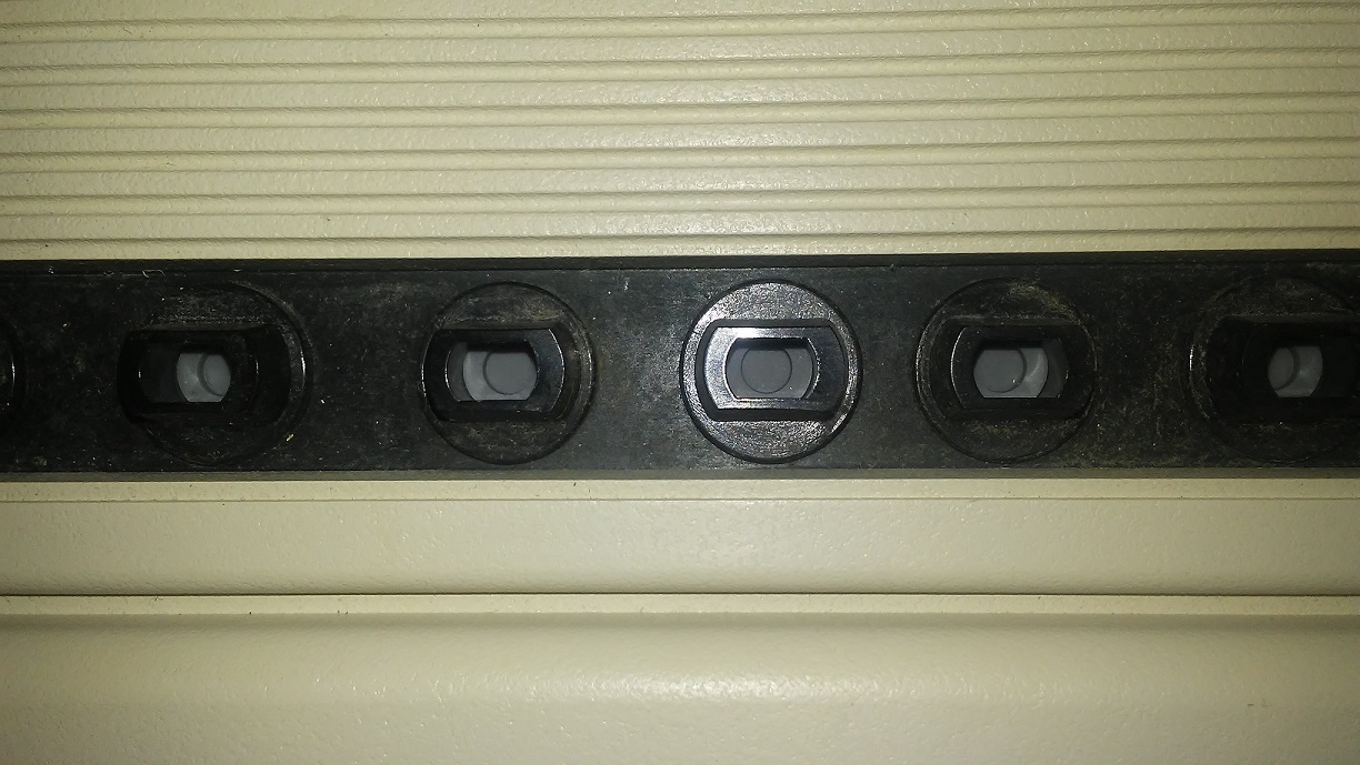

Interesting to see these also come in a rubber dome version, I thought all HP 460XX keyboards with this layout were in fact Fujitsu leaf spring. On closer inspection, this looks like the rubber dome version, because the rounded protrusion around the stem is visible beneath the top row keycaps, while this is evidently leaf spring

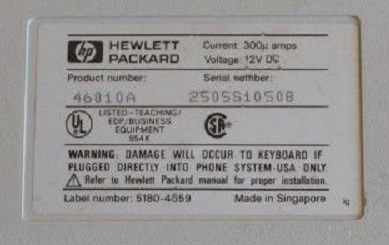

Some of these definitely are Fujitsu leaf spring: Image
OldIsNew
25 Feb 2018, 22:43
Noobmaen wrote: Some of these definitely are Fujitsu leaf spring: Image
As you noted, a very similar board - but not the same one. The leaf spring version you found is a 46010A:

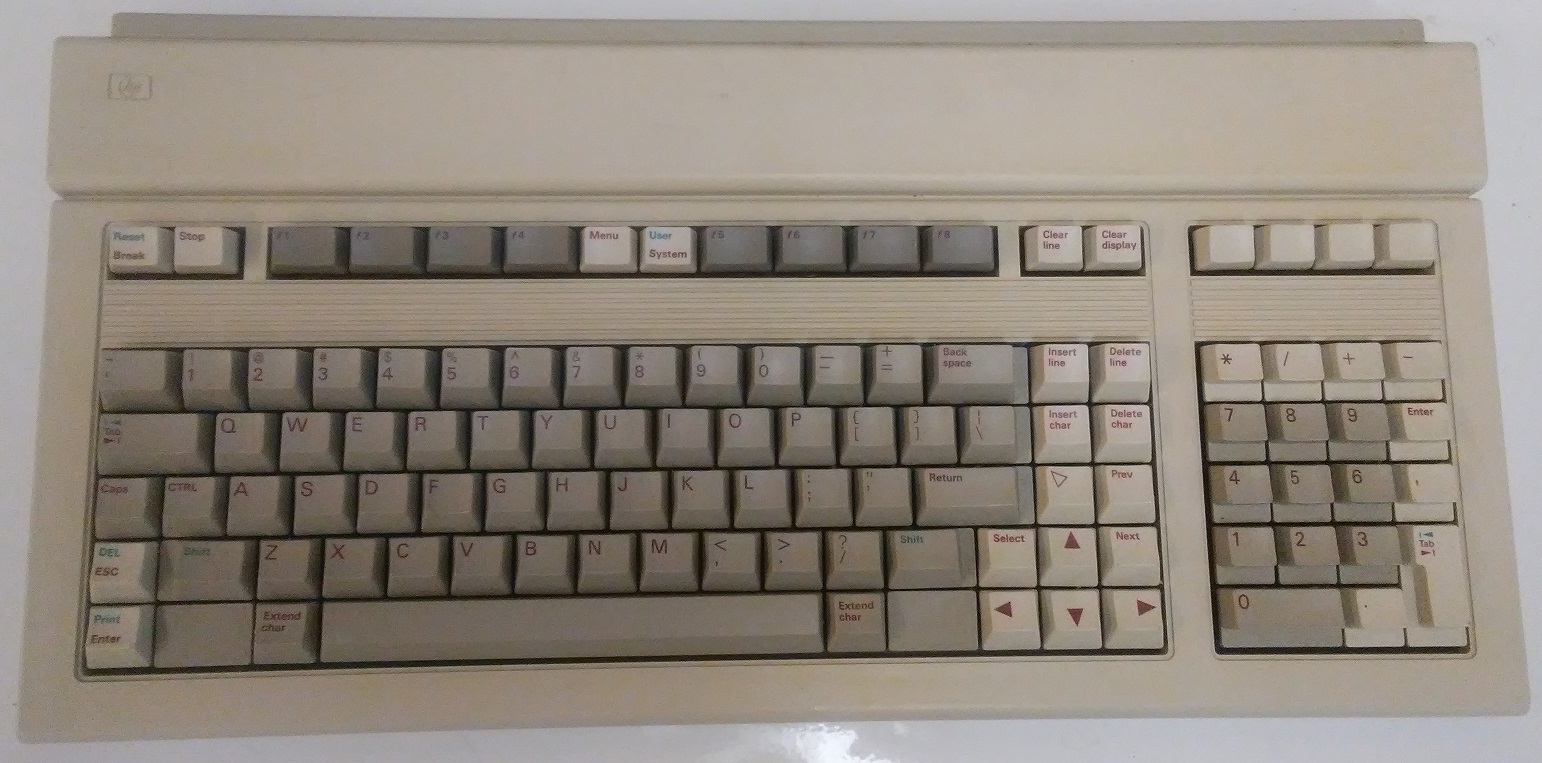

My rubberdome is a 46011A:
So I think you've pointed out a very helpful tip for sure. I would like a FLS version of this board and at least it looks like we now know what we need to look for!

Here is another one which sold recently, this time in mint condition. I suspect it's the rubber dome version based on the rounded bump below the top row key caps.
