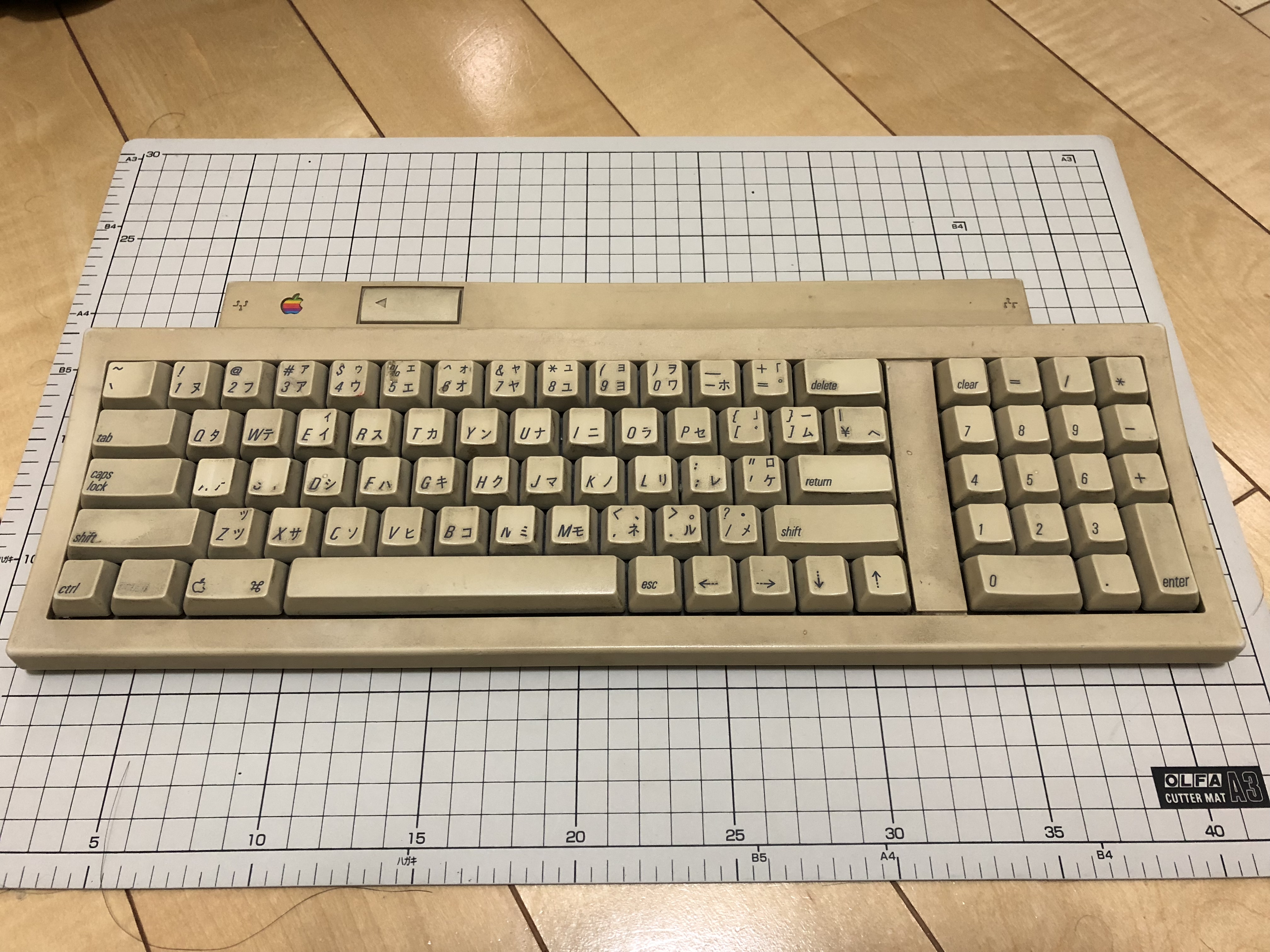

The other day, I bought used Apple keyboard Ⅱ.(Photo2)
It was bad condition, so I decided to do retr0bright.

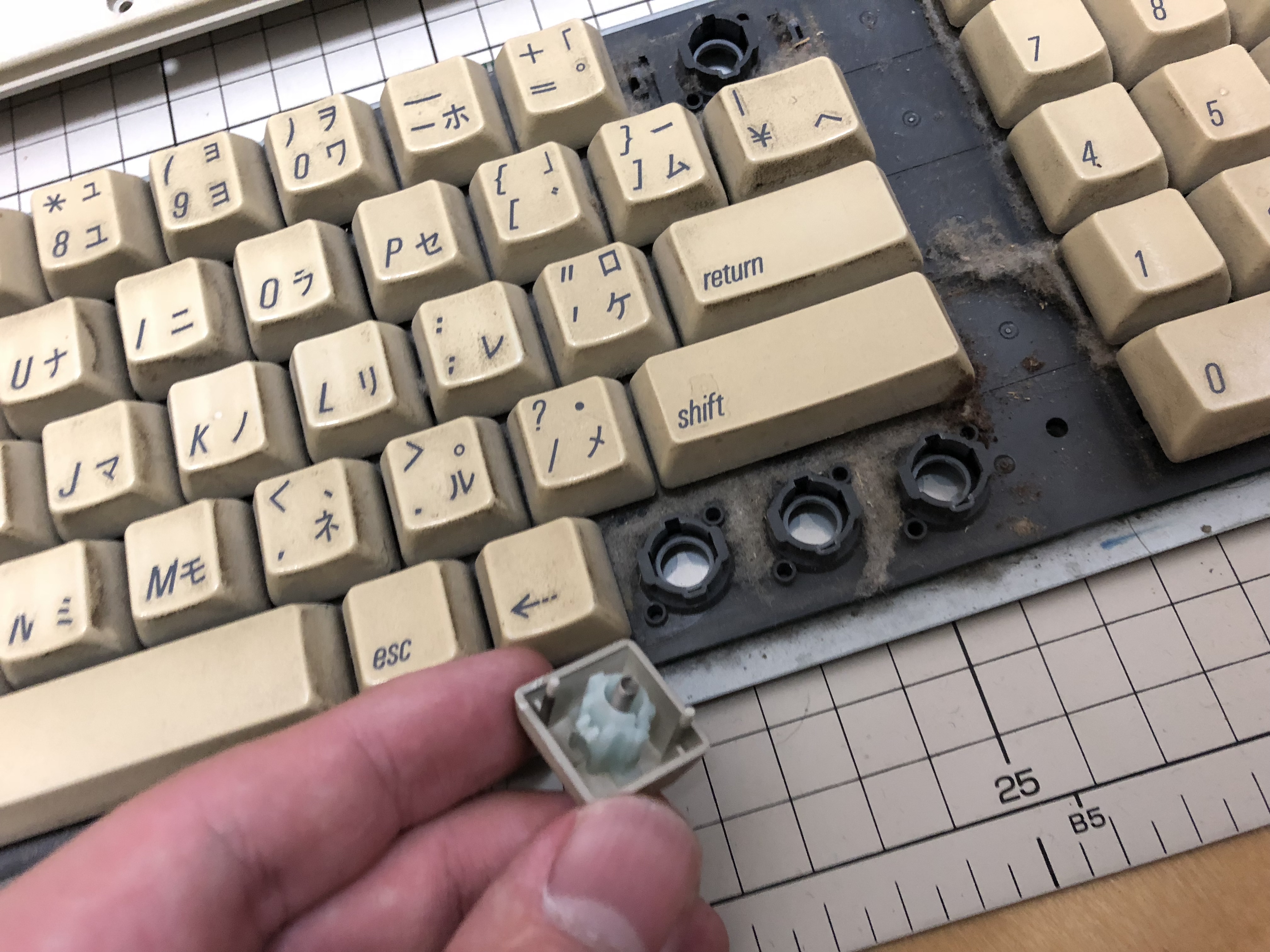

But when I pulled up key caps, I knew springs are fixed to key caps with blue parts.(Photo1)
My question is below.
•If I sink key caps with springs in liduid of retr0bright, are springs going to get rusty?
If I have to take apart, how can I do?
Thank you for seeing this post.

Hmmm never seen that before.
You could use the cream method, with https://www.sallybeauty.com/salonc-care ... lt,pd.html
that way very little will get on the back of the cap.

- Brett MacK
- Location: United States (New Hampshire)
- Main keyboard: SGI Granite
- Main mouse: Logitech G403
- Favorite switch: White Clicky Hi-Tek 725
It looks like SMK spring over membrane, but i'm not 100%

I did retrobright Amstrad Acorn PC-1512 keyboard keycaps and chassis by immersion in liquid peroxide.
Amstrad Acorn PC-1512 keycaps have a small center spring similar to yours. The springs will not rust, they will oxidize; a process that will probably led them to rust in the future. I lubricated all the springs afterwards. I really don't know if the springs will survive or not.

FWIW, the sliders (blue) and keycaps can be separated.
