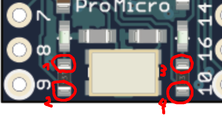

Thanks, I still need one last info. If I unsold the two vertical resistors, each one have two holes (one coming from the LED and the second from the other part of the circuit).
On my picture, which numbers would be the "new" pins? 1 and 3 or 2 and 4? :?

Narann
02 Apr 2018, 16:38
If I rotate the Pro Micro shematic, I guess it's 2 and 4. Am I right? :?
kokokoy
02 Apr 2018, 17:29
Haha. Sorry mate not familiar with circuit diagrams. I am a complete noob on the things and was totally winging it when I build my board. :lol:
But anyway you’re correct its 2 and 4. Lastly, just checked my board and it tirns out I didn’t even removed it (really remembered I did).

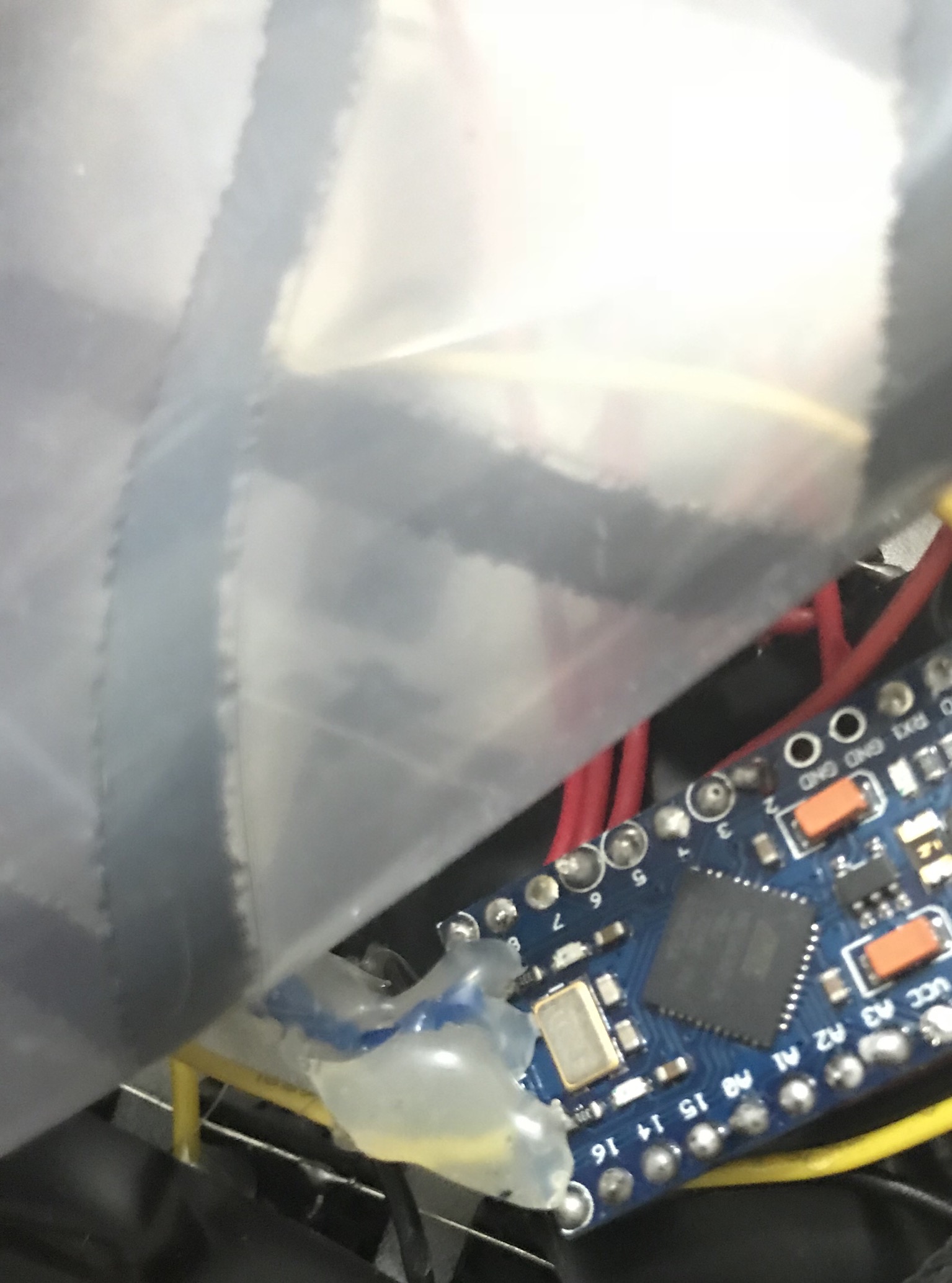

__red__
02 Apr 2018, 19:05
Suggestion - get yourself some UV-cured PCB mask. That hot-glue isn't going to protect the connection fully from stress.
