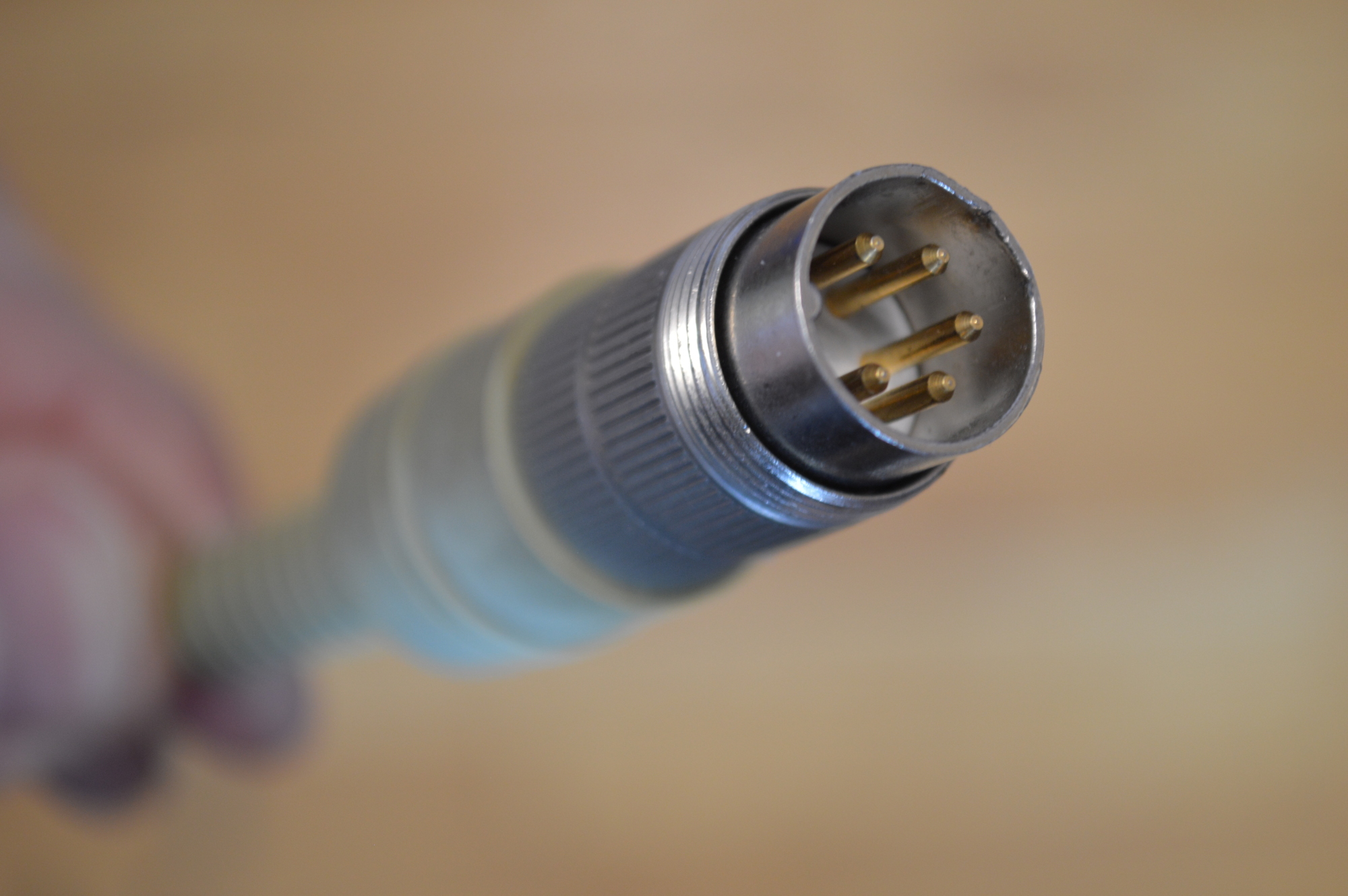

Hi! Here is a picture of the F122 male connector (sorry for the VERY poor quality, I will upload a better one when I am at home):
This connector is a DIN-5 240 degrees and must ideally be screwed in the female connector. As Orihalcon states for one of his female connectors:
The adapter will work as is, but it will plug in farther and more securely if the screw in shield is removed with a dremel from the original F122 cable.
I would like to avoid this scenario and I would like to avoid modifying the internals of the keyboard.

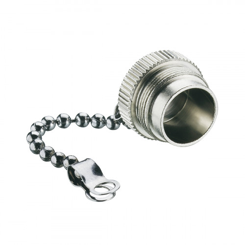

don't forget the cap : )
double check the cad datasheet and dimensions the thread on the outer ring of the connector if you have the tools to do so. Its a well documented part from Lumberg. ~$7. if you poke around they also have many other options. eg: http://www.lumberg.com/en/products/product/0308

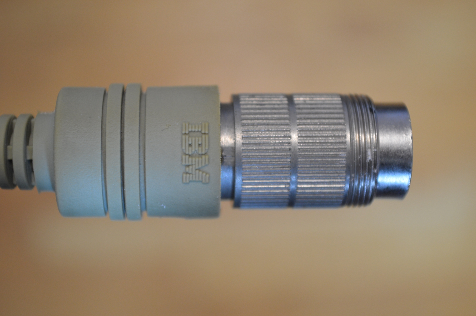

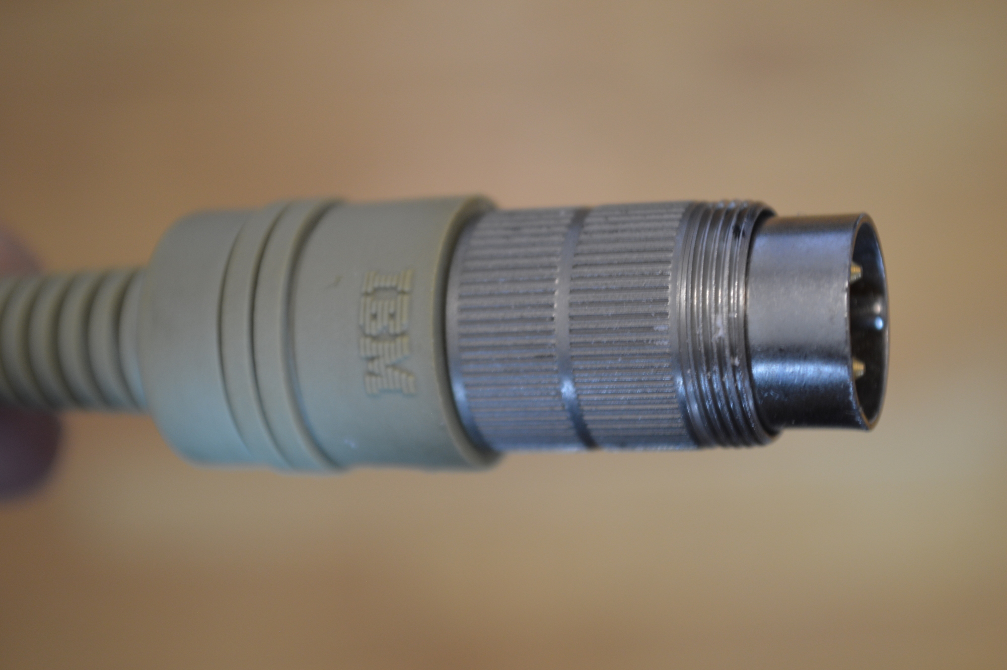

Here are better pictures of the connector:

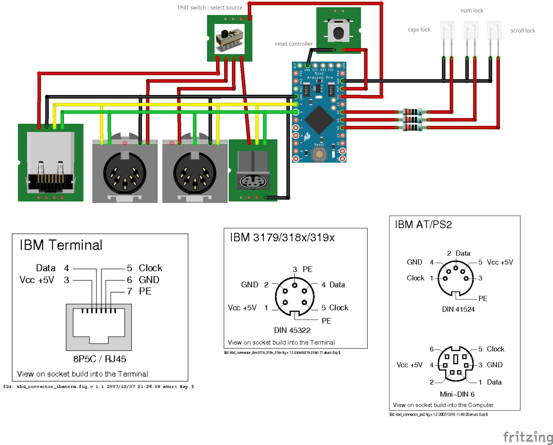

Here is a rough draft of what I want to do:
I don't know how I could reset the micro-controller automatically when switching from one connector to another (ideas?) so my current hack is to simply add another switch to reset the micro-controller. I also intend to use a cheap Pro Micro with the following pitfall:
When a Pro Micro is externally reset (by pulling the RST pin low), it'll only briefly (<750ms) start the bootloader before continuing on to the sketch. If you need the bootloader to run longer, resetting twice quickly will get the Pro Micro to enter bootloader mode for eight seconds.
So switching sources rapidely could have dire consequences.
Another fun addition to the box could be LEDs to indicate which connector is selected.

With a 2 pole selector switch you (probably) don't need to use a second switch to reset the micro. Simply connect the first poles of the switch as you did above and all the second poles to the micro-controller input power. The power interruption when switching should be enough to restart the micro-controller. I'll try to post a circuit of what I described tomorrow and if possible test it out over the weekend.
PS: With a multiple pole switch is trivial to add LEDs indicators for the selected connector
j0d1
20 Apr 2018, 00:48
I think I understand what you mean and for that I must choose a "break-before-make" switch (which I think I would need anyway), which opens the current signal path before closing the new signal path.
zool
21 Apr 2018, 02:12
you could also run the off the selector switch back to the controller, and select the profile you want for each port, but you will need a little code, so...?
also you might have problems with the clk and data being paralleled up? but whats the worst that can happen there, just unplug the offending boards.
j0d1
21 Apr 2018, 03:10
zool wrote:you could also run the off the selector switch back to the controller, and select the profile you want for each port, but you will need a little code, so...?
As far as I know, Soarer disappeared without releasing the source code of his converter so I am stuck with a black box. I can't add code to it easily. I could take the couple of days necessary to re-code everything (is it finally the time that we have an open source Soarer alternative?) but let's face it, Soarer firmware is awesome as it is and just works.
zool wrote:also you might have problems with the clk and data being paralleled up? but whats the worst that can happen there, just unplug the offending boards.
The switch in the design is there so only one keyboard is powered up at a time and therefore only one keyboard uses the CLK and DATA lines at a time. The only potential ( :roll: ) problem I see here is that current flows from the CLK/DATA output of the powered keyboard to the CLK/DATA output of an unpowered keyboard... I don't even know if it is possible / makes sense or what I should do to avoid this situation.
