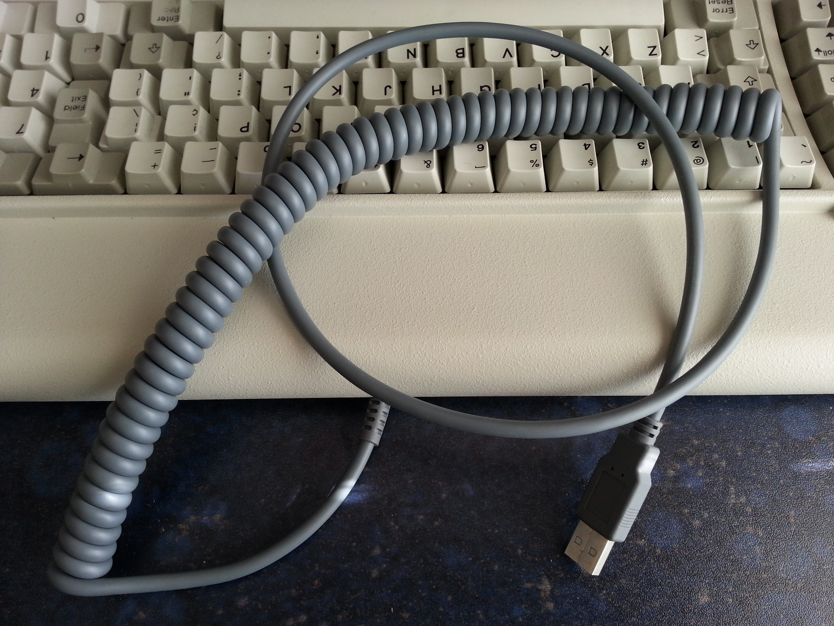

tigpha wrote:
tigpha wrote: Hmm... What about USB A to RJ45 Coiled Spiral Extension Cable that sells for £10?
Just received one of these. The "RJ45" plug is actually a 10P10C modular connector, with a loop of wire connecting two of the pins together. Snipped that off (have no sockets available to match it). The wire itself is foil screened four conductor standard USB cable, with very sturdy neutral grey PVC insulation. Not bad coiled cable at all.
Definitely a worthy upgrade! Not quite the beige colour of the original cable, but certainly the same industrial aesthetic. Much, much tougher than the pathetic USB cables I've found so far. Probably will last another three decades.

tigpha
22 Apr 2018, 09:43
Hi Elecplus, The cable connects to an ATMEL controller inside. So far this is the closest modern equivalent I've found for original coiled cables, for a reasonable cost.
I also bought this other longer one from ebay, but the plastic is different. It doesn't have the same "snap" to the coiling, and doesn't seem so resistant to abrasion. The first one from amazon is recommended.

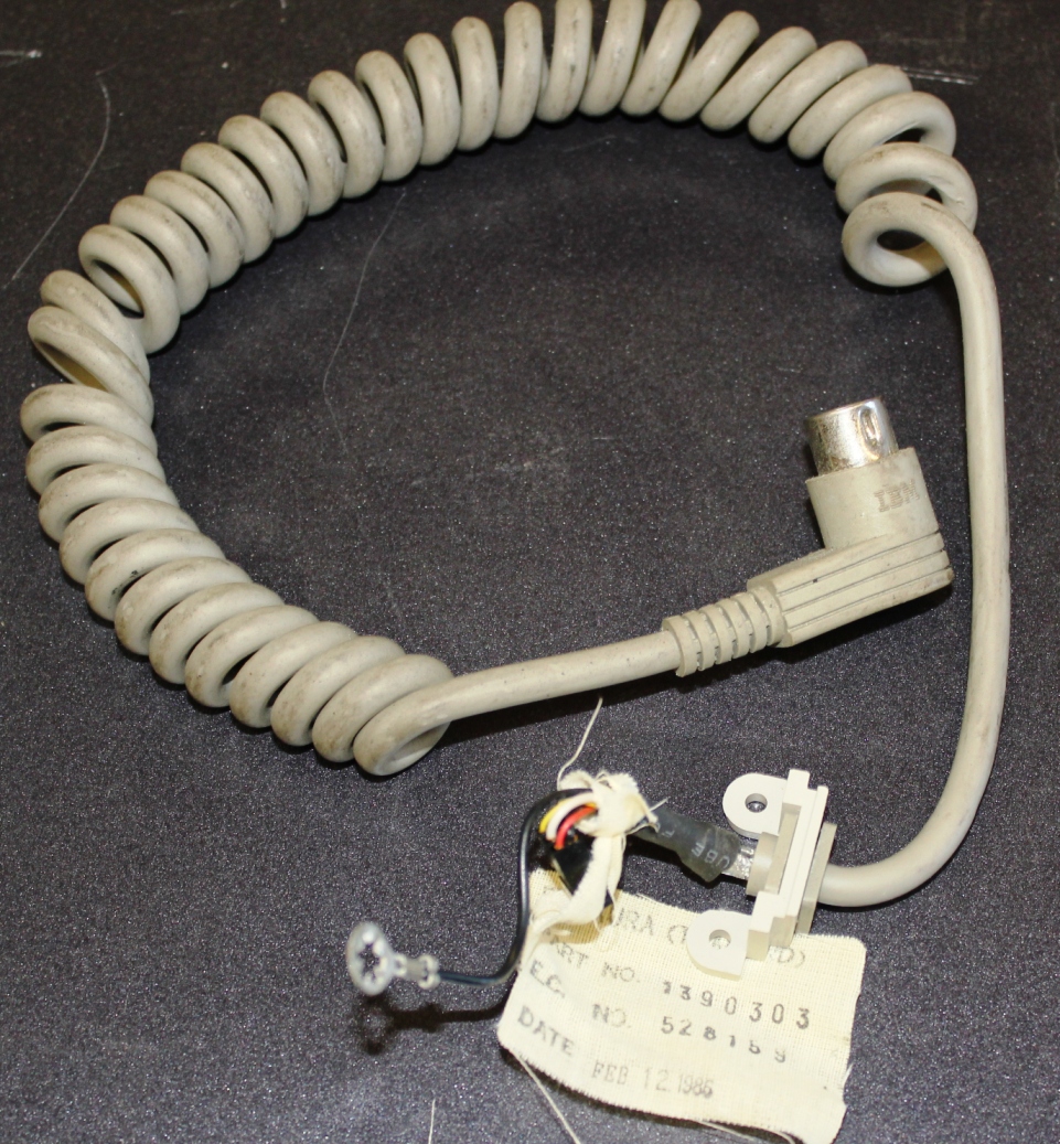

elecplus
26 Apr 2018, 21:42
These are the ones we save from the terminal boards we are killing right now. The PN is 1390303, and the date on this one is Feb 12, 1985! Nice and thick, definitely holds the coils well. Obviously this one still needs to be cleaned.
