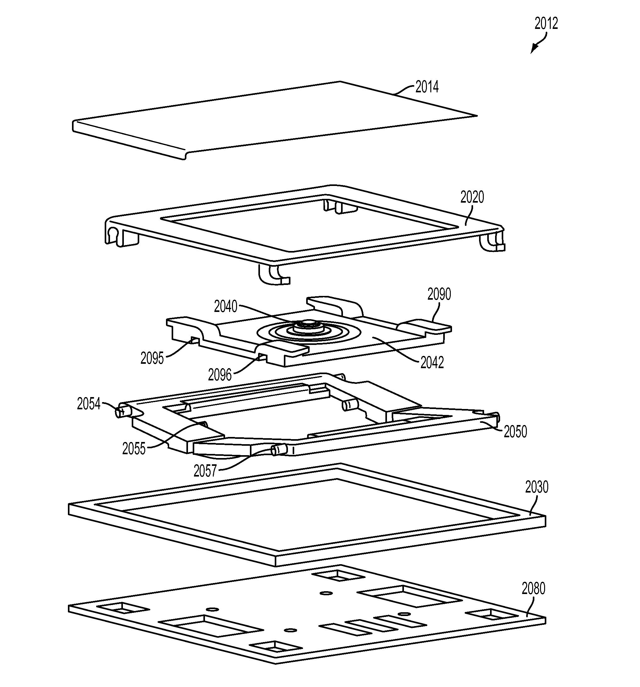

Do Apple's problematic super-thin keyboards have springs? (https://www.extremetech.com/computing/2 ... d-analysis)
I think I mistakenly assumed all keys had springs, but Apple's don't look like they have room for springs.

Apple's switches are basically glorified scissor switches that use a metal tab instead.

Blaise170 wrote: Apple's switches are basically glorified scissor switches that use a metal tab instead.
I think they are metal domes. It is a type of very low-travel switch that used to be more common for pocket calculators back in the 1970s before people decided rubber domes were better.

Findecanor wrote: I think they are metal domes. It is a type of very low-travel switch that used to be more common for pocket calculators back in the 1970s before people decided rubber domes were better.
There is a patent that was filed which shows the scissor mechanism. They do have a dome of sorts, but the dome isn't strong enough to return the key to its initial position without the help of the scissor.
