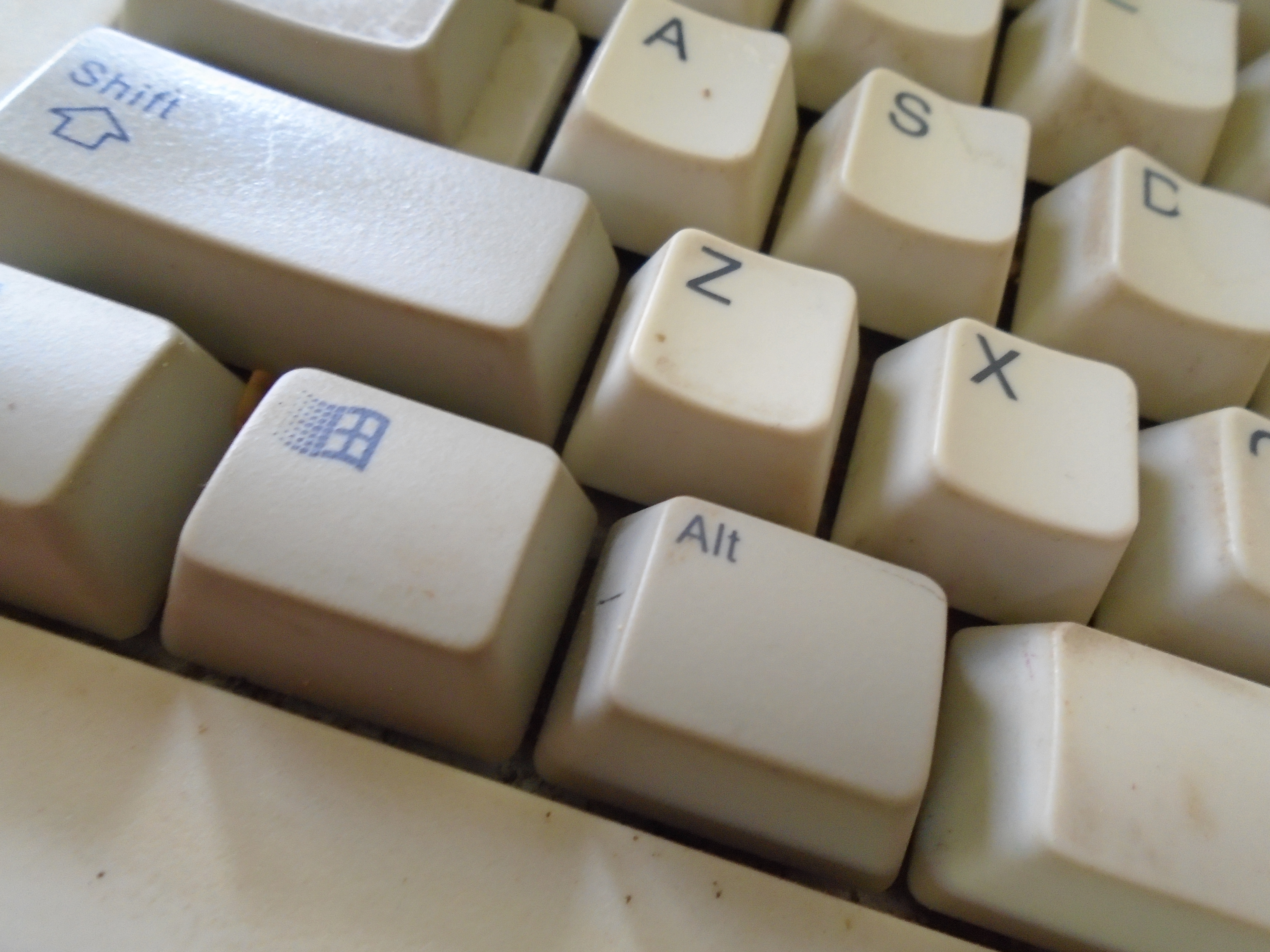

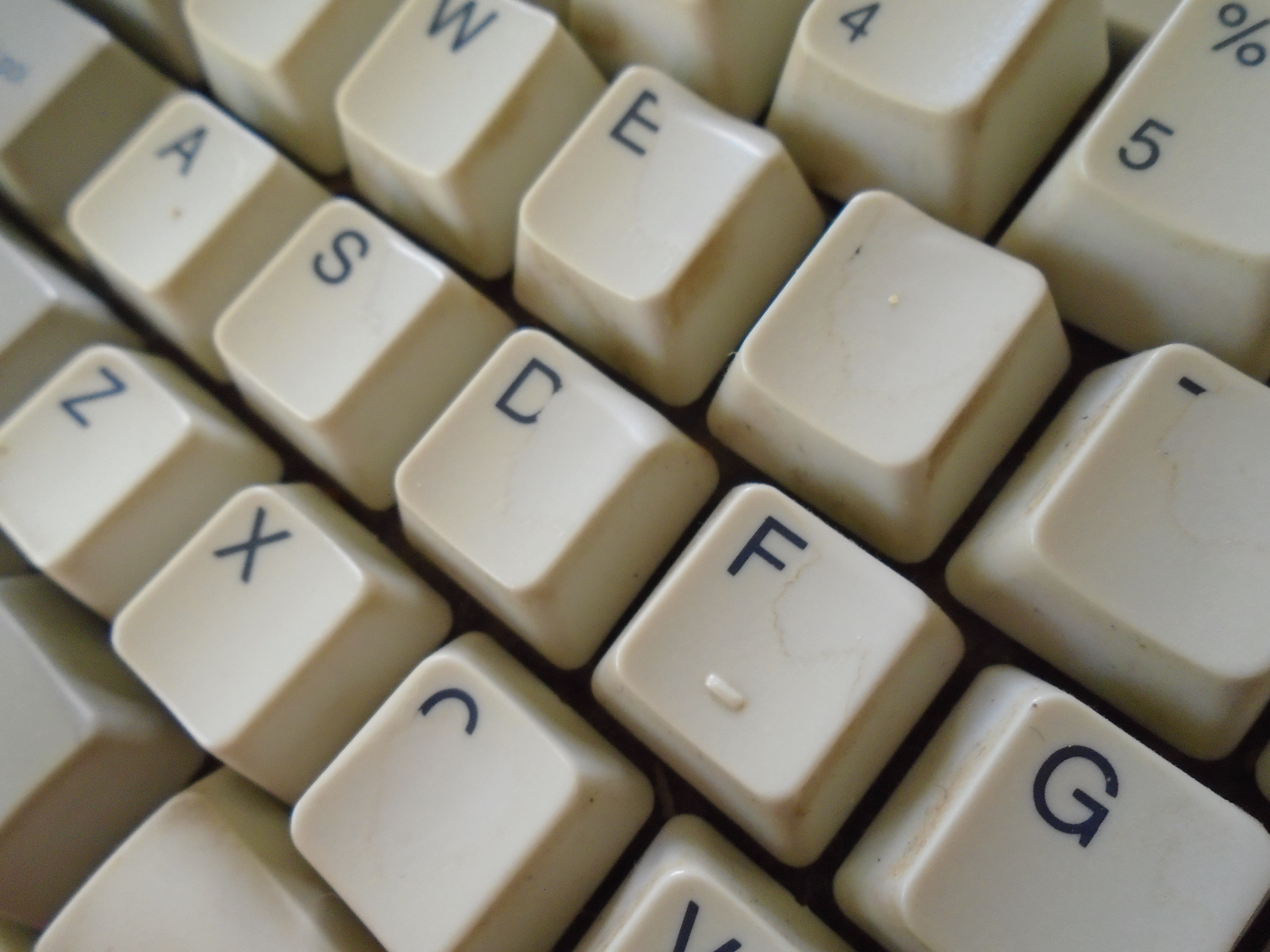

Hi,
I just got this well-used AT101W from Cindy/Elecshopper, and they keycaps appear to be pad printed, much of it is already worn off. They don't appear to be lasered, because the quality is better, it looks more like dye sublimation, but I don't think this kind of wear happens with dye sublimated caps. I wasn't aware about the AT101s having pad-prints, I thought they just had lasers and rarely dye-sublimated. Any thoughts?

xxhellfirexx
17 Sep 2018, 21:01
That looks like rimless pad printing. Regular pad printing does only the letters. Rimless pad printing covers the top surface.

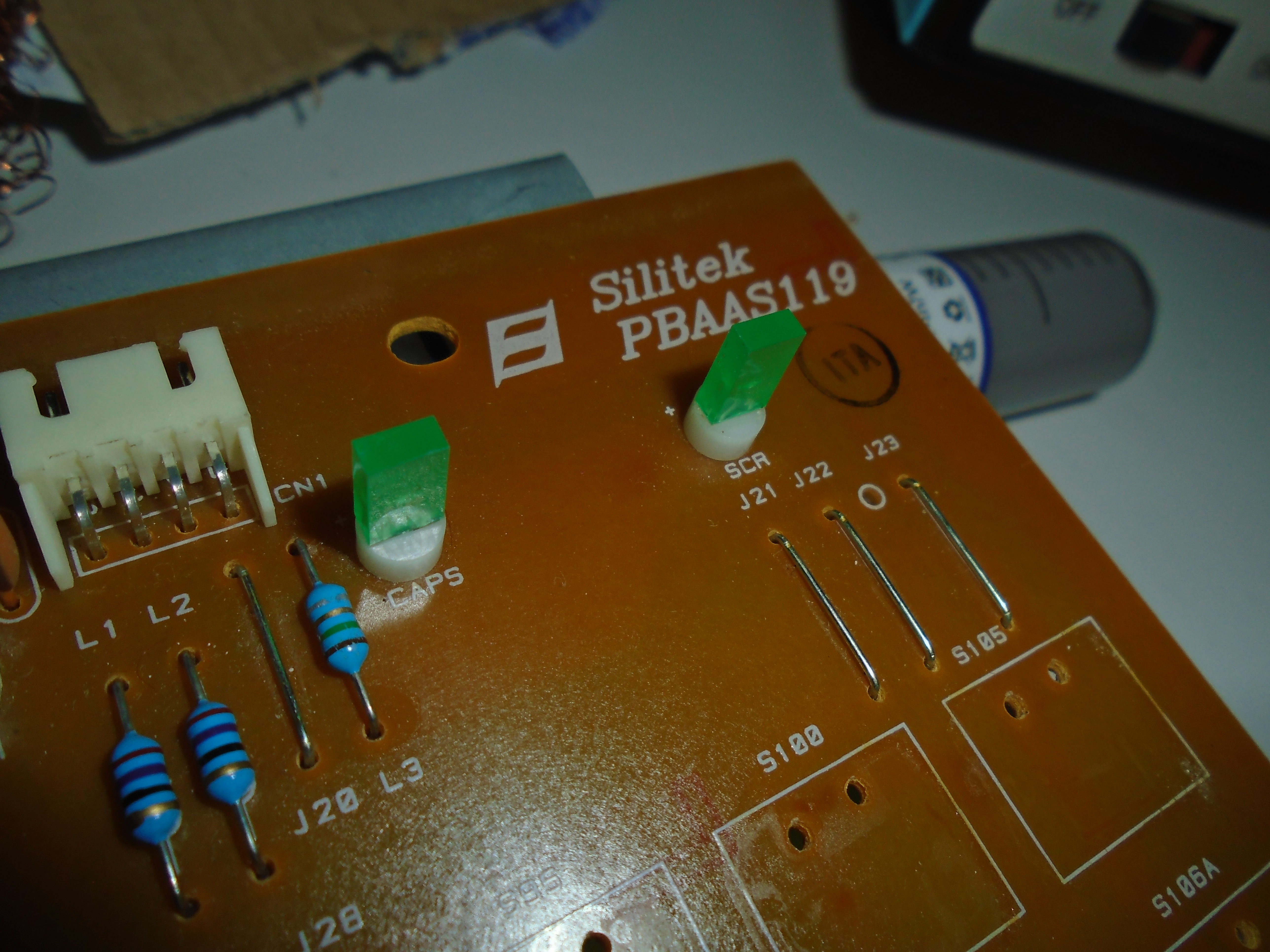

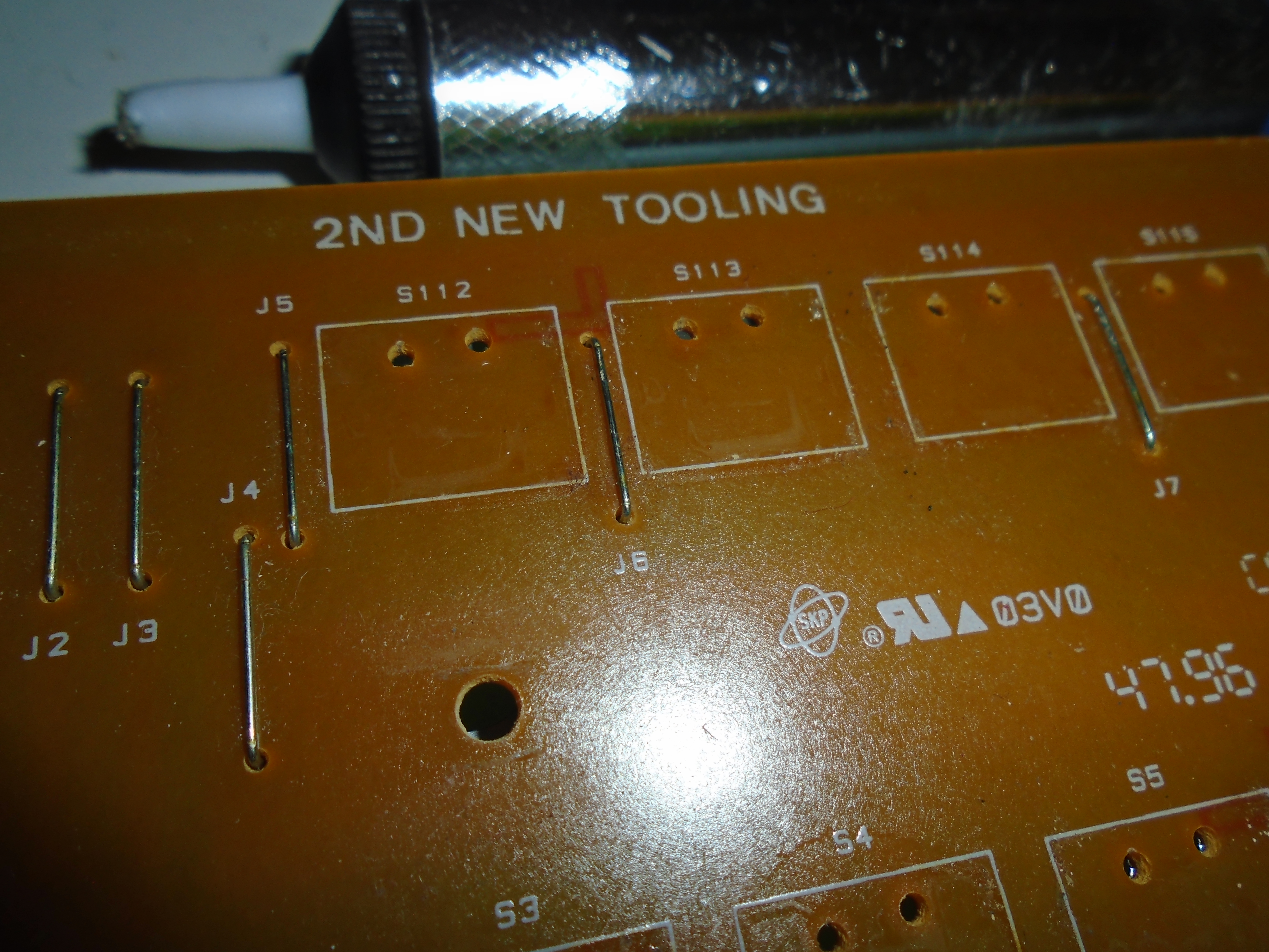

abrahamstechnology
17 Sep 2018, 21:12
Desoldered it and interesting silkscreening on the PCB

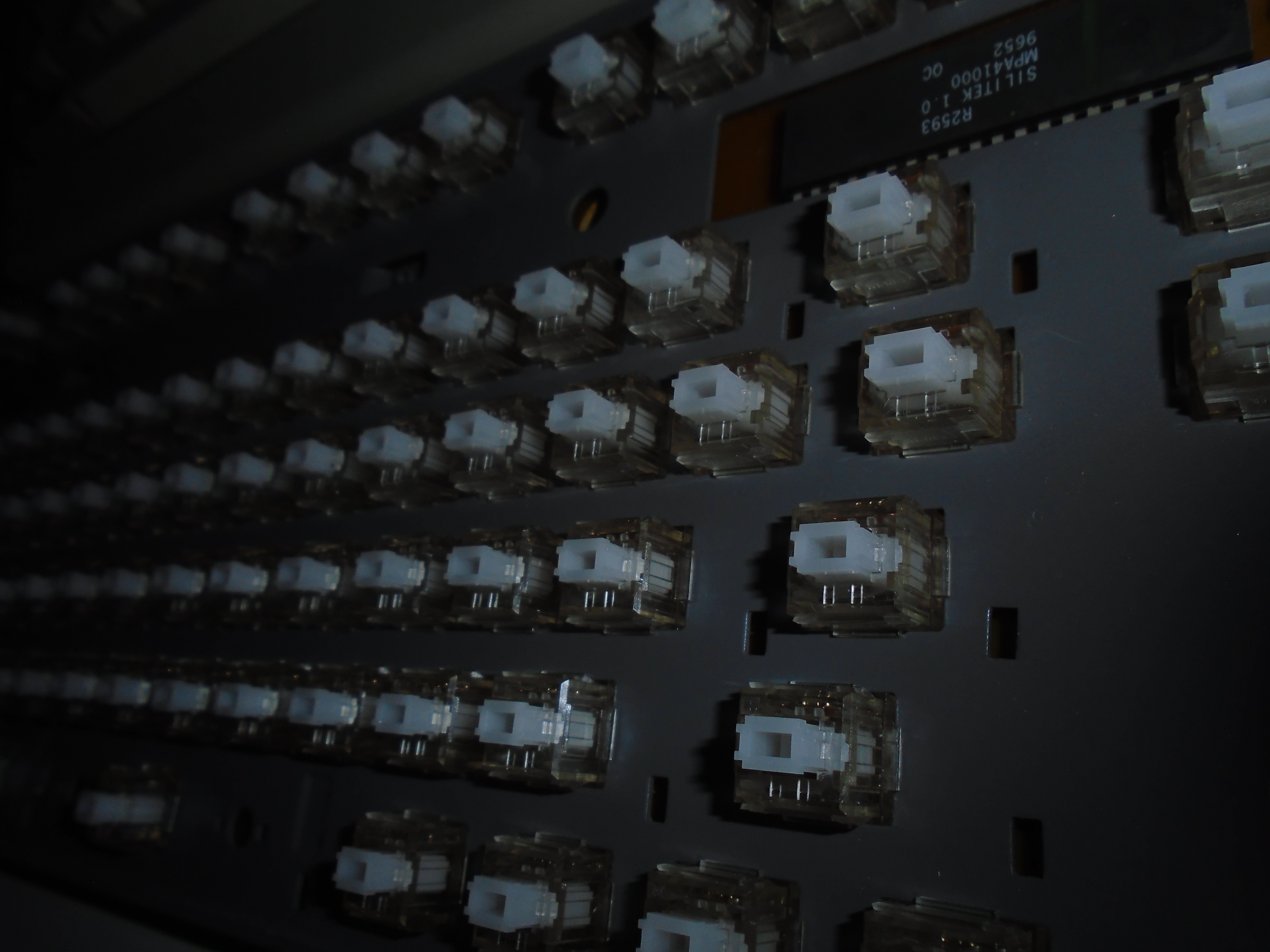

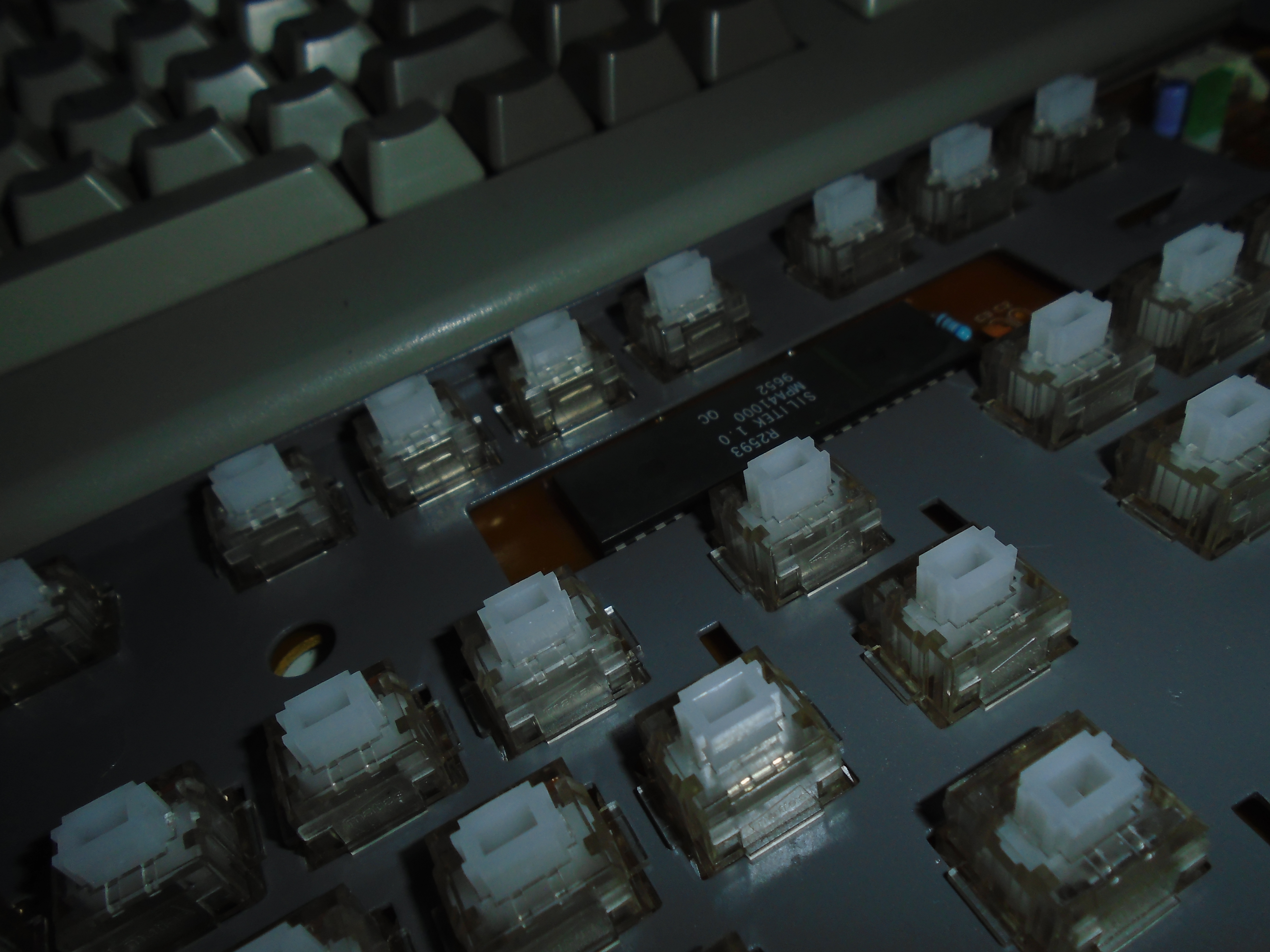

abrahamstechnology
18 Sep 2018, 04:18
Restored backplate and replaced switches in a few hours, new record?
