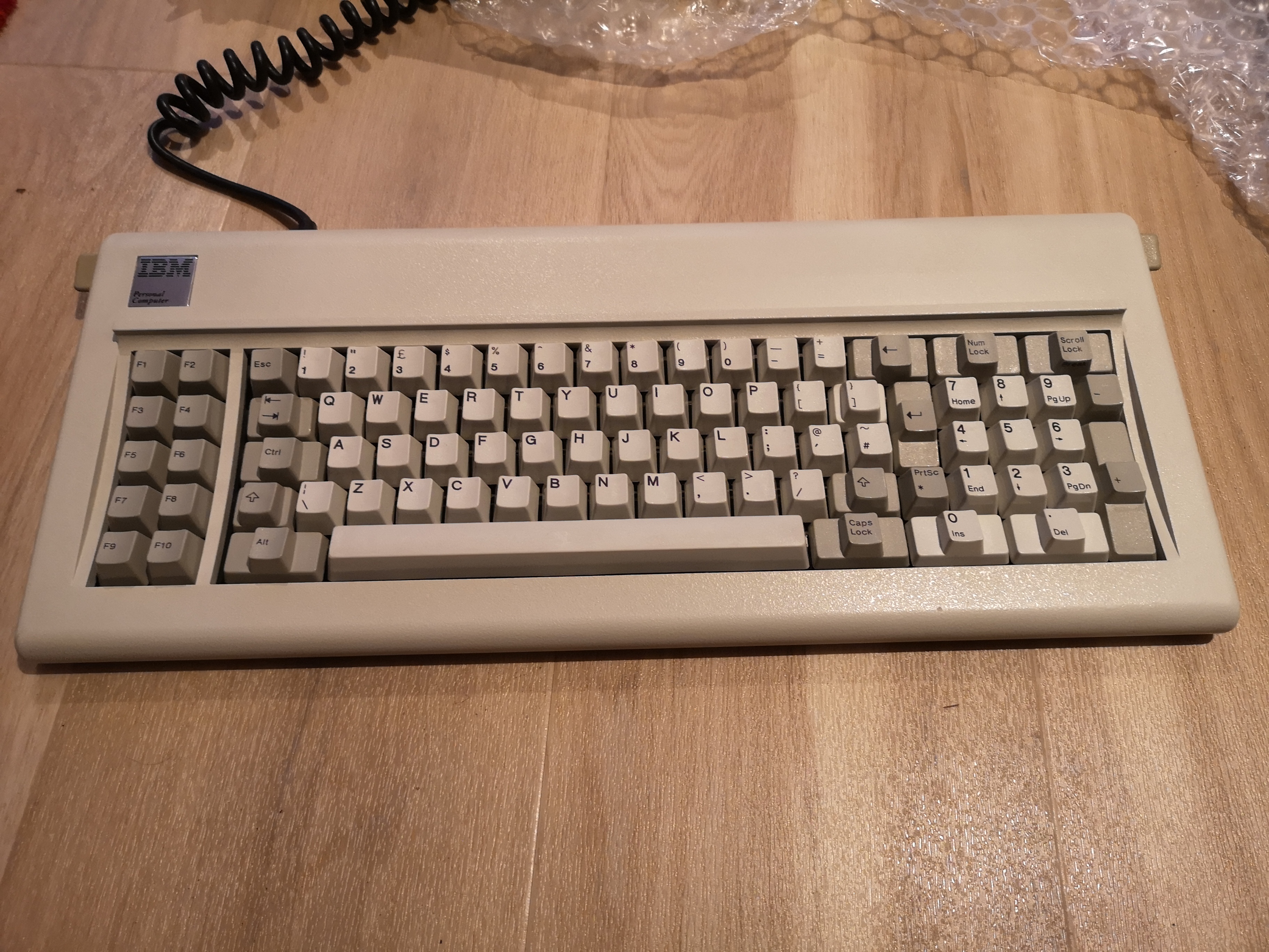

Hey guys I have finally found an IBM Model F keyboard with a UK layout and just got done restoring it
Here's the picture of the fully restored Keyboard let me know what you think.
Thanks.
Thanks.

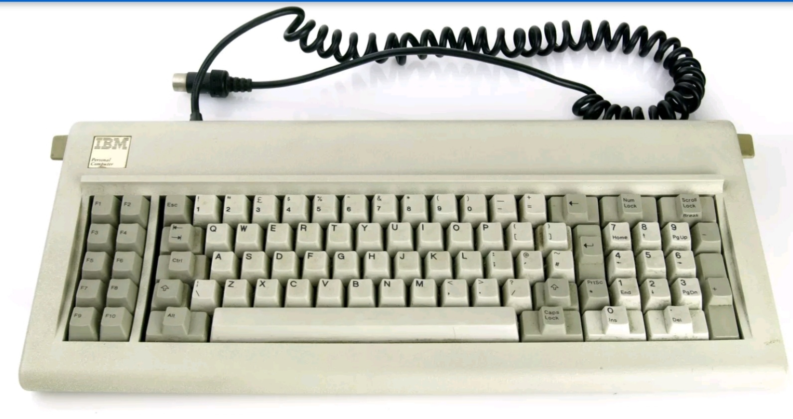

This picture is the before grubby condition.
Sorry about the different background but you can still see the dirt.

good job!

Thanks green-squid it was a lot of work but so worth it
- digital_matthew
- Main mouse: It's a Secret.
Looking good. It's amazing how well the old IBMs clean up.

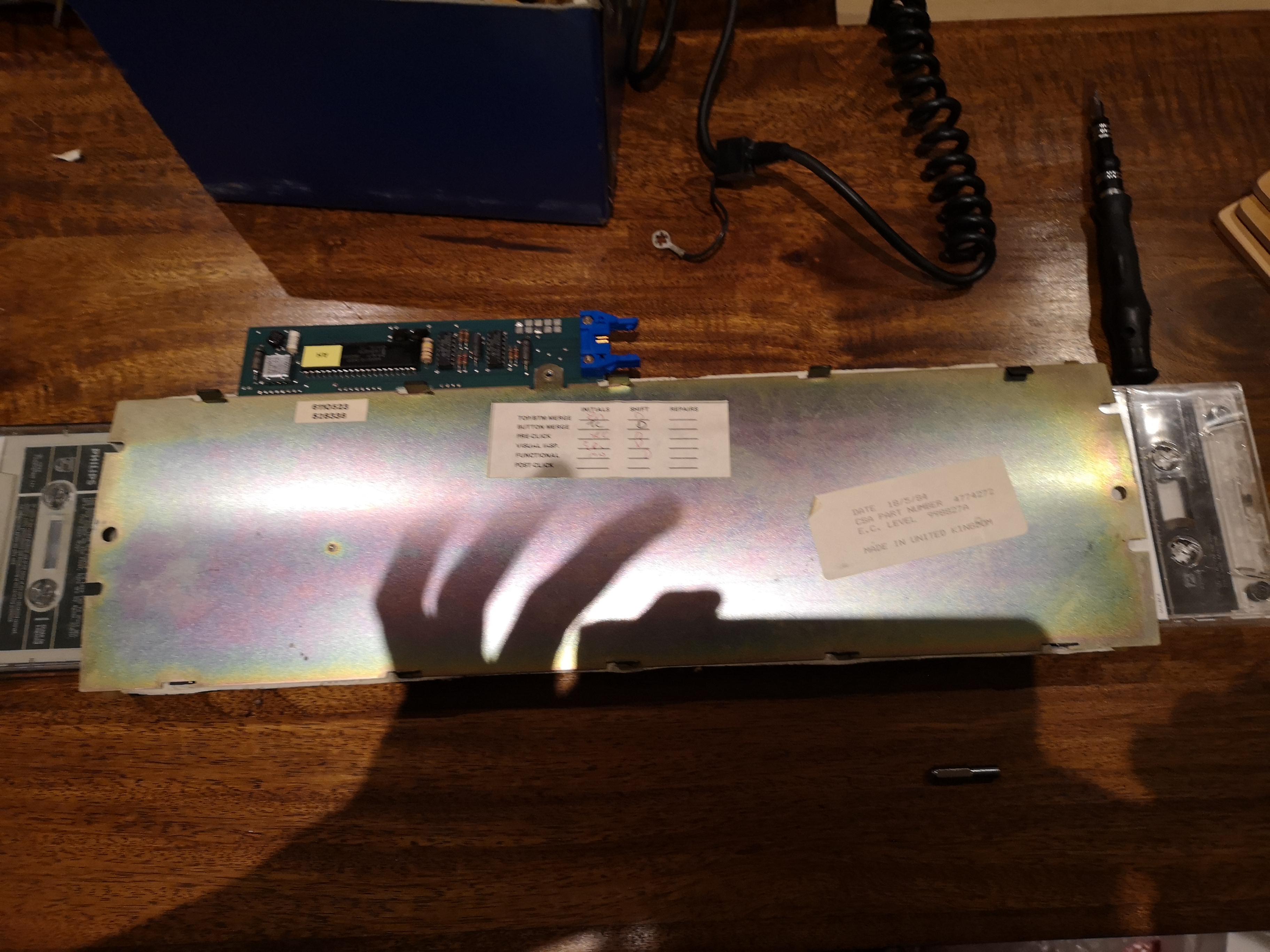

My backplate was in fantastic condition for its age here's a picture of that.
Notice theres NO rust!

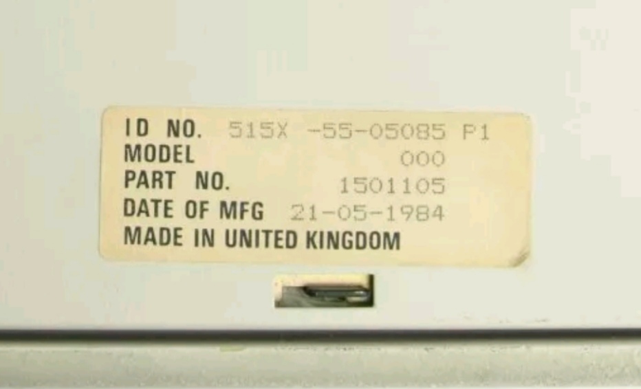

And for those wondering here's a photo of the manafacturers label on the back of the keyboard

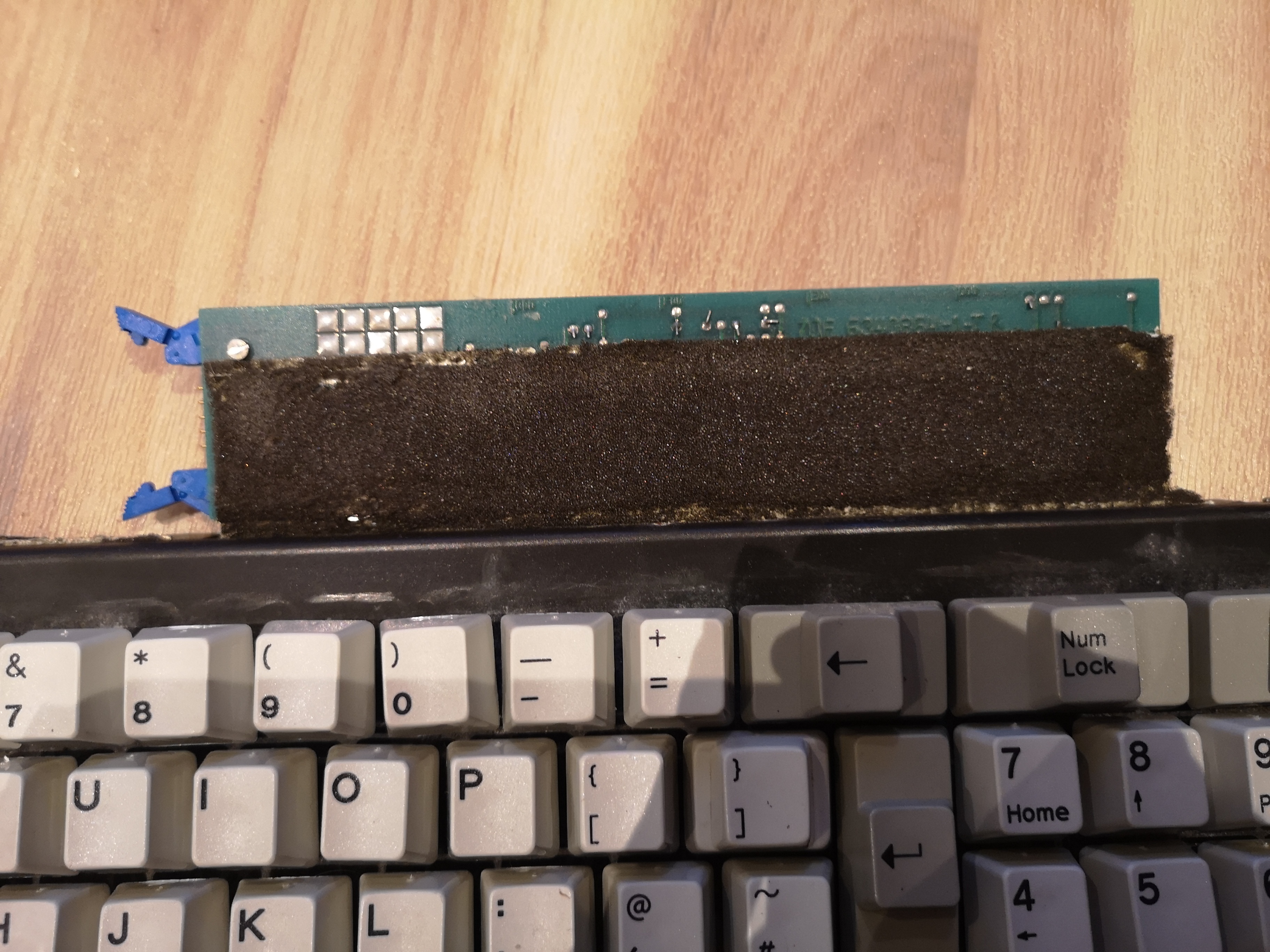

Here is the picture of the original foam let me know if it needs replacing at this point.

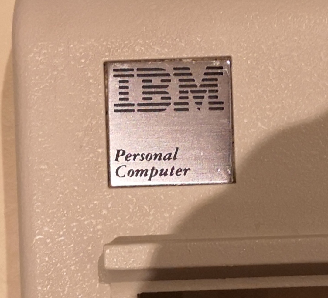

Fkazim
- Location: United Kingdom
- Main keyboard: Modded IBM Model F AT
- Main mouse: Mionix Naos 8200
- Favorite switch: Capacitive Buckling Springs
Here is a picture of the IBM badge
- Screenshot_20181107_210051.jpg (258.7 KiB) Viewed 5614 times

The real test will be if it will work when you get the converter. If your foam has degraded which may be the case then there may be foam residue on the capacitive pads so you will get poor response from key presses

Ok when the convertor comes if all is good I will post it here if there is problems then I will replace the foam and take pictures along the way and post them here.
Any recommendations about the foam like type sizes good brands?
Thanks.

Ok thanks for the info really appreciate it. Any specific thickness?
Anakey
- Location: UK
- Main keyboard: Planck
- Main mouse: Cyborg Rat 7
- Favorite switch: Alps skcm white
you want about 3 or 4mm but it needs to be compressible down to about 2mm as it will be compressed strongest at the top and bottom less so in the middle but it still neds to hold the barrel plate in place

That seems way too thick. I would have halved those numbers with a fairly firm foam.

Had a look and as I live in the UK shipping costs would be too high but I did find something similar would this be a good replacement foam for my IBM model F?
https://rover.ebay.com/rover/0/0/0?mpre ... 3062945336
I would buy it in 3mm thickness.

I would think the foam itself would be good - as long as you can compress it enough. I've found 1/16 " foam works well. Apparently that's 1.5875 mm - so with 3 mm might be a bit tough to get the board closed again.

"Art Foam" from Michael's Art Supply is 1/16" but it is actually rather firm, while eventually compressing nicely with enough force. My opinion is that a thinner, firmer foam is preferable to a thicker, softer type.
