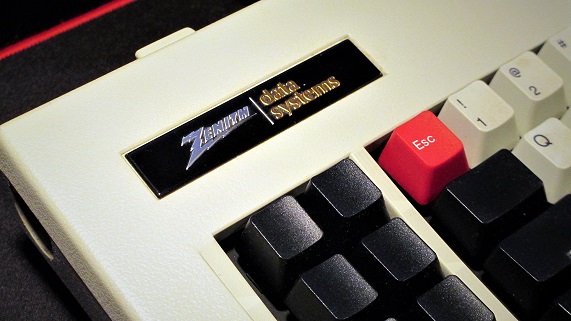

+ Black Zenith logo badge.

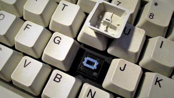

+ Hybridized switches from linear to tactile/clicky with tops, sliders, springs, and click leaves from SKCM Blue Alps.
+ Cleaned Blue Alps parts using an ultrasonic cleaner. Lubed the sliders with Dupont dry teflon.

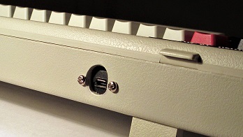

+ Installed a micro-USB connector.

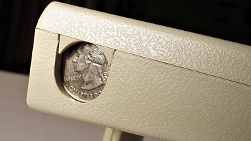

+ Closed the opening for the former connector with a US 25-cent coin (perfect fit!).

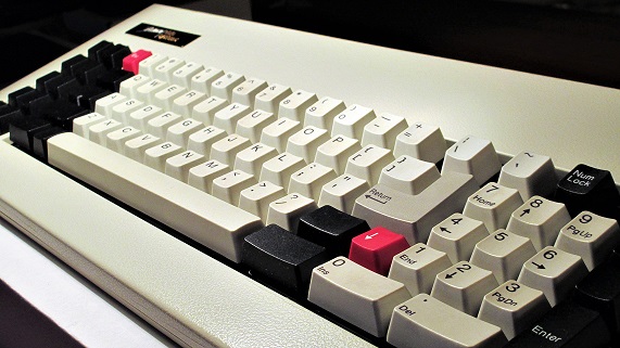

+ Replaced modifier caps with caps from Matias black blanks, Tai Hao red Dolch, and Tai Hao black.

Top left - Zenith badge
Right side
Hybrid switch and underside of dye-sub PBT cap
Micro-USB connector
Former connector opening blocked with US 25-cent coin

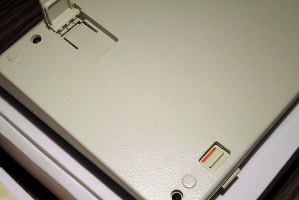

Bottom case showing a flip-out foot and latch

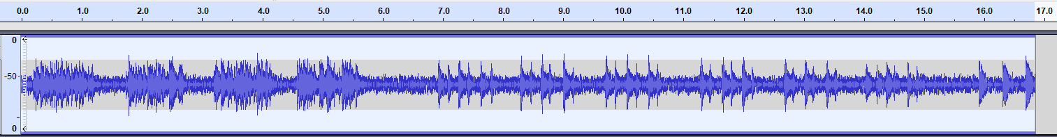

Waveform of typing sounds (dB vs time)
Typing sequence: 3 times each of the following sequences:
097
oii
;lk
Return
Right Shift
NumPad Insert
Spacebar
Thumping finger on top-center case
