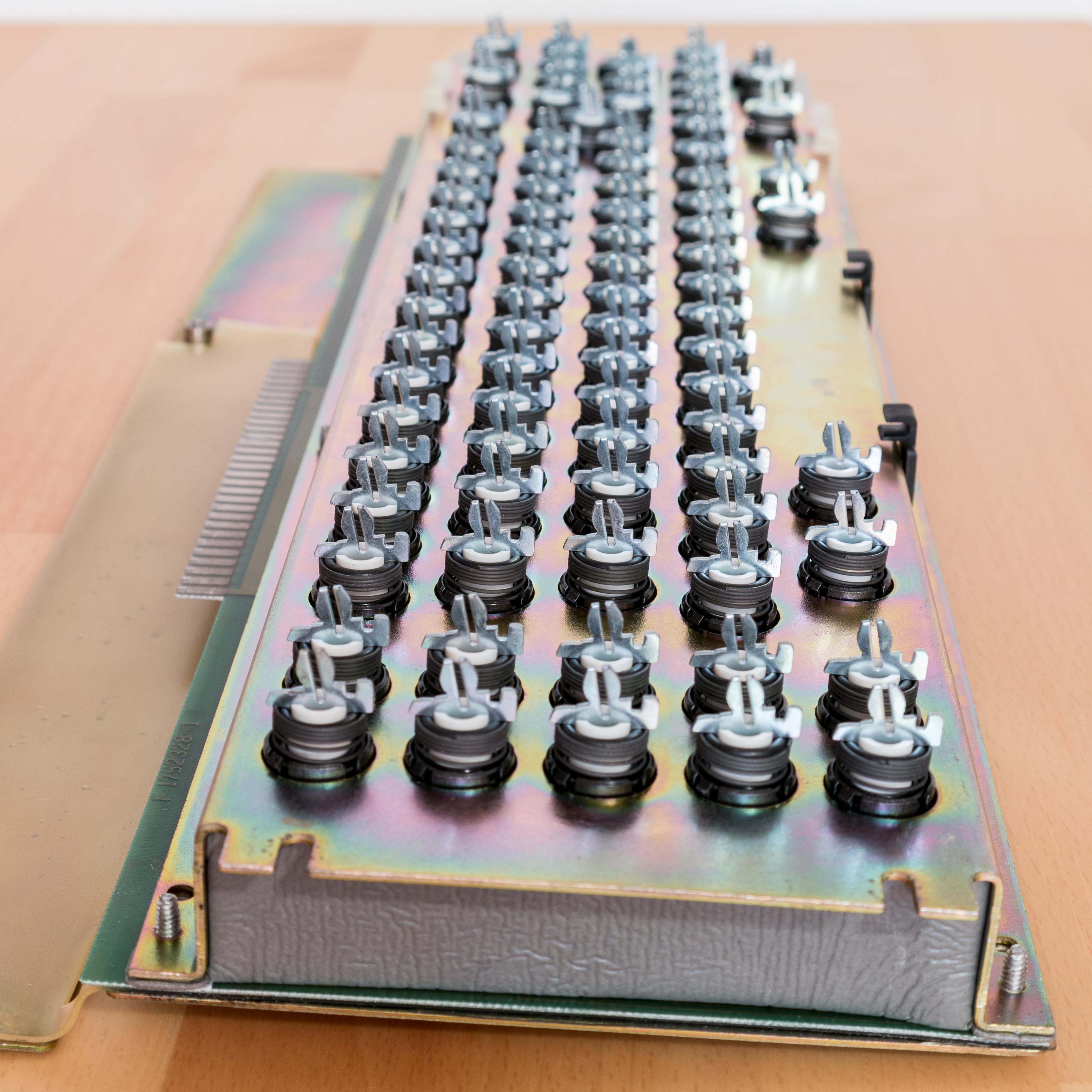

Some weeks ago I got an IBM 5251, which was in really good shape. No rust, nothing broken or bent.
But the switches were very loose, so I opened it, cleaned it and replaced the foam.
All switches are sitting tight now - and clicking happily.

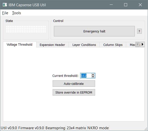

But I have now the problem that there is no Voltage Threshold, at which all keys are working correctly.
At 112 all keys have the state "off". If I press keys, nothing happens.

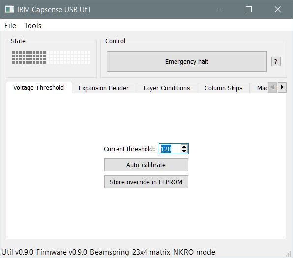

If I go higher - starting from the left side - keys start to register as pressed, although I'm not pressing any.
Until at 128 the 10 first columns all register as pressed, although I'm not pressing any. And if I press keys of the other columns nothing happens.

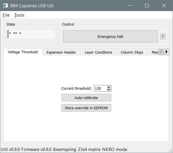

If I continue to raise the threshold, finally keys start to react, when being pressed. Starting in column 23. The higher the threshold, the more columns start working - till column 11 - at a threshold of about 144.
If I go higher, key presses start to trigger multiple spots, until in the end the whole matrix registers as pressed (without keys being pressed).
To sum it up: I can get the columns 11 - 23 roughly working, but columns 1 - 10 are either in state pressed or not-pressed - depending on the threshold, but at no point work correctly.
