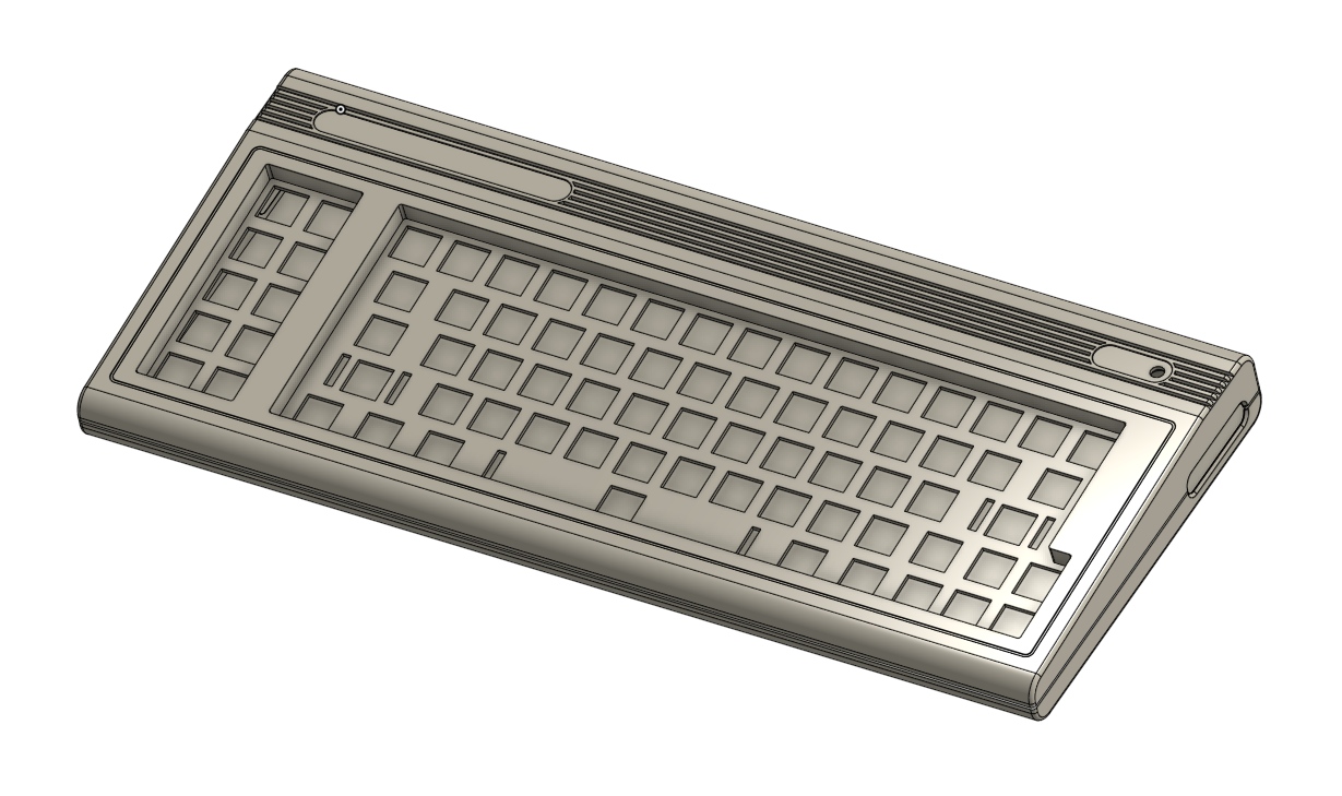

Made a lot of updates to the case. I still have to find a solution for the back USB port.
Below a very rough render.
the function keys on the left would be flat so I can mix and match anything I want.

16 Jan 2019, 18:52
What kind of material do you have in mind for the case? Milled anodised aluminium?
It would be nice if it would be designed so that mods wouldn't be too difficult.
First, a Raspberry Pi (Zero) or Hub would need some space. Then when drilling for a port, you would like the wall to not be too thick and leave visible bare metal.

Findecanor wrote: 16 Jan 2019, 18:52 What kind of material do you have in mind for the case? Milled anodised aluminium?
yeah material would be aluminum. As of now I don't think you can fit a raspberrypi... (well yeah a zero, sure). But your idea to make a thin spot is not bad at all...

16 Jan 2019, 20:34
It's kind of smart to accommodate the arrow cluster this way by making the Right Shift 1.25u. Haven't seen this before, and if it is not done in other keyboards before, matt3o has really created this design with some out of the box thinking.

Just some request / suggestions perhaps even unreasonable:
For those two empty round-edge spaces at the top of this keyboard case, the right one can have the lock indicator LEDs, the left one, if you can, or if some crazy people can make this happen, can hold a layer or layer name LCD indicator for the keyboard, given it can have its own Raspberry brain even.

16 Jan 2019, 20:56
Menuhin wrote: 16 Jan 2019, 20:34 It's kind of smart to accommodate the arrow cluster this way by making the Right Shift 1.25u. Haven't seen this before, and if it is not done in other keyboards before, matt3o has really created this design with some out of the box thinking.
honestly I've never seen it in modern keyboards ;)
The right LED can be layer lock or caps lock, or just power. Up to you. On the left I'd put a sticker c64 like...
Speaking of which... what about the name?
I was thinking Commander 64 or simply Sixtyfour.
16 Jan 2019, 21:25
It's similar to the original C64 which had a 1.5u right Shift, and then two "CRSR" keys on its right side. Without holding Shift, those keys were Down and Right: same keys and same fingers as an inverse-T cluster but one row up compared to a standard PC keyboard. Shift-Down was Up and Shift-Right was Left. The best 2-key arrow cluster I have seen. :)
The C64's keyboard was actually quite wide. The top two rows extend farther to the right, with 16 keys on the top row instead of 15 which is standard nowadays. The Del key is to the right of where a standard Backspace key is now.
matt3o wrote: 16 Jan 2019, 20:56 I was thinking Commander 64 or simply Sixtyfour.
If the Backspace key was 2u, it would be a 74-key keyboard. ;)
